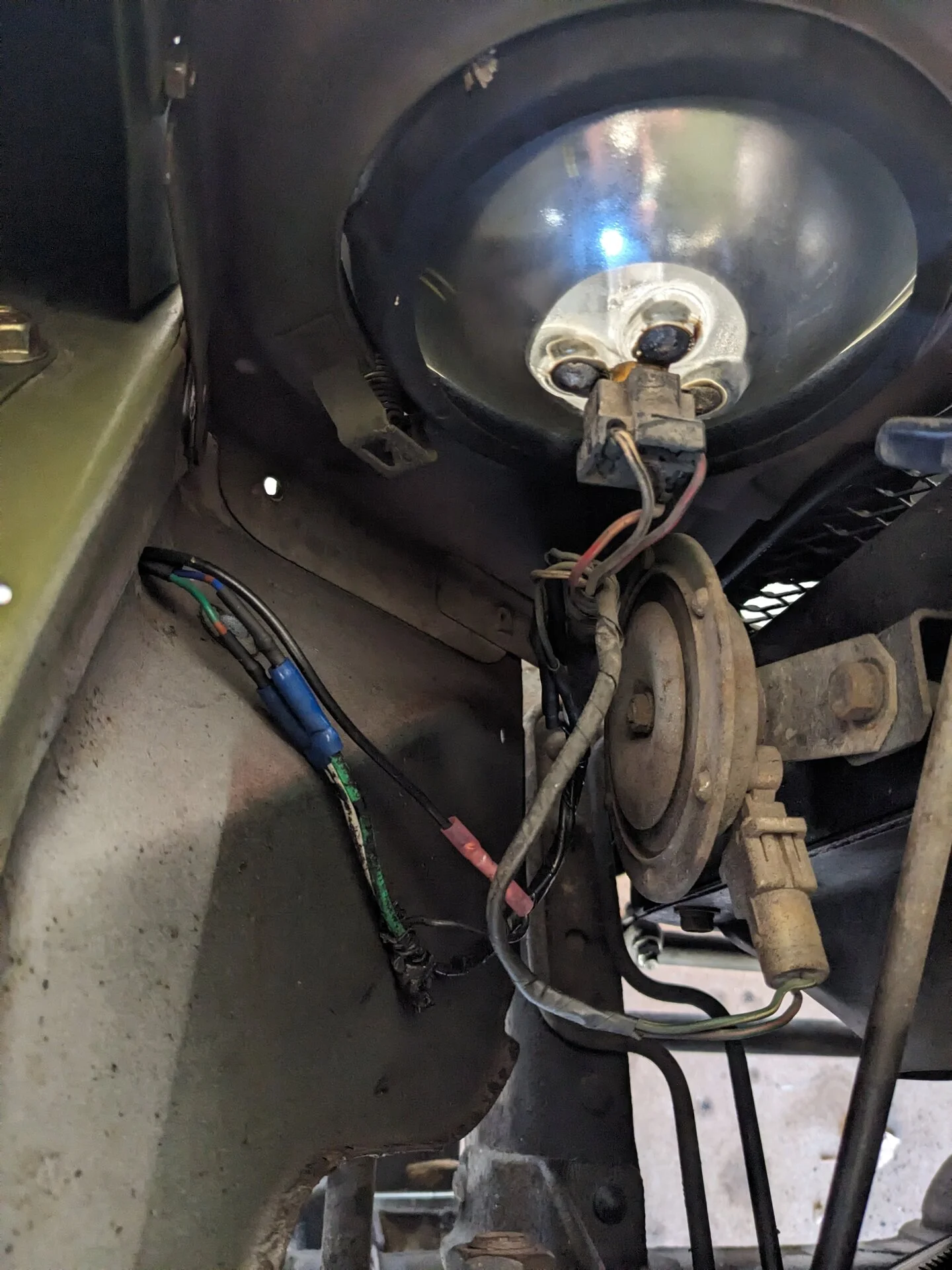

The headlights on my truck are pretty awful, and I'm trying to figure out how best to go about making it safer to drive at night. I have my eyes on the City Racer LED lights, as well as the KOITO 8110-60P70 Kit - I don't have a preference for either, so long as I can see adequately at night and they are easy enough for a beginner to handle the installation.
The issue I'm having is making sure what I order will work with what I have now. It looks like the PO may have done a bit of splicing to get stuff working.
Current behavior - I pull the headlight knob out halfway, and the fender lights operate (main headlight lamps off). Pull the knob all the way out, and both lights come on.
If I order either of those sets I mentioned, will I need to undo what the PO did so that the high/low beams are handled in the main bulbs - and if so, will I loose my fender lights?

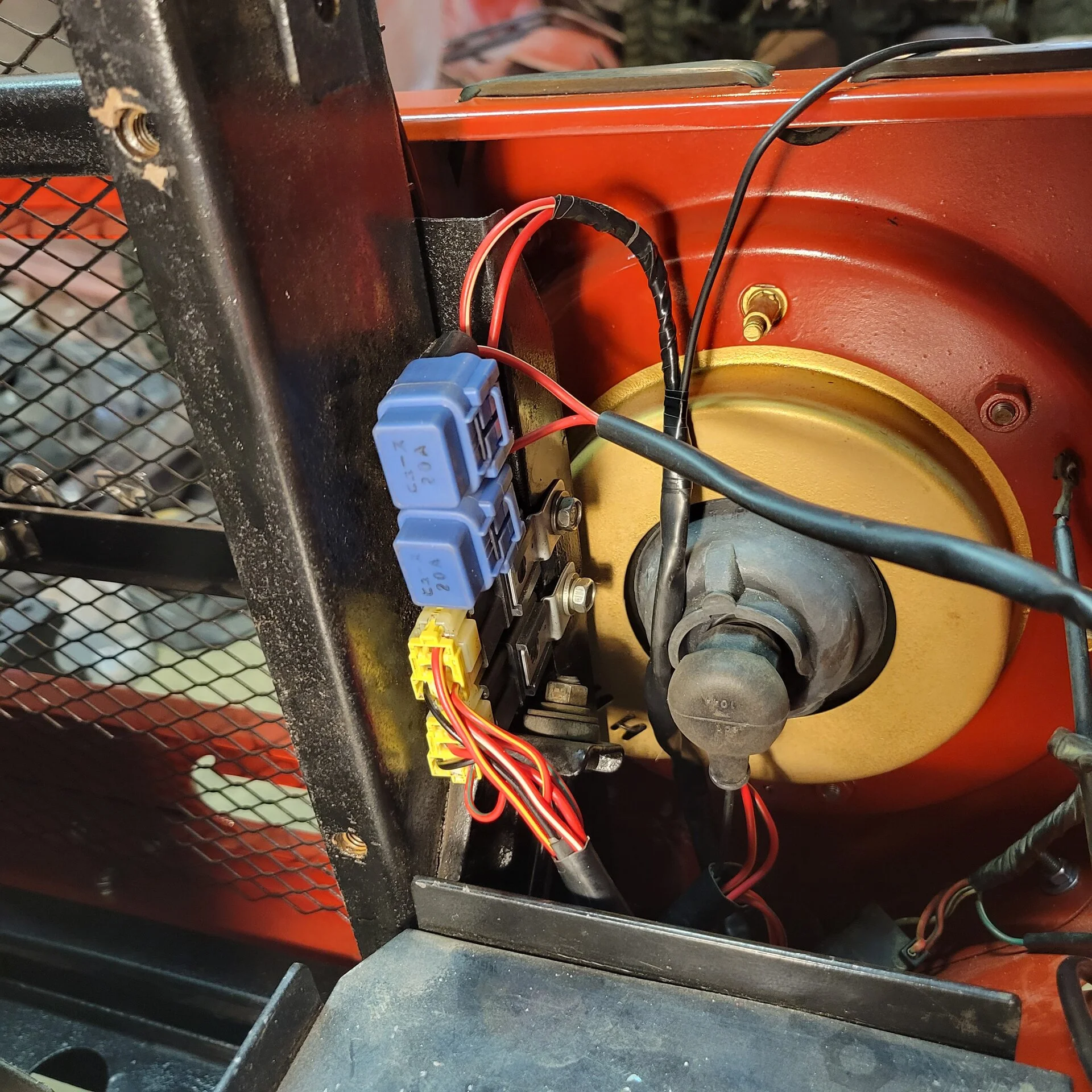

I highly recommend the Toyota kit. It's just 5 connections. It's plug and play. In stk wiring power goes thru switch to the light. In the kit, power comes from the batt, and is activated by the switch. Unplug 1 head light and plug it into the harness. Remove your old bulbs and install the new headlight housings and install the bulbs and plug the harness to them. Then 1 or 2 wires to the batt positive and 1 negative. Hardest parts figuring out where you want to mount the relays and fuses. The harness is long so some folks shorten it. The blue things are the fuse covers. Fyi. I'm not familiar with Cityracers kit.

.Hardest parts figuring out where you want to mount the relays and fuses.
Not anymore :D

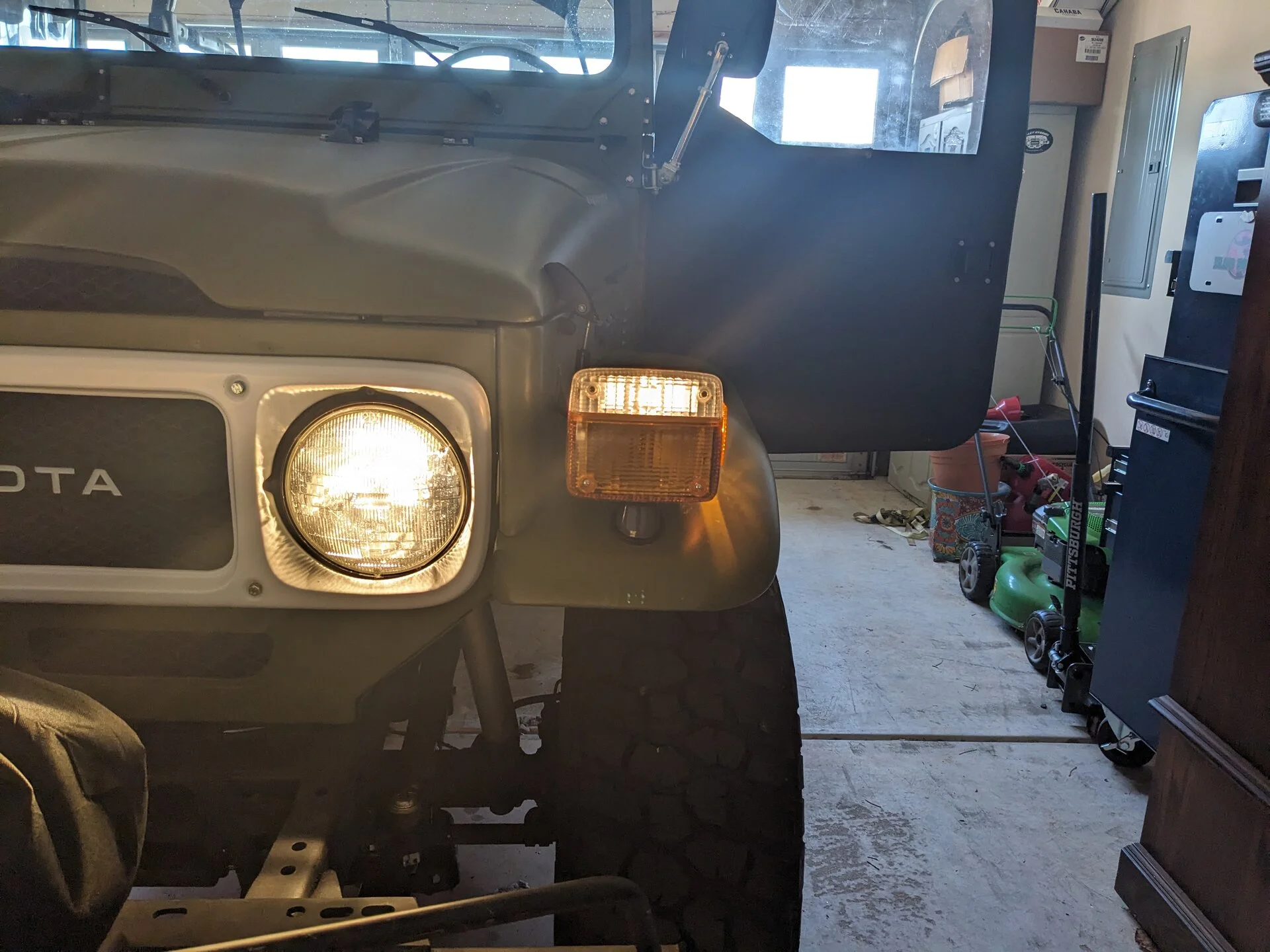

For anyone keeping score - I ended up getting the City Racer lamps. Shipping was crazy fast, installation could not have been simpler.
I don't love how the LED light looks on my truck, I think the warm orange incandescent lamps look great on an old vehicle, but I am more than pleased that I can see everything at night with ease now, and the ride feels safer now as a result.

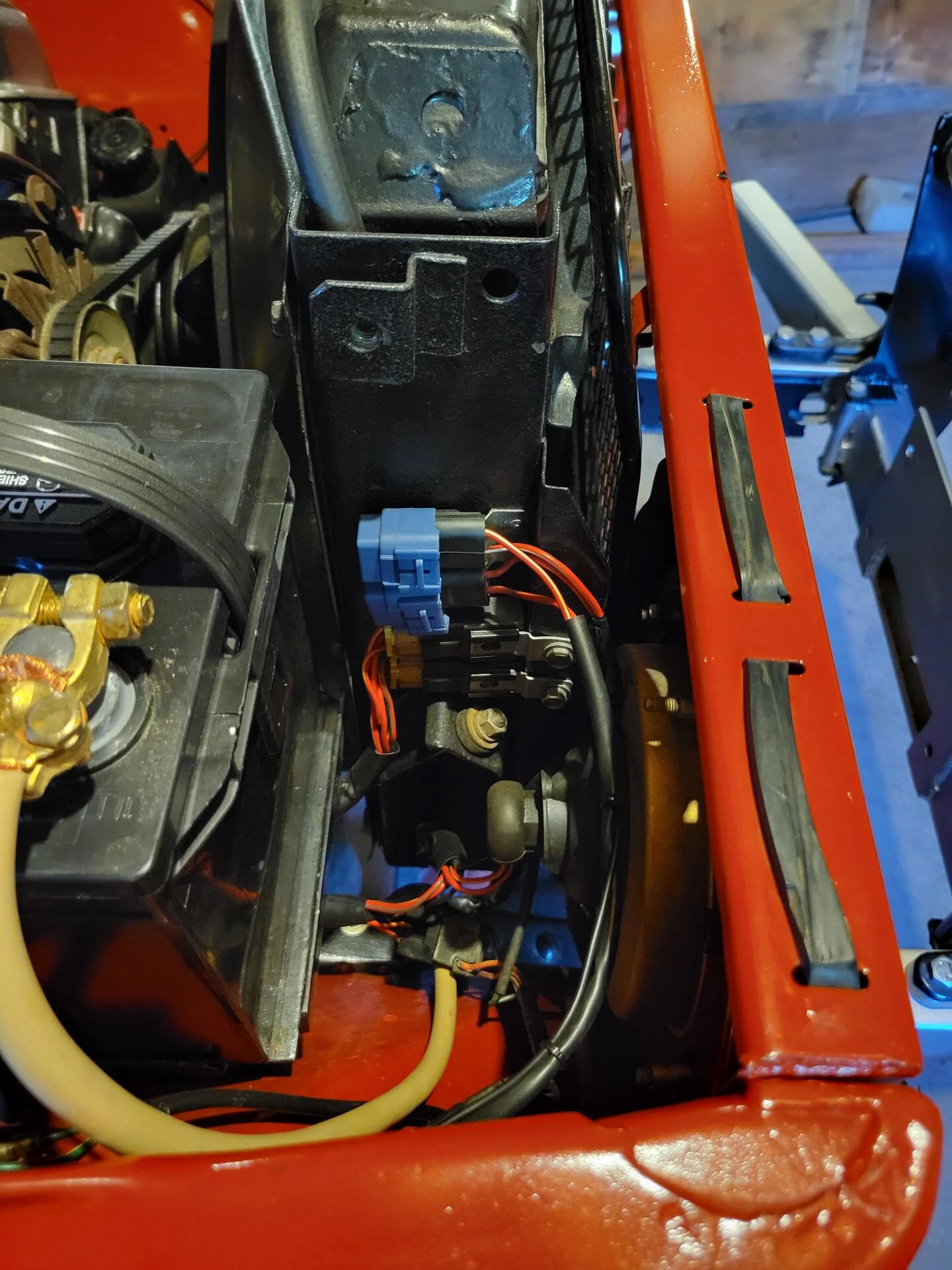

I was able to get one of these kits and get it installed in my 40 today. Excuse my ignorance, but why do we need the relays, fuses, and direct power from the battery as apposed to just being able to plug directly into the factory wiring.
The original factory wiring is to light to handle the current draw of higher power headlights. So to fix this issue you use the original wiring to trigger the relay. Heavier wires are run from the battery to the relay and then to the new bulbs. The relay is simply an electronic switch.
