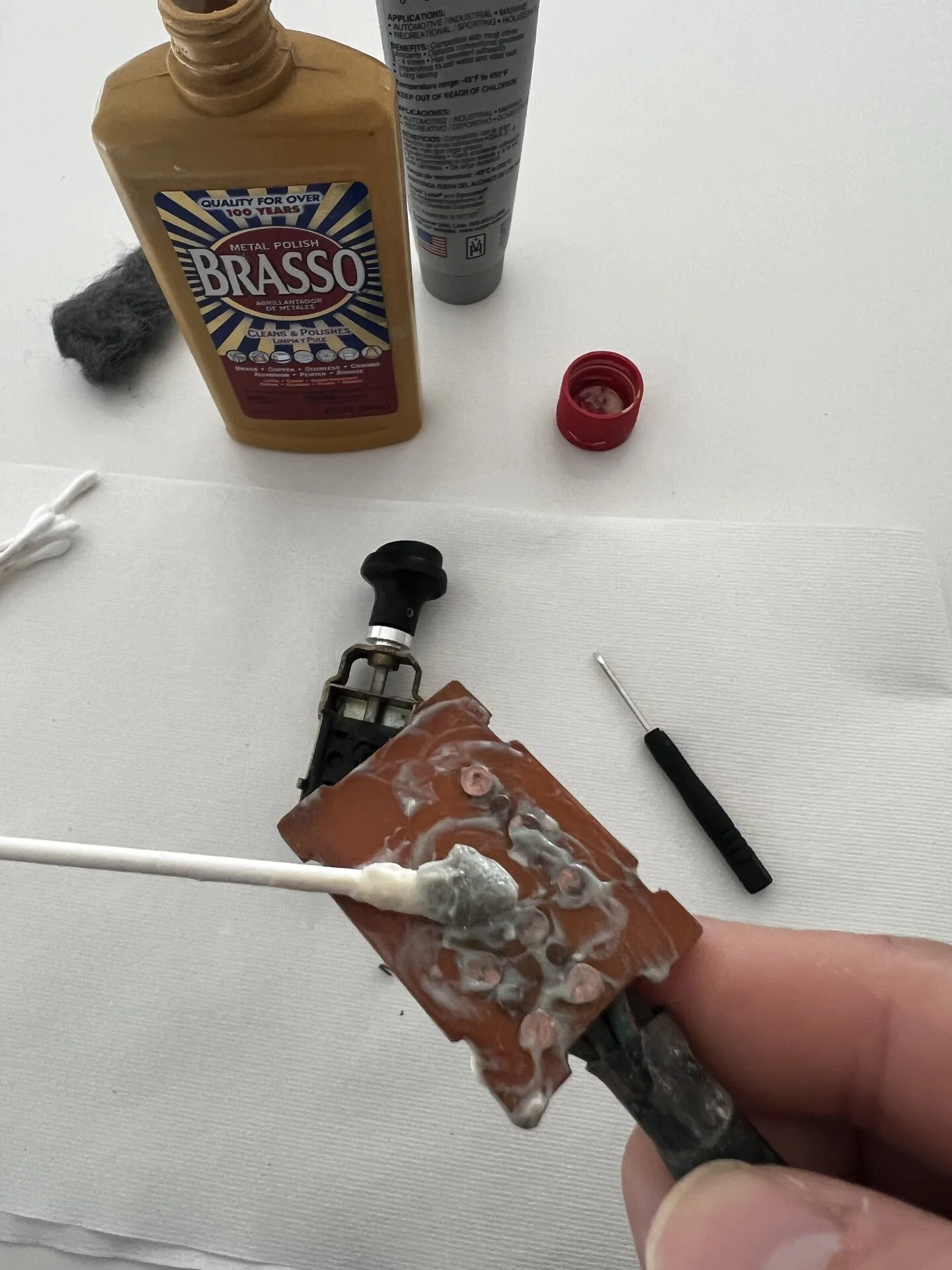

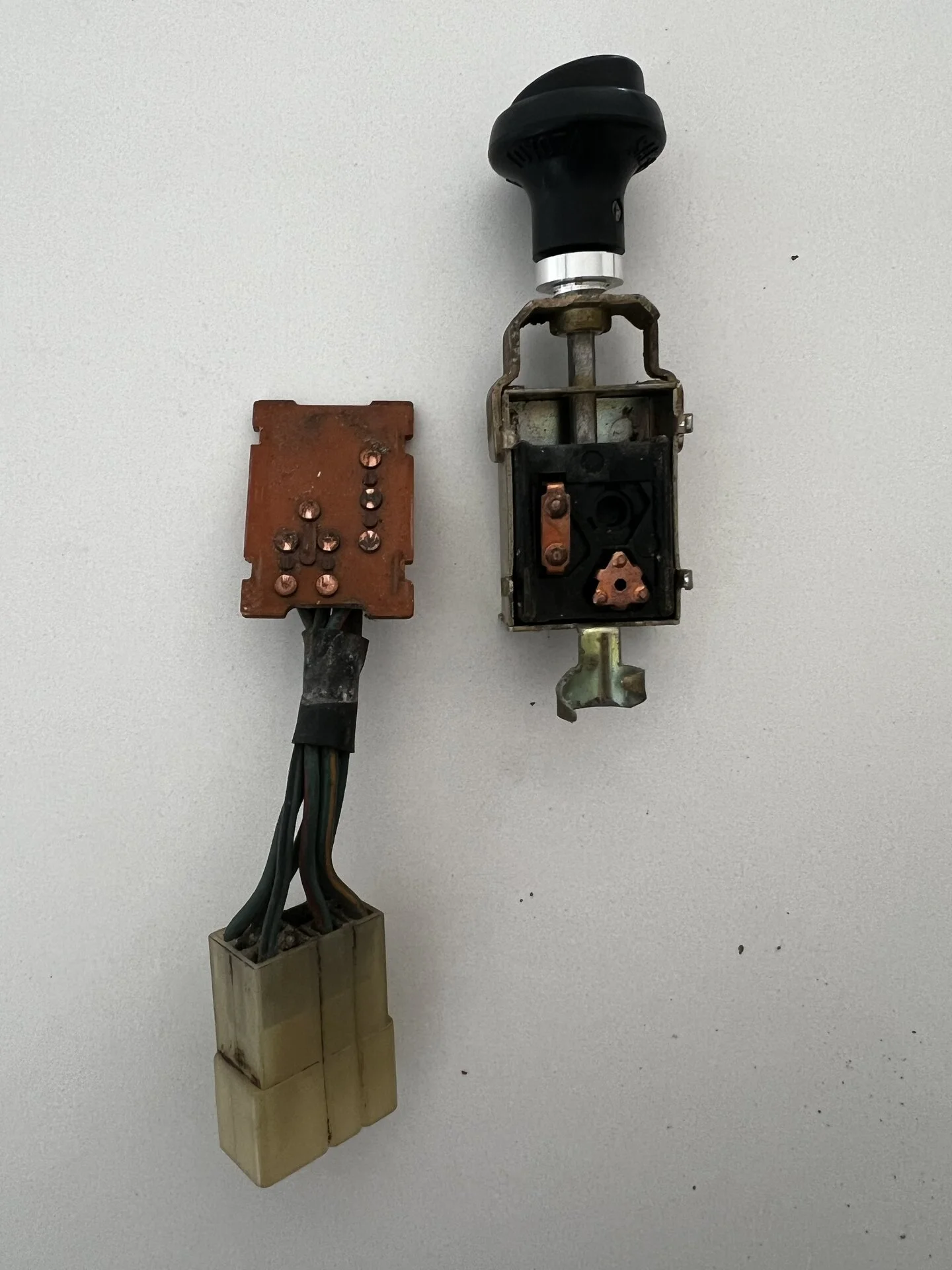

Hazard switch. Normal course of action might be to find another or buy one. However a small flat head screwdriver to carefully pry open the tabs and wiring harness revealed what I'd hoped to be an easy fix:

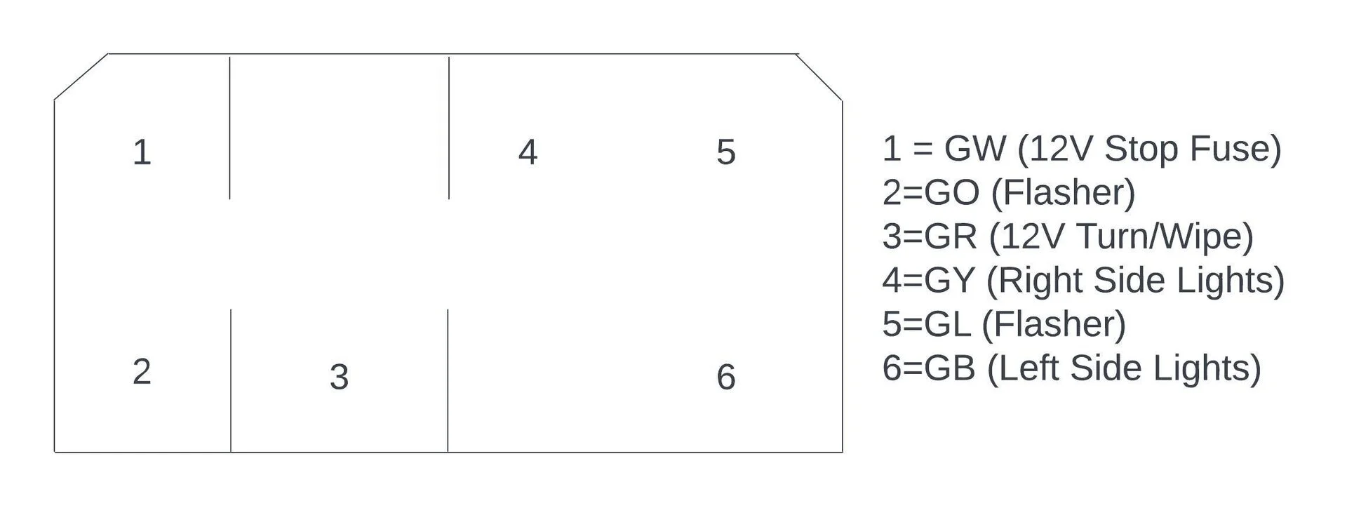

Quite a bit of dirt and grime fell out - and comparing the contacts....I saw exactly why GO and GR were not passing 12V. (Which if you are rebuilding one, I made this diagram):
If you have the switch in your hand, removed from the truck and look in the end of the plug:
1. With the switch pushed in (OFF) pins 2 and 3 will have continuity with each other and none else. (this allows current to flow through your normal turn signals)
2. With the switch pulled out (ON) pins 4, 5 and 6 will have continuity with each other and pins 2 and 3 are interrupted with a new 1 to 2 connection, overriding your turn signal switch and sends voltage to each side turn signal.)
My pins 2 and 3 failed. You an see the build up on both sides.
Q-tip and Brasso:
Cleaned with rubbing alcohol:
Same thing for the other side. Then, lubricated with dielectric grease (Super Lube is dielectric)
Reassembled:
Test:
2. With the switch pulled out (ON) pins 4, 5 and 6 will have continuity with each other and none else. (this interrupts pins 2 and 3, overriding your turn signal switch and sends voltage to each side turn signal.)

Just one small addition to what you stated in case someone is reading this later and troubleshooting. In the on position, pins 1 and 2 are connected as well. This is what sends the power to the flasher and what was causing your issue (GO and GW open and not making a connection). Nice fix!
