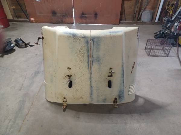

There is a CL ad in Gallup, NM that has a pretty good hood listed. I’m actually going up to my land in the next month or so and could grab it, bring it back to Texas and then we could figure out how to daisy chain it over to you.
Nolan bought a hood from me and that’s basically what we did, albeit, half the distance and it was during Roundup but you’ve got fans and we’re willing to help.
Lemme find the ad..
