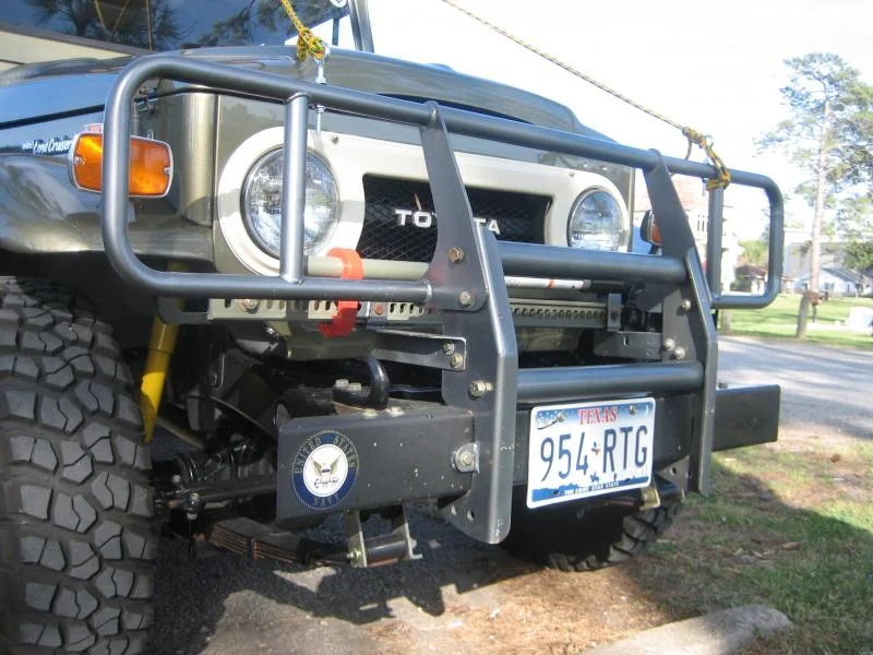

Man - more live action in this thread than I’ve seen in a long time! Love the cleanup, this pig is going to be sweet. I’m betting SOR had a 55 version of that bar, Marv was a big fan of the pigs (had a 20min conversation with him about 55 mirrors when ordering new screws for mine back in the day). Amazingly in-tact end pieces on that rear bumper. What is this magical Vegas gold (chrome)?
Digging this rig @gonzopancho😎
Vegas Gold is a powder coat color that is quite close to the original pewter paint.
Me too! Thanks!
I spy some Dave Gore handy work 😉 Color looks good, these are going to look great!
If you’re referring to the front bumper there... that’s just a pic I found here on mud of the Vegas Gold powder coat vs the stock pewter paint.
This truck keeps its stock bumpers. Trying to keep this one “questionable stock”.

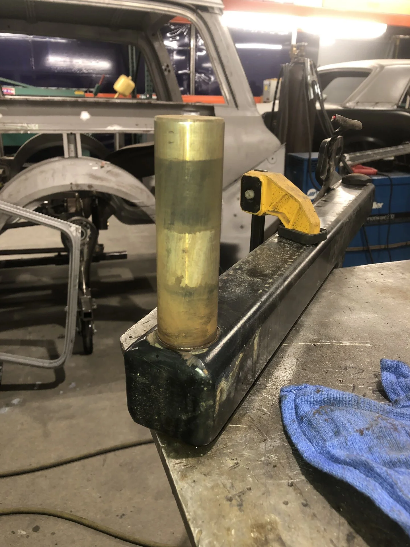

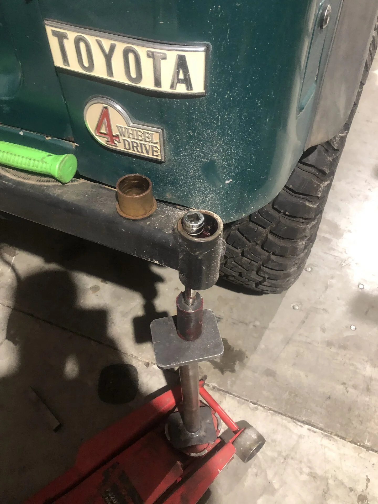

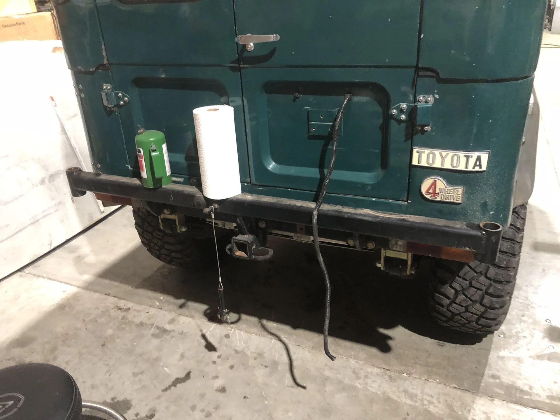

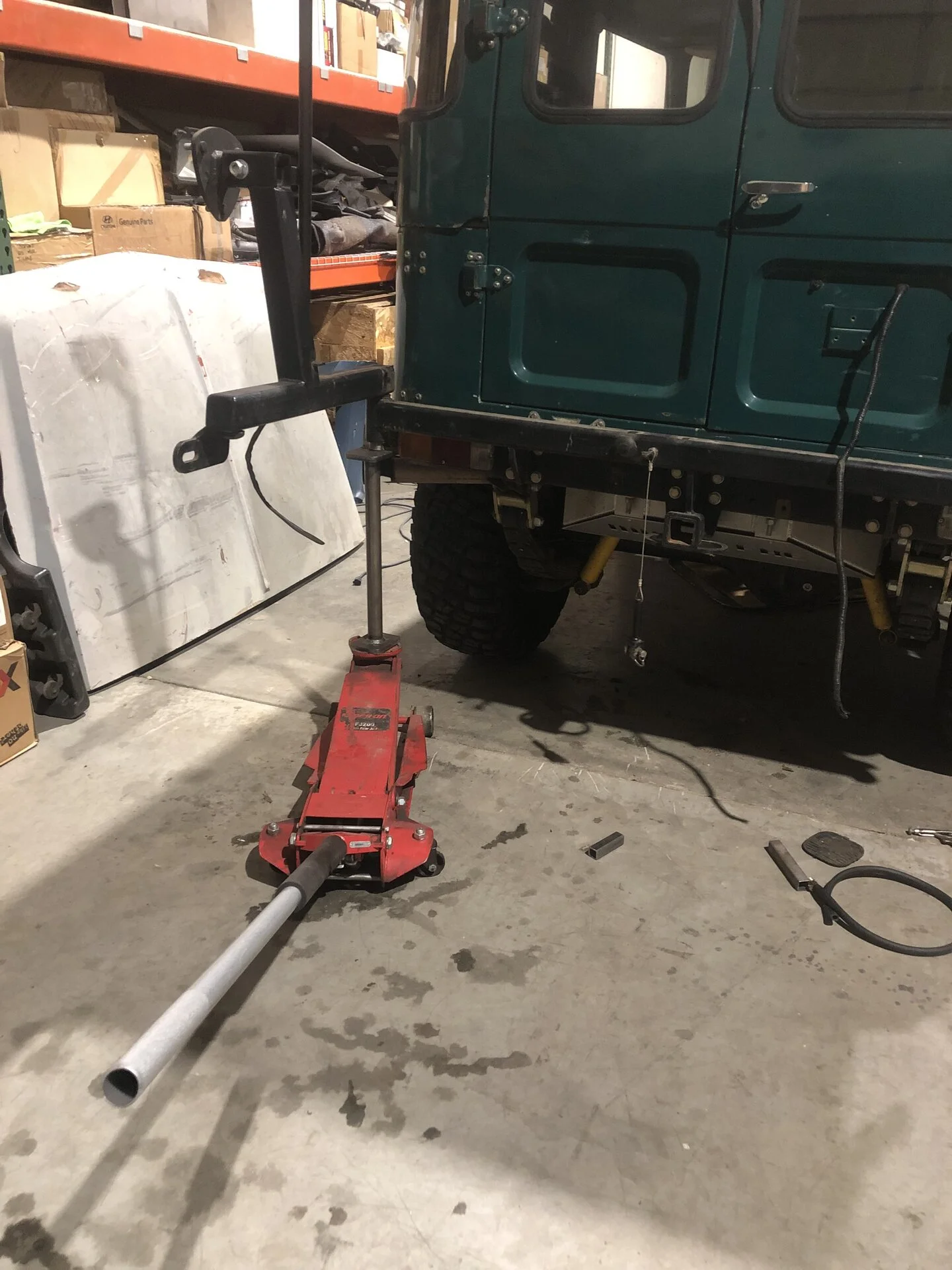

Since you mentioned Dave … spent part of the day tearing the swingouts off a 40 bumper of his.
Plan is to go back together with zerks toward the body, and a channel for grease in the bushing.
This one was on the 76 fj40 I had (@PabloCruise drove it a couple times when he was in Austin.)
This bumper is headed for the 72 fzj40. I have a different one on the 74 fj40 that I’ve owned for > 20 years that @samc2447 can attest is nearly frozen solid.
IDK why Dave won’t install zerks. I’ve mentioned it to him a couple times over the years.

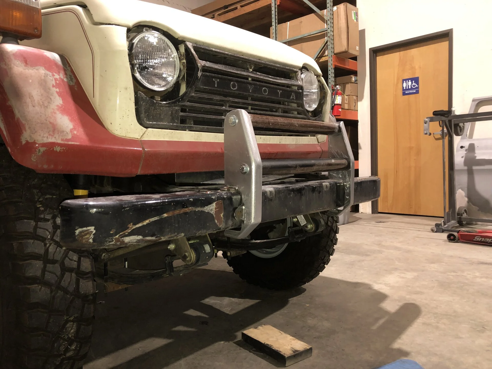

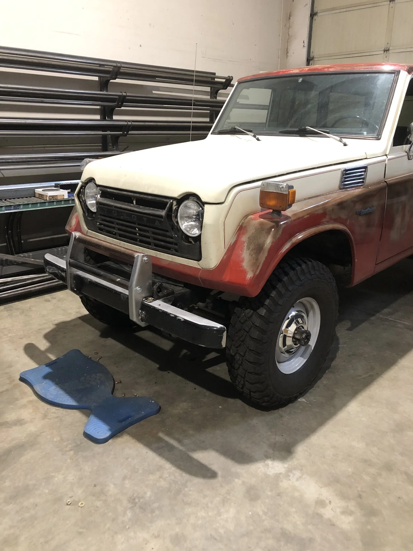

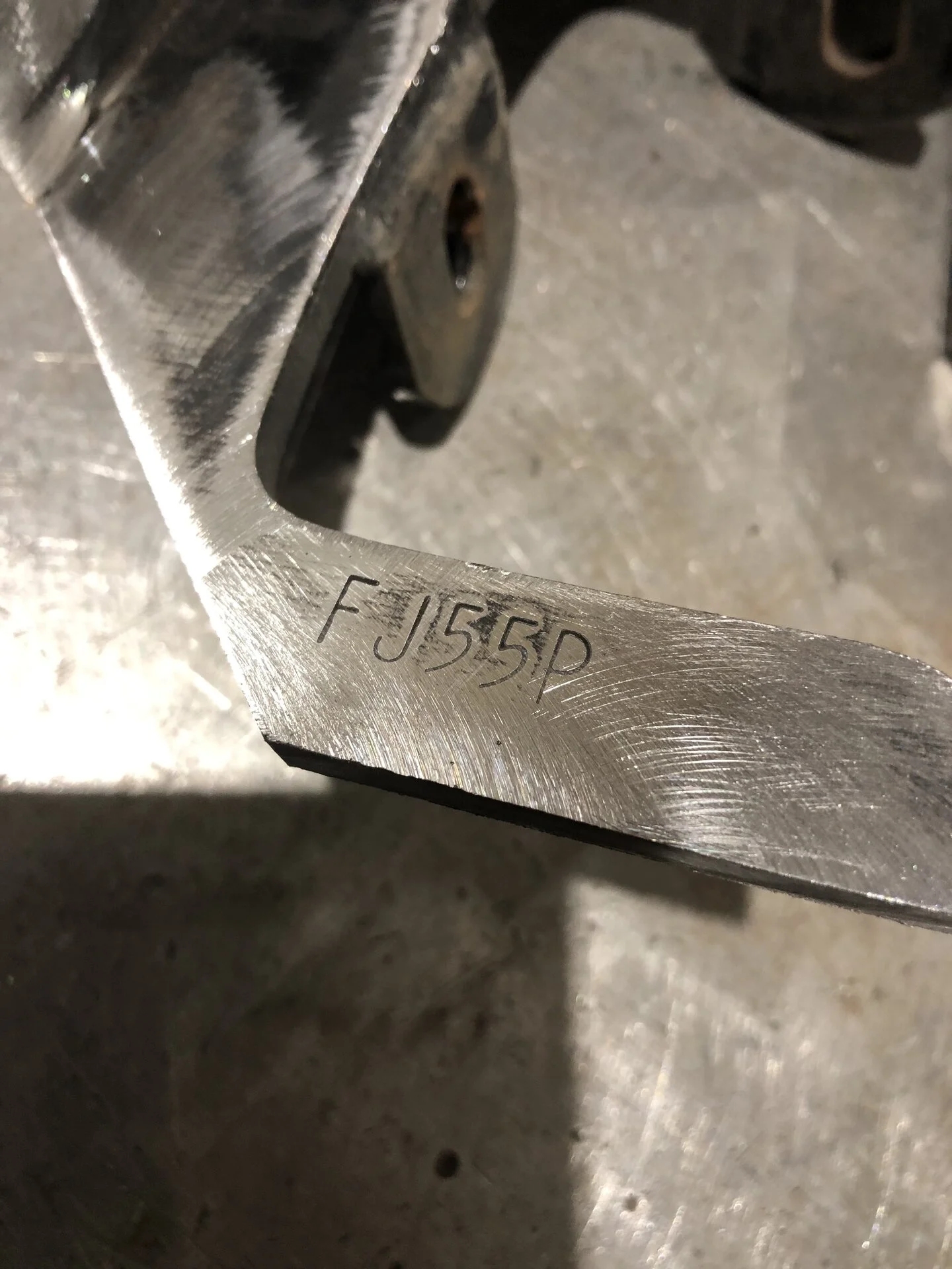

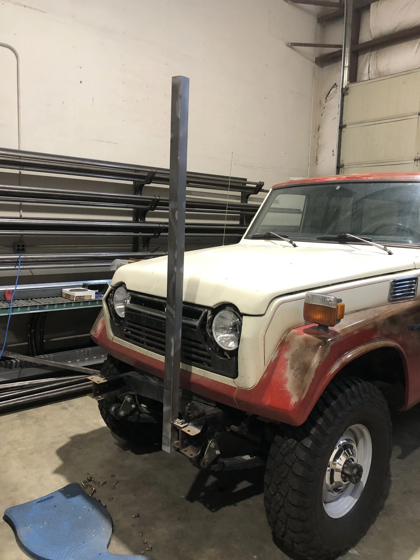

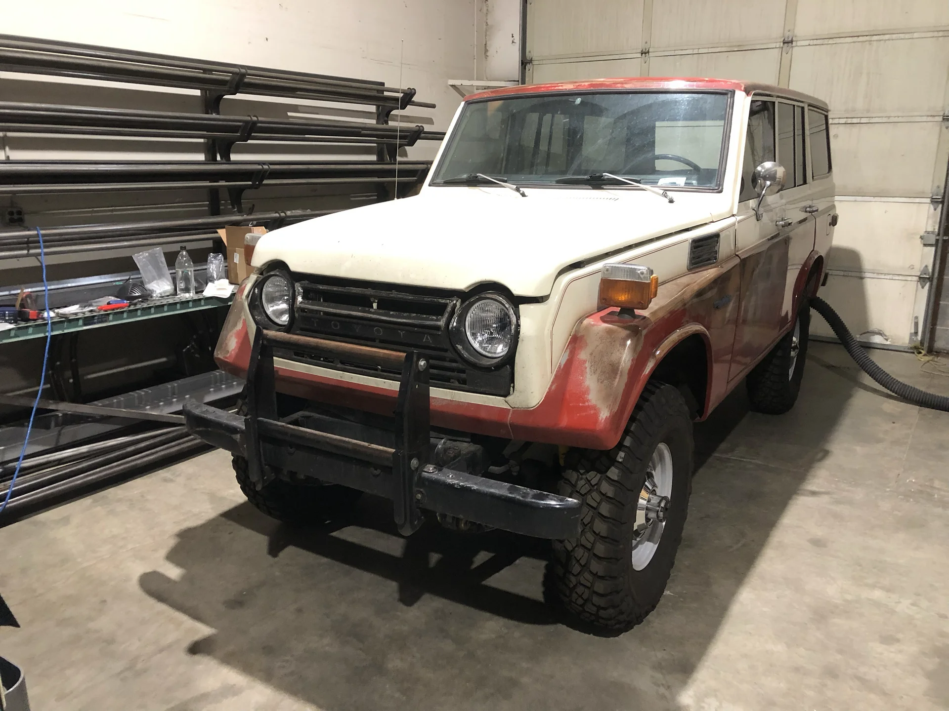

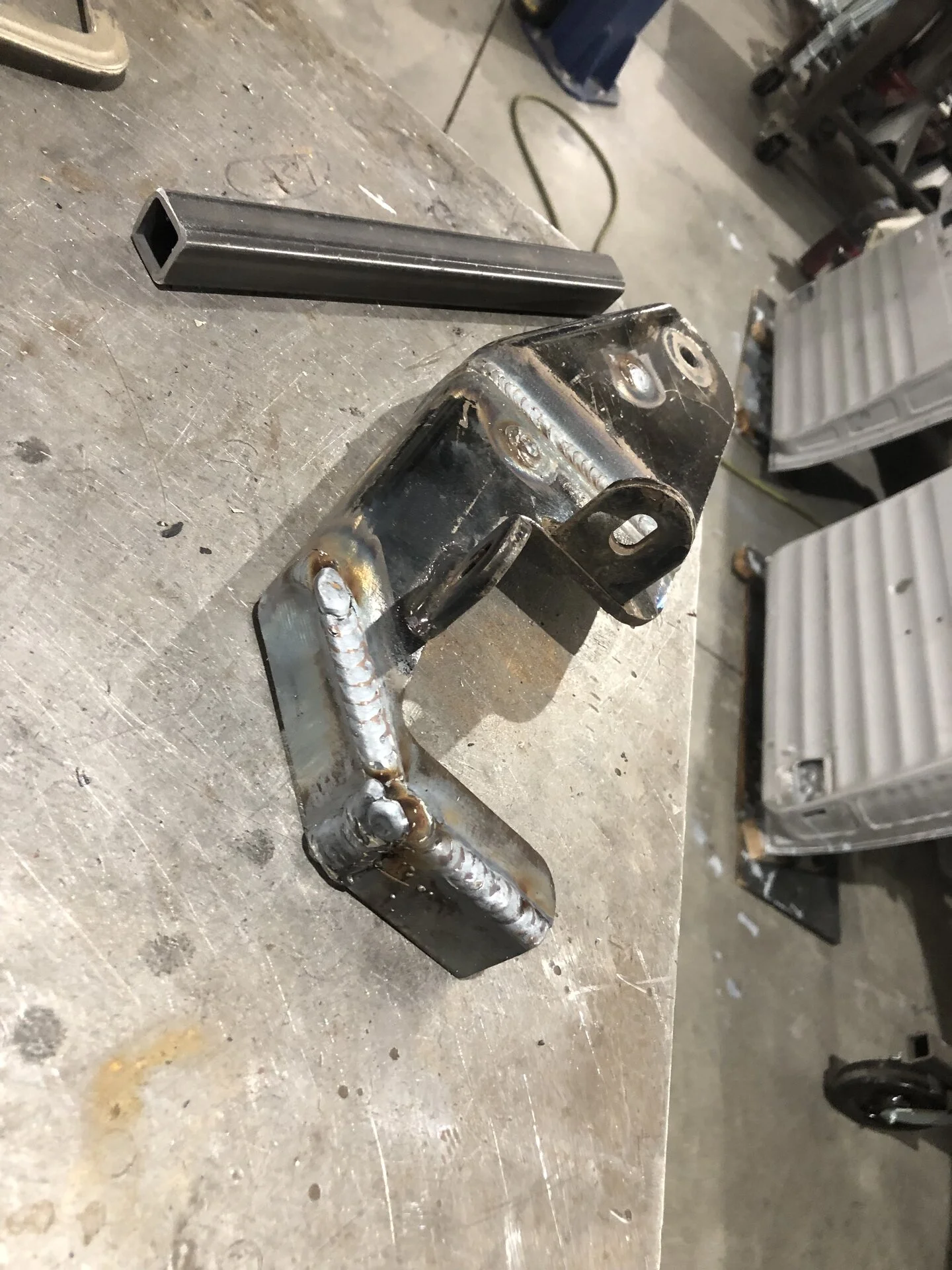

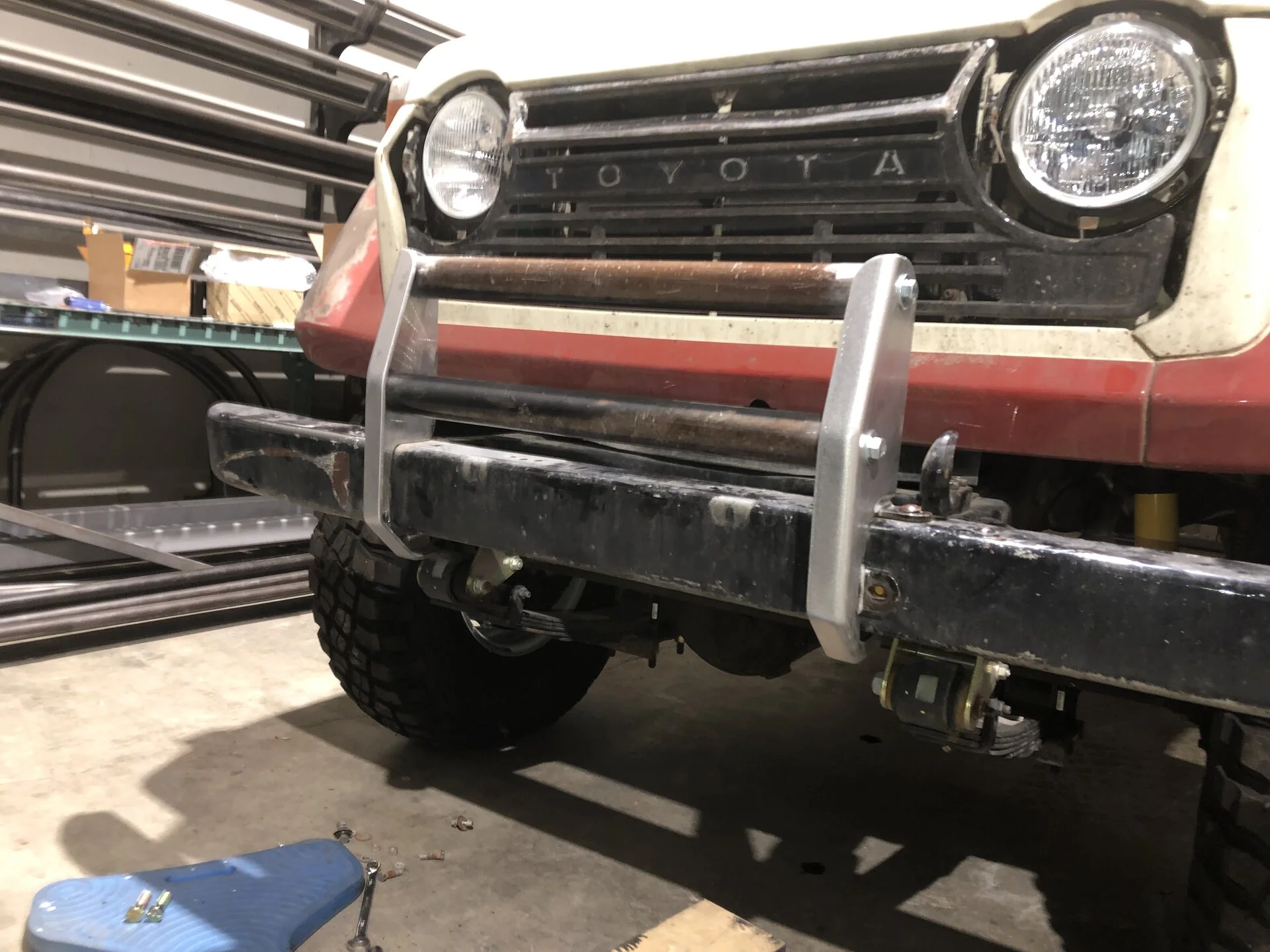

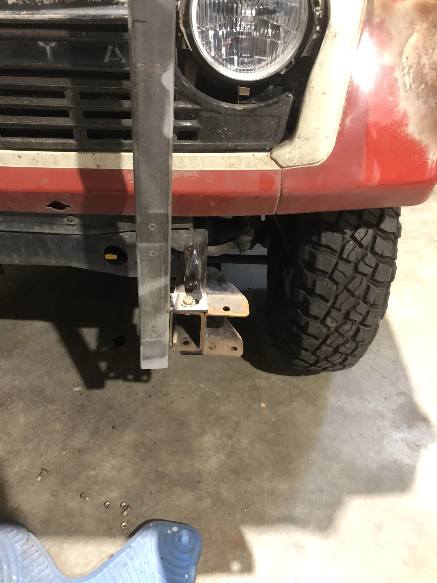

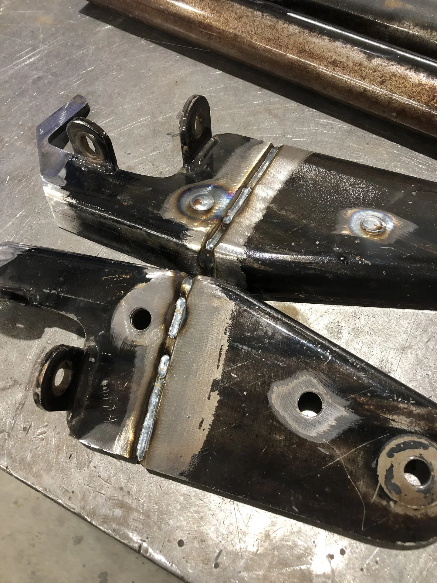

Brush guard reworked.
I’ve allways thought the FJ55 bumper sat low and forward. It needs something upright to bridge the gap.

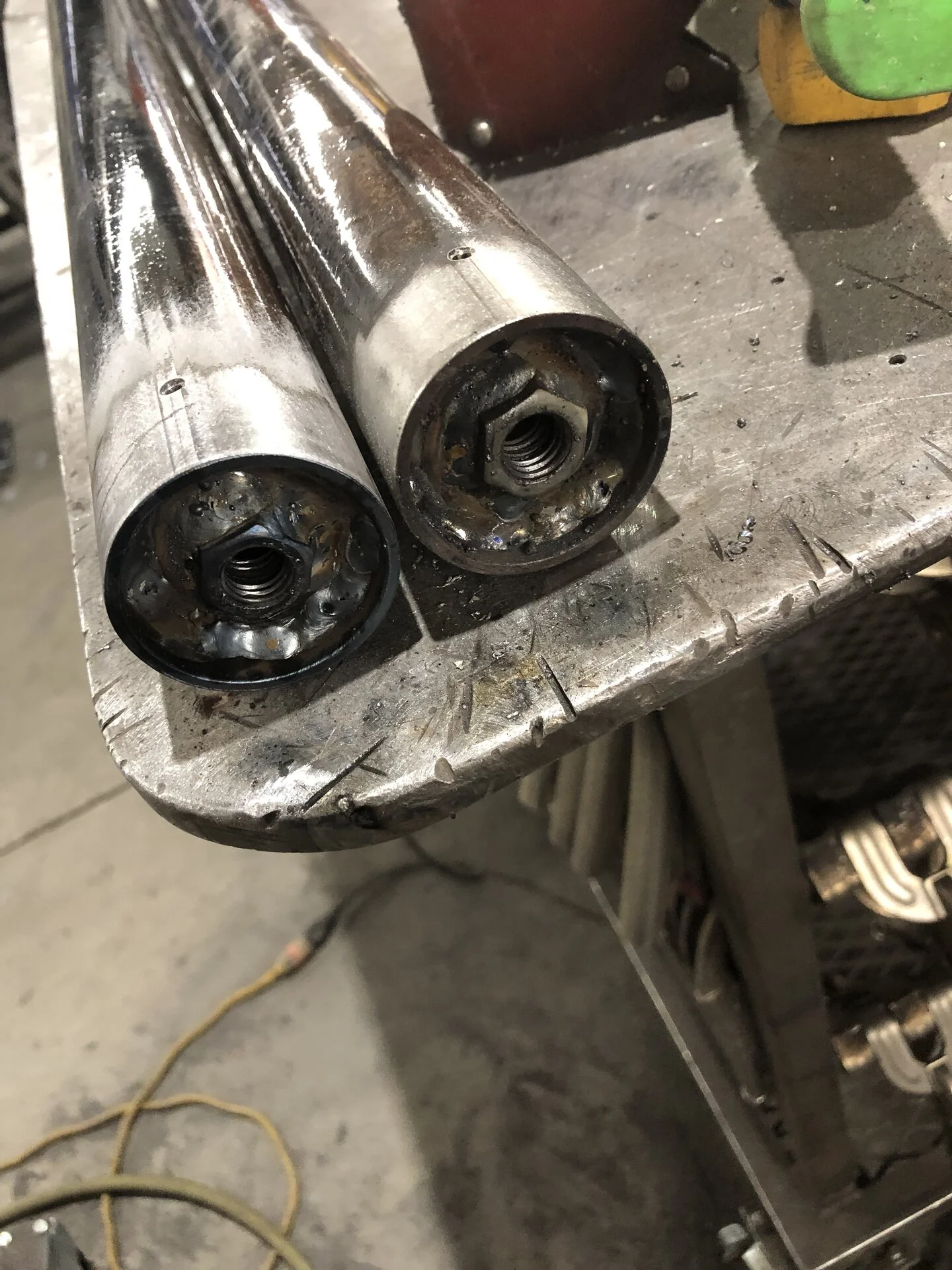

Relocated the lower tube up, added nuts on the tube mounts for more thickness and drain holes.
Lower where it wraps under will get a 3rd tab to attach to the bottom of the bumper.
Ditched the rubber pads on it. Pass side of the bumper will get portapowered back into place. Extra holes in bumper filled.
The piece had some stampings. SOR used to make a similar piece with a huge guard for the 40-series, maybe they made them for 55s, too.(?)
Also much mo' betta!!!
