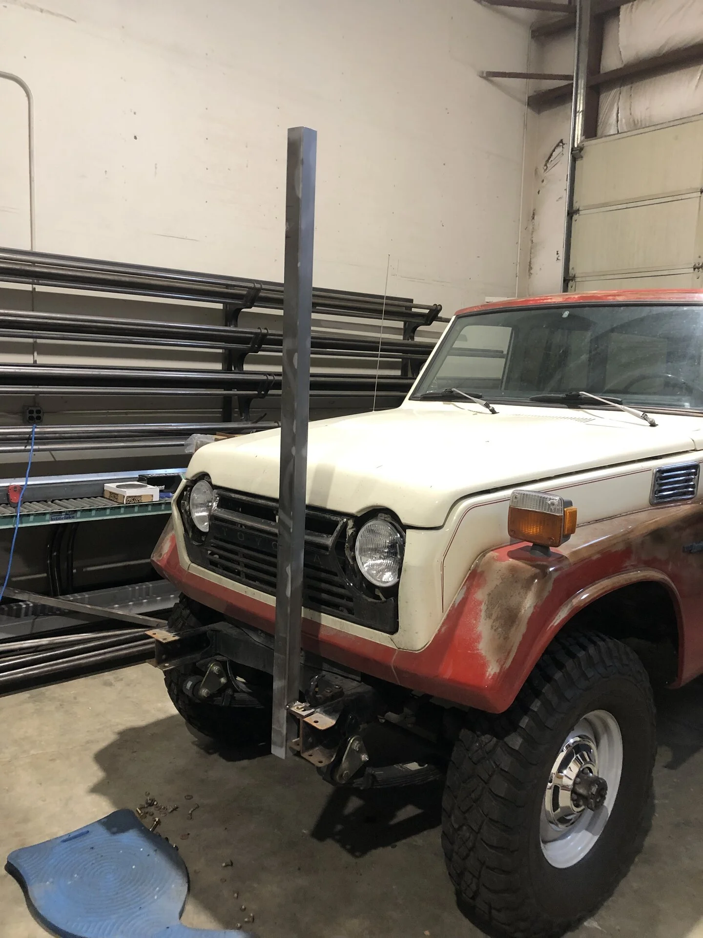

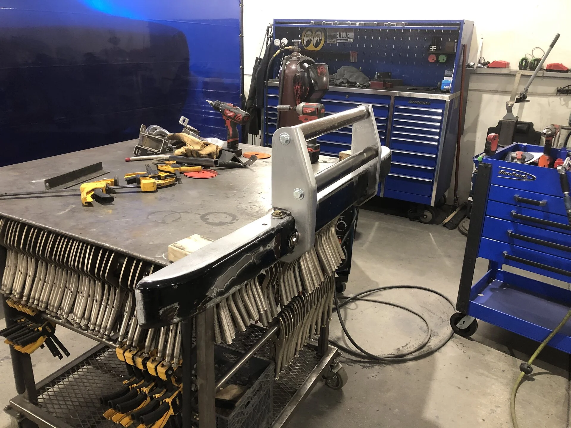

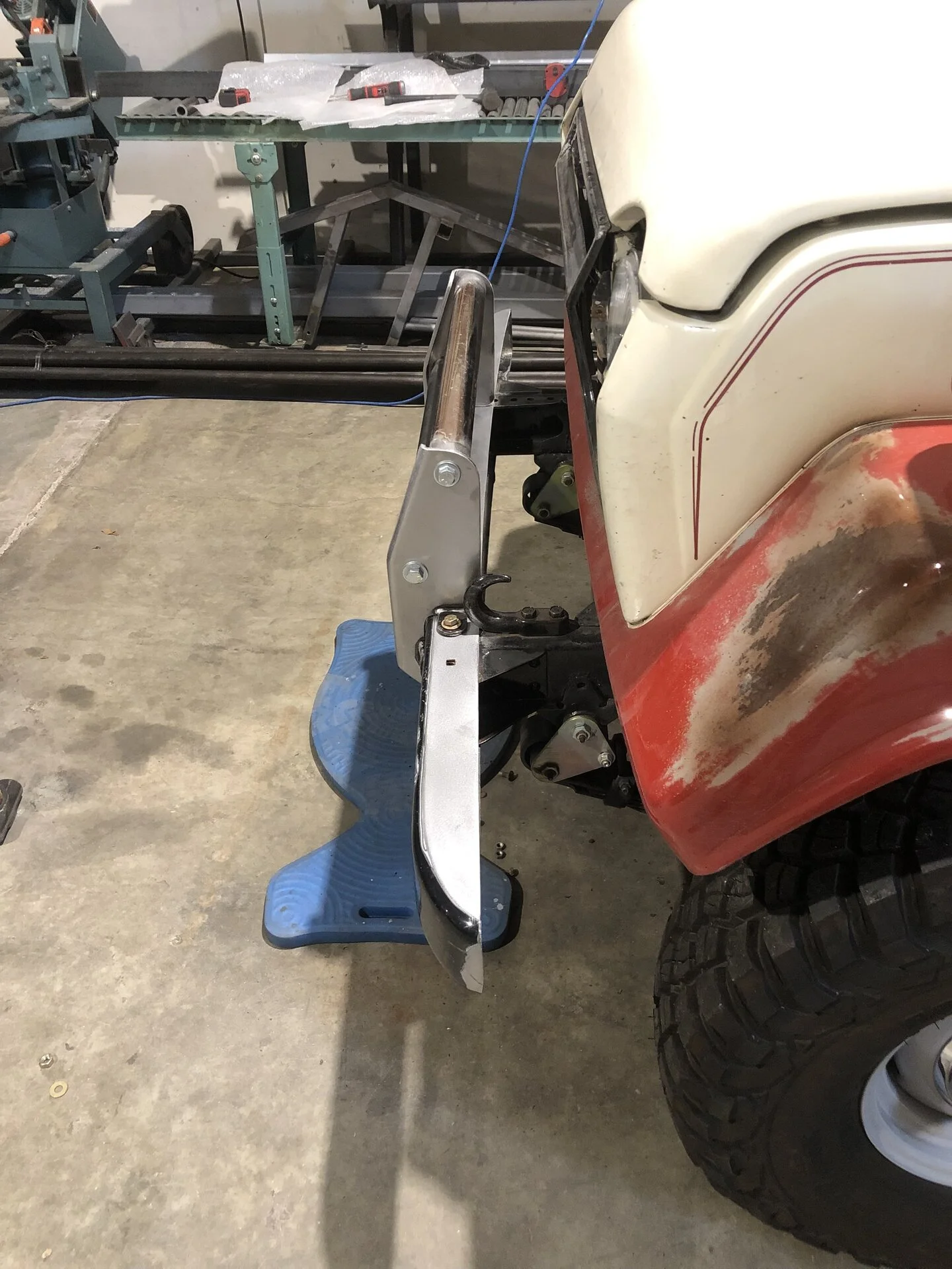

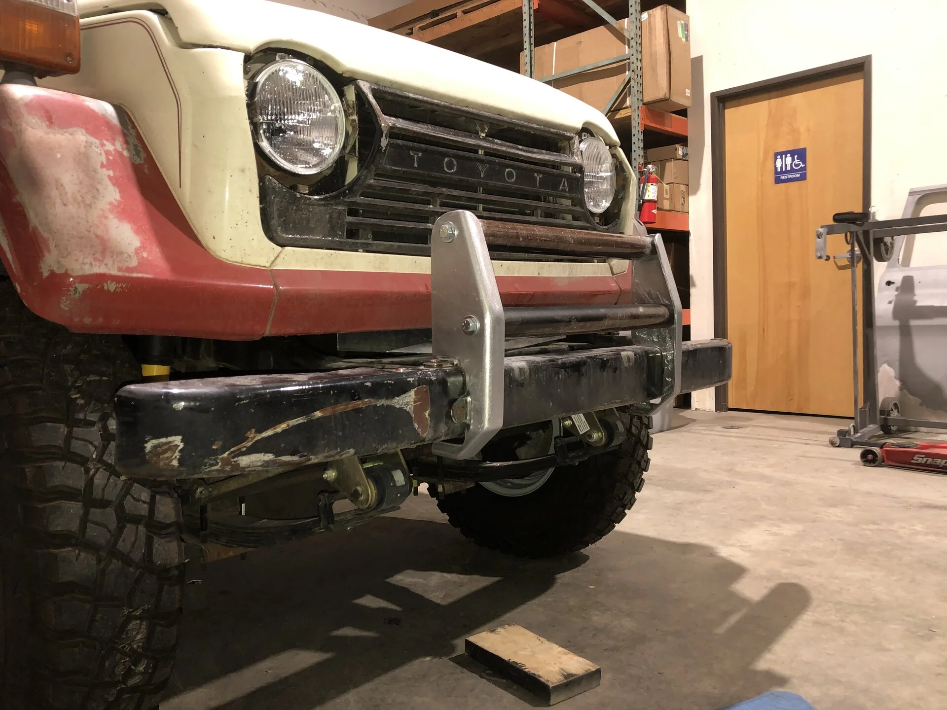

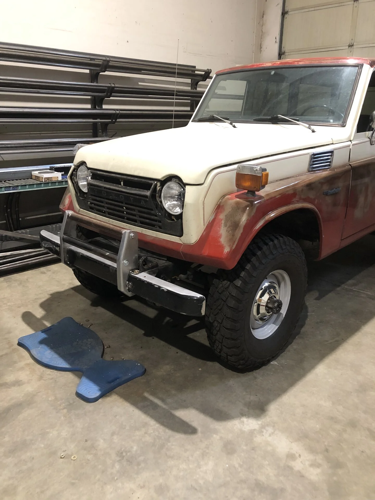

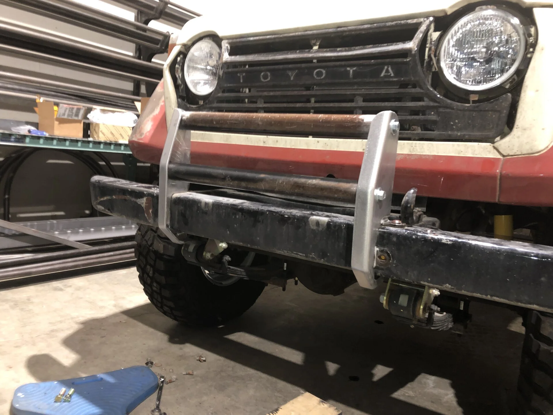

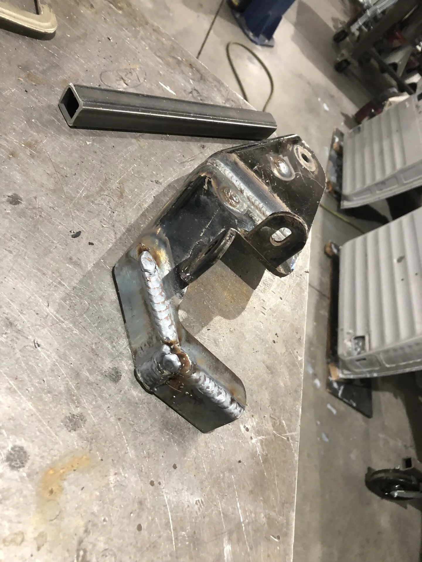

Brush guard reworked.

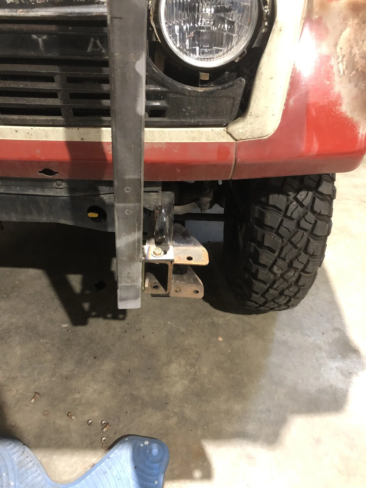

I’ve allways thought the FJ55 bumper sat low and forward. It needs something upright to bridge the gap.

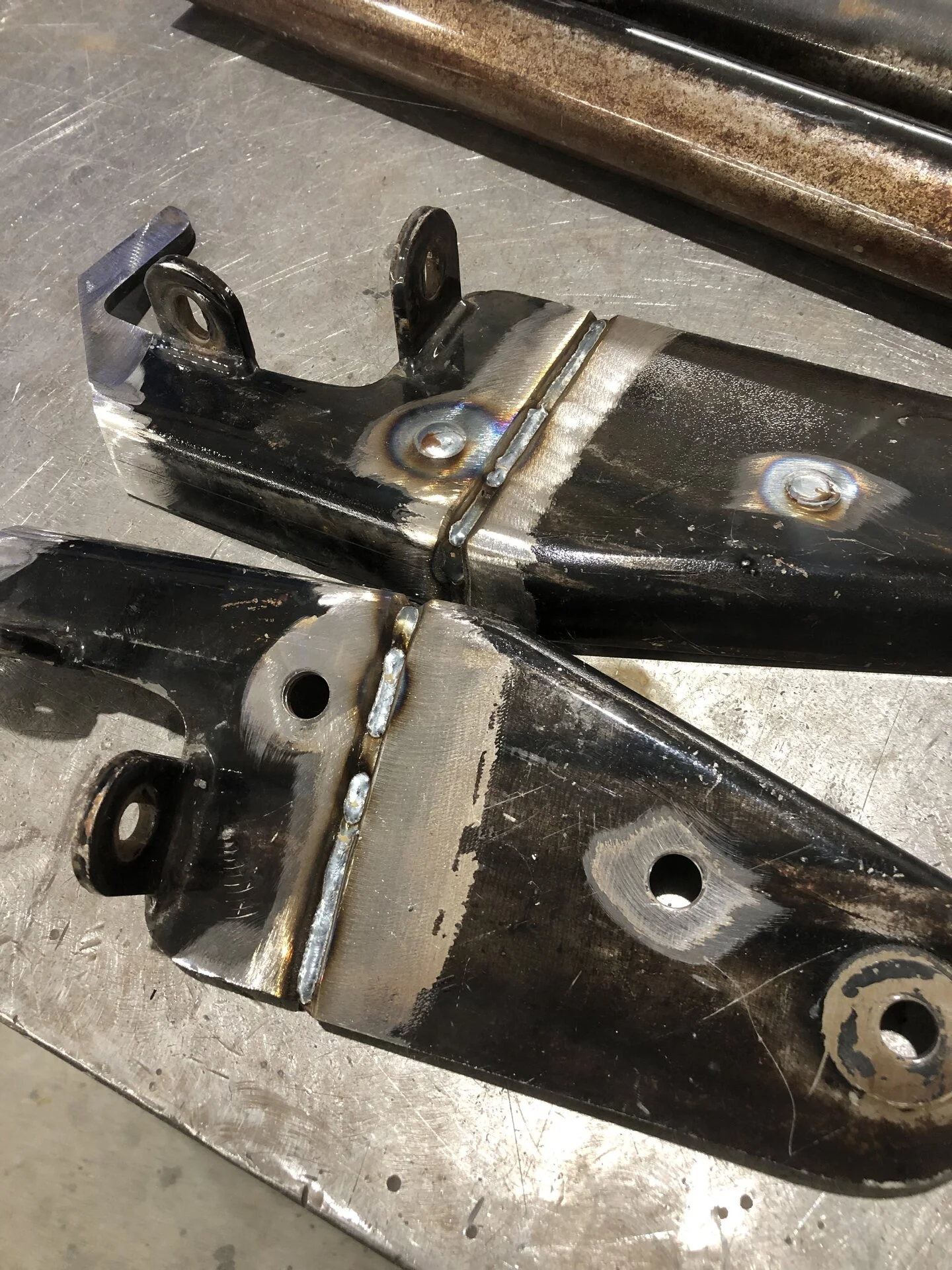

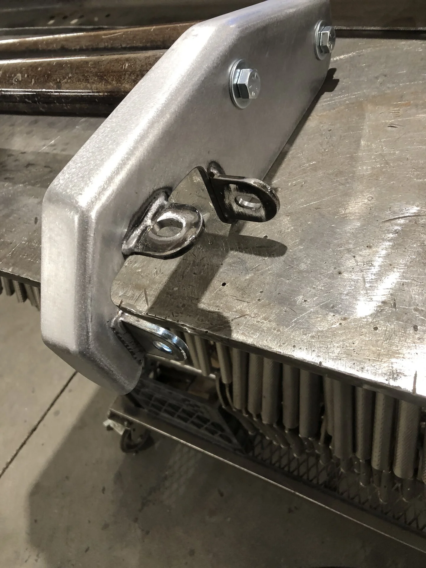

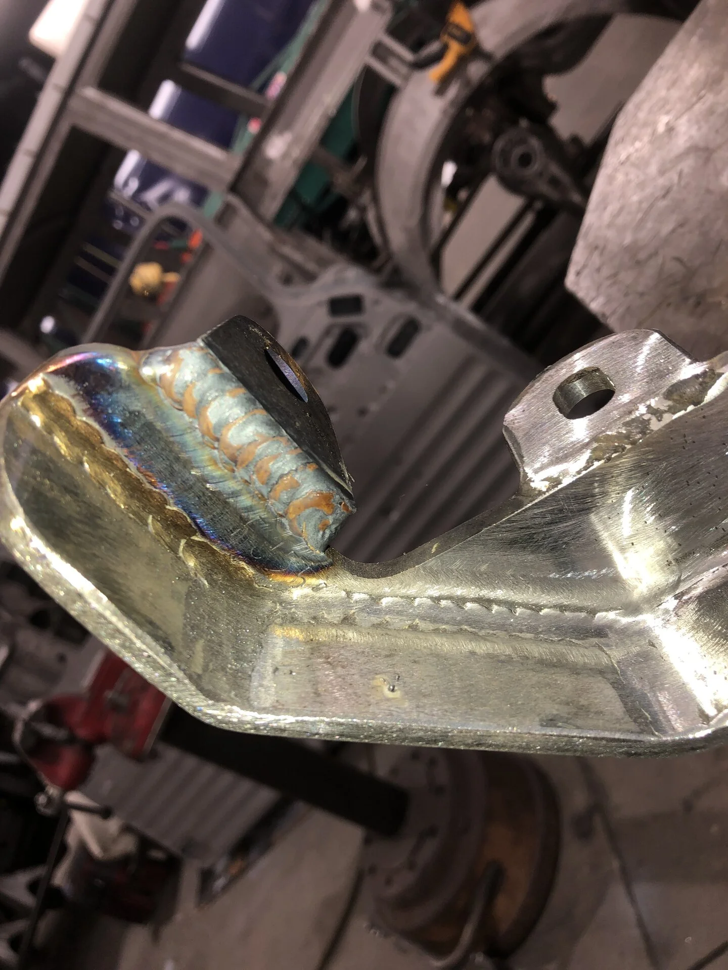

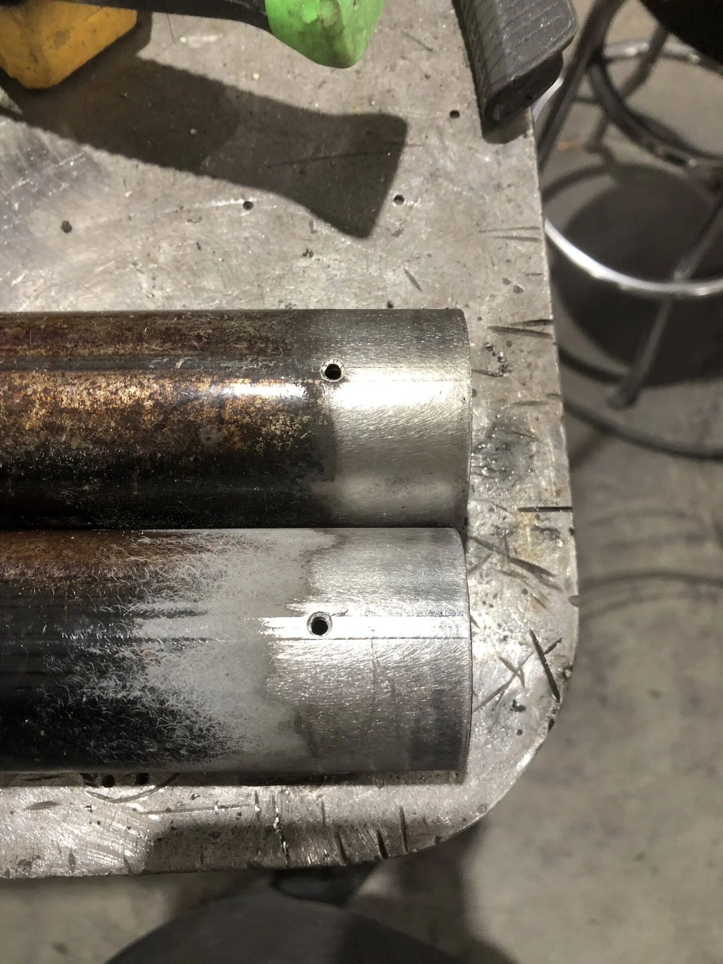

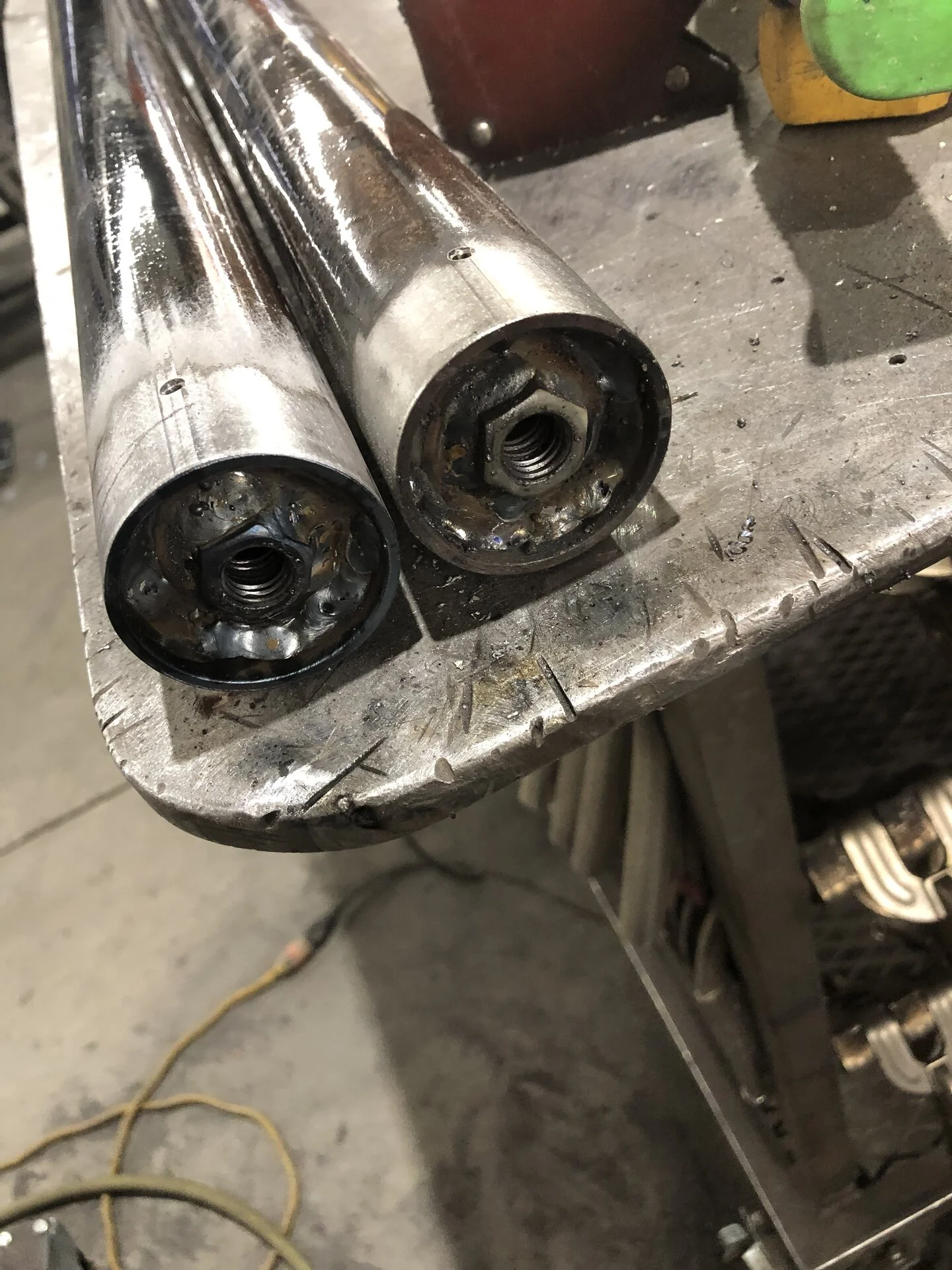

Relocated the lower tube up, added nuts on the tube mounts for more thickness and drain holes.

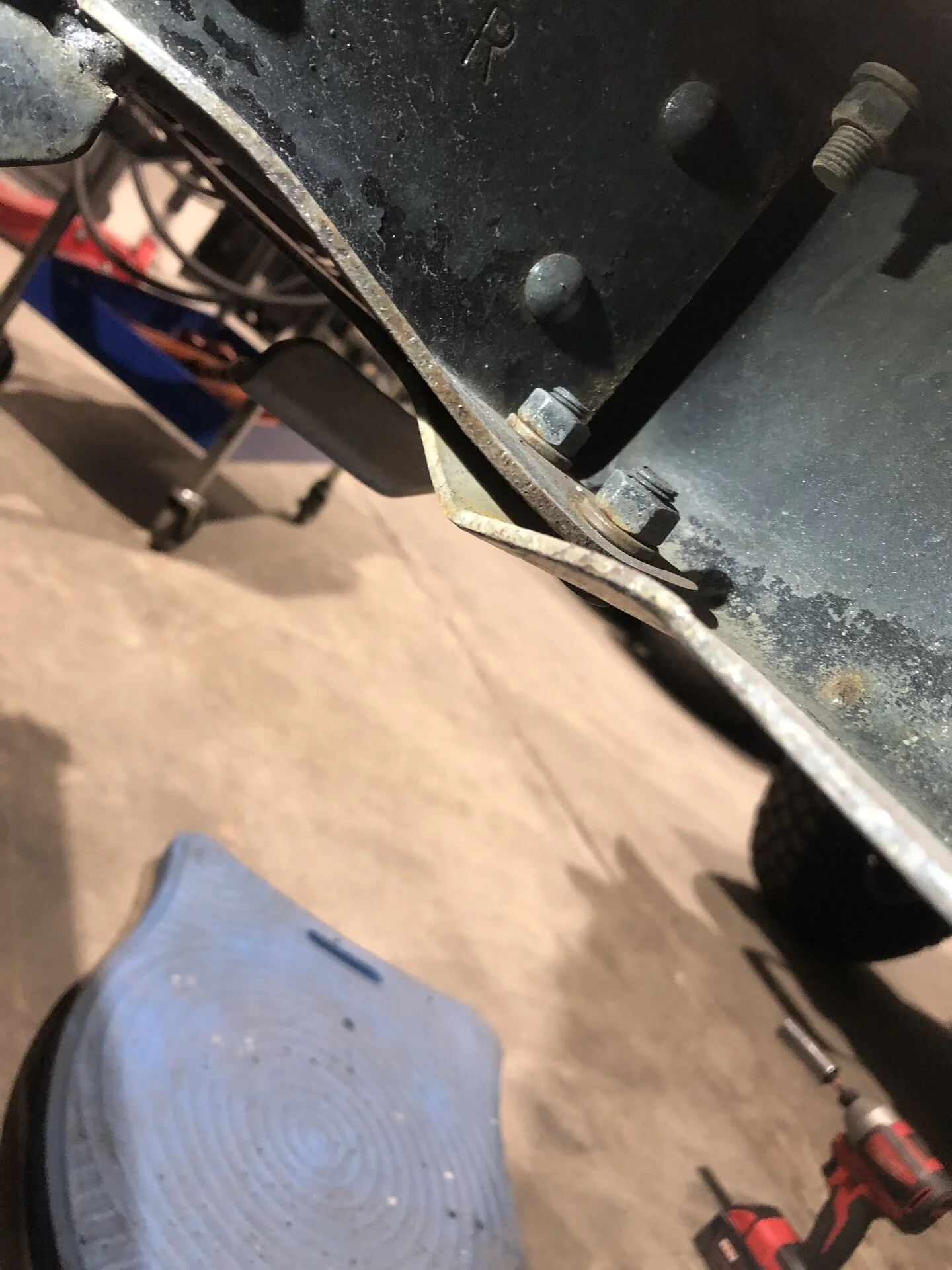

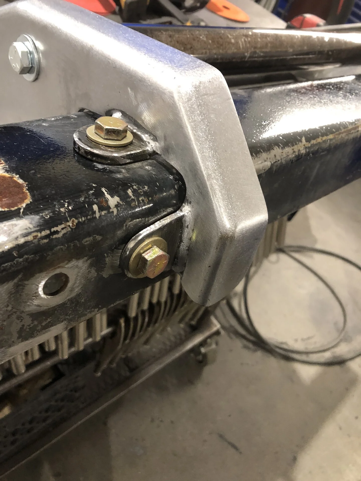

Lower where it wraps under will get a 3rd tab to attach to the bottom of the bumper.
Ditched the rubber pads on it. Pass side of the bumper will get portapowered back into place. Extra holes in bumper filled.

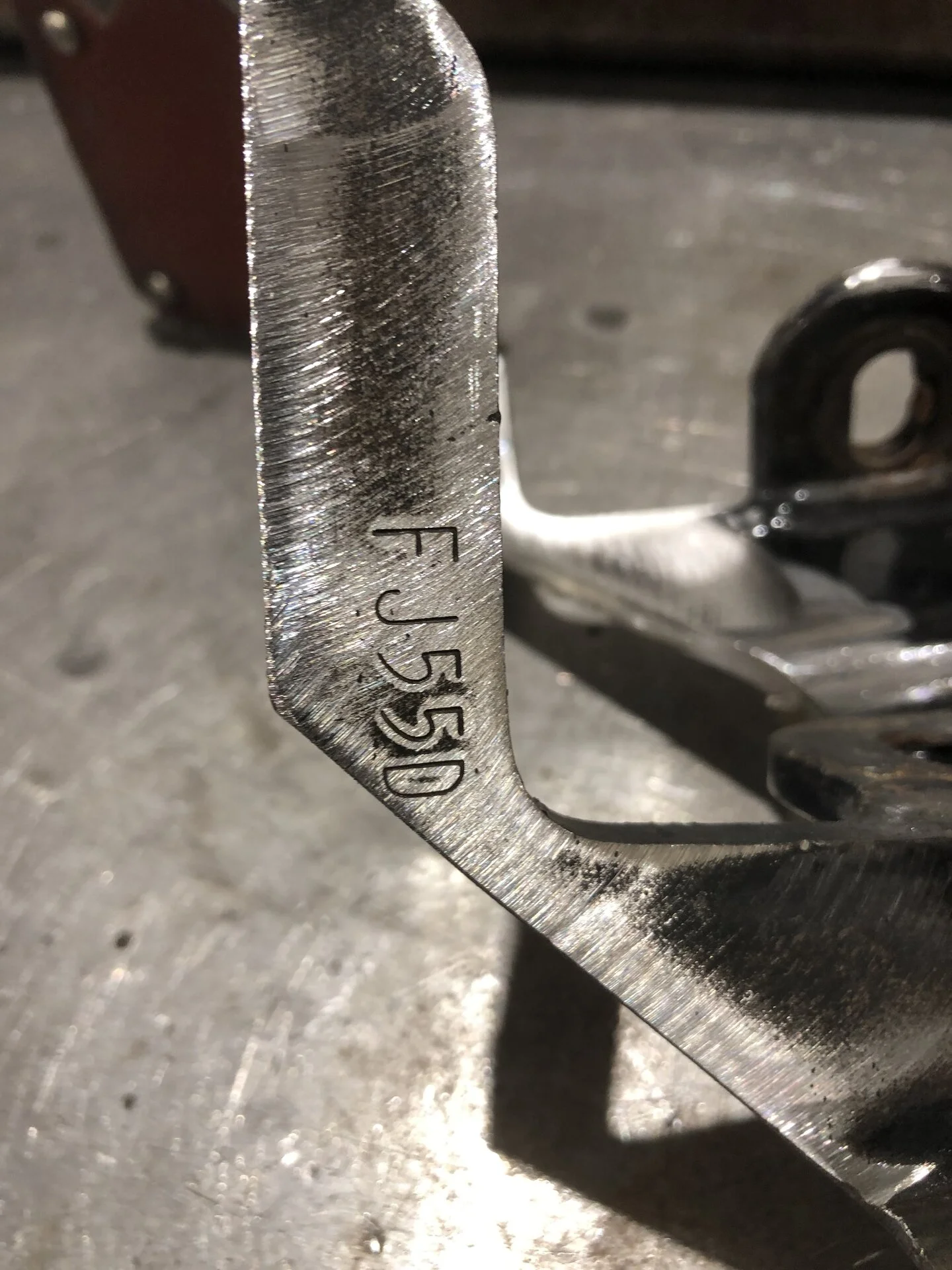

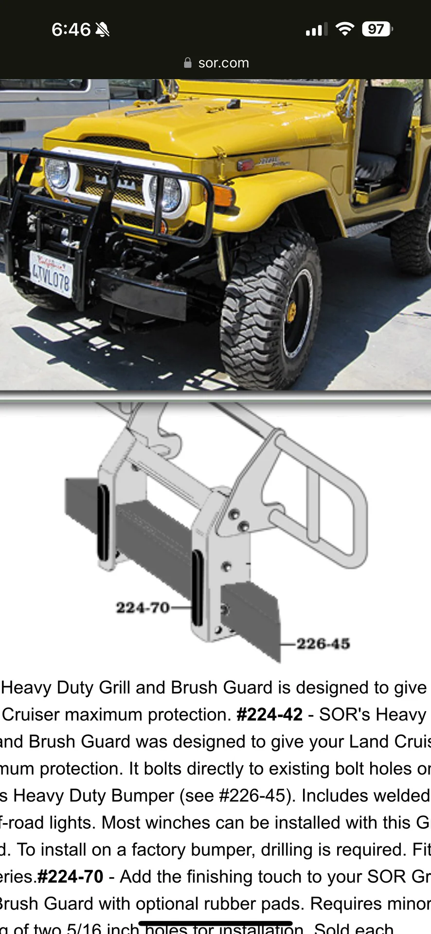

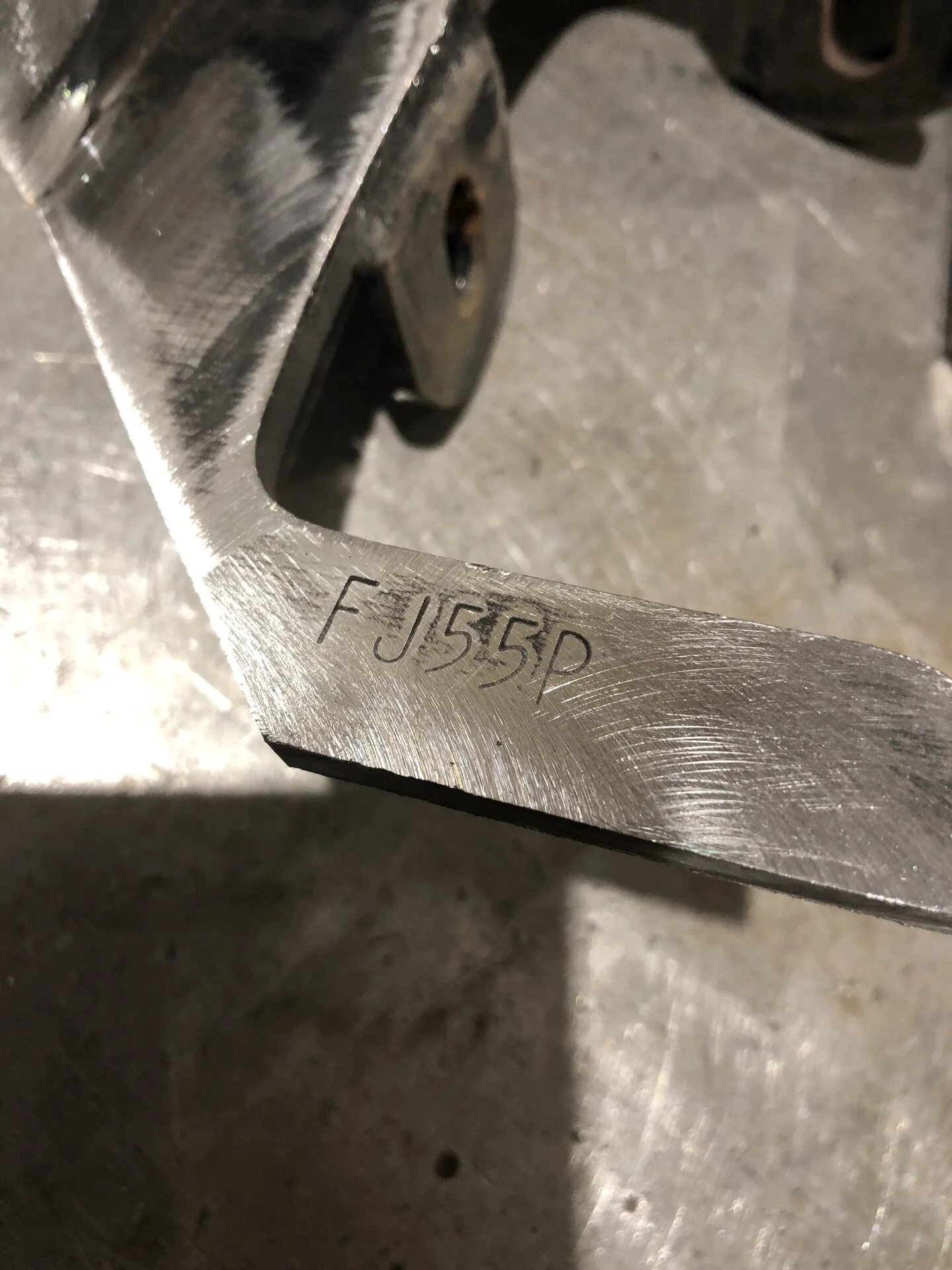

The piece had some stampings. SOR used to make a similar piece with a huge guard for the 40-series, maybe they made them for 55s, too.(?)
