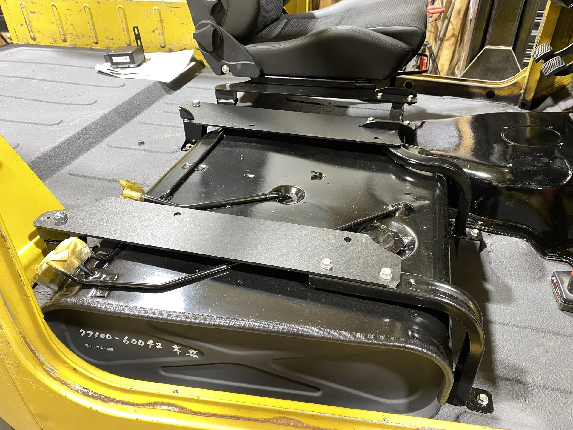

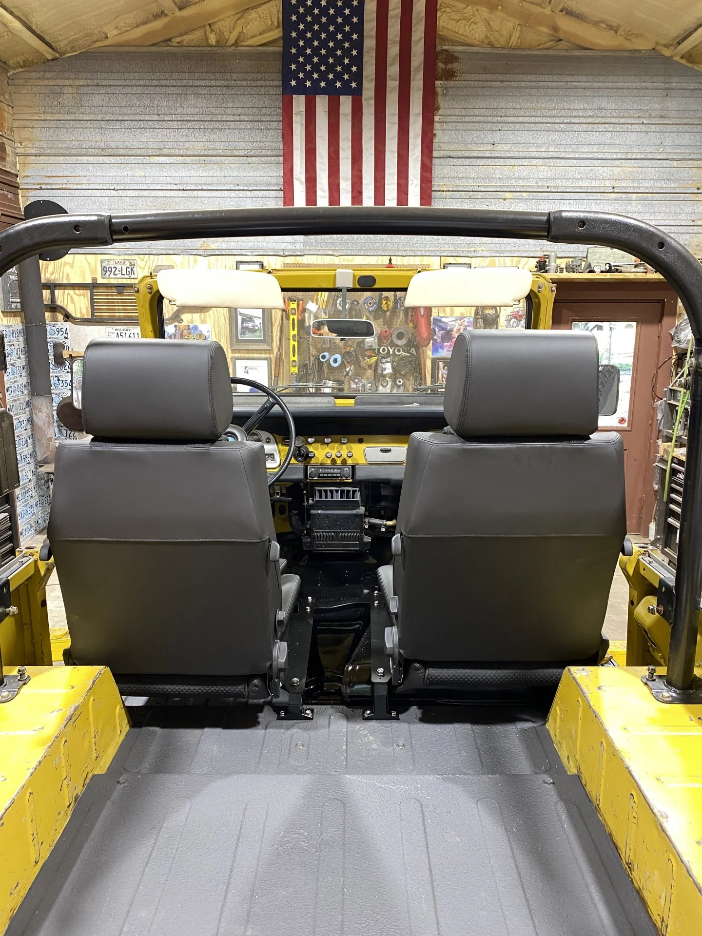

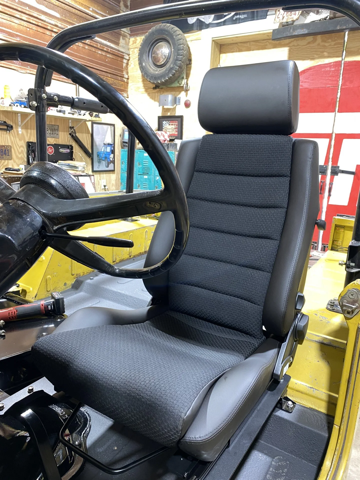

I think maybe if your old seats had had still had the OEM gray and the headrests to make Garth happy I don’t think I would have thought about the seats but now I’m super glad we did these.

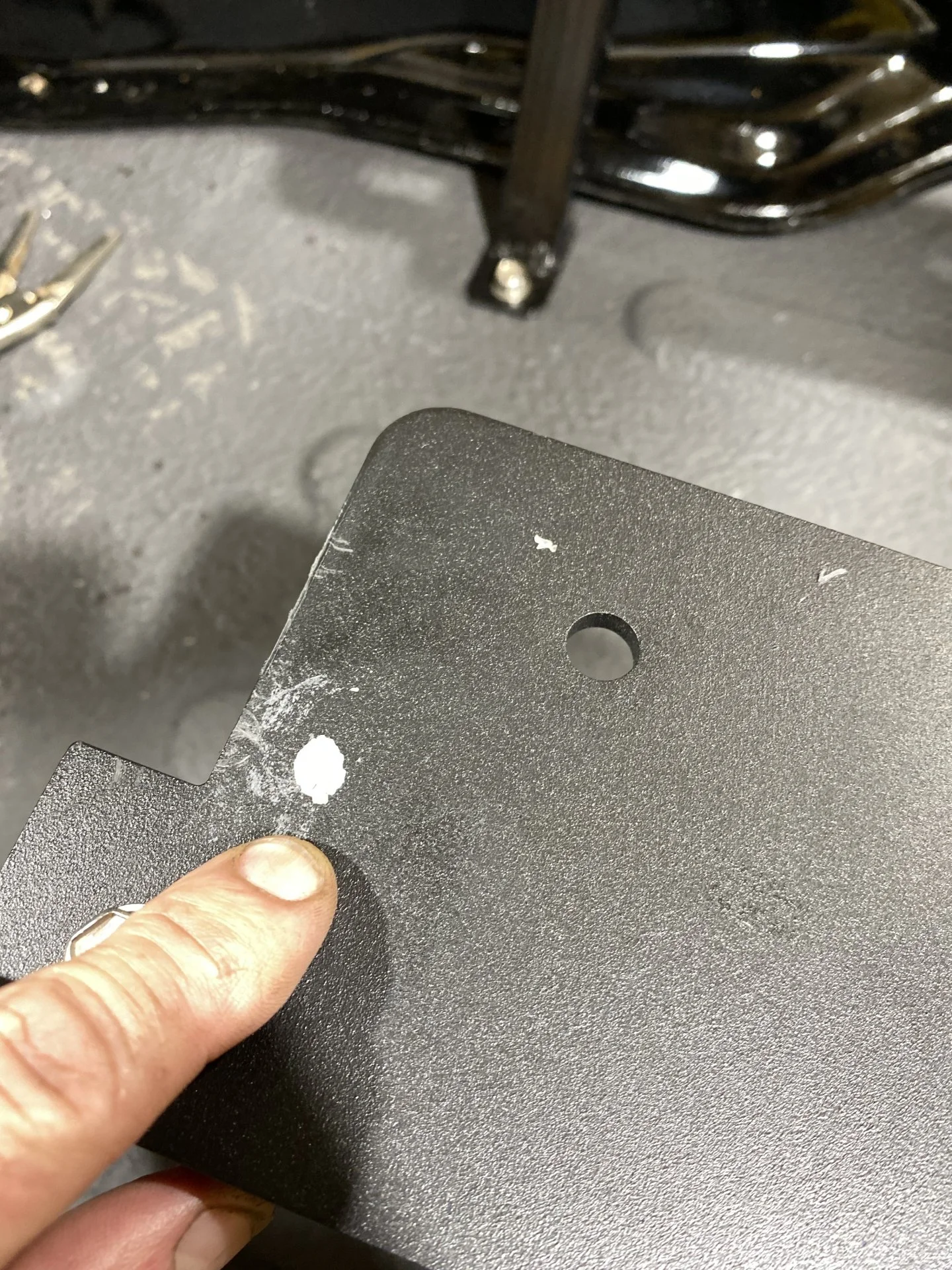

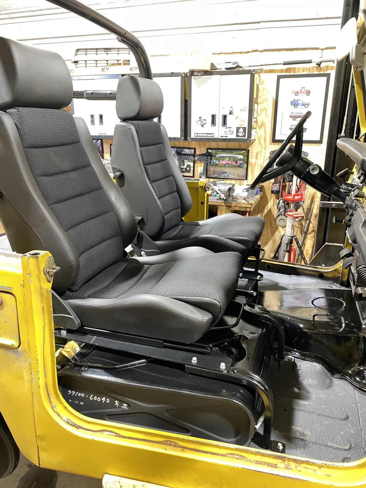

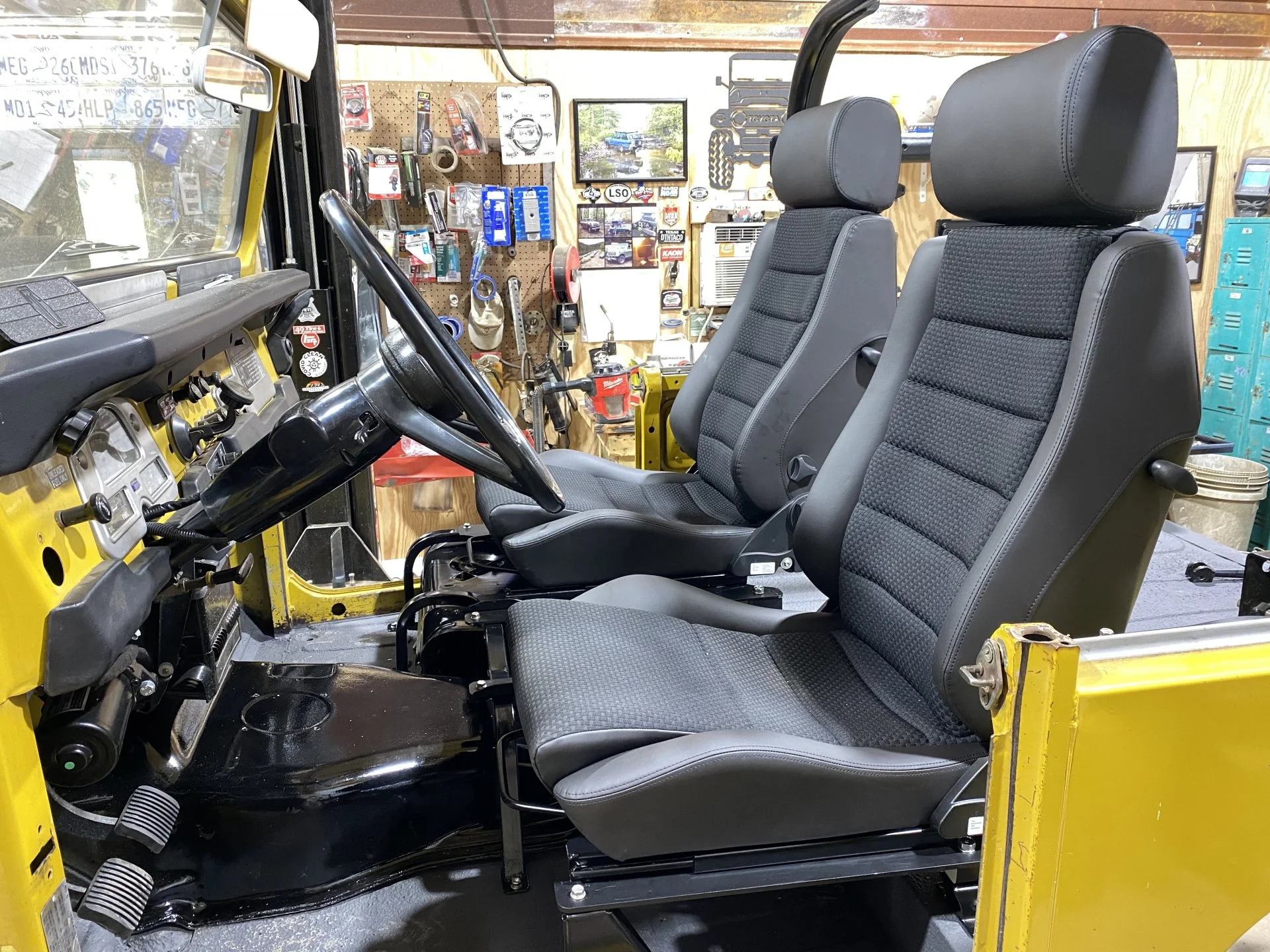

A little more to the story. Cool Cruisers came up with these brackets to work with their Bestop seats and normally only sell these with their seats. I’ve been a long loyal customer and the owner, Stephen was kind enough to let me have a set of these plates.
Yeah we could have had a sub frame made but I love these beautifully powdered OEM brackets.
I did have to drill holes for the Scheelmann slides. Not a big deal. I got one done and I’m pooped. I’ll get the other in tomorrow
Id guesstimate these give you as much leg room as the bracket flip/tall guy mod you can do. These seats are SUPER pimp

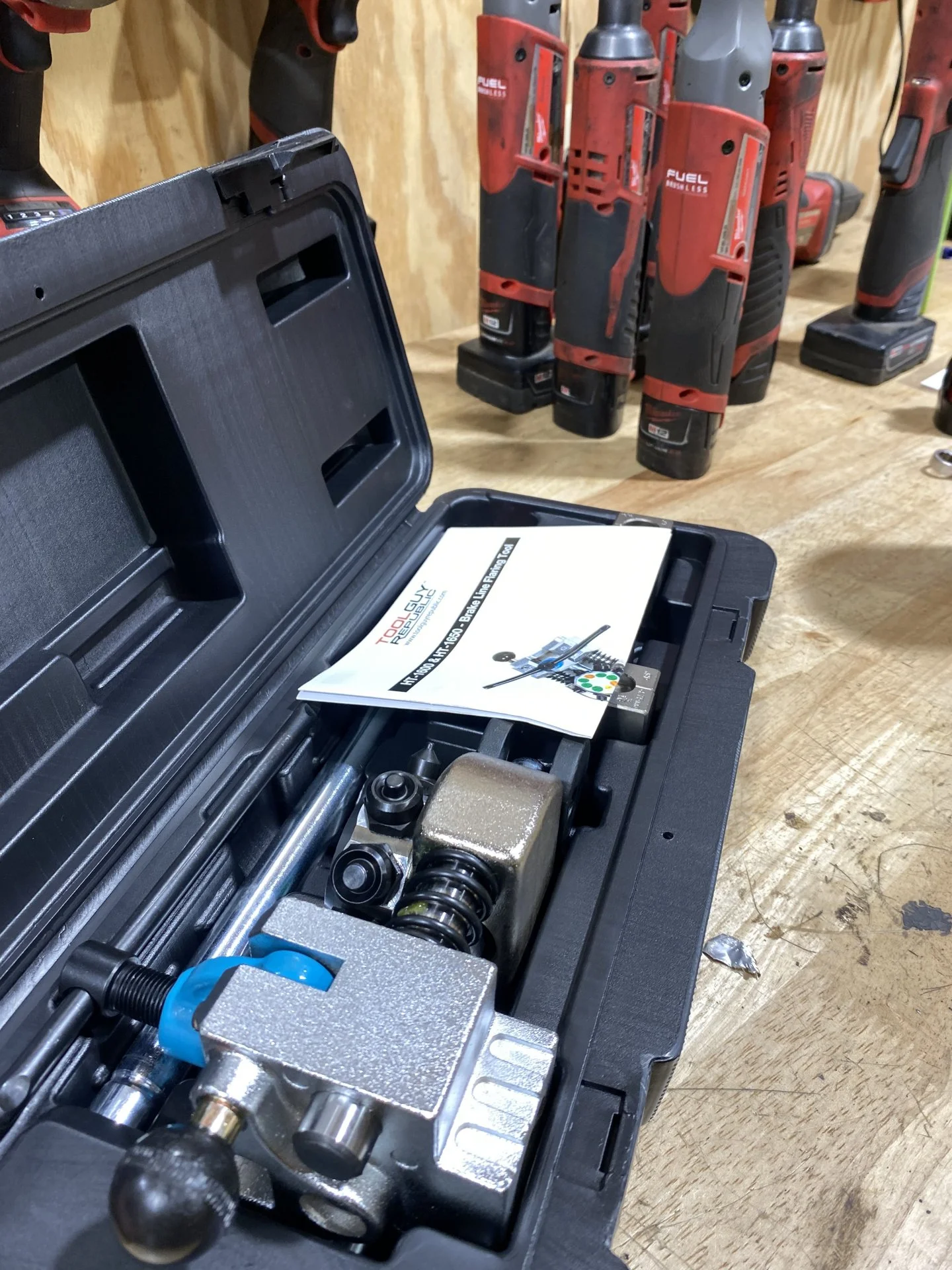

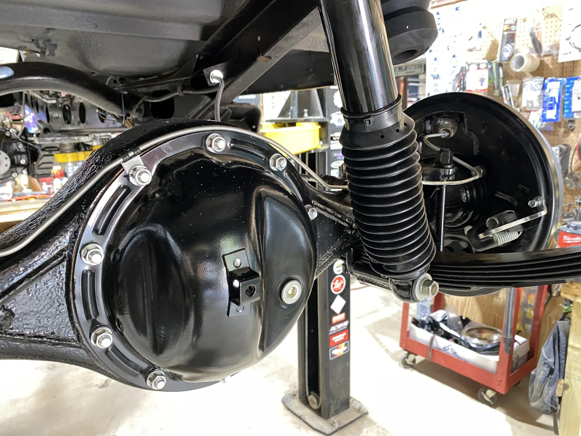

Fun stuff like bending and building brake lines. @FJ60Cam told me to buy this fancy bend/flare tool but I need to figure that thing out on my time not John’s so I used my old manual tool
Done ….

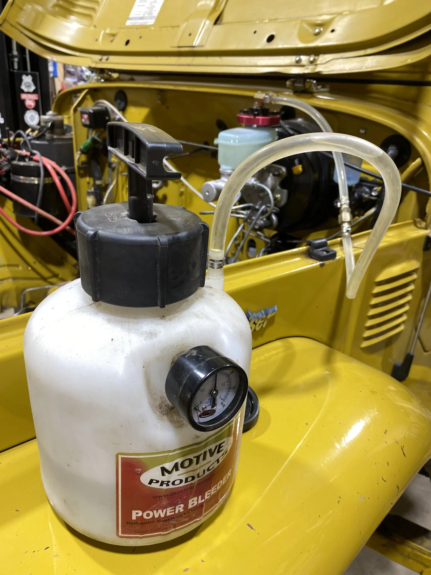

If you don’t have one of these Motive bleeders then you need to go to Amazon now and get one.
The best feeling ever is to pump this thing up to 15 PSI and raise the Cruiser and have zero leaks in a fully redone brake system on the first shot.

That brake line flare tool takes about 1 minute to figure out and i bet you’ll find is one of the best tool purchases you've made

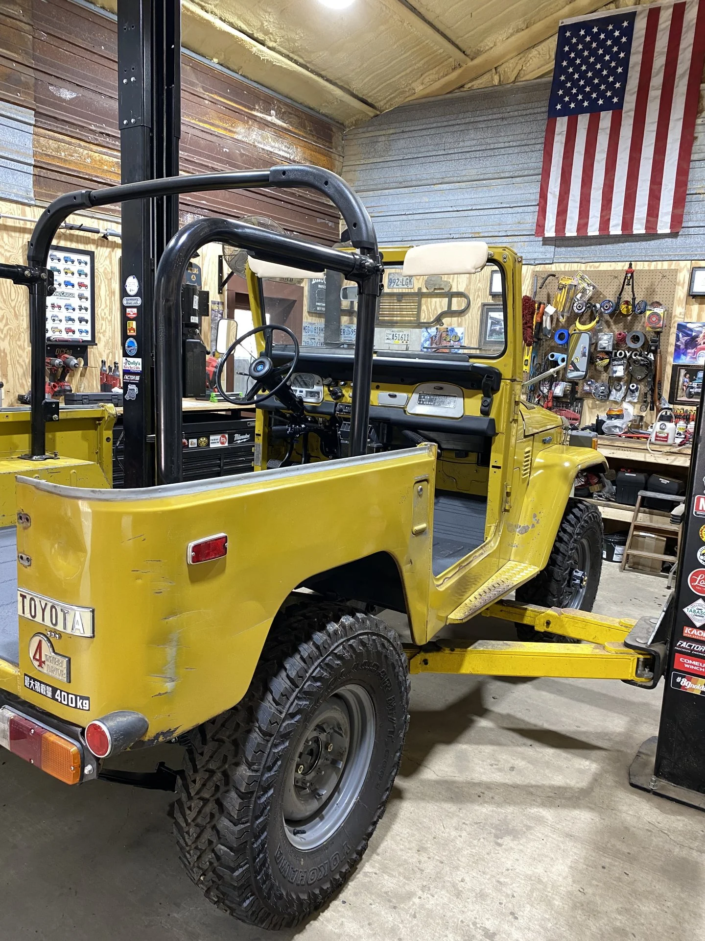

What’s the 400kg sticker about?
