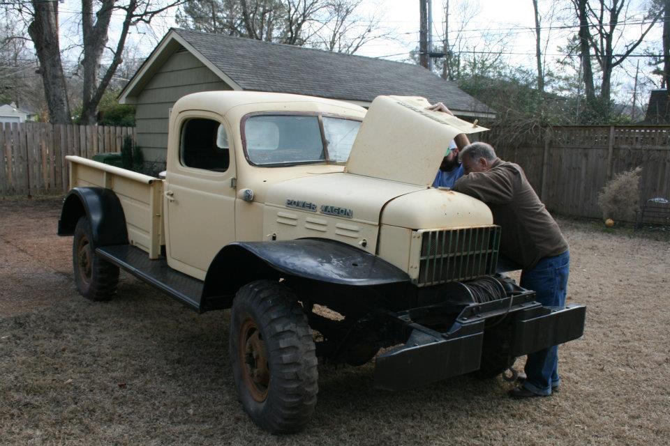

The day we picked up the Power Wagon
The day I sold the Power Wagon

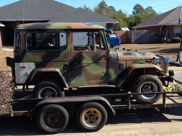

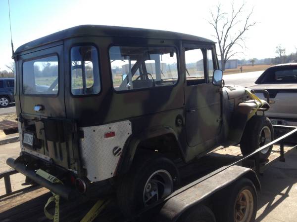

Sounds like a winner to me... So, I am buying this camo FJ40 sight unseen. First vehicle I’ve ever purchased where I didn’t actually see it in person, which to me is a little scary. Nevertheless, I took the plunge and hoped for the best and prepared for the worse. Thankfully I have an understanding wife who is supportive all my projects…My buddy helps me arrange for shipping from the panhandle of Florida to North Alabama (Huntsville).
January 10th

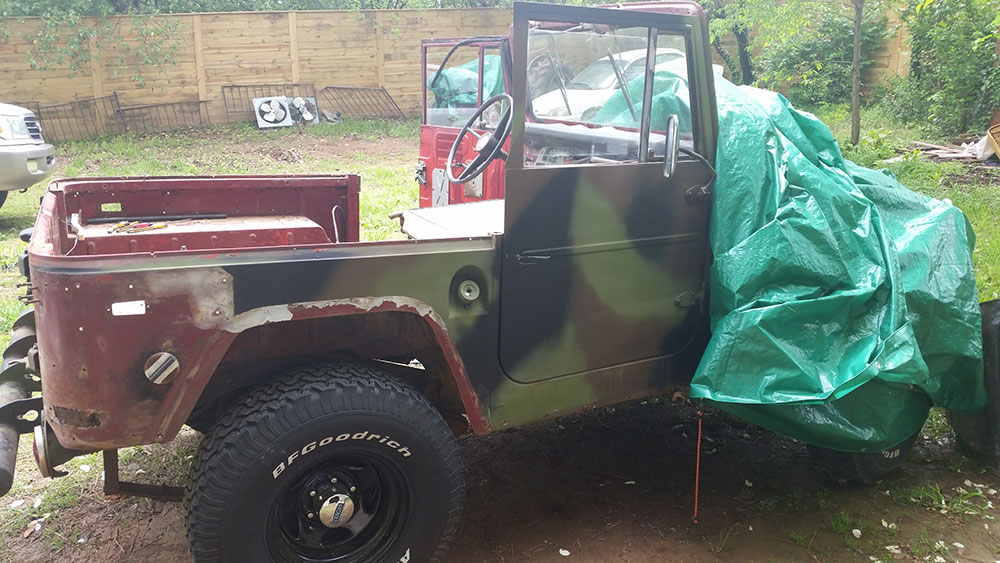

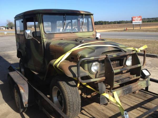

FJ40 d-day (delivery day) arrives and I get to see it in person, the bones to the project I’ve wanted to start for some time. She arrives after dark so I’m not getting a good picture of the truck other than with headlights and a flashlight. No brakes, no clutch, no battery to test if it will turnover although my buddy Tommy had already seen/heard the engine running in person so I knew it would.
January 11th

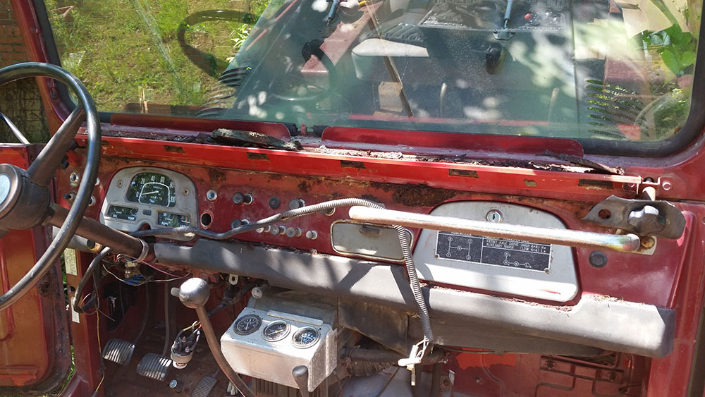

Daybreak and I am already up and ready to give a full inspection of my new 40 project. Ok, let’s look at the frame, umm, yes there is rust. Not a ton, but there’s enough… Let’s look in the engine bay umm, yes there is sand, lots of sand in every little piece and more rust. There is some rust in the back and mainly between the tub and top and of course around the drip rail. With a fast 5 min inspection and I already know we will need the following. 1) Battery 2) Clutch 3) Brakes 4) Wheels/Tires 5) Side marker signals 6) Front apron side markers 7) Running boards 8) Front seats 9) Rear Jump seats 10) Roll bar. After inspecting the data plates in the driver side door jam, it reads a build date of Oct 1971 but the VIN ends with 72 and the original owners manual in the glove box is showing 1972. In addition, the data plate under the hood and on the frame also read that the ’71 I purchased is actually evolving into a ’72, no biggie to me. One thing that should have given it away to me was the hood was not split like the most ’71 models. Again, the year did not matter to me. Upon further inspection I see more rust than I had originally planned for, but nothing that can’t be fixed. I am a little anxious to look under those rear diamond plate corner pieces to see just how bad those areas might be and what they might be hiding. A couple of other items I noted, the rear jumps were missing, in place of them was a Con Ferr bench seat along with a full family roll cage. I’ll plan on removing both of those items and probably selling on MUD or Craigslist.

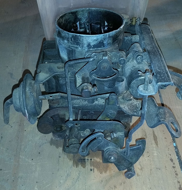

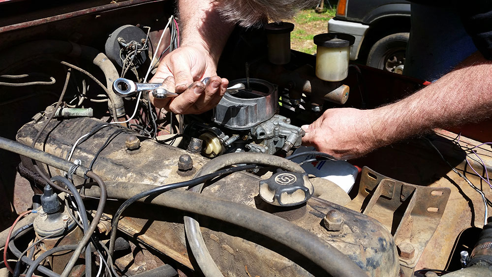

Carb has been rebuilt, although it seems like we are missing a few items from the carb it’s back together at this point and rebuilt. We’ll see how she runs… again wx is holding us back. When we have some weather above freezing temps and not snowing we’ll be able to get more accomplished.

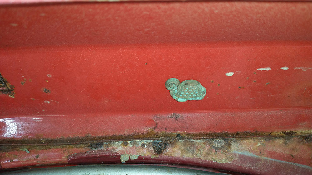

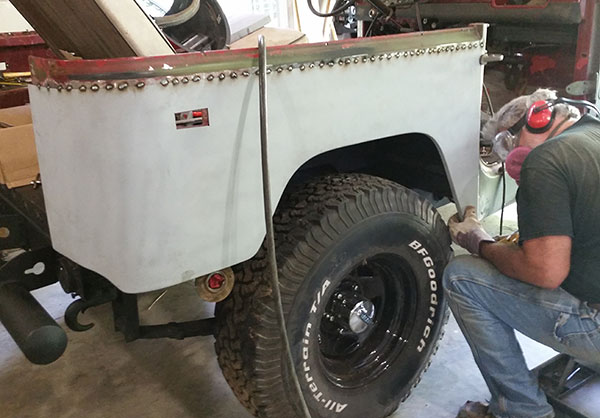

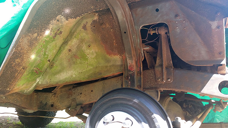

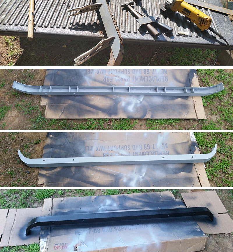

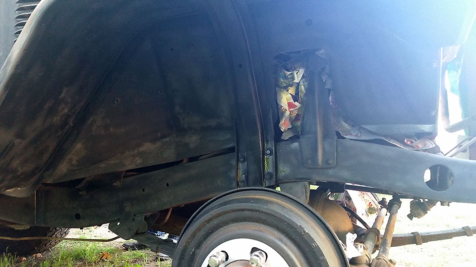

I remove the diamond plate corners and the fender flares to see what might be hiding from us. Surprisingly, there is rust, but it’s not as bad as I thought it might be. We do have a couple of areas that will need our attention but for the most part it’s solid and we have something to work with. Along with filling a good number of holes left from where they attached the diamond plate corners. Another surprise we notice is that the PO added an extra fuel tank to the back of the 40 and they decided to use nice rubber garden-type hose (instead of steel lines) for the gas line. So, another must do is to change out the rubber fuel hose for steel fuel lines. I also should mention, for now I have decided to keep the fuel tank located in the back as I like the location a little better than under the seat of the passenger. I’m still toying with the idea of keeping both tanks but at this moment I’m leaning to keeping only the tank in the rear but that could change.

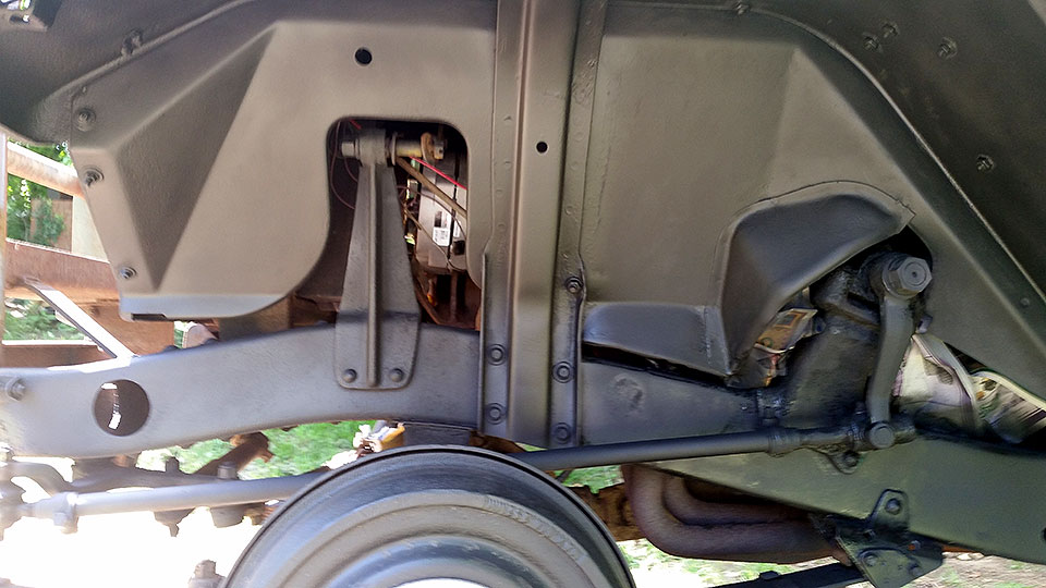

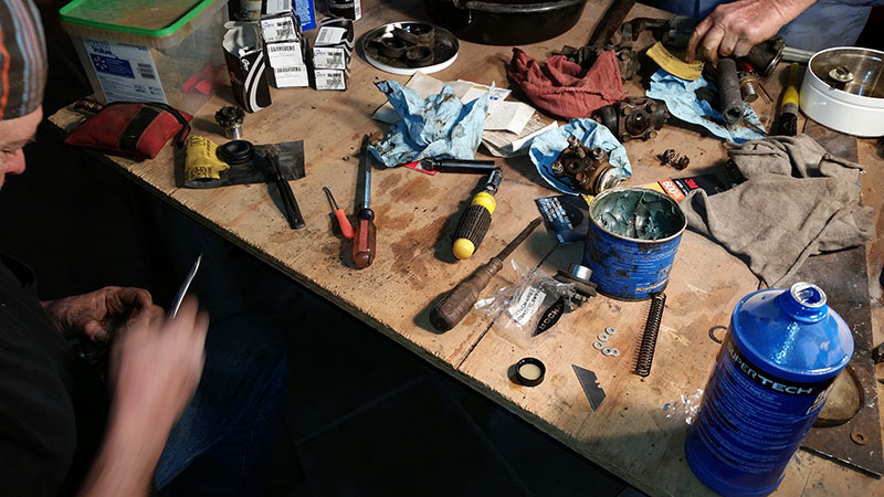

Finally have had a few decent days of weather and we have been able to get the newly rebuilt brake cylinders installed, new master cylinder installed, new brake shoes installed, and brakes bled. Brakes are MUCH better, not 100% but they are really pretty good. They are a little soft so we think there might still be some air in the lines and will plan on bleeding again. Also, we notice the brake booster has some hissing sounds when depressing the brake pedal. Not sure if it needs rebuilding but need to keep an eye on it to be certain.

The Aisan is another story altogether. As mentioned previously, we rebuilt the carb last month, but there seems to be a couple of parts missing based on some exploded views we have reviewed online. We are not exactly sure what the PO might have done or not done but something is not quite right. It never wants to run with the choke all the way in, backfires like crazy and idles pretty rough. Even when making the adjustments nothing seems to help. Scratching our head on the carb, nothing seems to help or change no matter how much we adjust.

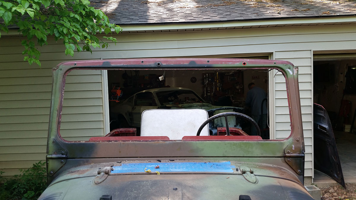

We removed hard top, which was quite a job with two men and no lift. We’re already talking about an easier way to do this and not be so cumbersome to remove the top. But we were able to get it setup on a stand and now I can get to it a little easier and have better access when I start working on stripping the top down to repair and repaint.

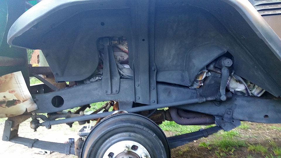

I removed the old seats, original gas tank under the passenger side and began cleaning the tub. There was so much sand in this truck it’s like it live on a sand dune for 20+ years. There are some additional rust areas we need addressing, some small areas in the tub and a small area on the tranny hump. I’ve also got to start thinking about tackling that mess of a wiring harness.

Even after the Aisan carb rebuild the old girl still does not want to run smoothly. I have read numerous posts from several folks who swear by the Aisan stock carbs, Trollholes and Webers. We have fought and fought with this carb and have not had much luck tuning it. I’ve just about given up on the Aisan rebuild. I ran across a fellow MUDDER selling a Weber from one of his 40s. Interestingly enough he lives in Steamboat Springs where we just visited a few weeks earlier. I decided to buy the Weber and we hope to see if we can get her to run a little better without coughing and backfiring.

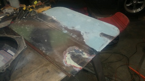

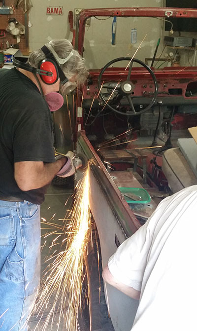

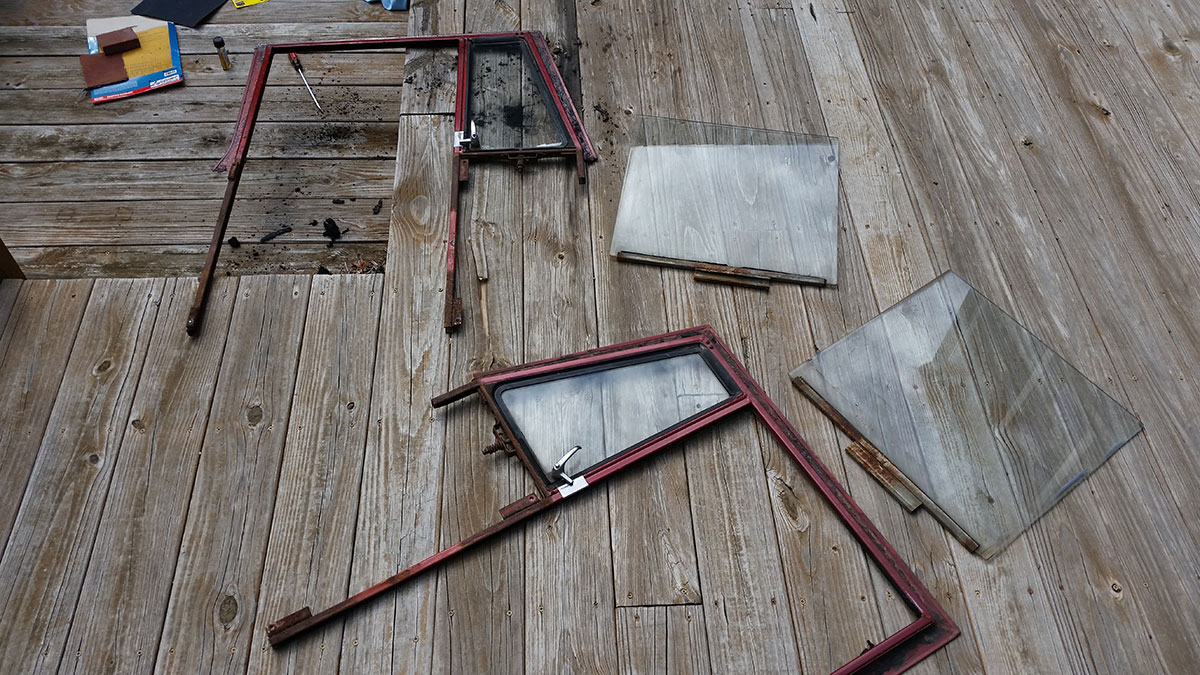

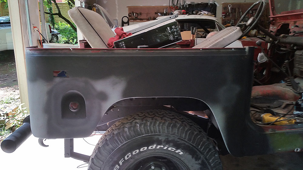

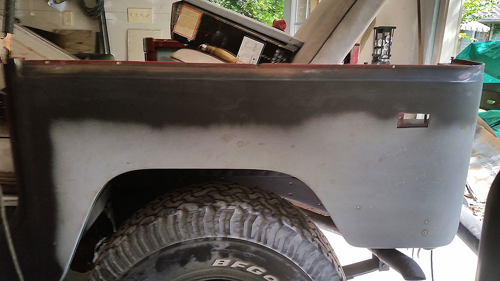

I’ve decided to start working on the doors until the Weber arrives. They have some rust we need to address. In addition, they have a couple of broken areas that need welding and repairing. Thankfully my dad and granddad are both excellent welders. My task for the day is to remove the top halves of the doors so we can get to the areas that need welding and I can focus on cleaning up the top halves of each door.
