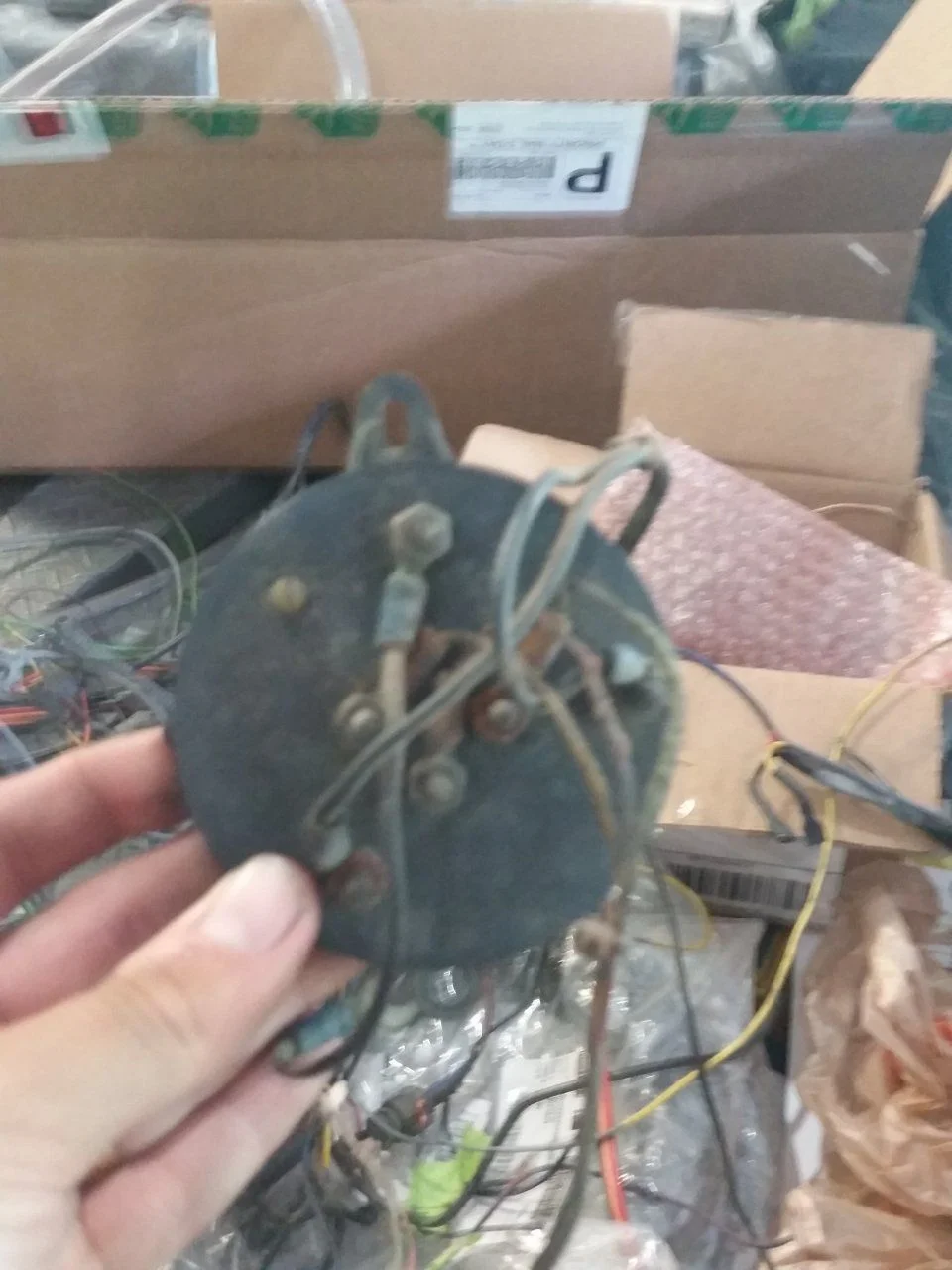

There is one part that we are not sure if it's original or what it goes to. It was mounted to the top of the firewall on the engine bay side. It was no longer plugged to anything. Pic attached. Any ideas on what it is?

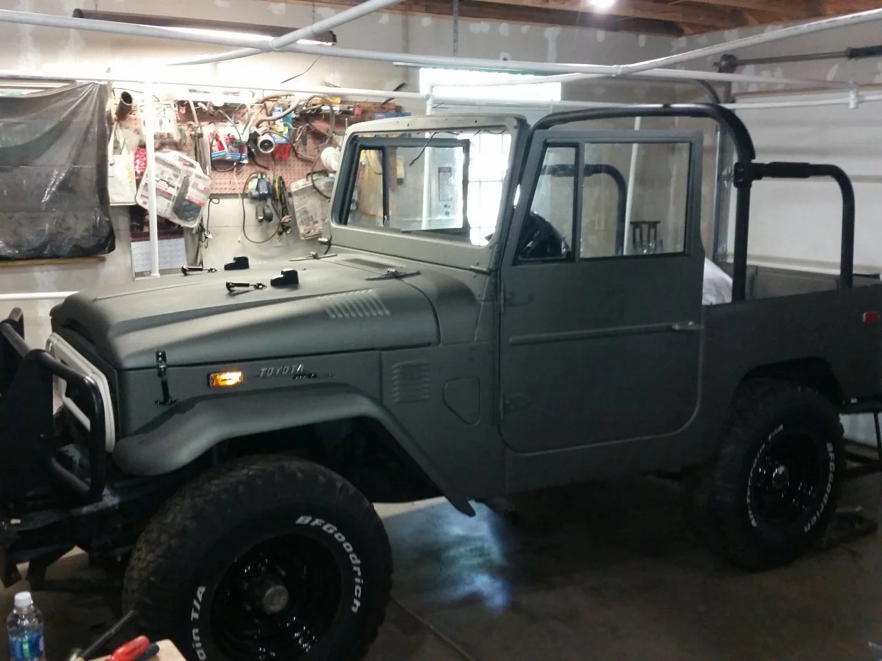

We continue to make good progress with the electrical, door assembly and roll bar....Seats (front and jumps) are being reupholstered and should have those next week. We hope to be on the road in another week or two.

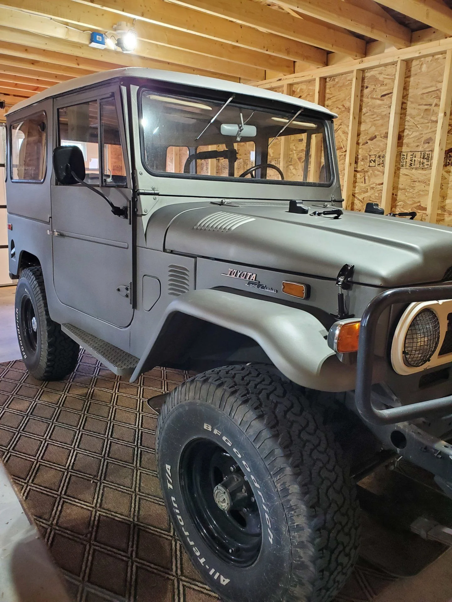

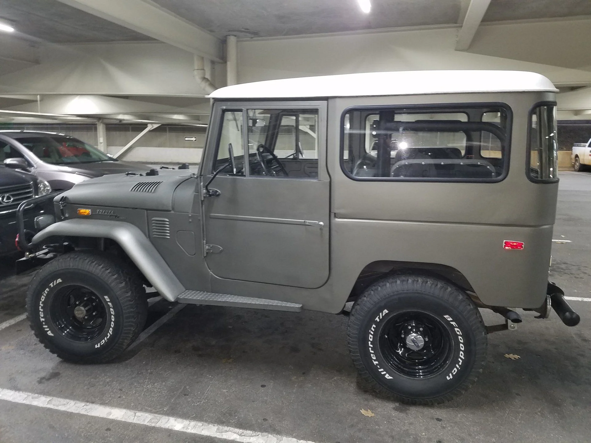

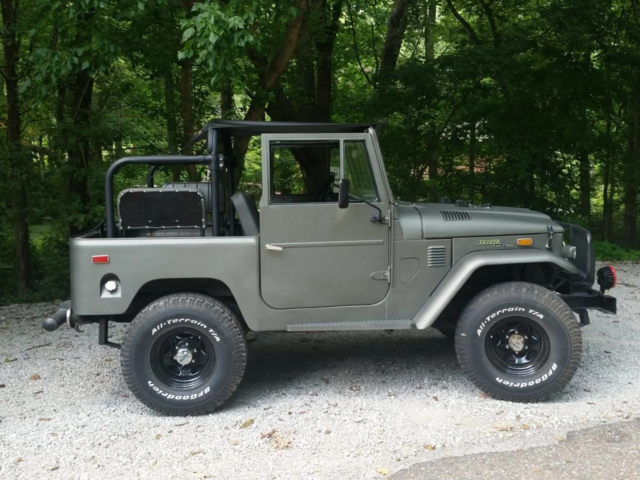

We got our sets back from the local upholstery shop and love how they turned out. We buttoned up a few other things this week and finished the electrical issues (we think). So, after a ton of work over the past 18 months we took the FJ40 for a few miles and several trips around the neighborhood. We have a couple of things to work out, but overall we are very pleased with everything. We have not started work on the top. We'll do that in the fall when we have some cooler temps and less humidity. haha

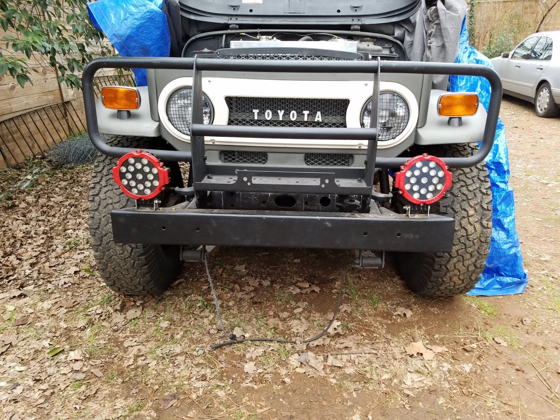

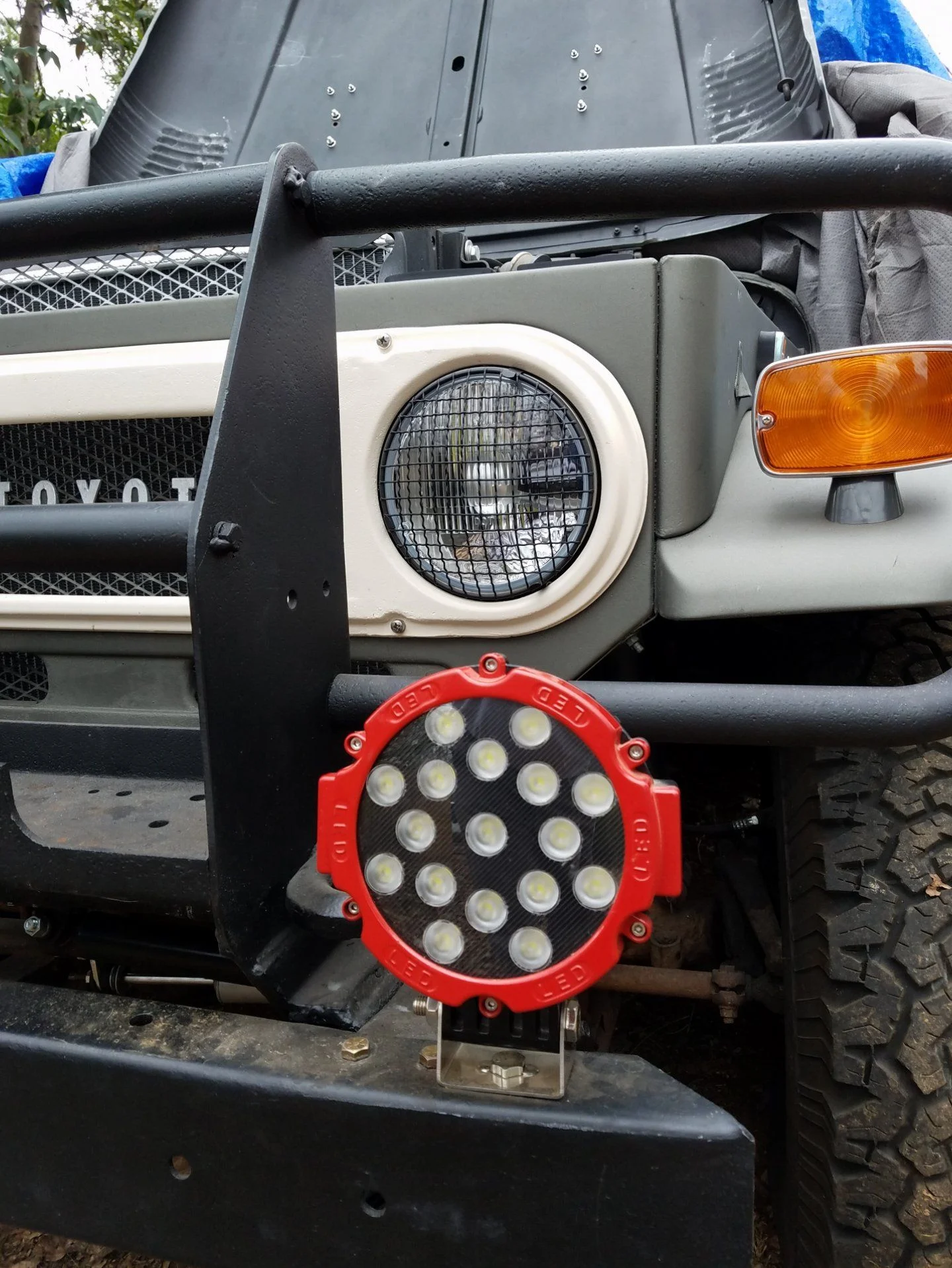

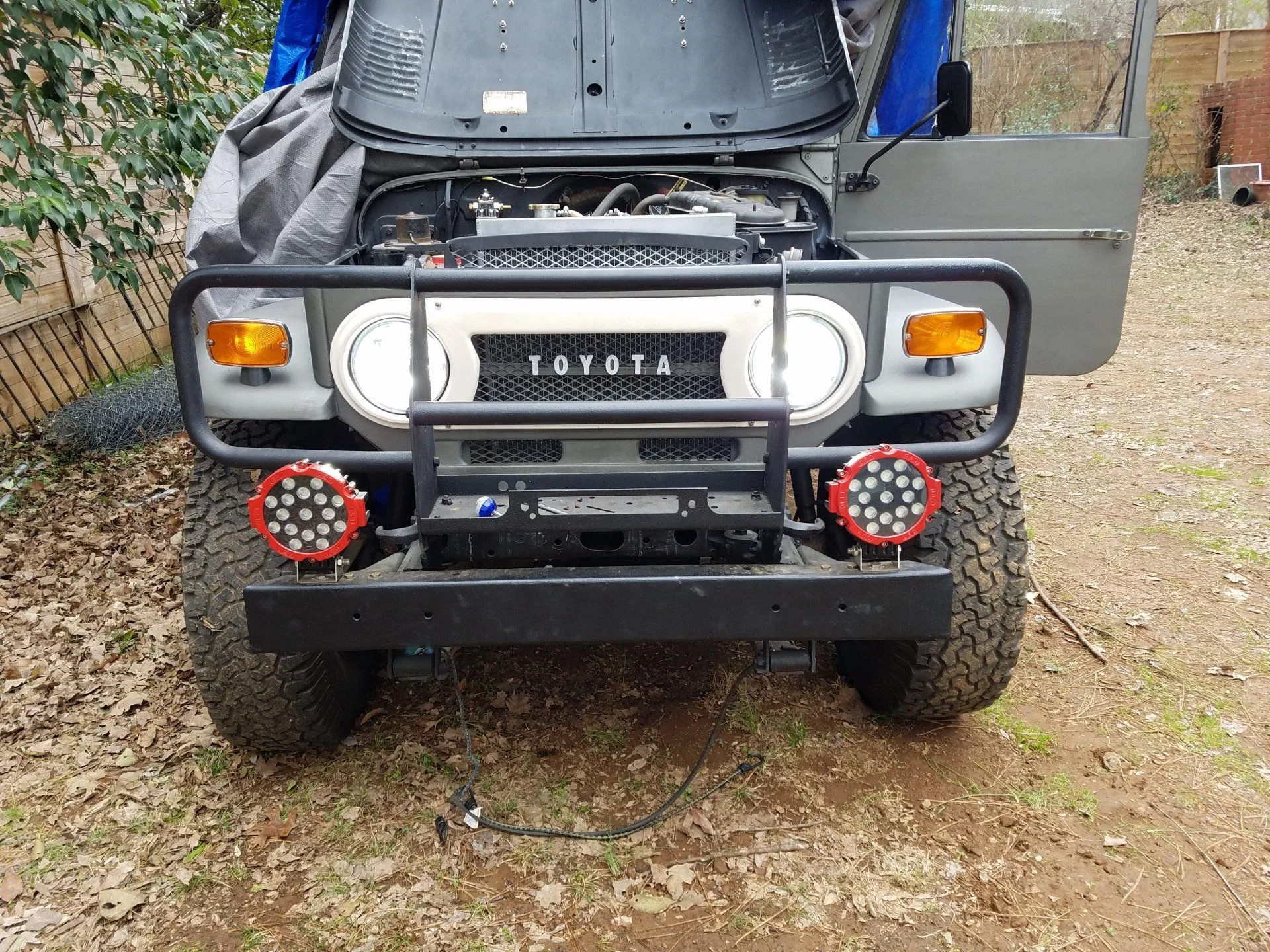

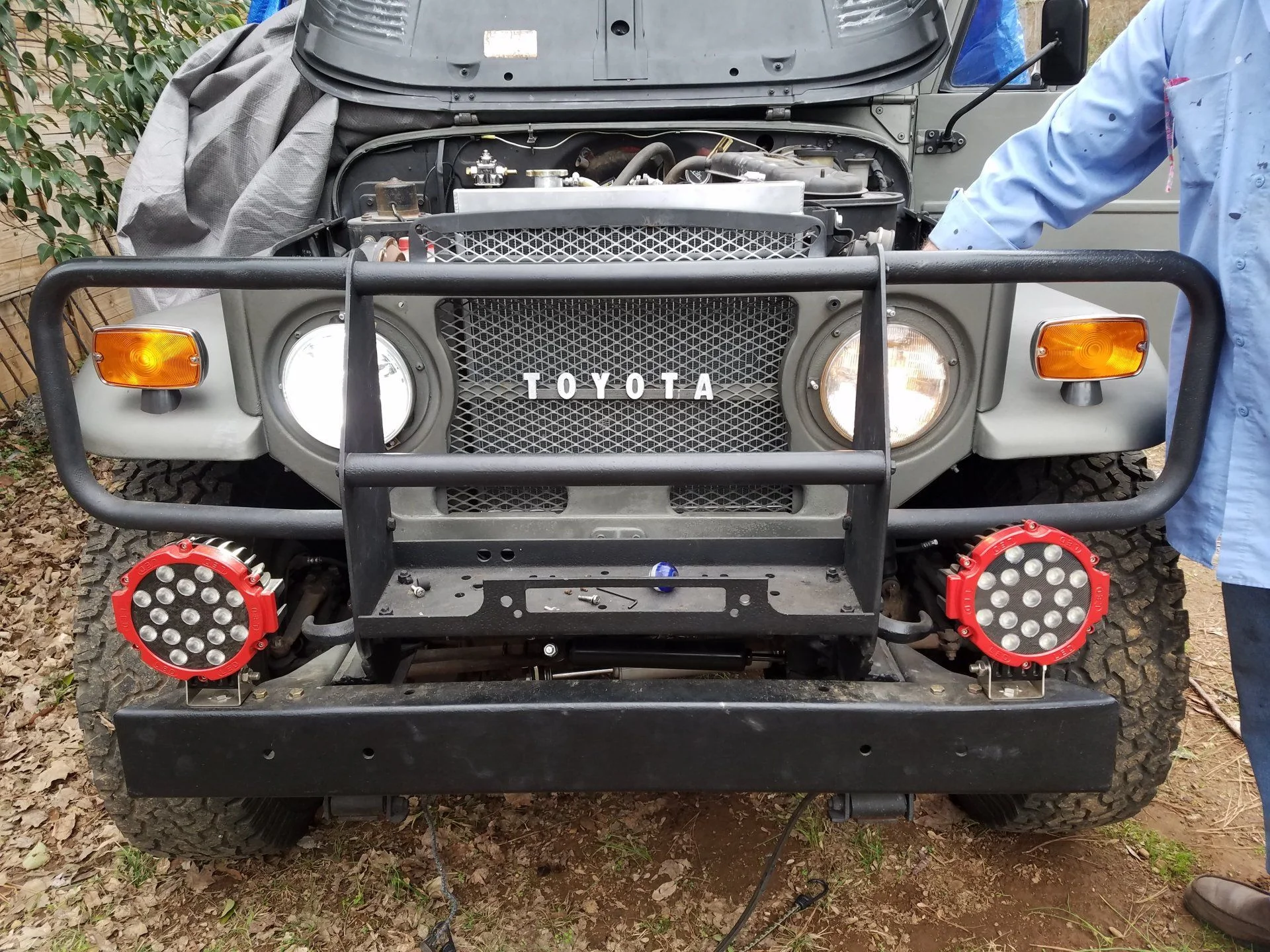

We had previously changed all of the lights to LED except the headlights. So, we tackled that conversion over the weekend.
Old original bulb on the right new LED on the left
both new LEDs installed and turned on
Also added stone guards after the LEDs were installed.

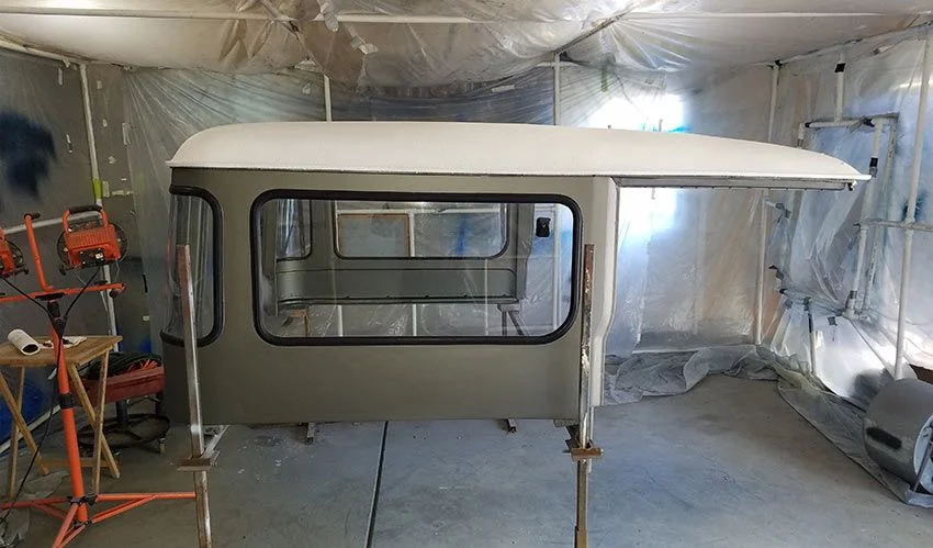

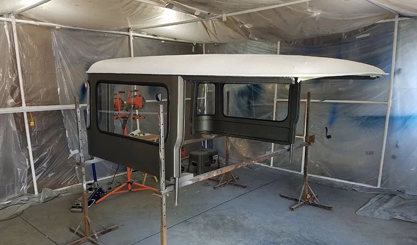

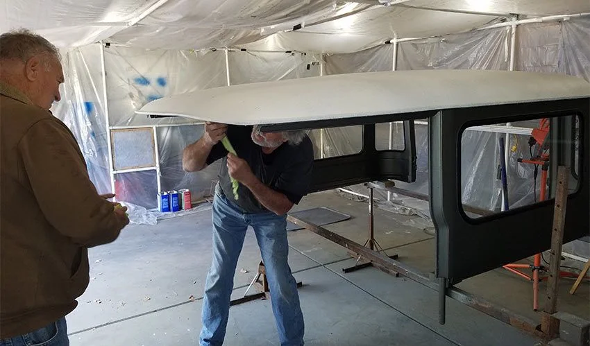

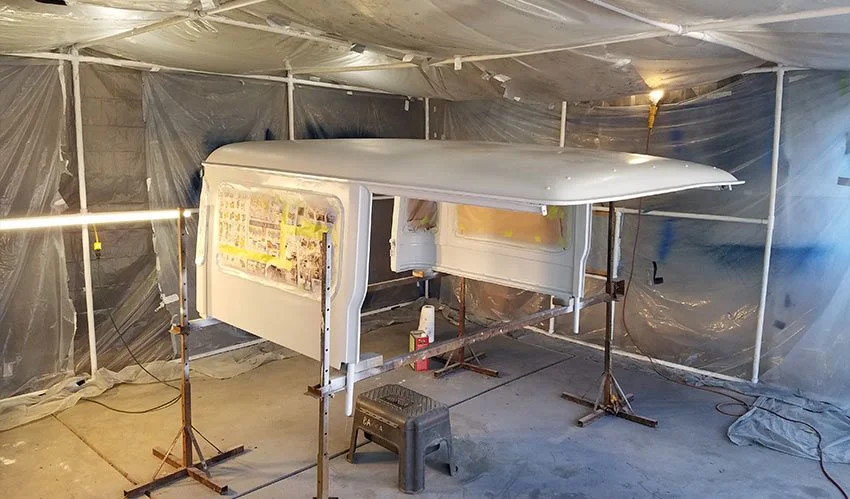

We have been working on the hard top which was in really poor shape. In particular, the fiberglass was extremely rough. I decided it was beyond repair to get a slick look so I went with the remaining tintable raptor liner on the top for the white fiberglass portion. It worked so well on the tub. I know the purists may not agree, but I really like how it turned out.
So, we got everything like we wanted it from a prep perspective and then we sprayed everything this week. I think it turned out great, I'm so pleased with the results. See pics below.

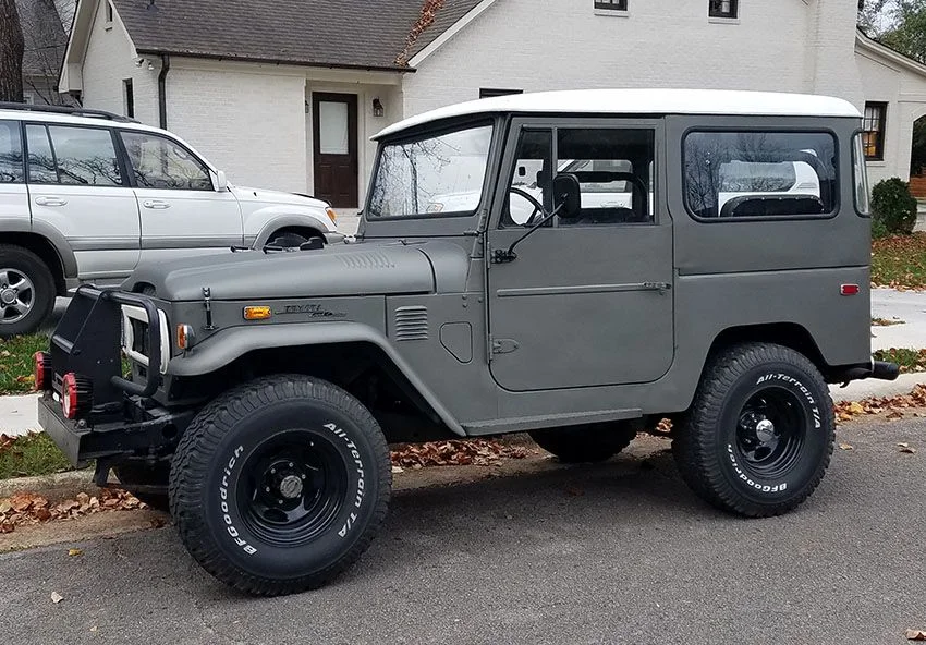

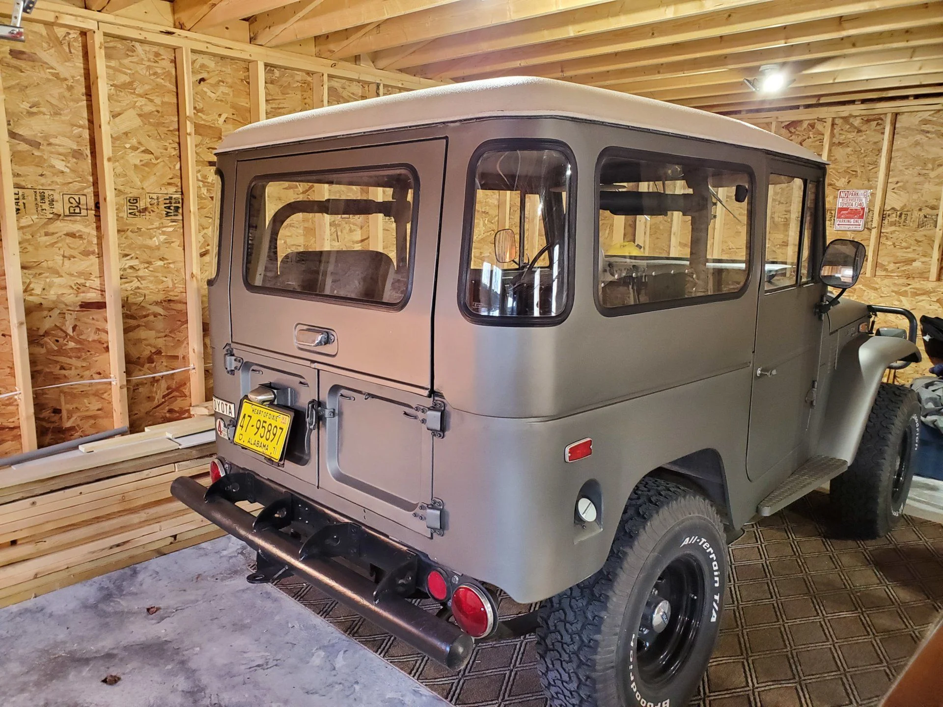

We set the hard top this weekend and I wanted to share a few pics.
