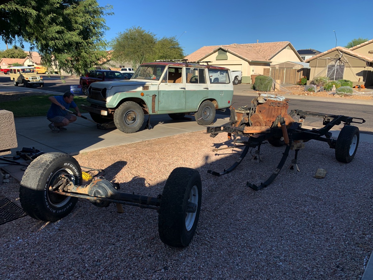

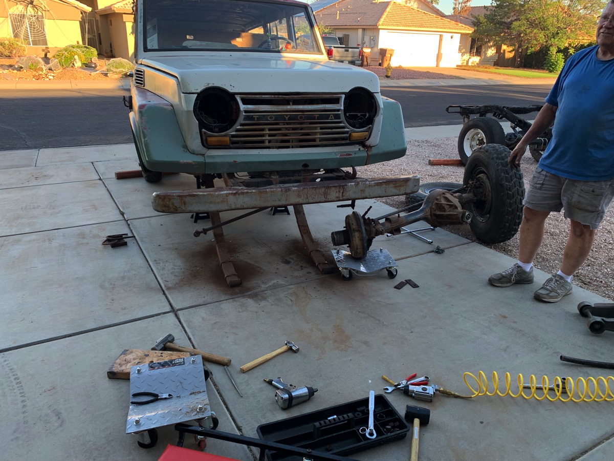

Whew... almost a year since an update. Lots of work though...
Dad's 3FE came on a built-up FJ40 chassis that had disk fronts and a rear disc kit as well. He took the parts off the chassis to convert his rear to discs. To do the front we figured a straight-forward axle swap was the best approach. So we got busy...

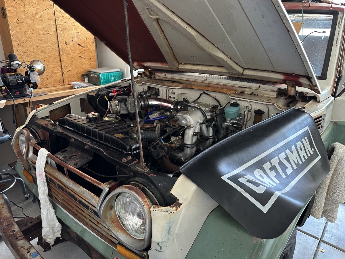

With that out of the way the 3FE went in for the last time.

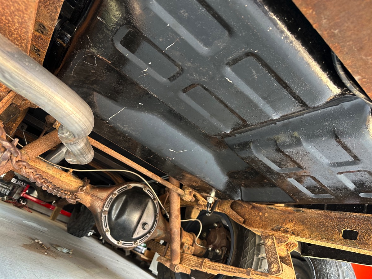

And a big milestone preventing us from getting things running was the gas tank. Dad reconditioned the gas tank we grabbed from Cruiser Corp and we finally got it installed and plumbed.
Other work done...
  • All new brake hardlines. Dad bent and flared those all custom.
  • New brake master.
  • Rebuilt front calipers.
  • Radiator was re-cored and modified... we needed it pushed forward in its bracket to make room for the 3FE fan. Dad had a local radiator shop do that and it ended up perfect. Thanks to @PabloCruise for pointers on that.
  • New exhaust custom built.
  • Driveshafts modified/rebuilt to suit 3FE and 4-speed position.
  • Lots of wiring harness troubleshooting and work.
  • New Koito H4's installed.
