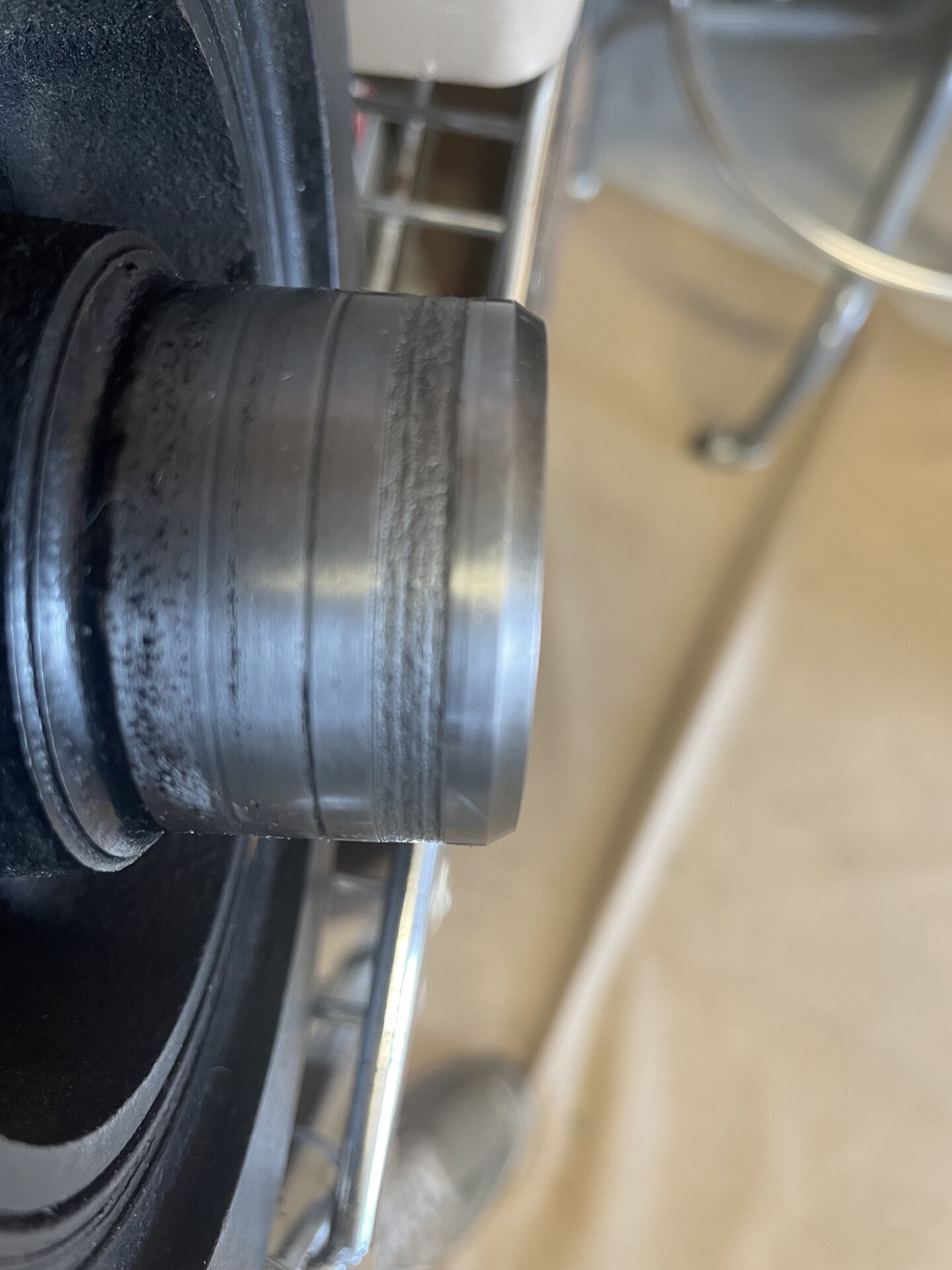

Just pulled HB and removed pwr steering pulley.
Same howl.
Pulled the HB and have a significant gouge. Can’t figure out what caused this though.
Could this be the culprit?
