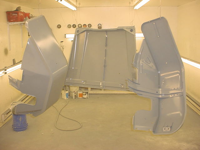

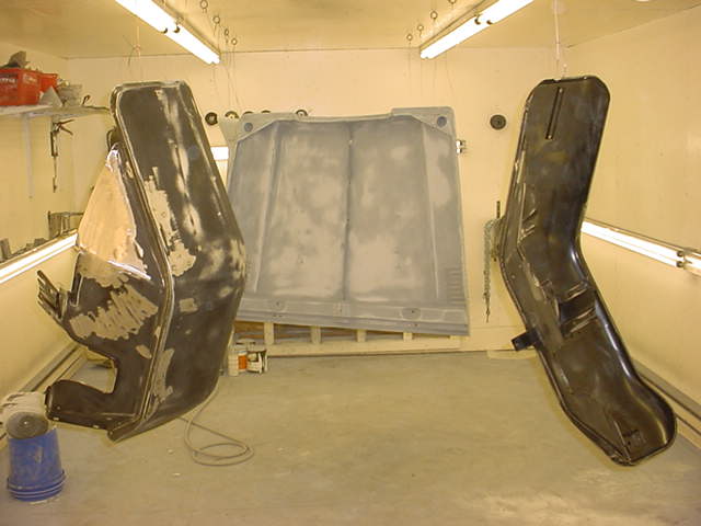

Got about 3.5 hours on the lv tonight.
Nothing glamorous. Ran over both fenders with the DA and 80 grit, prepping them for primer. Shot a coat of epoxy primer first on the fenders and then 2 coats of ureathane primer for block sanding tomorrow. I think they will probably take 2 more coats of primer after that and then blocked out again, but should be good to go after that.
Went over the inside of the hood with 180 and the DA, shot a couple coats of ureathane primer on the inside. Also went over the aprons with the block and 80, 2 coats of ureathane on those also.
I have to drill the holes in the hood tomorrow for the spray nozzles, also would like to go over the inside with 220 and then one more coat of epoxy. Need to drill the holes for the emblems in the aprons. Probablly block those out with 180 and see how they look, might be fine after that or might need 2 more coats and blocked out to 220, we'll see?

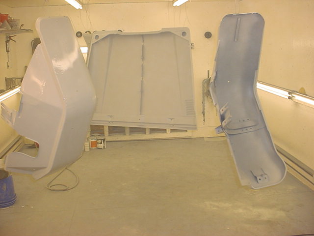

Pretty good day on the lv today. Got out of work around 5 so I could get going on this. Temp wise it was awesome so I moved some of my parts outside so I could work in the sun :)

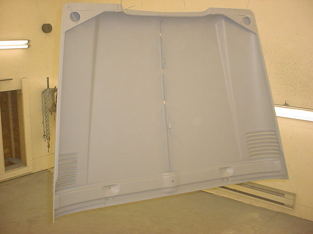

Blocked out the hood first, went fast. Had to drill the 2 holes in for the spray nozzles and then notch each side of the hole with a file. I had the OEM measurements from a 68-71 hood, decided to do my own thing. The nozzles are from an 80 series cruiser, looks pretty much the same as the nozzle on my 77 FJ40. The nozzle on my 40 is centered and 11 inches back from the hood edge. I went 10" back and 10" from the center..... I don't know why, just seemed right and looked like it will work, I'll let you know when I start spraying.

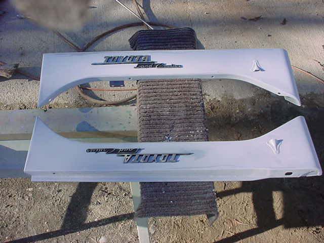

Blocked out my aprons with 220 also, then had to drill the holes in them for the emblems, all good.
Fenders, hit those with 80 grit and the DA again because of some deep scratches on the inner fender well. They look extremely good now.
Everything got hung up again and sprayed with 2 coats of epoxy primer. The hood and aprons are ready for paint. The fenders are going to have to be blocked out with 220 tomorrow, but that should be it for sanding fenders. I plan on shooting a coat of epoxy over the top after I block them out and then they are ready for paint.
