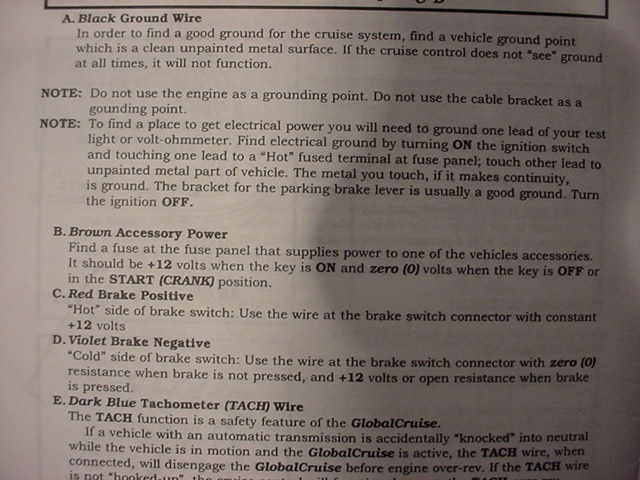

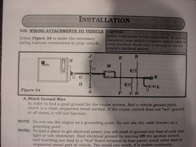

"B" is ign hot
"C" is Batt hot. They call it Brake switch hot so both the voilet and red wires can go to the same place. It does help with troubleshooting down the road.

To clarify on those C & B wires, The C wire is hot even when the vehilce is off?
Thanks Matt
Waggoner5 said:
Yes, hot even with the ign off.
Should work to bring a constant hot off the solinoid up to the red wire, "C".
The EZ 21 harness had a cruise control wire I ran out to the unit, it is only hot in the on position, obviously that will be for the brown wire, "B"
I thought the Violet wire, "D" ran into the brown brake light wire, basicly goes hot when the brake is depressed?
Thanks, Matt
You can run a wire from the solonoid up, but you can also get the constant hot from any other source that is hot even when the ign is off.
Yes, the violet wire goes to the side of the brake switch that puts out 12 when the pedal is depressed. It is also the wire that supplies power to the brake lights when depressed. The other side of the brake switch should be constant hot. That is why the instructions tell you to run the red wire to it. It saves you from running the red wire down to the solonoid or somewhere else.

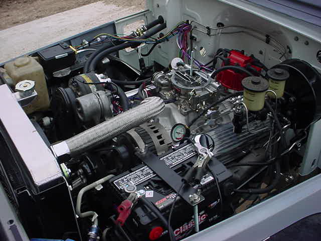

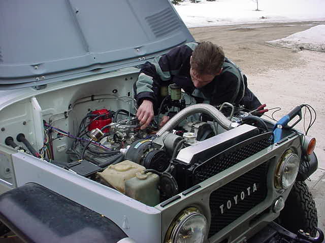

Pretty good day on the lv today. I had a couple things to finish up and my mechanic buddy came over around 1 pm.
We worked on the cruise control and got all that taken care of, went pretty good. Couple other misc. things, but then we pushed it outside so we could start it agian and he could get it all timed and dialed in. Ran for about an hour, had to shut it off a couple times to make some adjustments, but went pretty good. Adjusted the fan relay, but overall seems to be cooling pretty good for a new motor. I had doubled up on the fuel filters when I ran the fuel line, glad I did. Quite a bit of rust coming up from the tank right now, hoping that isn't going to be a problem? I had washed it out several times and thought I had the bulk of it, but obviously not. Probably drain the tank and fuel that's in it and try to flush it a few more times, see how that goes.

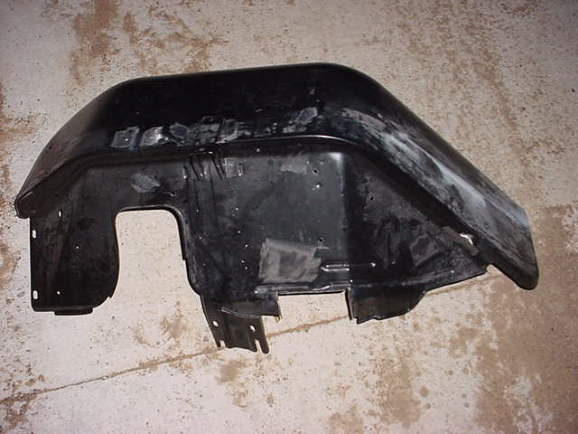

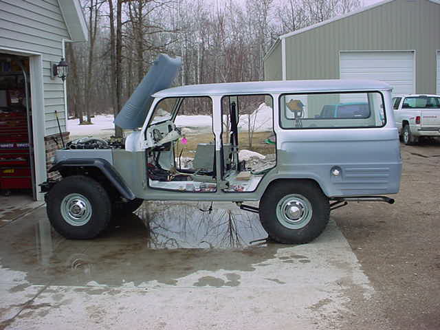

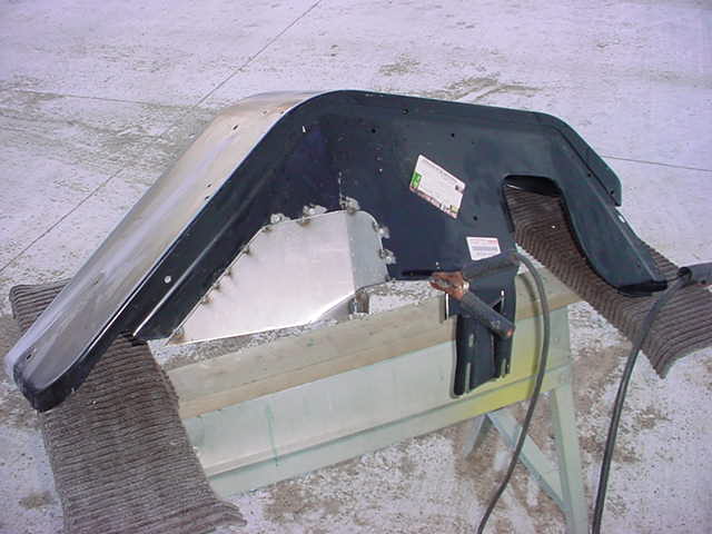

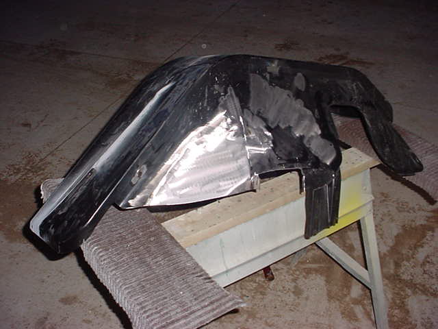

Spent a good couple hours and tried to clean up the shop a bit, wiring seems to make a mess. Unbolted the front clip and started welding on the fenders tonight. Got pretty much all the holes and pieces welded and ground down that I needed to, buzzed off a few Toyota decals also. Hoping to go over them with 80 grit and the DA tomorrow, would like to shoot some primer on them tomorrow night and start sanding Tuesday. The hood is pretty much good to go, the side aprons will need a little work like the fenders but not much. Hoping to be spraying paint by the weekend, get the front clip jammed and bolted back on.
One question on the cruise control if someone knows the answer? Light green wire "G" that I mentioned in the prevous post. It says it goes to the Neutral saftey switch, I understand that. Are you supposed to run that wire to ground or supply the NSS with 12 volts and energize the wire in event in goes into Neutral? Question is bascily, run it to ground or power it up?
