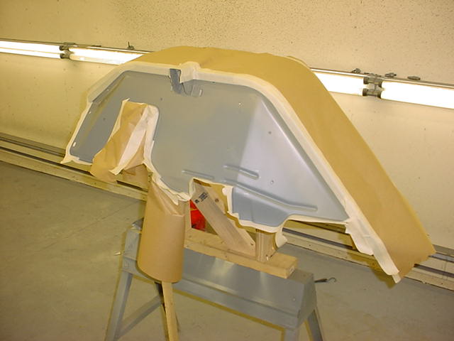

buckroseau said:

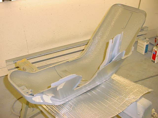

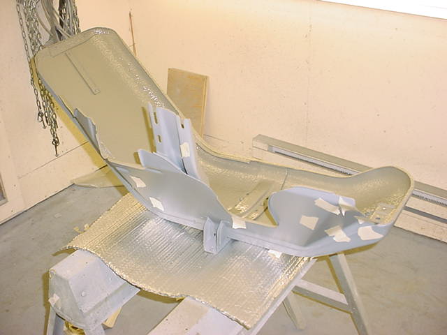

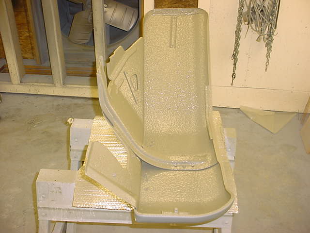

Only a couple hours on the lv tonight. Got home and started masking off the edges of the fenders for that SEM sauce.

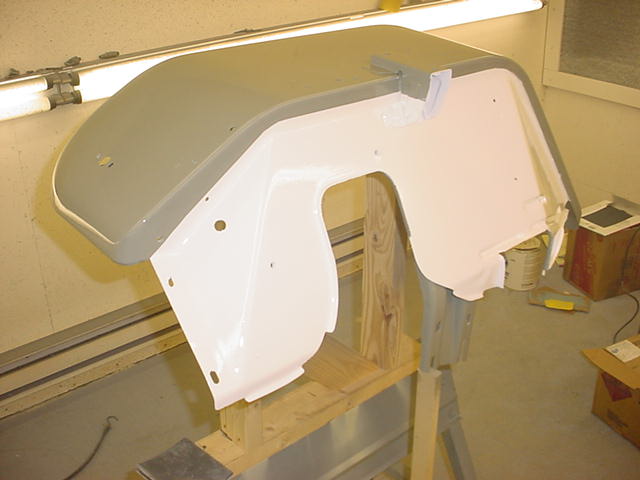

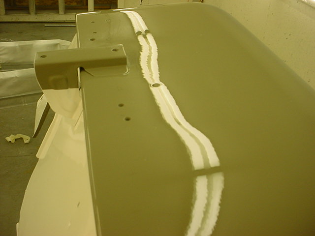

Pretty long night on the lv tonight, just finished up.
Got home around 6 pm and made some stands to hold the fenders real quick, should be a pic of those. I used some wax paper on top of them since the SEM sauce was still a little plyable. Got everything ready to go, including hood hinges, latches, fuel tank cover, side aprons and fenders.
Shot continetal beige first on everything, 2 to 3 coats. Then started back taping for white. Painting is getting to be like welding, getting a little tired of it. Back taping parts takes lots of time and it only takes a few minutes to spray paint, then you get to rip off all that work that took you over an hour to do.
Once both colors were on, shot 2 coats of clear on everything. Everything turned out pretty good, happy with it. Probably let those parts dry all day tomorrow and into Sunday, start hang doors and tailgates tomorrow probably.

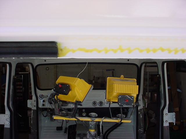

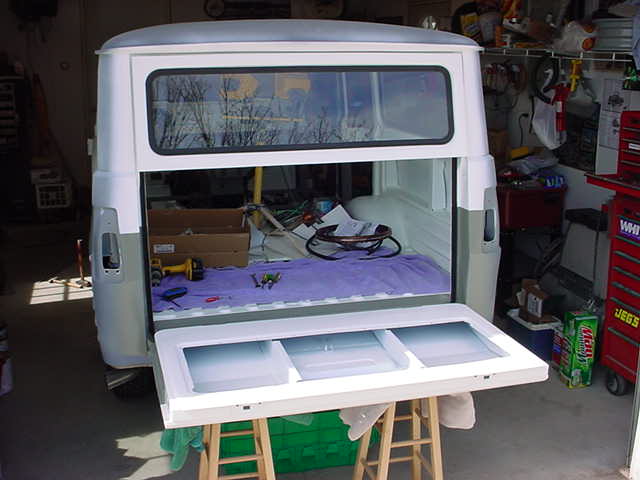

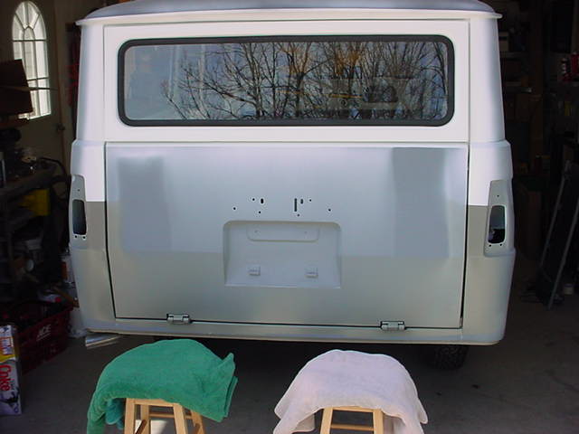

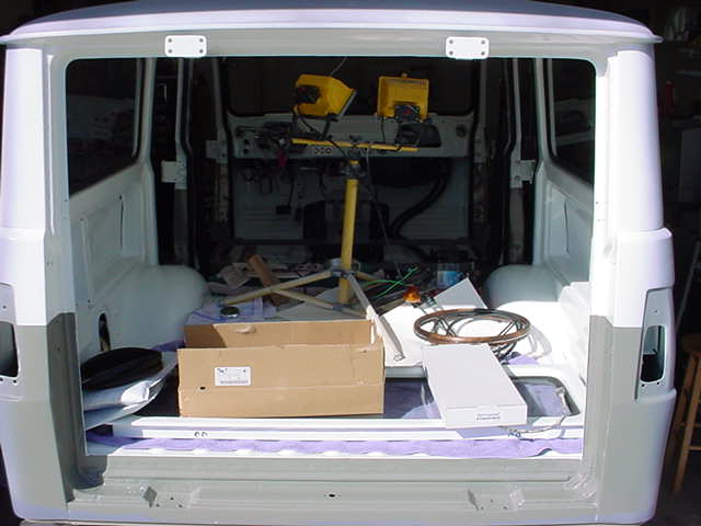

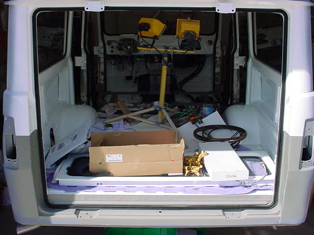

Pretty good day on the lv, didn't try to hard today, nice day so I had the doors open all day and the lv out for a while while I worked on it.
Started off the day by gluing some weather stripping I got a few weeks ago from JC whitney to the back tailgate area. Took 2 pieces started in the center and worked to the bottom, glued the 2 ends together at the top and bottom.
After the weather stripping was on I started with the upper tailgate. My buddy Jerry (or as I call him, "Broncoabandoner" ;) ) came over and helped me hold it up while I got all eight bolts in. That went better than I thought, glad he was there to hold it, with the glass it was heavy. After that we bolted up the tailgate, little problem. My auto body buddy and I had the upper and lower tailgate closing well when it was in primer. It was a tight fit between the 2 when we had it in primer, but closed well. Well, now it doesn't close so well. I made as much as adjustment to the top as possible, but just so close but won't fit. So tomorrow I plan on making a little lower hinged ajustment. I plan on milling some of the face of the hinge off, possibly a 1/16" or so of each flat surface of the hinge. That should give me a good 1/8" and then should fit. I will end up blasting and painting the hinges again, but that's ok, as long as it fits.
My buddy Jerry stuck around for a while and helped with the doors, I think you can see him in one of the pics while I was making him do the heavy work :) . Got all 4 doors hung and swinging into the jams nicely. Suprises me how tight that new weatherstipping on the door jams sits against the doors, should be a nice tight fit.
I have some painting I plan on doing tomorrow also, but if the tailgate stuff goes well I plan on trying to get my latches installed on the doors again.
Mattt
