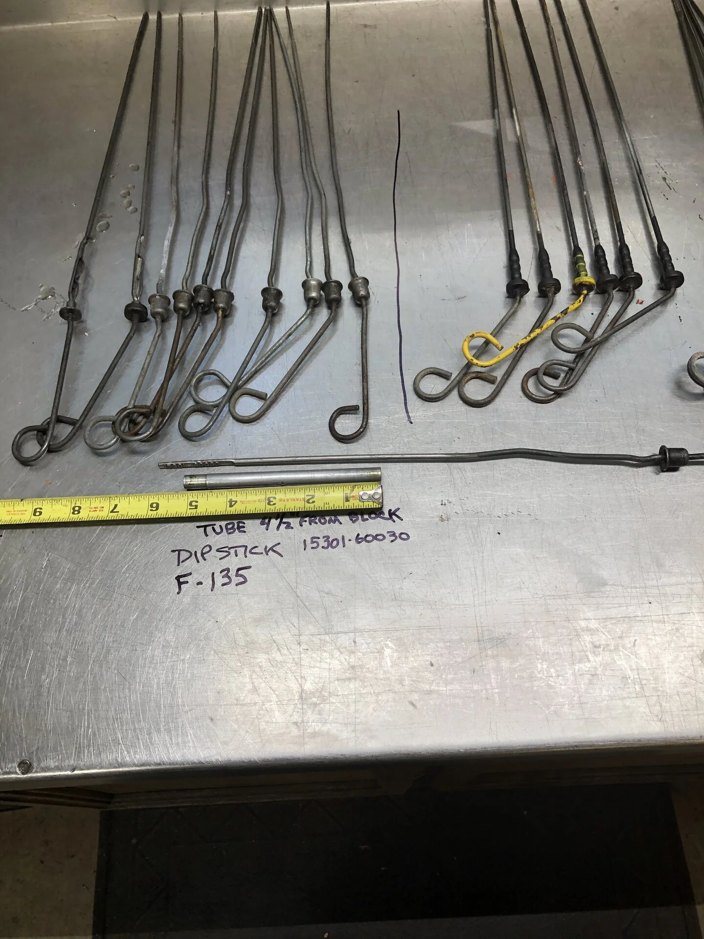

Measured two F135 engines. One is 4” and one is 4.5” (1966) of tube length from the block.
Were the dipsticks different lengths? That's the real question.
Good question, when searching a bit ago I thought the dipstick part number was the same through ‘67 but that’s not from hard data.
I’m going to top my oil at 6.9 qts (ok, call it 7 or maybe 6.5liters 😂) tomorrow am and measure the height above the F line on the dipstick.
Hey Chase @red66toy do both the rigs measured above have the same oil filter system?
Both have the OG canister oil filter system.
Pulled out some dip sticks.
Not sure if this info helps.
Thought I had a theory going here, that being that the OEM canister oil systems have 4” dipstick tubes and the OEM spin on oil systems have 4-1/2” tubes due to the volume differences between the canister and spin on filters - to keep dipstick readings the same assuming the same total oil system volume (6.9 qts, 6.5 liters). But Chase’s @red66toy info just blew that theory. Somewhere this tube length change must be documented. All I know right now is with 6.9 qts (6.5 liters) of oil in my rig, after a brief run to fill the oil filter, the fill mark is 1/2” above the F line on the 15301-60030 dipstick with a 4” dipstick tube and non-original remote spin-on filter system. 🤷
