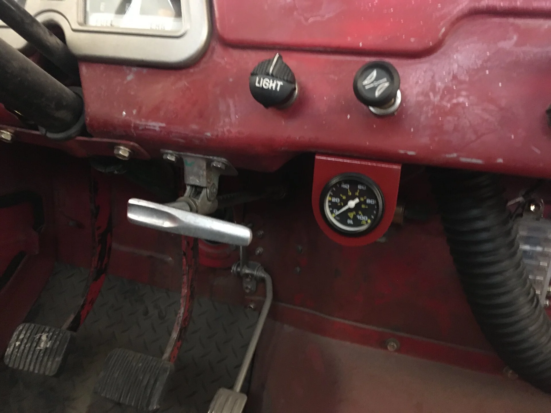

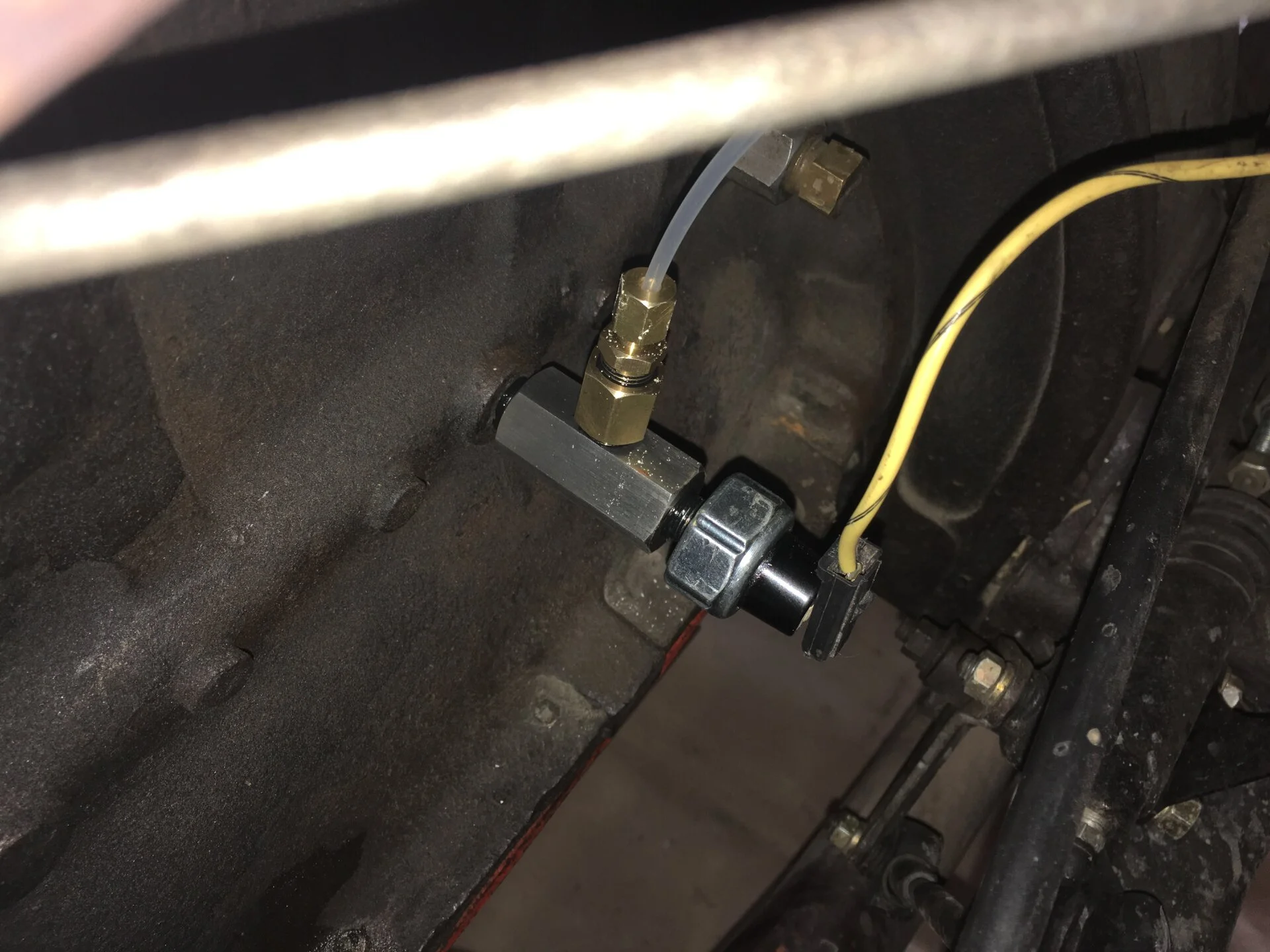

Installed a mechanical oil pressure gauge, just used the unused vader light hole under the dash to mount the homemade bracket, so no new holes in dash. This to allow easy, no impact removal if needed. Still have the fully functional (and annoying) OEM idiot light.
At cold startup, was getting 42psi at idle, dropping to 5psi or less at idle after fully warmed, then barely to 20psi at 2k rpms. Oil pressure regulator was fully adjusted, so I shimmed the spring and now it’s 50psi cold and 25psi warmed and 2k rpms. Still drops to very low pressure at idle when fully warmed. (8 qts of 10w-30 Rotella T-4)
I have a smidgeon more adjustment I can make since shimming, then will test again. If no improvement I’m going to pull the regulator unit off to verify the plug is fully seating and to replace the o-ring gasket (Redline’s kit), but I doubt there’s issues therein, just want to check that box off. This is a really old motor, previous threads show what I’ve done to cure some ills but not a complete rebuild.
I’m under the assumption that its age and worn bearings are overbearing the regulator’s ability to maintain hot oil pressure to the FSM spec’d 44-50psi at 2.4k rpms. (FSM is not clear on any idle psi spec) Redline is emphatic about pressure at 2k+ rpms in terms of failure prevention but this rig will spend a lot more time below those spin rates. Thoughts?
I don't know, 5 psi at idle for a fully warmed engine running 10w-30 sounds decent to me. Sounds like a good plan to get all the pressure you can from the regulator and then call it good. I have a very strong F in my swb and I get around 20psi at idle with a fully warm engine running 10w-40.
The additional adjustment really only raised the cold startup pressure, so I’m going to set that to be at 50psi at cold idle as best I can. I still might pull the regulator and fully check it out when the Redline kit arrives.

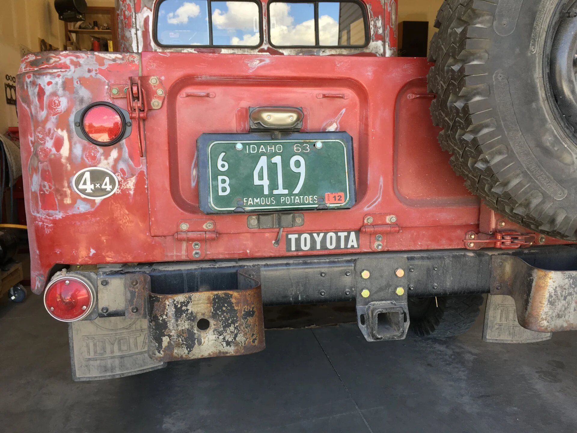

Non-OEM complete now 😂. Matches OEM Toyota sticker though.
