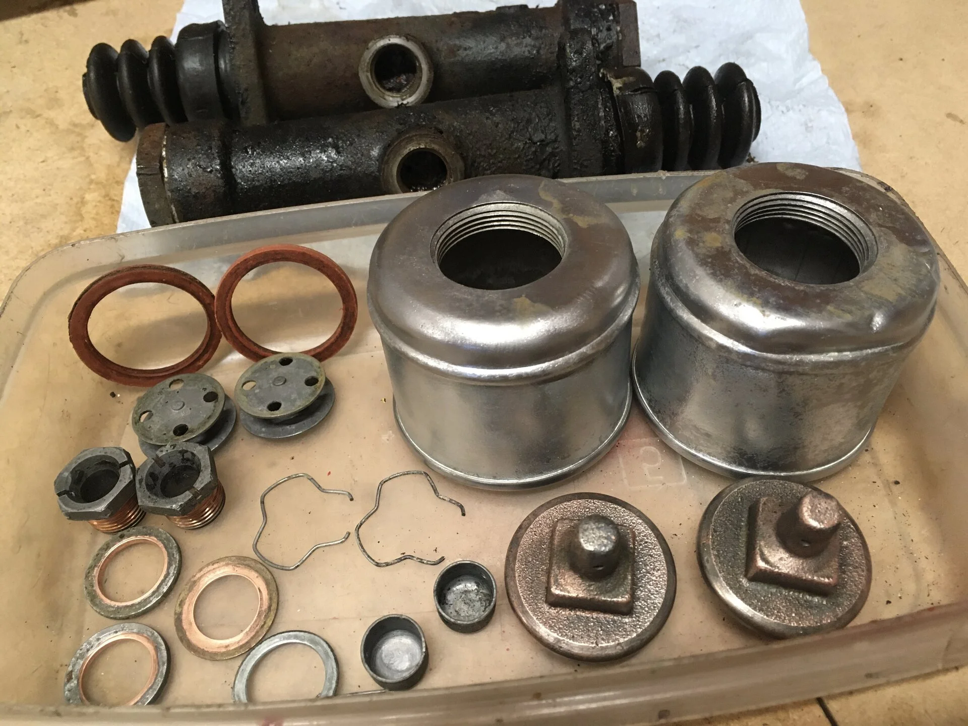

Another “maybe” update. Cleaning these up, just the cups, they‘ll replace the plastic cups on the existing installed OEM MC’s. Maybe 😂. Some pinholes to deal with on the bottoms (white spots from light), thinking of Tin/lead solder. (?) I‘ll asses further once I get some dremel wire brushes to clean up the insides. Maybe.
