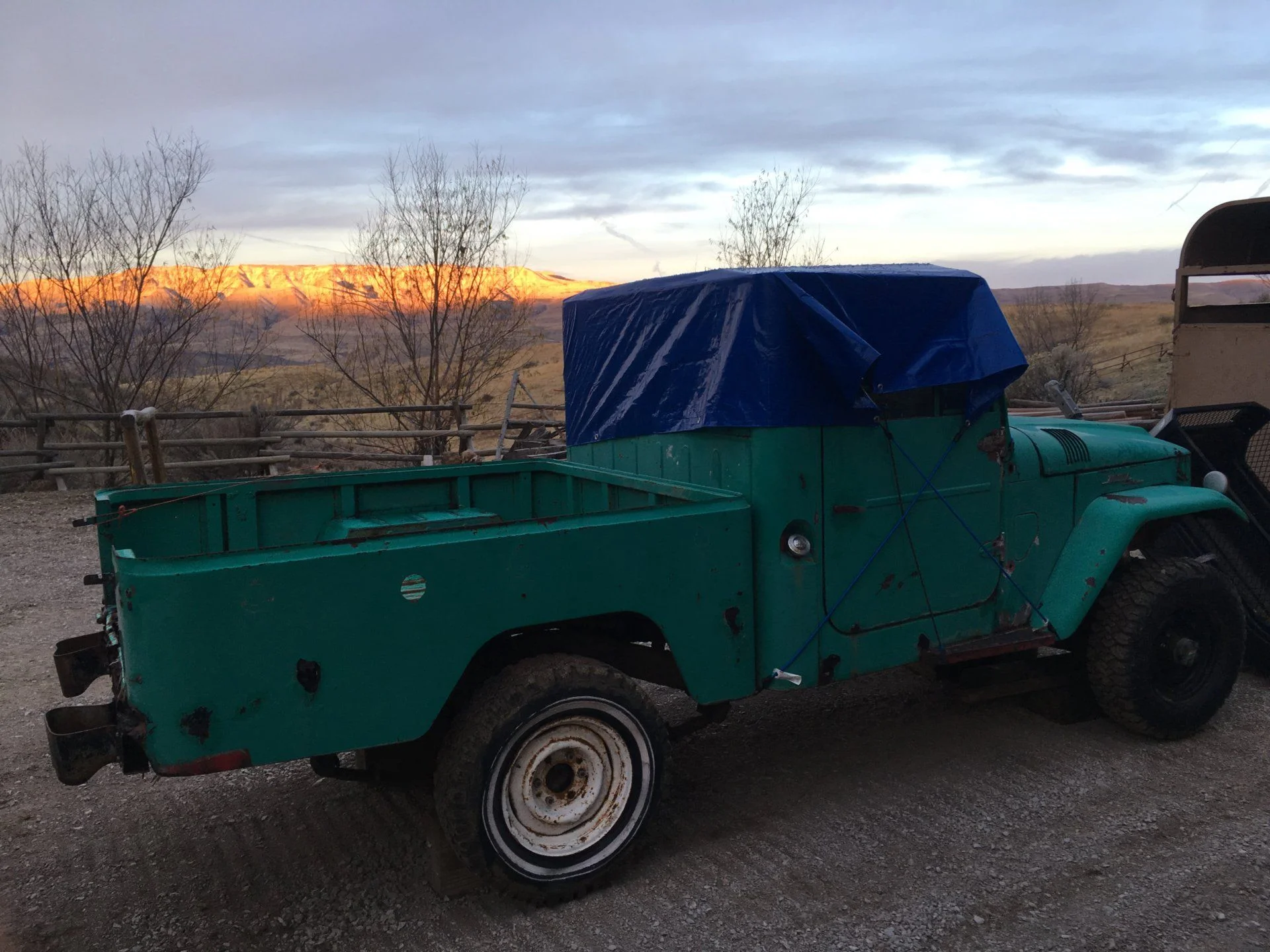

Well, here goes. I picked this rig up in Nevada on 11/19/17 (previous f/s thread with more pics For Sale - 1963 FJ45 ), now it sits in front of my barn (hence name) for the winter. The new shop gets ground breaking tomorrow (12/1/17) so she'll have to wait until it's done to move inside. And that's when the real tear down will start. I've started a little bit (the top is off and in the barn, hence the tarp, along with the fuel tank). I'll pick at it a little while outside, mainly to curb anymore rust growth and to get a start into parts-acquisition (and tool acquisition). I've treated a lot of the external rust areas with rust converter to hold until the resto - my main objective - gets underway. I suspect the resto will need a few deviations, but this will be as stock as possible (so I guess a resto-mod). I don't mud or rockcrawl except when I'm hauling stuff (salt, protein) to the bovine-in-residence, and I don't need a street rig for mall-hopping, have that already. This will be a work truck. In that sense, I don't need it now because I have '65 FJ40 that fills the gap between my horse-hauling pickup, four-wheeler (atv) and tractor, LOL. So this is ultimately a project rig, and in that sense I BETTER HAVE FUN with it (so says the wife). Just a few pics to start this thread:

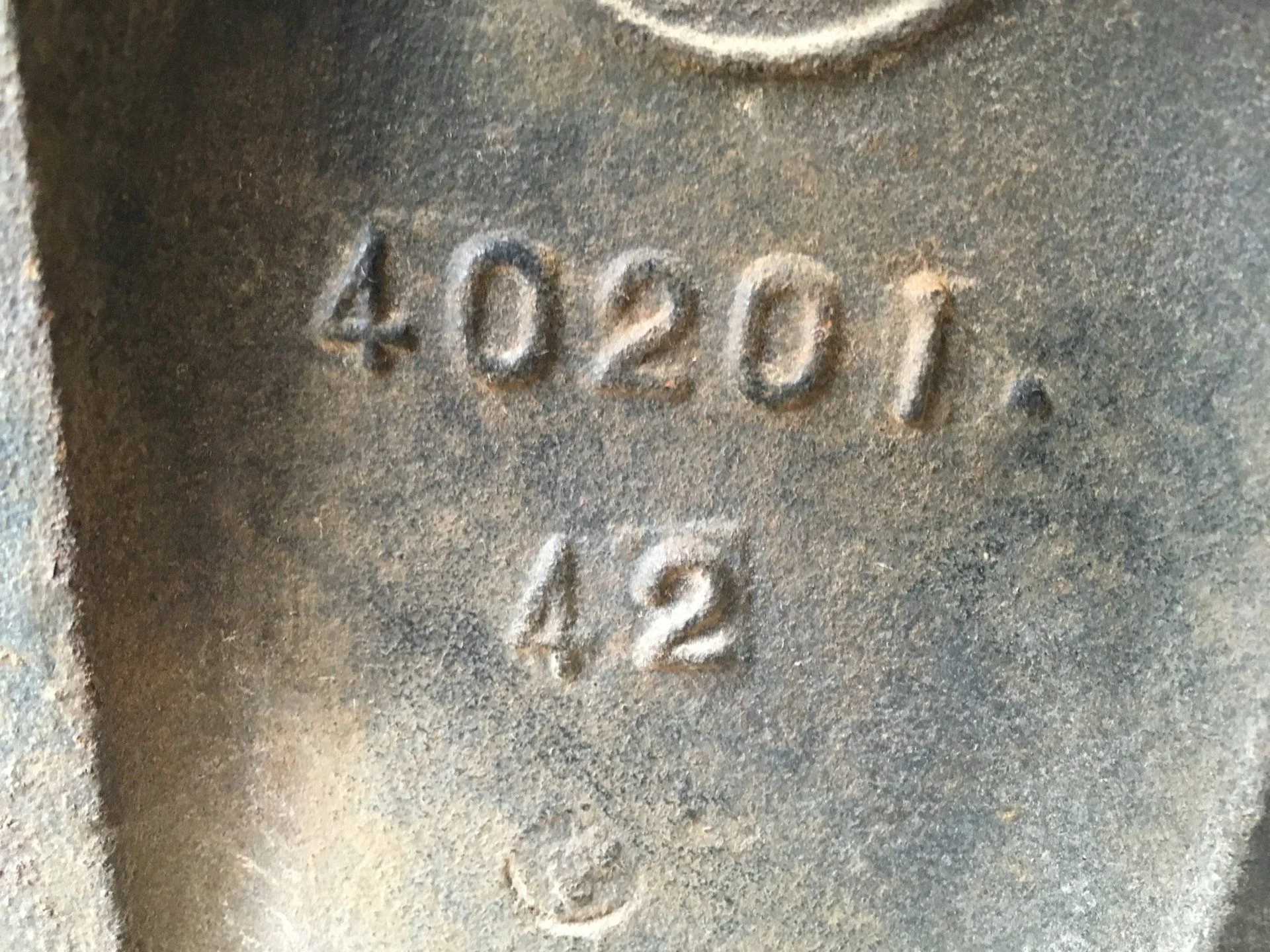

Finally got around to doing some number verifying. Engine not original but not surprised (assuming vin tag is authentic - see later poor image on frame no. check)
But that opens a door for other engine possibilities since I have no clue if the one “installed” (lol there’s one bolt holding it in) runs or will run. That’s a much later bridge to cross. I think it’s a Feb 1 1964 block? F or F135 (are those different?)? I’m becoming an expert in cluelessness. Can’t remember what the 42 means.
What do the rearward driver side block numbers mean?

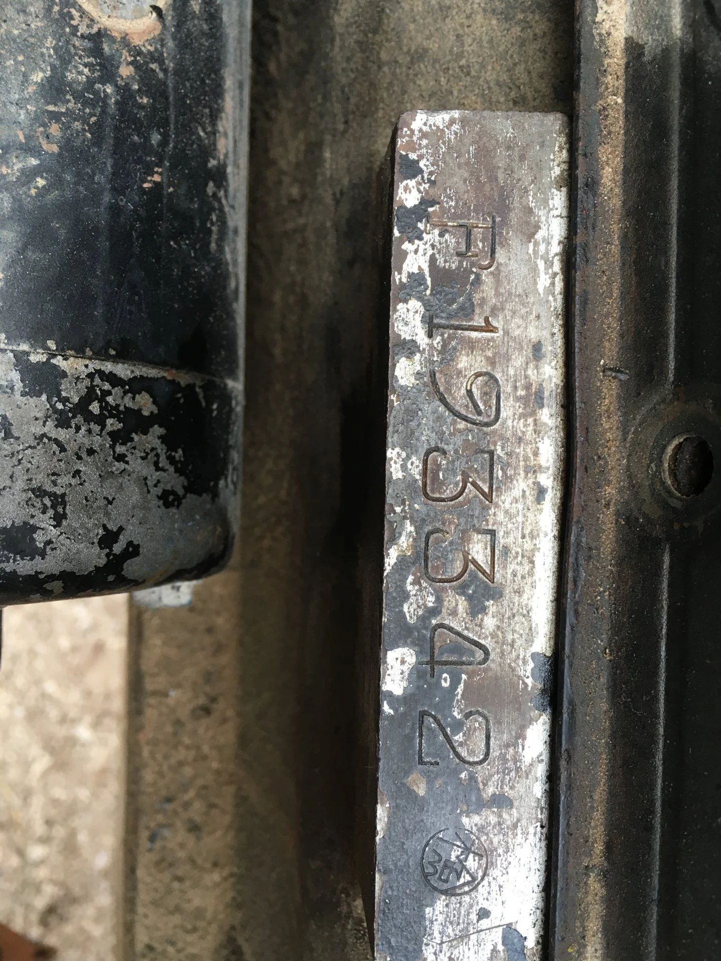

Barely able to verify that frame and vin no’s match. I can make out the 5 - 1304 and maybe the 8 on the frame. A bit too much material removal in its past, but I think they match.

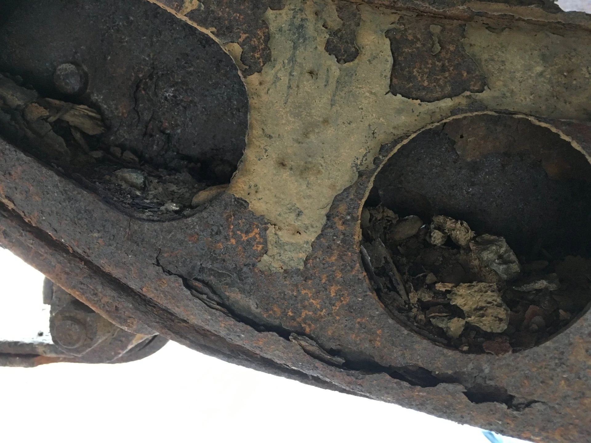

Found one serious frame issue in front of driver’s side rear spring shakle. This might move me to undo frame rivets, fix, cleanup and bolt back together like some recent threads have shown. Of course, I’ve never done that so add another clueless possible road adventure to my already cluelessness expertise.

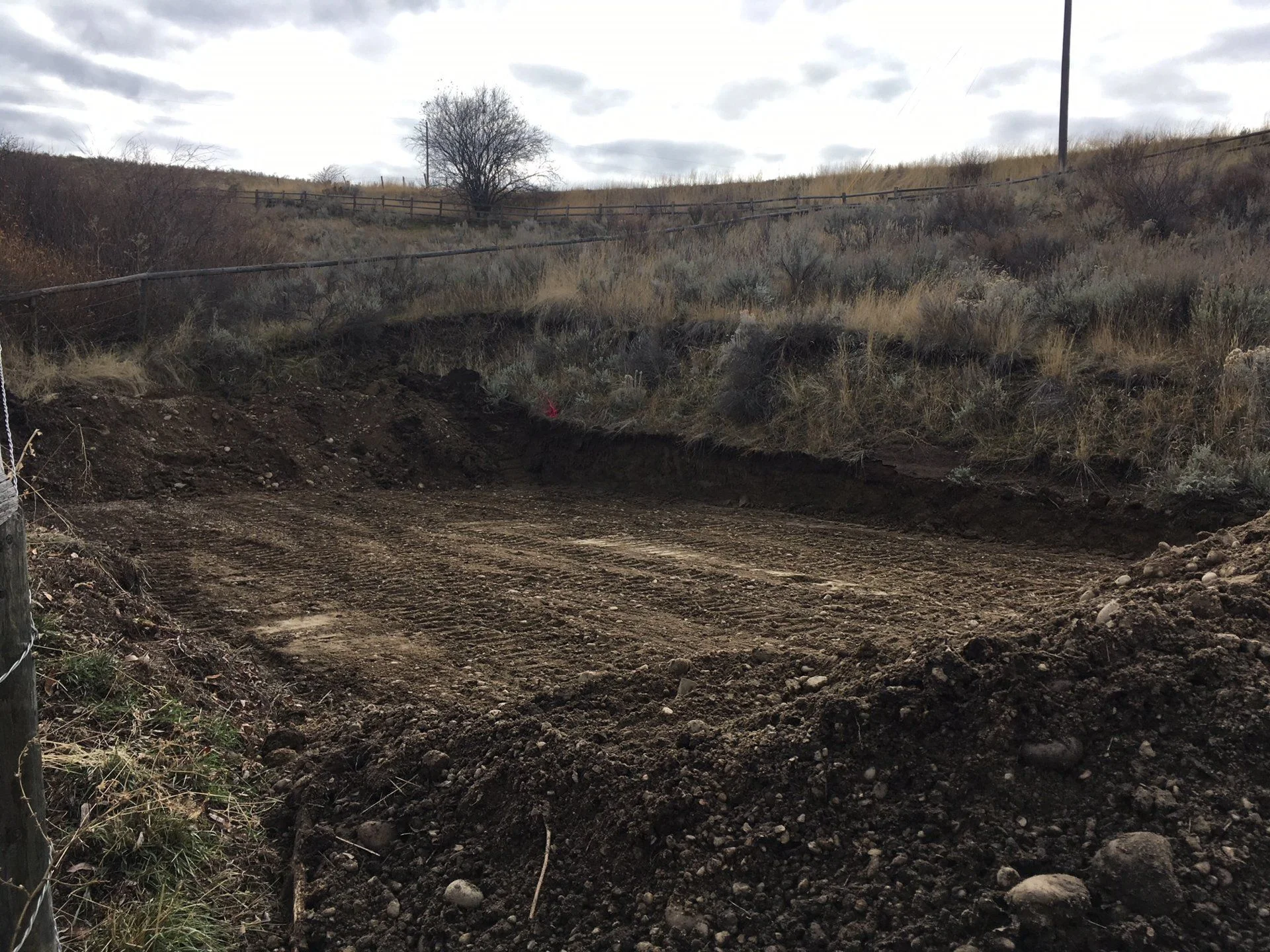

But the shop has started (ok excavation, but :bounce:). Soon I won’t have to crawl around on the ground to expand my cluelessness!

Not much cruiser stuff going on here, but the foundation walls and footing for the shop are in place and curing. Next week gets backfilling and either slab or framing, not sure.
