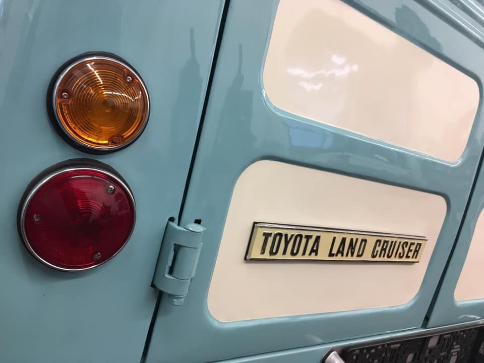

  4. The rear license plate bracket and light are missing, it's got a tail light and some home fab bracket on there now. Since this is on the GIFU side of the truck I guess I can do whatever but if anybody has any idea of what it should look like let me know. I haven't seen any 28 pictures of the rear. Otherwise we will probably use a 1960 bracket and light.

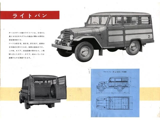

  8. I'm quite certain the bench seats in this truck are not original. I'm thinking the front seat I'll model after the FJ25, and the rear bench after the FJ45LV. However I'm wondering if the rear bench in this one was fixed - unlike the LV which flipped forward on a front hinge. Reason being that there's that cage in back. Thoughts? Fabbing a fixed one would certainly be simpler. Any ideas on building/sourcing the FJ25 front bench?

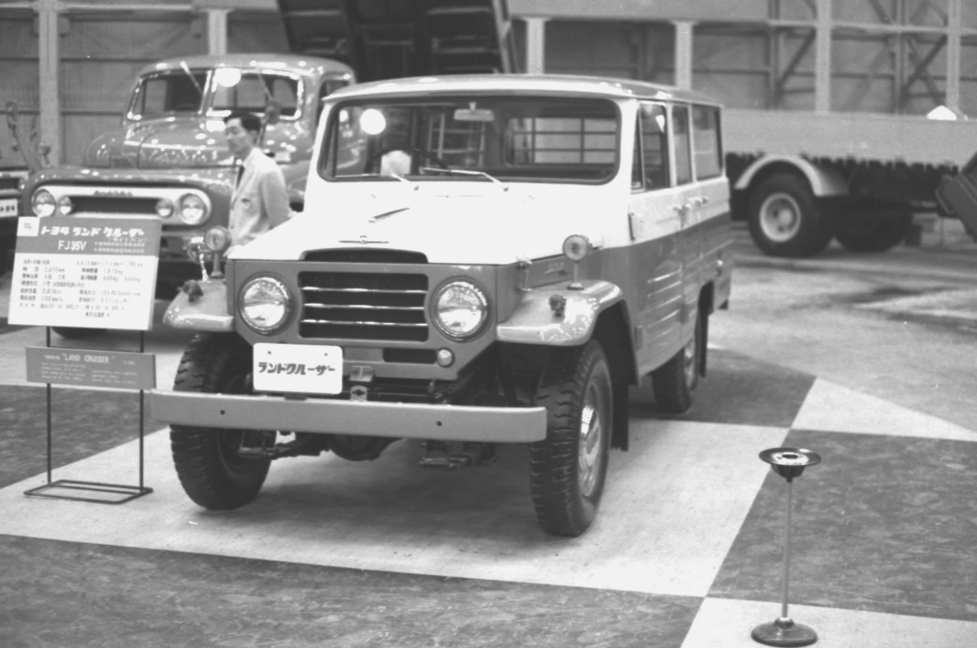

Congratulations on getting this piece of history. Will enjoy following your build. You can recoup some of your spending by selling those fender mounted turn signals. HA Ha John
One of the first things i'm going to pull off! Begs a question though did the 25s not have front turn signals at all? Or did they use the front torpedo marker lights as turn signals?

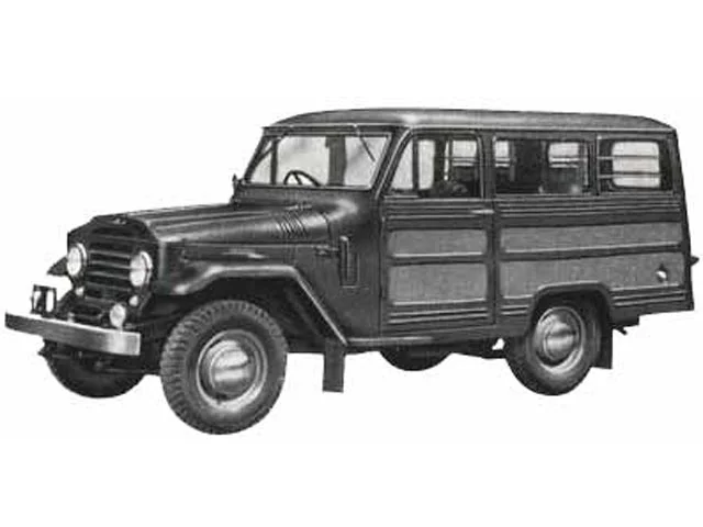

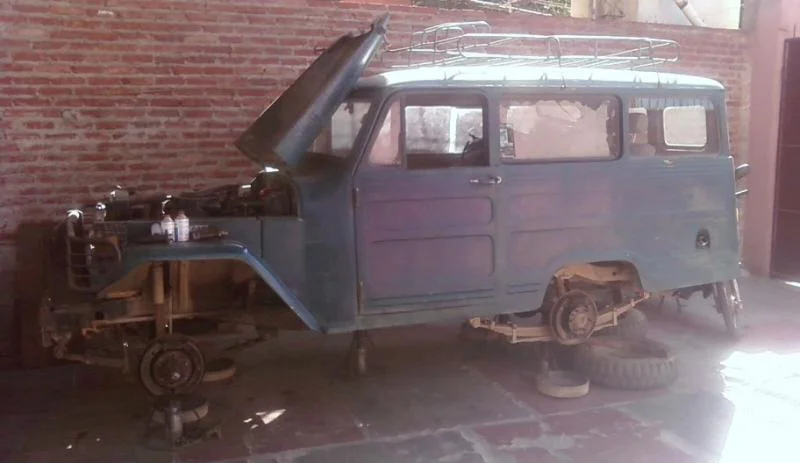

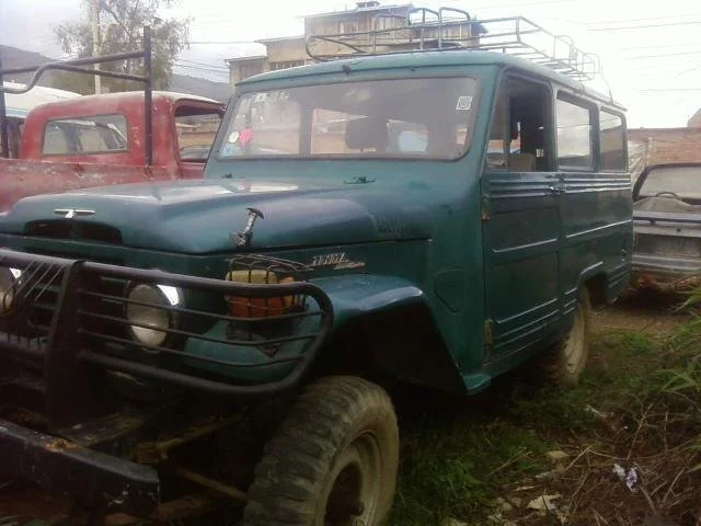

I know of at least one more in Venezuela ... Henry C @Exiled had found ... the pic made its rounds as the only one known for a great number of years
I will have to check my pics... know I got it
Have some other pics ... but... probably ones you had seen
henry's pic:

  1. The rear license plate bracket and light are missing, it's got a tail light and some home fab bracket on there now. Since this is on the GIFU side of the truck I guess I can do whatever but if anybody has any idea of what it should look like let me know. I haven't seen any 28 pictures of the rear. Otherwise we will probably use a 1960 bracket and light.
i will see what other pics i got of the tail area and see if anything could have been or even a pic of one

  1. I'm quite certain the bench seats in this truck are not original. I'm thinking the front seat I'll model after the FJ25, and the rear bench after the FJ45LV. However I'm wondering if the rear bench in this one was fixed - unlike the LV which flipped forward on a front hinge. Reason being that there's that cage in back. Thoughts? Fabbing a fixed one would certainly be simpler. Any ideas on building/sourcing the FJ25 front bench?
may be original.... and just reupolstered .... dig into it will tell if the frames are at least original most likely

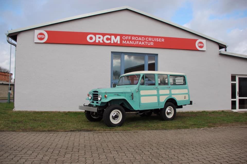

Thanks for the pictures! I had seen some but not all of those. Most of them are 2 door, the 4 door pictures are harder to find. But i think the 2 door should be similar enough that should help us figure out how she should look. I wonder what the interior seating layout was? The frame on both my bench seats looks brand new, so unless it’s the only thing they restored, it doesn’t look original.
Do you think those tail lights on the one in Denmark are original? Interestingly the quarter panels seem to have a welded patch about the same size as the trapezoidal LV combination lights. I’ll get some pictures next week and see what everyone thinks. Could just be coincidence.
