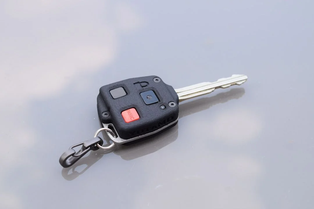

Depending on what you mean by “broke”, @suprarx7nut ’s YotaMD shell might be a cheaper and more durable fix…
Yes I saw those and am going to order one. The only thing broken is the plastic. Thank you regardless!

At this point, I’ve intentionally “broken” factory keys, to move to the reliability/sturdiness of the YotaMD shells.

What I’m saying about “milking the detailer” is that you really don’t need a new “fob”, or “programming”, you can reuse what you’ve got. Either with a YotaMD shell, or a Denso replacement key from a locksmith.

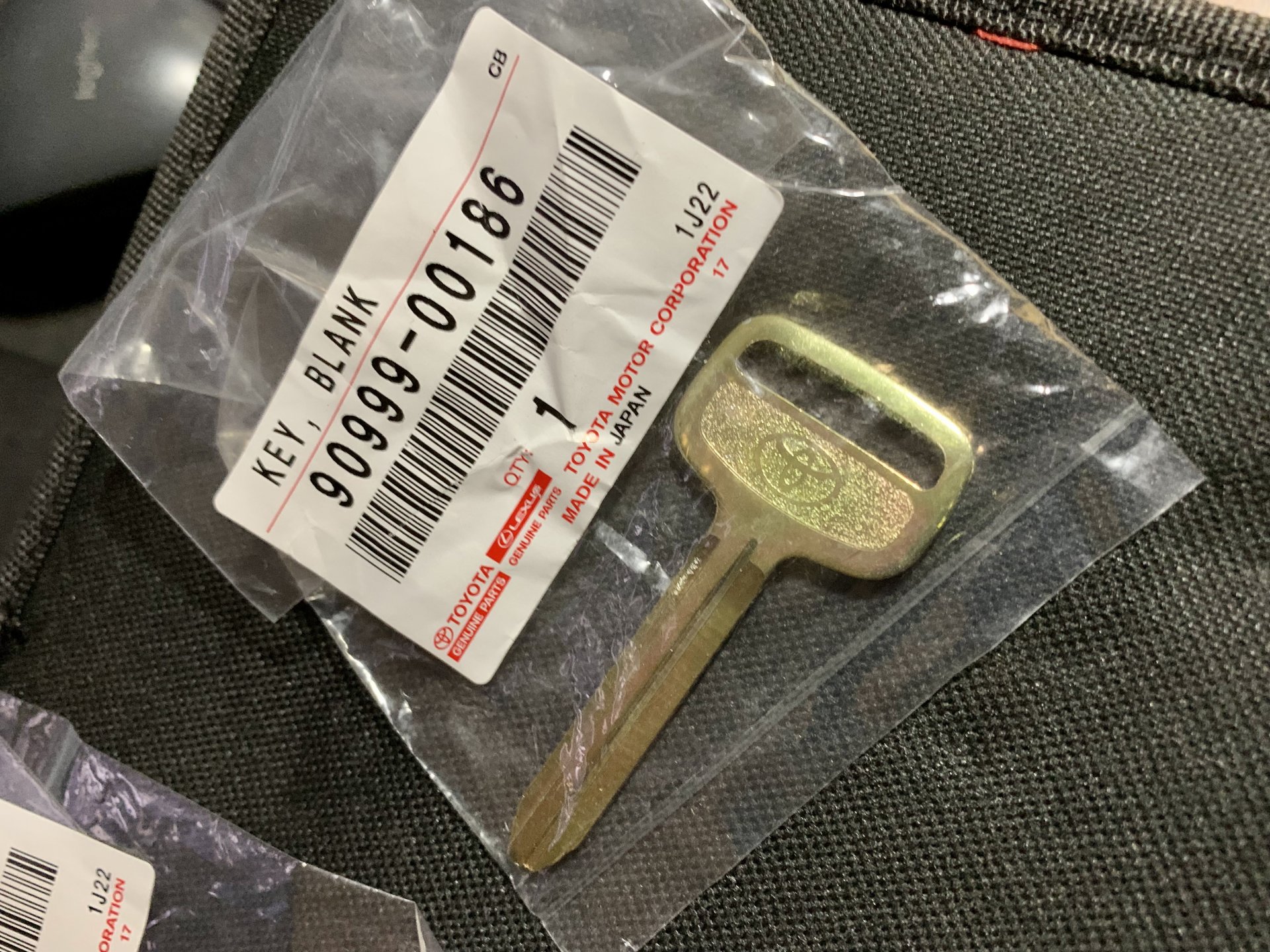

Greetings Fellow Members of the 100 Series master key thread :)
im ToyotaMatt ,
after some basic R+D here in the 100 SERIES TECH FORUM , i could simply find no better place to make this historically significant all things 100 SERIES formal
ART Opening of sorts unveiling .......
- Female Owner Operators & Gentleman may have the privilege to introduce the worlds first OEM TOYOTA GENUINE Japan Spec. Parts GOLD Plated 100 Series Key Blanks !
- i have done much home work online and else ware to state for fact humanity has never GOLD Plated a Single OEM TOYOTA 100 Series Key blank ....
- so here we are and there we go ........
- below for your review :
- is the end product of countless hours of indeed some trial and error , to bring these JDM OEM BLING things to the 100 series community ....
- they can indeed be SST Machine CODE CUT using the latest NipponDenso ( TOYOTA AUTO BODY ) computerized technology we have going on at the TOP-SECERT Rising Sun Mechanical SKUNK-WORKS Laboratory ..........:cool:
- these are TOYOTA JAPAN Spec. part # 90999-00086 , this by default is a 100% SOLID Nickle base metallurgy key Toyota offers up .....
- at the end of the day is the PERFECT metallic sub-straight to Yellow Zinc. Gold Electroplate .......
- Thanks For your Support 😇🍻

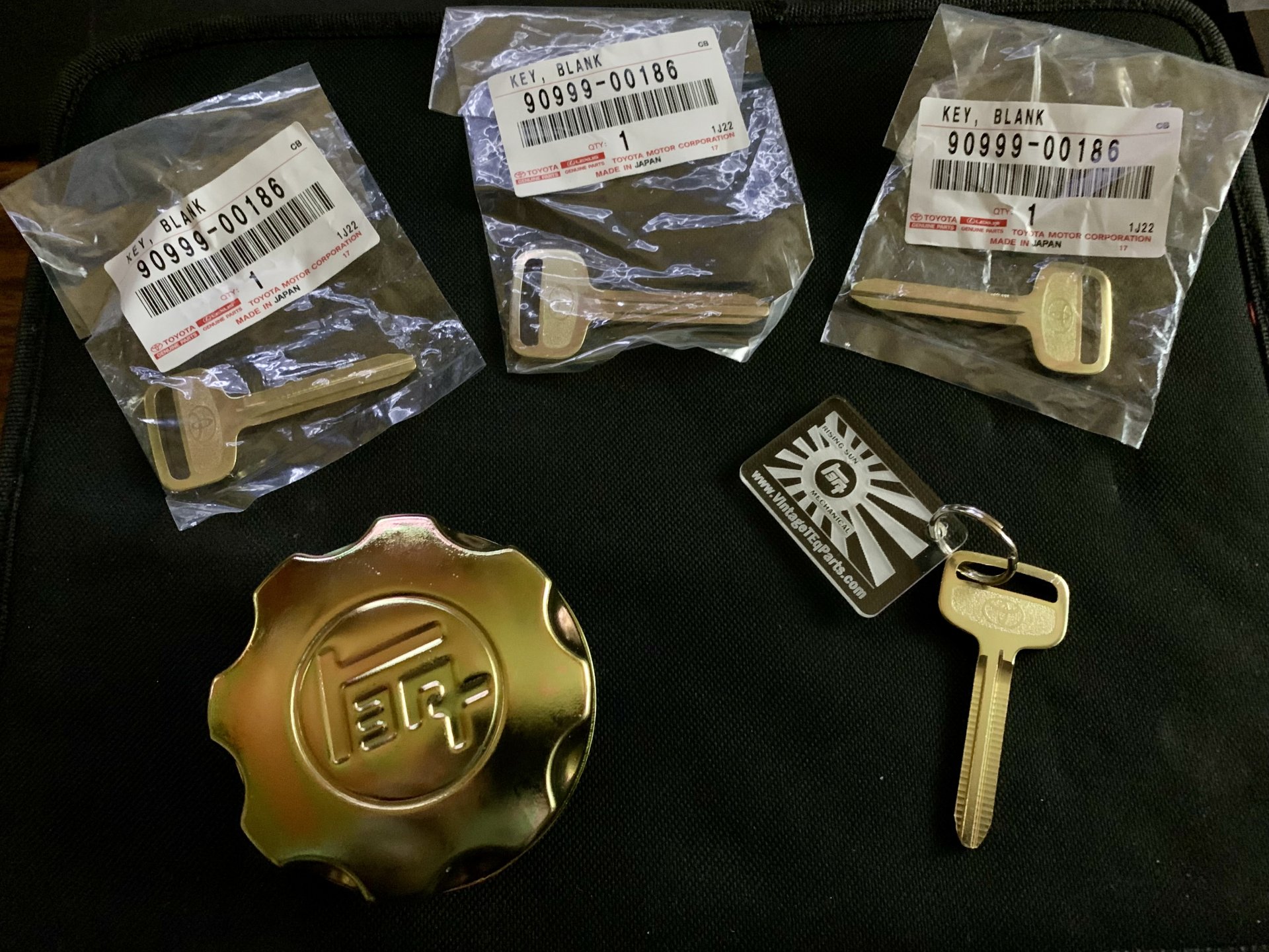

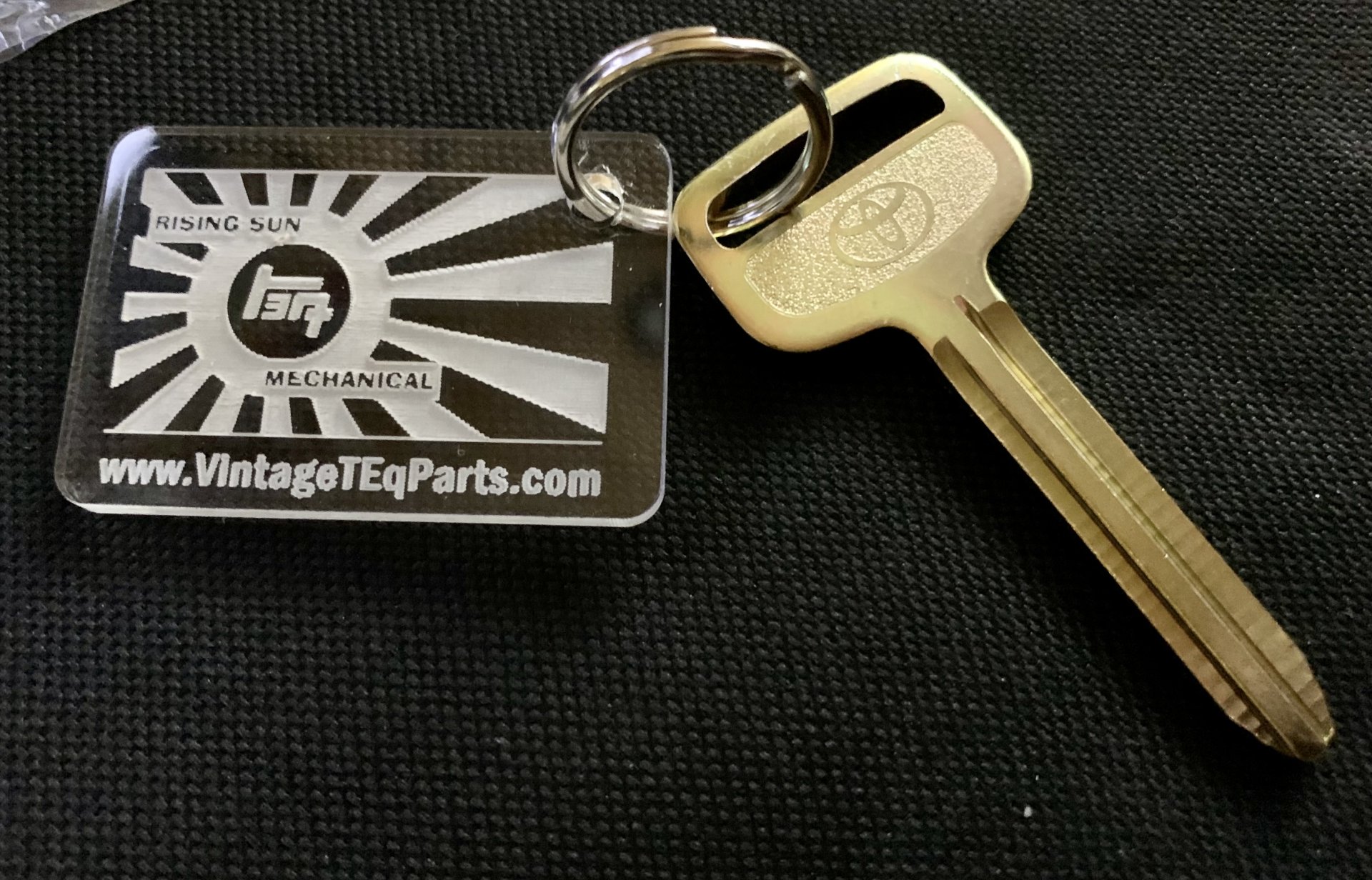

im ToyotaMatt ,

That's pretty cool. The only problem is those keys can only be used to unlock the doors. Without the immobilizer chip the ecu won't see these to start the engine.
yes ,
that is correct ...
- i should have mentioned that fact above , ?
- but since 100% of all 100 SERIES owner operators have a CHIP key , and NO non-chip equipped stand alone metal blanks assumed everyone
here in the world famous 100 SERIES MASTER KEY THREAD already knows this , :D
