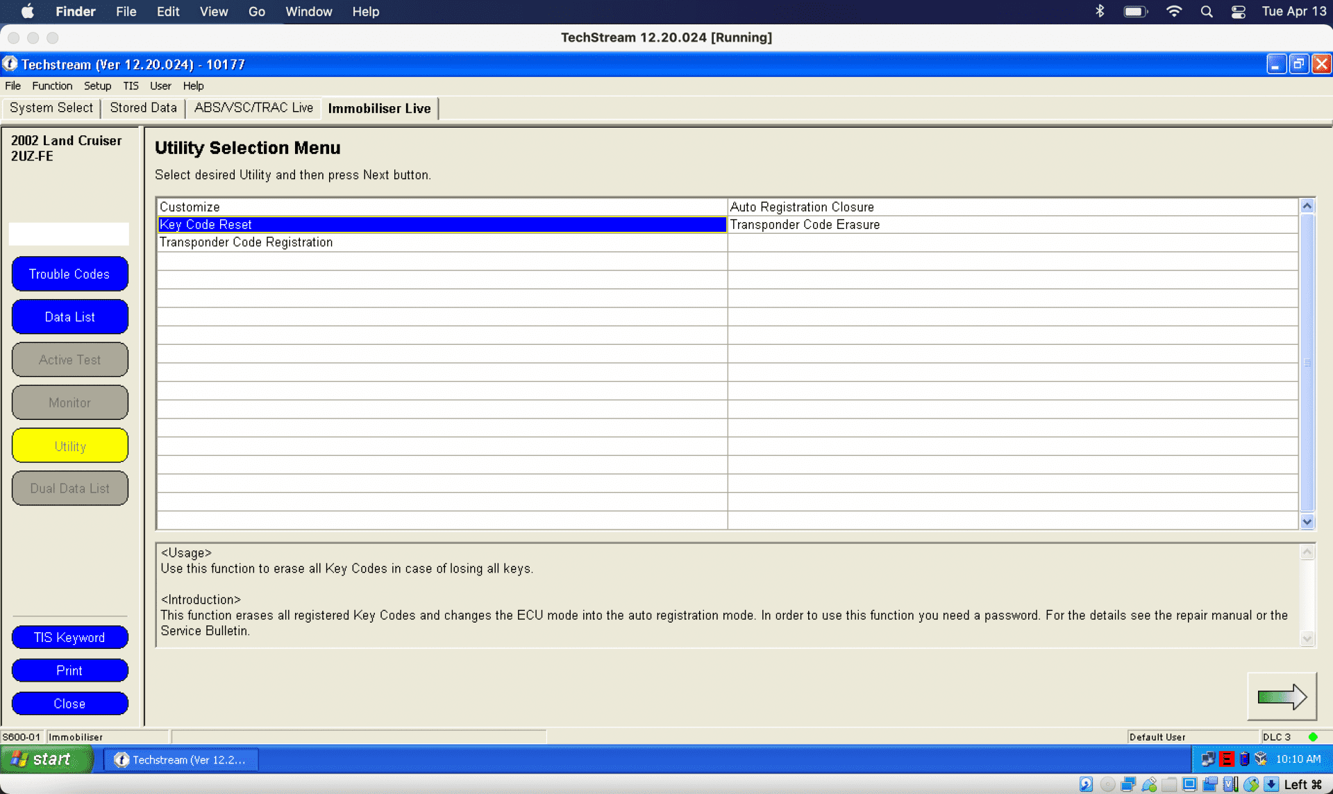

@Mauser you're right! I connected TechStream and I see the Immobilizer > Utility > Key Code Reset, screenshot below.
PM-ing you now how to get the decoded key needed to get ECU into key learning mode :)
