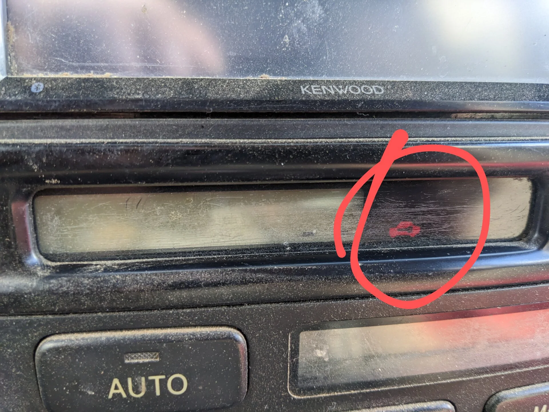

The best way to tell if your key is a master is to watch the security light while you insert the key into the ignition switch. If the light goes out as soon as the key is inserted you have a master, if it stays lit for a second or two your key is a sub.

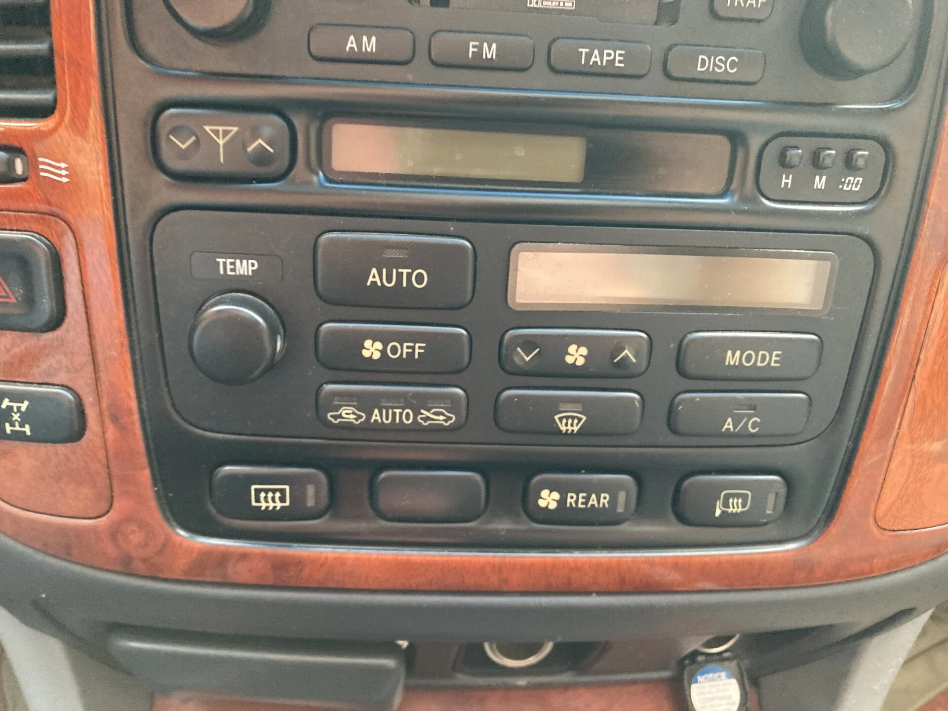

I understand that you may have already addressed this question, but I kindly request your patience. I'm curious about the whereabouts of the elusive security light. During my visit to my "100," I attempted to identify the type of key I possess (only one complete (no buttons/aftermarket (I also have a partial key/fob only that works to lock and unlock). Unfortunately, I was unable to locate any security lights. Even a brief search on Google did not provide any helpful leads. The vehicle in question is a 2001 LX. Thank you for your assistance.
Middle of the dash just below the radio.
I just got this one and it is my first 100. It’s going to be a learning process. Not sure what trim level but it seems pretty bare by Lexus standards.
