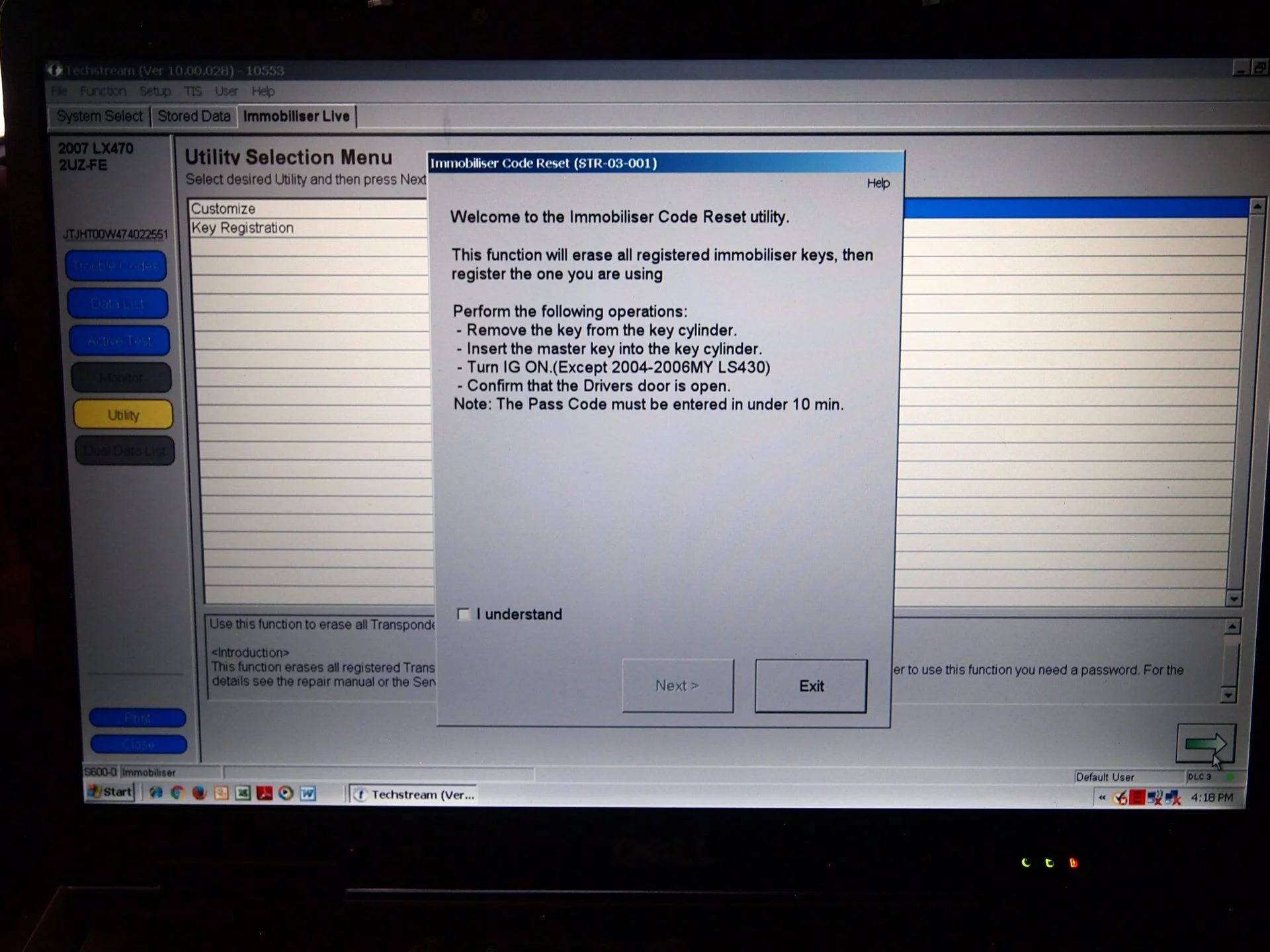

With only a working Valet key to work with. I used it to enter tech stream registration utility.

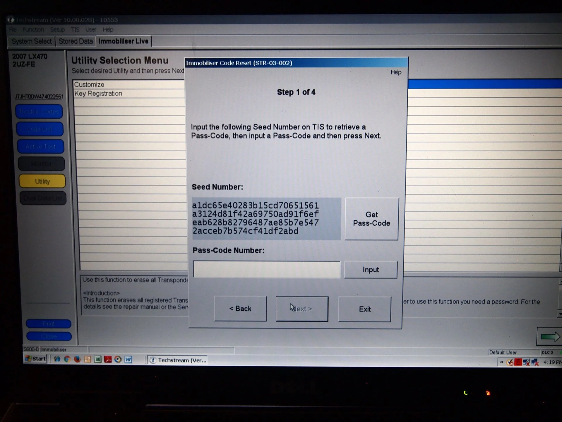

After entering Tech Stream and going through the processes of obtaining a seed number (96 chars) to get a 6 digit Pass-code from this web interface: LEXUS, SCION, TOYOTA PASSCODE CALCULATOR / GENERATOR: Calculate Pass-code by Seed number | Immobilizer Pincode Calculator (official website)
Then inputting the pass-code into tech stream immobilizer registration utility within 10 minutes. It starter the 16 minute timer as it proceeded with registering process. I used the only working key I had: The Valet key in IC switch ON, drive door open and unlock all others closed.
In the end it gave option to register chip, by inserting key, turn IG on. I could not add the master shell key w/FOB (which includes transponder chip), at this time as I'd hoped. I had it, but not yet had it cut. Plan "was" to just insert the tip of the key and register it without inserting all the way on turning IG on. But tech stream require inserting and turning IG on.
So I elected to end registration with Valet still in IG. Hope was Valet was now register as master. If so, then once I got the master shell key cut (w/Door FOB), I could come back, and avoid the retrieval process to get a pass-code, and just register a new immobilizer chip (the master shell w/FOB).

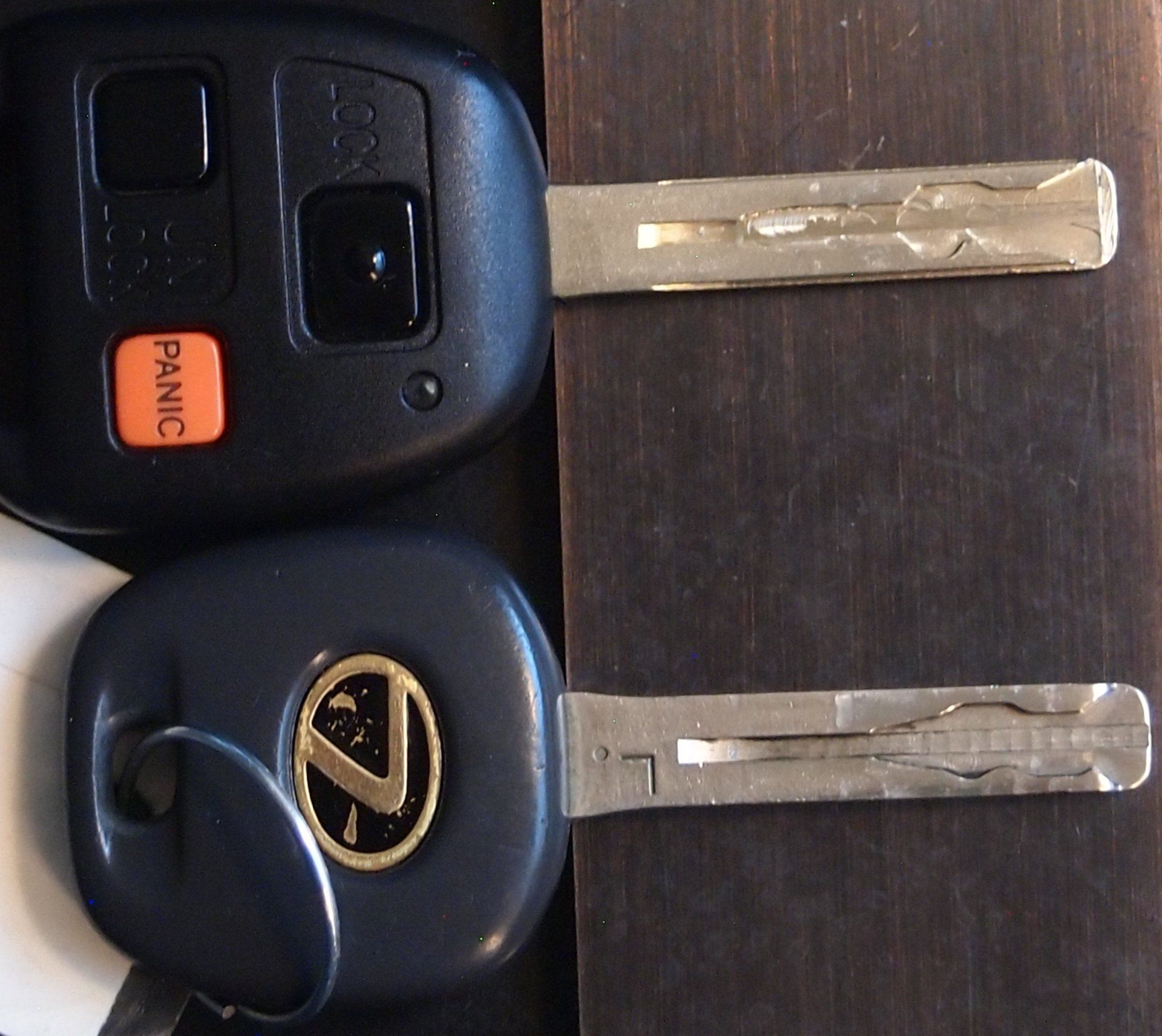

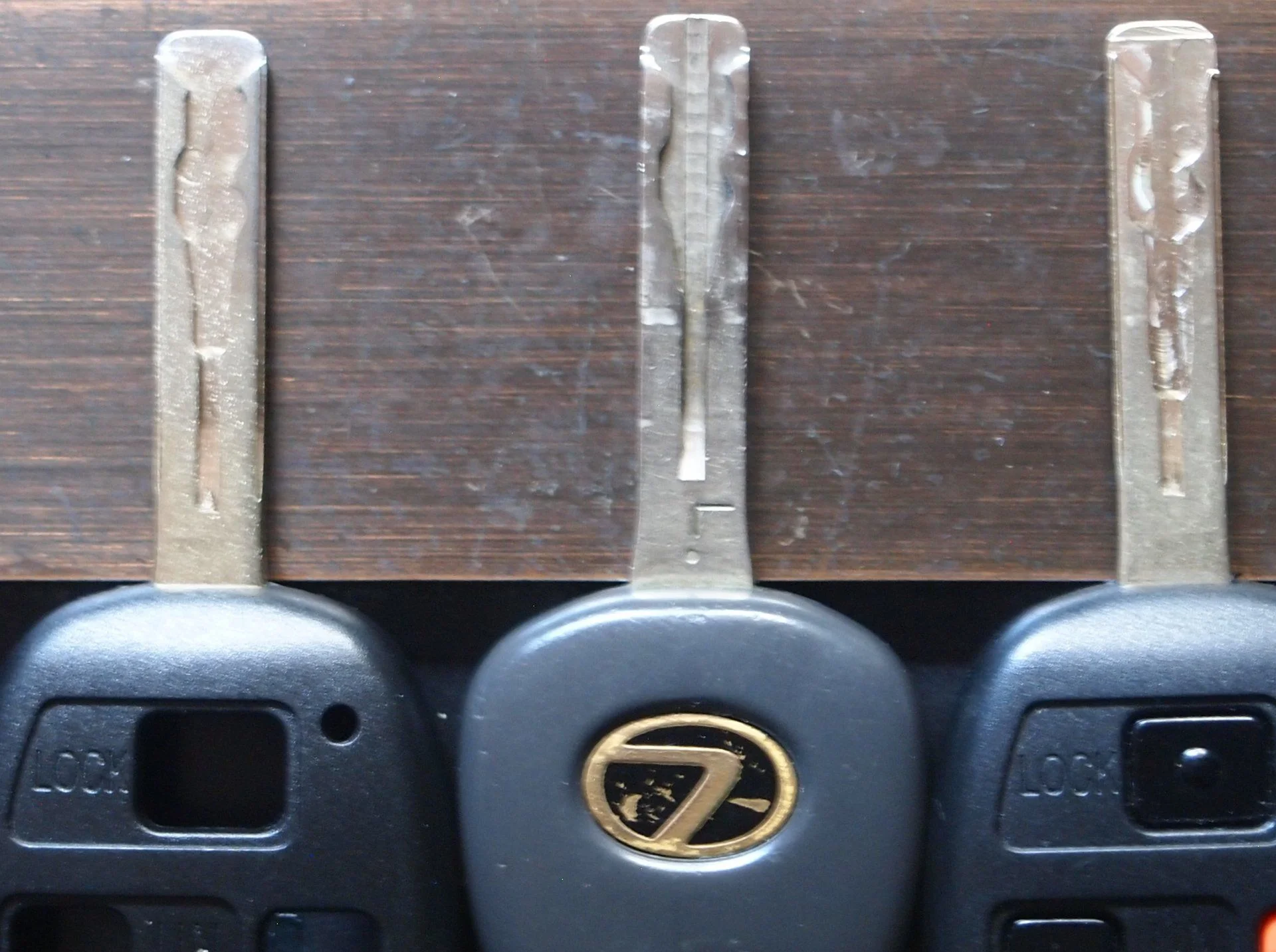

Here's the Valet and the newly cut master. What do you think, does that look like the same cut?
no, they don't look to be the same cut, I see significant differences. Now, whether that should matter, I don't know.
no not same cut at all....
I agree. Old has high spot new does not among other difference. If old valet was worn out it would not have the high spots. Also the inner flat surface looks like bit came down on it and penetrated too different levels. I'm so sorry I didn't just go to Lexus. They would have sold me a new shell for $50 and cut for free. Additionally they would give me the keys code (same code that come on the metal tag with OM packet) I just was on other side of town and had not heard form my parts guy at Lexus yet, and darn if I did not get cell coverage while at the locksmith trying too call him a second time. They owe me a shell and my money back if they can't do better.

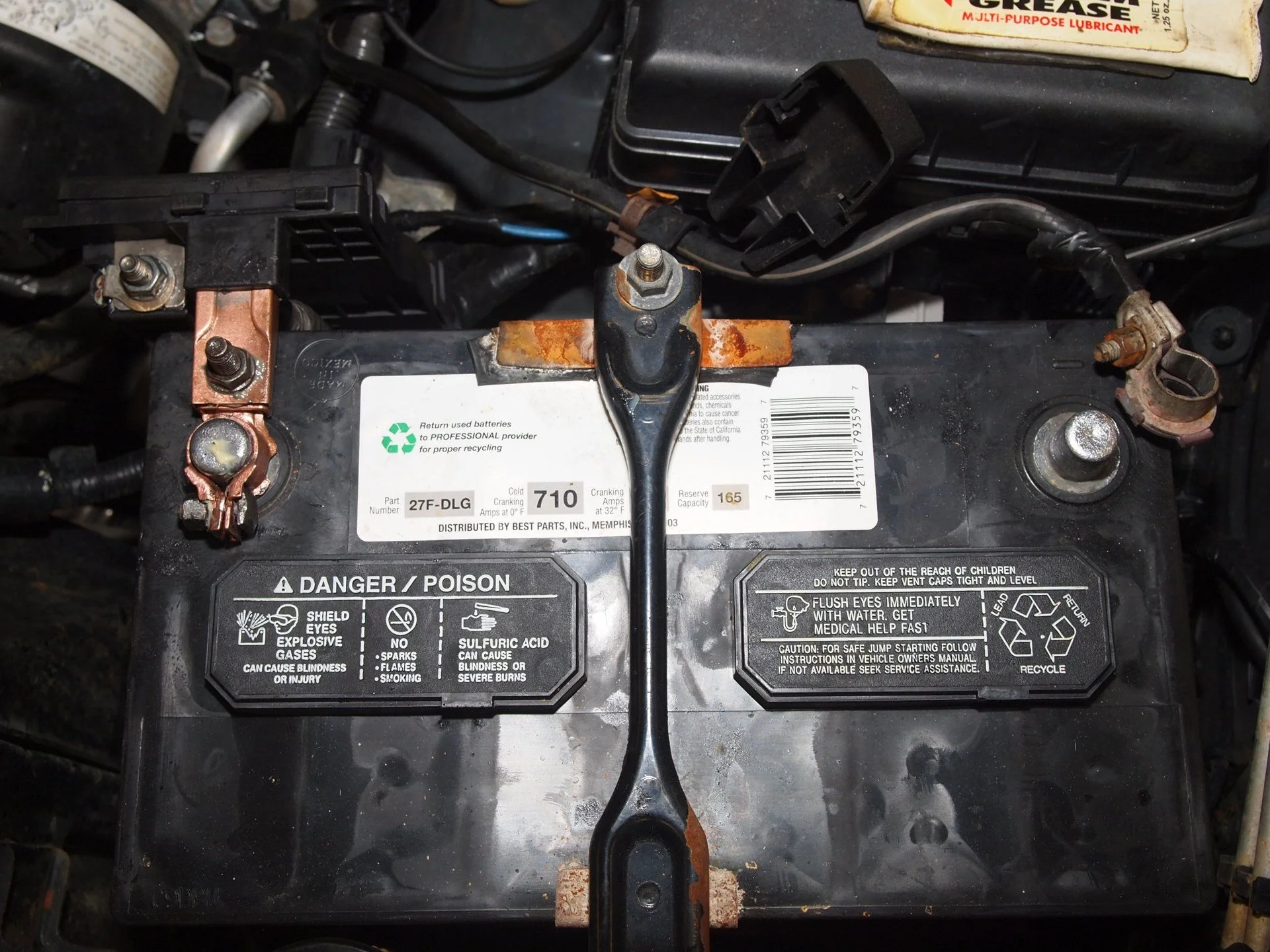

Car 12V Battery is a concern:
It's not reached 13 + volt yet (a March 2019 27F battery). The battery positive post clamp, when I bough this LX recently had some nasty hard white acid build up within clamp. It may have not been getting fully charged and sulfated. I had pulled clamp and the batteries main wire block apart and cleaned. But battery may have already be damaged. My charge is stated to repair this condition so I keep working it for now.

Obtained the Key cutting code from lexus:
I stop by Lexus Dealership this morning, talked with my wholesale parts guy to get key code for cutting key, based on VIN #. I just had to document ownership. I spoke to him about issue, asking if he's heard of a fail-safe mode or not have any key register. He had not. Said guys in shop mess up coding all the time and just re-do. But then they have the $2K Toyota handhelds diagnostic tools to enter Tech Stream. When I grow up I want one..LOL
Stop by Locksmith and had key re-cut with code in hand from Lexus. Much better but still a poor job. Seems they had a bad code and the machine needs servicing. But it works much better, but not as smooth as valet.
Today's cut on (left) based on VIN # key code from Lexus Dealership. Better match, but has deeper and longer cuts indicating their machine need serving. Guy basically told me this is the case.

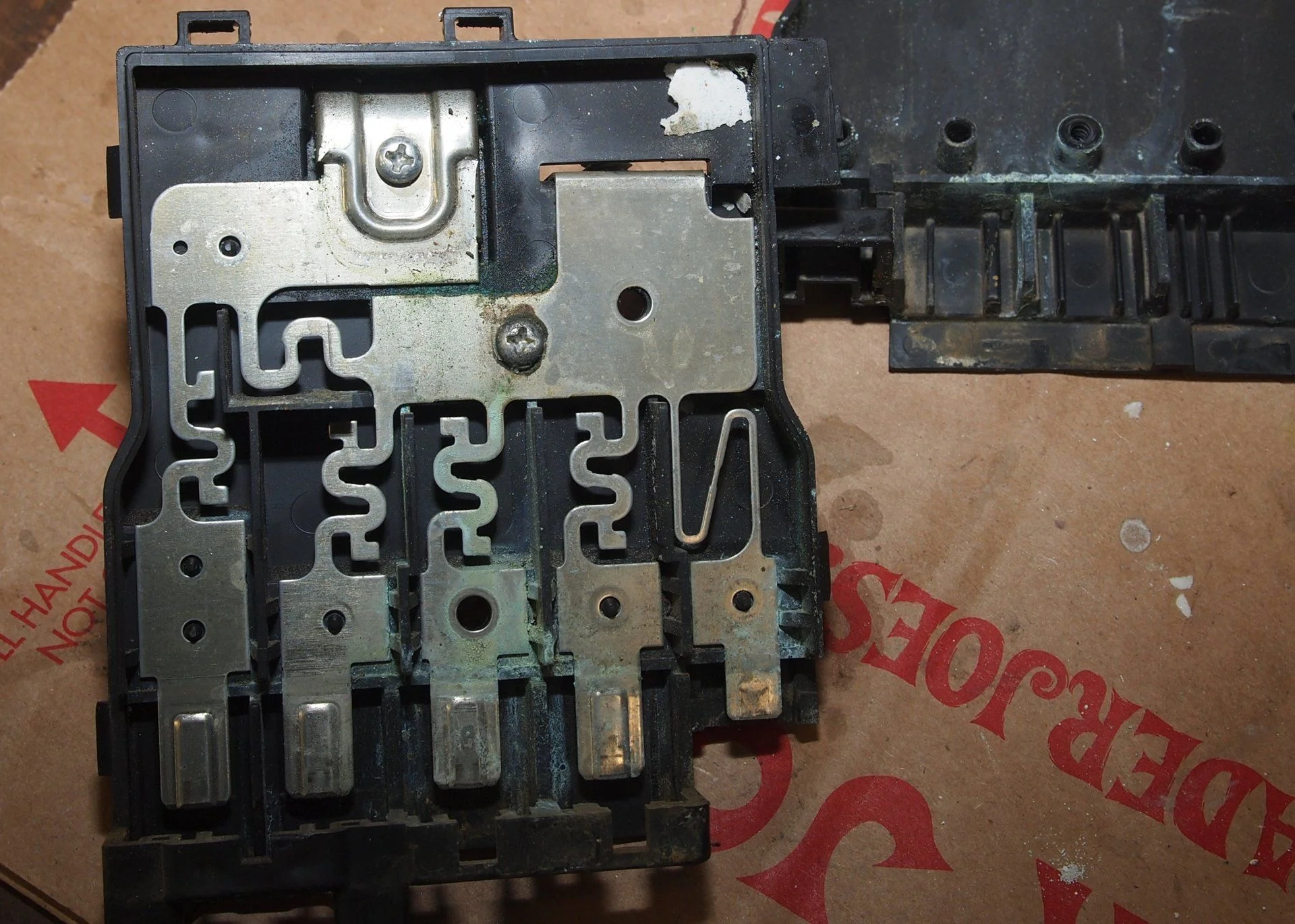

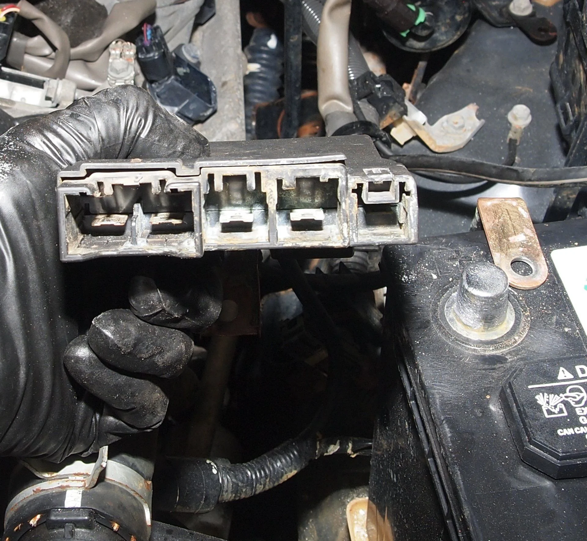

May as well show what I feel damaged new battery. I did this oh about 2 months ago, along with new OEM gas cap and fuel pump R&R. Interesting case I'll write up one day.
Seems new battery installed in march 2019. But baking soda neutralizing and may never had been done to vehicle in it's history. Acid (white cake) was deep into clamp and interior of terminal junction box. I kept hitting with baking soda and it keep fizzing. So I ended up tearing it all down and recondition.. The issue of resistance going up with corrosion and oxidation is something I think effects many system. Each new generation seems more and more sensitive to electronics working within tighter amp and tighter range.. 200 series now recommends removing battery clamps when charging, as of damage to electronics concerns.
Dealership has washed engine compartment (wish they hadn't). But I suspected they did not neutralize acid. Looks good, but I want to make sure, any acid washing down was neutralized.
I must have use 2 pound of bake soda, in three days before I took this picture
First tried brushing off cake. But end up tearing down.
Cleaned up and back together. First time I've done this.
FWIW.

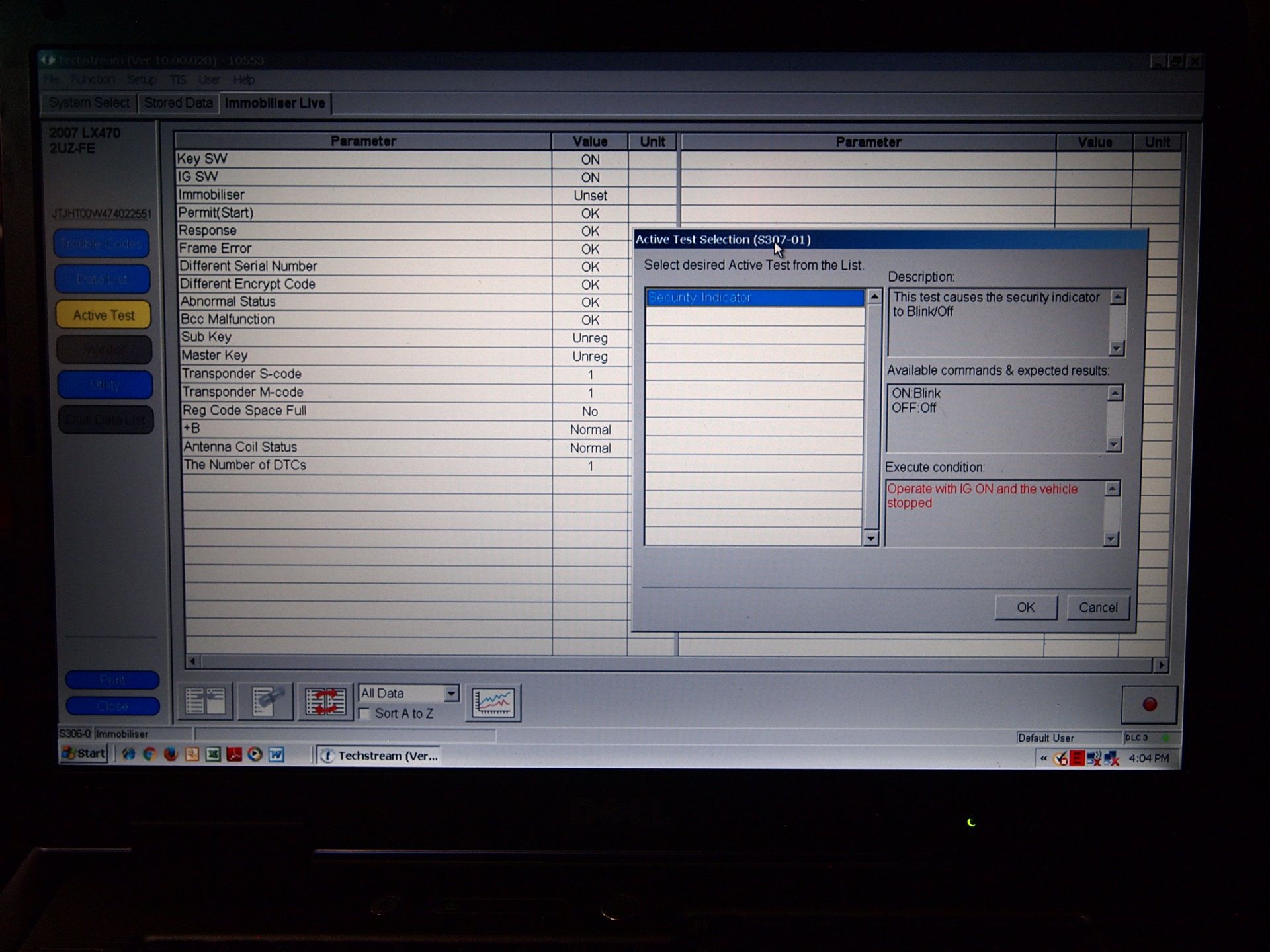

Security light:
Solid ------------------------- key out.
Blinks twice then pause ..-..-..-..- key in. Should be off!

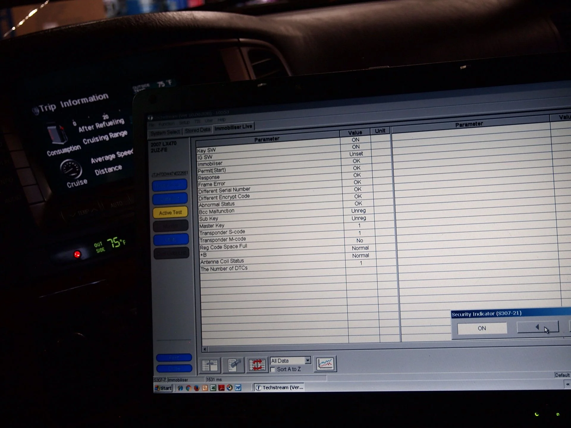

In tech stream active test mode, security light
Blinks once then pauses .-.-.-.-.-.- in ON test mode.
blinks twice then pause..-..-..-..-..-.. in off test mode. Should be off!

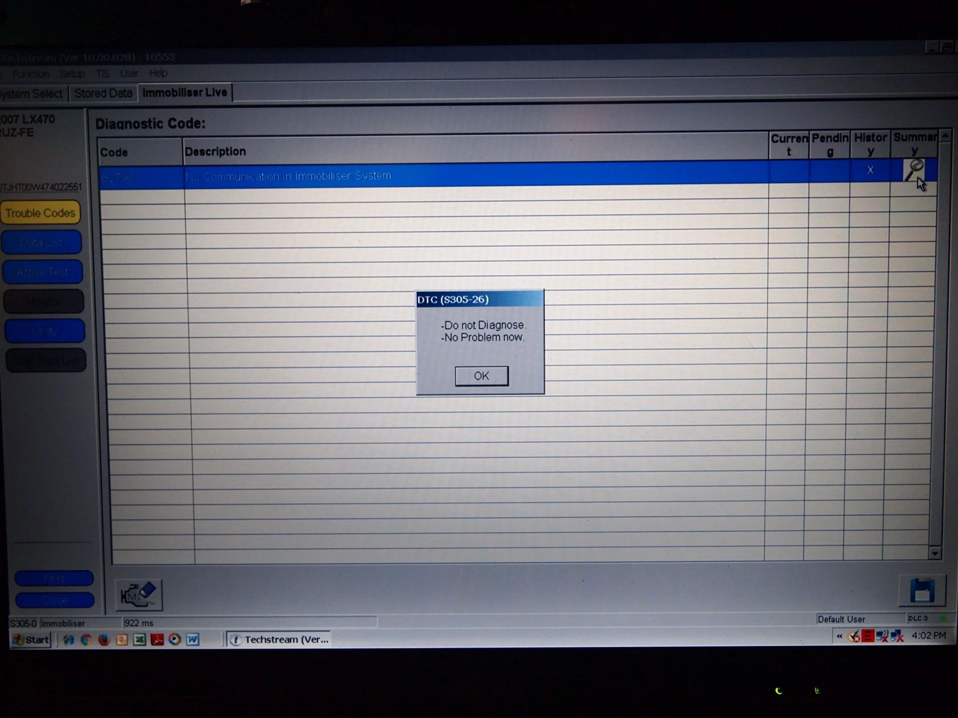

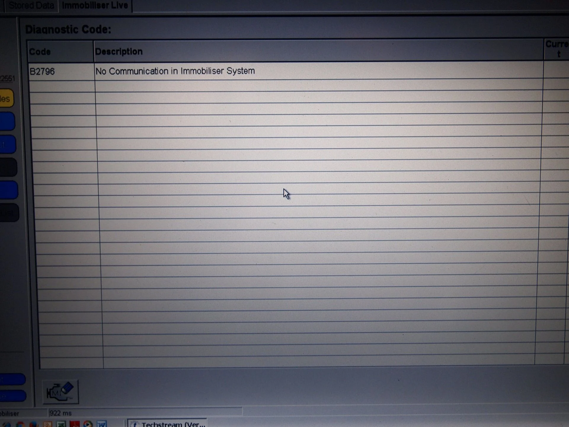

Here's diagnostic code B2796. First I saw this.
Here data list:
Is that snapshot of your datalist with your valet key in? I read thru your posts but I'm a little lost what you are now trying to diagnose. I think you went wrong at step one. You didn't have a master key inserted at the beginning of the reseed process. From what I remember that kind of sets up the rest of the procedure for success. Reseeding in general is a pain. I am the only one at my dealership that does them because the steps and inherent complexity involved require patience. I will try to re read your posts and see if I can make heads or tails of the 3 keys you used...
My recommendation is to try reseeding again with a master key. In the datalist you pictured, immobilizer is unset. What is confusing is that there is no master or sub key recognized at the time the immobilizer is unset, indicated by both master and sub key being "unreg" or not recognized as being inserted in the key cylinder. It is like it doesn't know where it is. Which is why I recommend starting over. Did cycling the key or the brake pedal kick it out of auto registration?

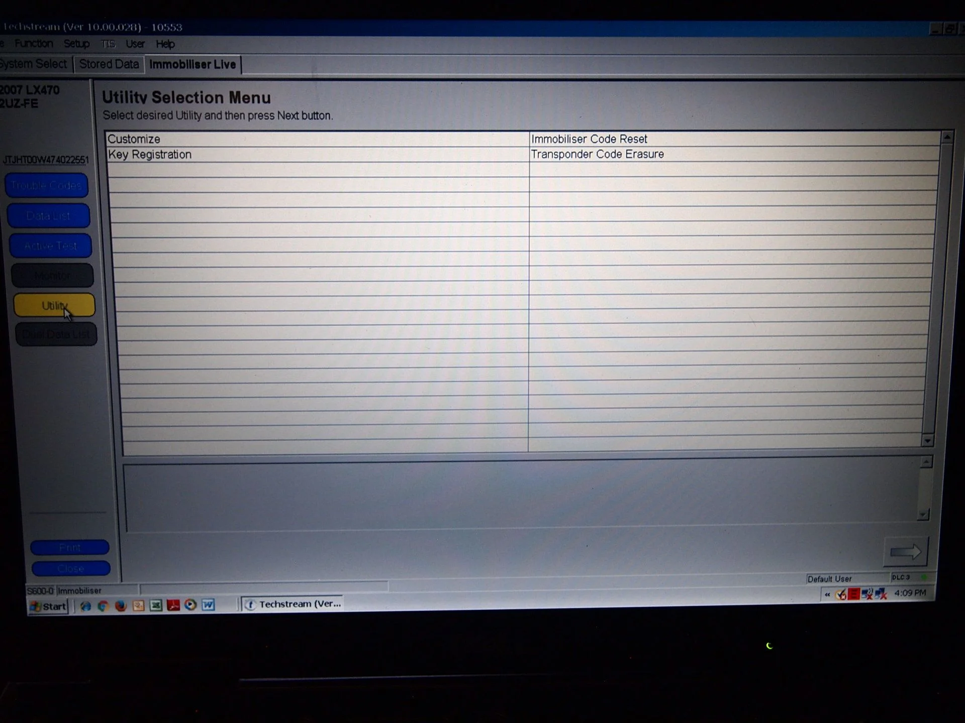

I started with only a valet (sub) only, as I don't have any master or flat key in box. 07LX came in without any thing but Valet.
Entered Tech Stream Immobilizer interface with Valet.
The system requires a master to use "Key registration", which I don't have. Would have been so easy!
So I used the Immobilizer Code Reset function with Valet key to get the 96 seed char. Inputted that in web page posted in OP.
To get a pass code and inputted it.
Timer began an instructed me to wait 16 minutes. Which I did without changing a thing. I waited until instructed otherwise.

But security light is sold key out, and blinking key in. Date show no key registered (Master Unreg, Sub Unreg) But engine does start.

Thanks for clarifying about the older subs. I was unaware any could be made masters. Must be before my time, as I have never been able to make a sub a master.
I was certain that I added the original grey valet as a master on my GX, but must be wrong since the new valet cant be made a master. I will try to test it later, but it is wired under the truck and the bottom of the truck is caked with mud.
Thanks guys for the help.

Some more question?
When cycling brake pedal 5 time, what state do I have vehicle in?
Such as door & IG switch, i.e drive door open or closed, locked or unlock, key in IG, IG on or off or just cycle pedal in any state.
Could I be shut out of tech stream and engine start with no working key?
So what do you think. Brake pedal gets system out of reg mode (exits) and it will have the sub and the master register. Or back to where I started and just the sub (Valet) working or shut out with no working key at all. My biggest concern at moment, is I getting system to normalize by cycling brake pedal 5 times, and then no keys chips registered. Than I can't get in tech stream or engine started. Hope this acts as door FOB receiver and keeps last or key used in reg.
Do you think it took (registered) my master shall key w/FOB. Or is just now recognizing as a usable chip in this "fail safe" state?
When I just pressed into IG slot with uncut shall key w/FOB, but not able to turning IG on as TS instructed. Did transponder it read the chip and registration it. Now, that is why both old Valet and new cut shell w/FOB start the engine. Or is it just that it's now sees as a workable chip and allowing in this state.
So you're thinking it was possibly my tech stream version 10, that kept system from exiting and completing registration?
Possible gave me wrong instruction (cycling IG) or did I mess up or could vehicle have a fault.
Is the DTC B2796 I'm now seeing, likely just do to not getting exited and state systems is now in or is it more likely I've a fault?
Similar happen while programming in the door remote. It ended up being two fold issue. The FOB was wrong transmitter for the year (Amazon seller wrongly listed as for 06-07). Also as it turned out the receiver was dead. Made for interesting first time doing a FOB registering. This transponder (immobilizer) has proven more so changeling. This my be why or in part why this 07 LX came to me without anything but a valet. Someone may have just became to frustrated they smashed it all to pieces...LOL
How can you tell what chip a key or fob has i.e. 4C or 4D etc. Is their a chart or some type of tool that reads these to identify chip?
I'm guessing, that Toyota vs Lexus have different transponder chips in-bedded in the 06-07 FOB. As PNs # different, but yet door transmitter the same frequency size and function..
