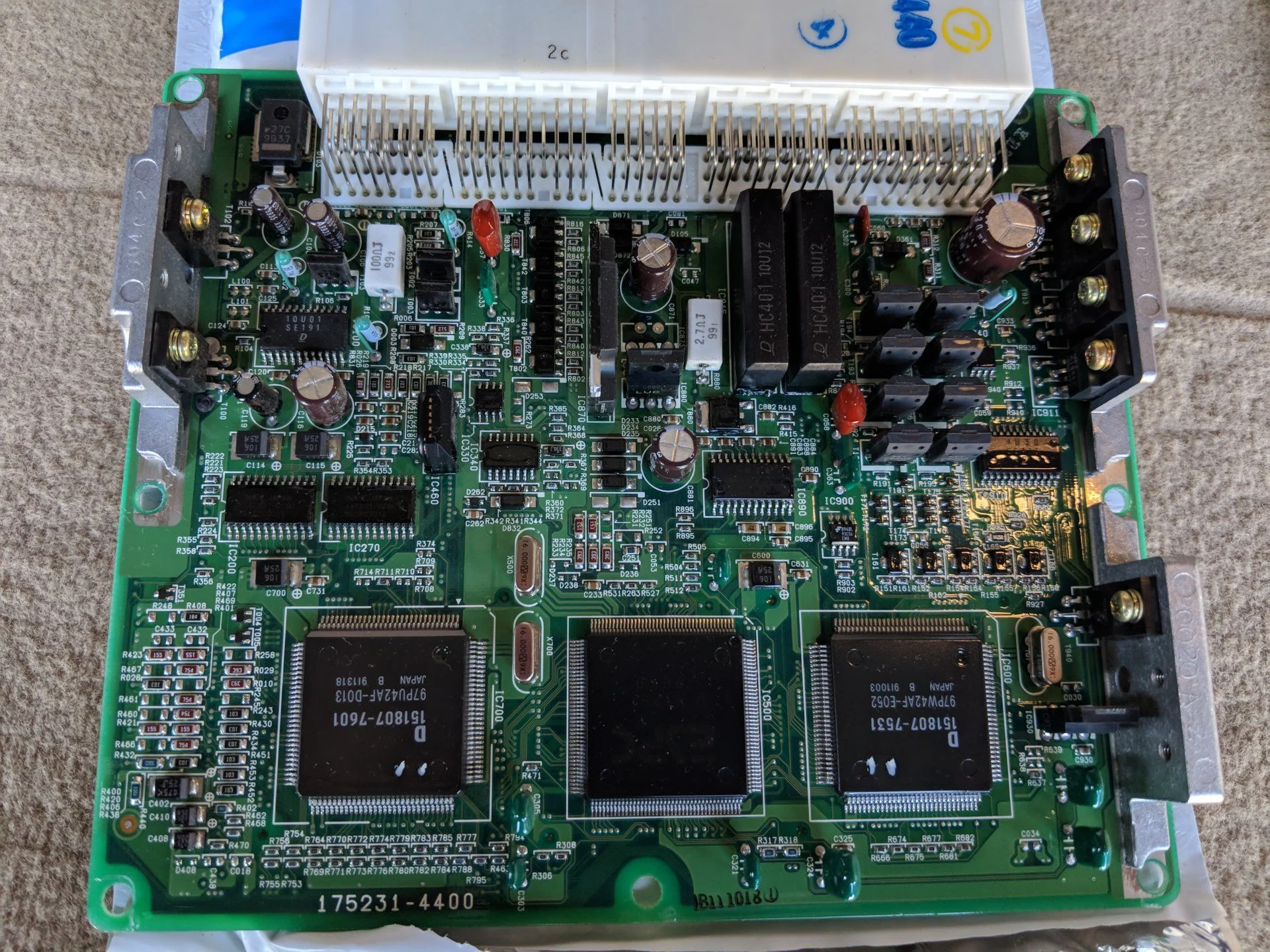

3) Got a free, virgin IC900 immobilizer chip from Mauser, who graciously offered them to anyone who needed one. This was also an exact match to the OEM chip on the ECU (centered, horizontally, below the right, red plastic cover):
4) I picked up an affordable rework station from Amazon, did a few practice runs on some old circuit boards and got to work.
5) After reinstalling the ECU, it was automatically in learning mode when I inserted the first key. I followed Mauser's instructions for programming the two masters and valet key.

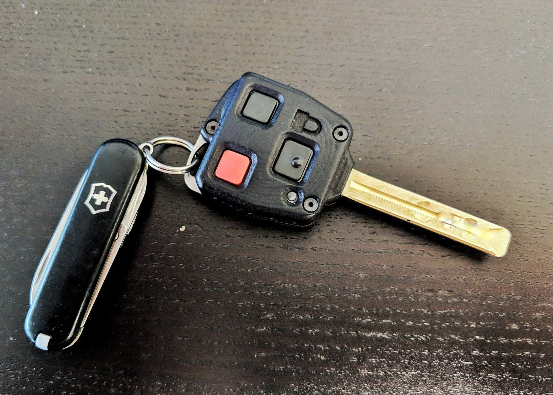

7) Installed one of @suprarx7nut 's YotaMD keys because they're awesome.

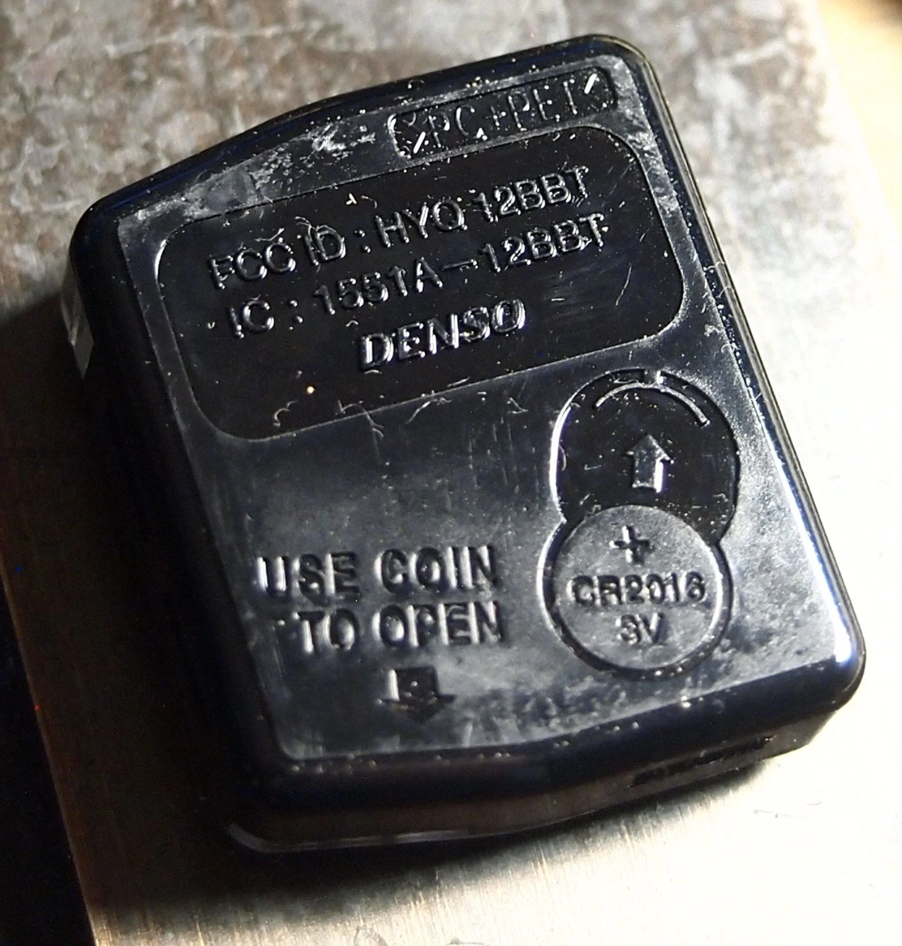

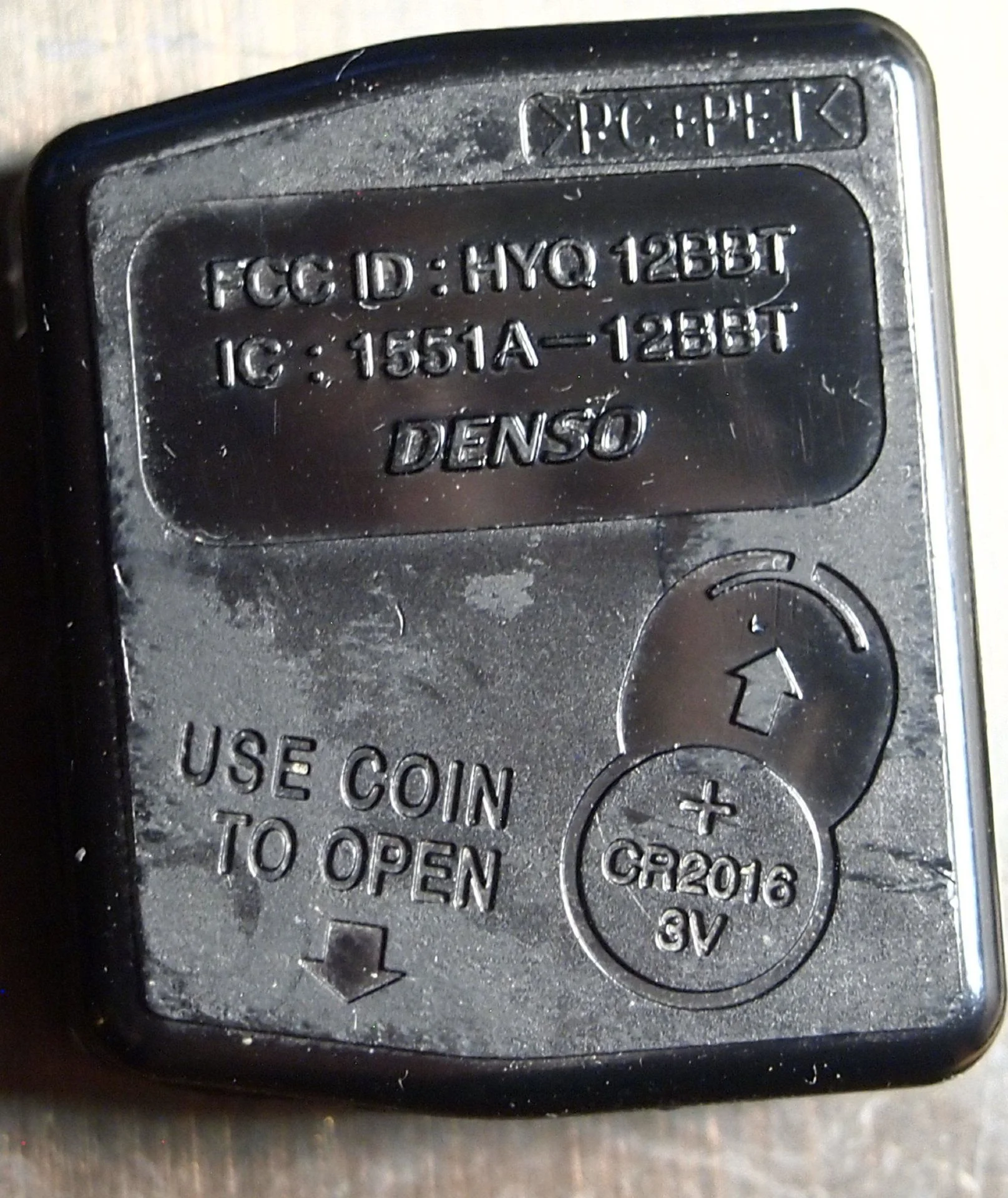

  1. 06-07 have a different FOB 12BBT (FCC ID: HYQ 12BBT, IC: 1551A-12BBT). Every signal eBay and Amazon seller I saw, stated the FOB 1512V worked with 03-07, some stated 98-07. I learned the hard way they're WRONG. 06-07 use 12BBT FOB.
  2. My receiver was inoperable. As it turns out, the 06-07 and likely other years share a dome light fuse with: dome lights, seat belt dash warning light, running broad lights, courtesy lights and receiver for the door FOB. Fuse is in the RH J/B (right foot wheel fuse box) DOME FUSE.

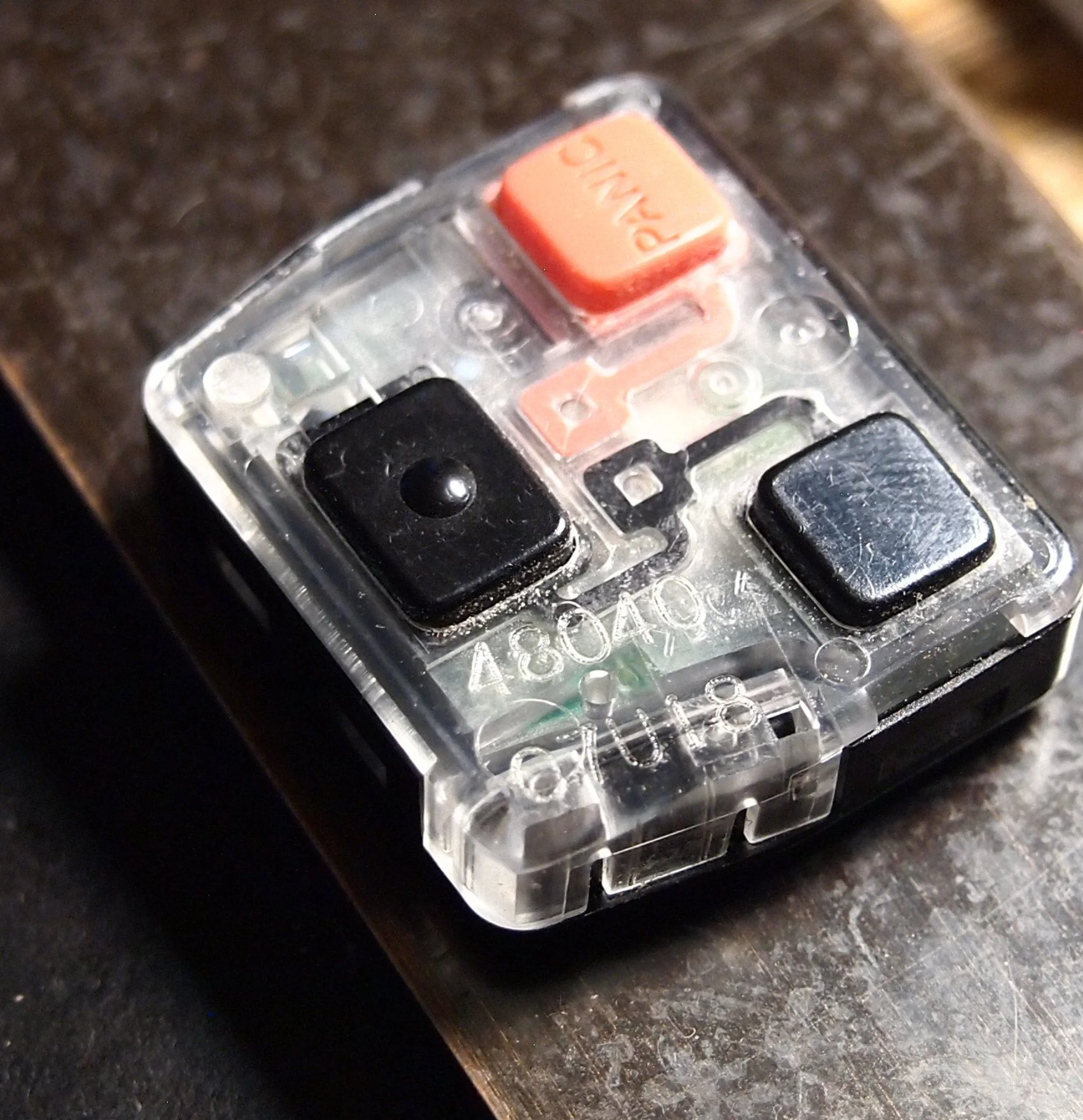

06LC Door FOB

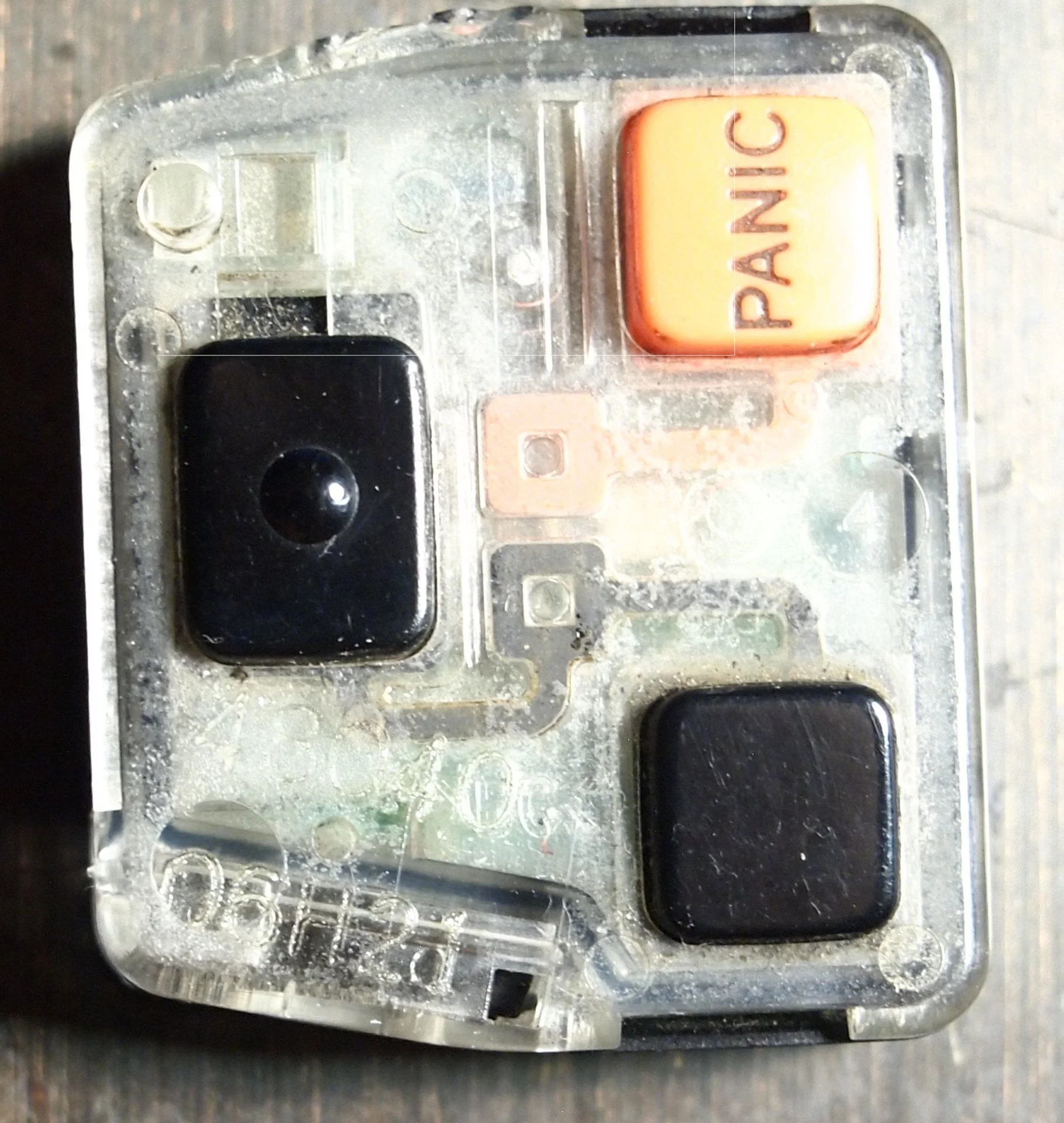

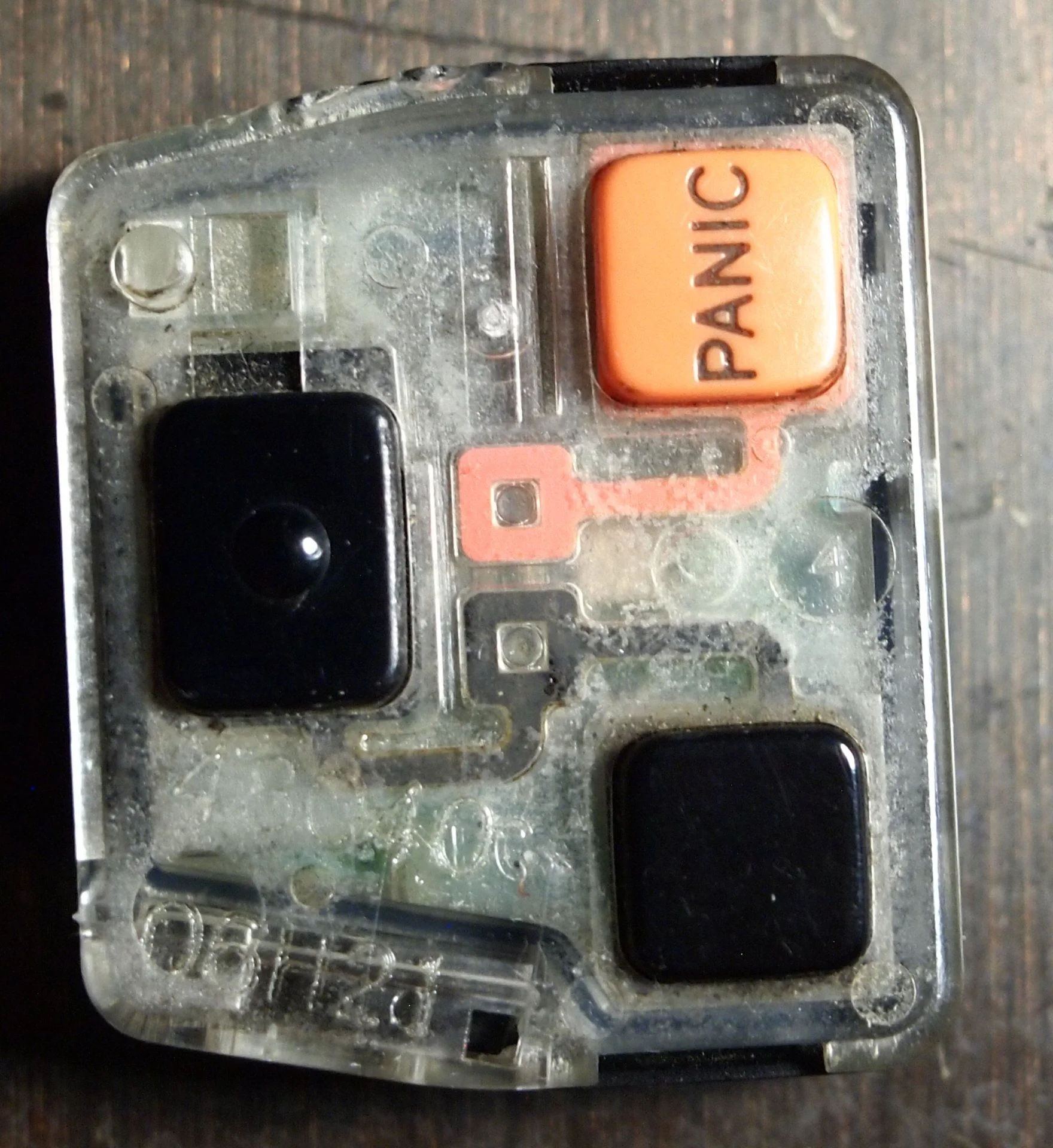

Below is 06-07LX. Or was sold to me as a refurbished FOB in a Lexus uncut short key shell, by a locksmith. So I don't know if actually came out of LX.
But it does have one difference in the numbers on the clear side of case vs my 06LC FOB. LC - 07U18 vs LX - 06H2d

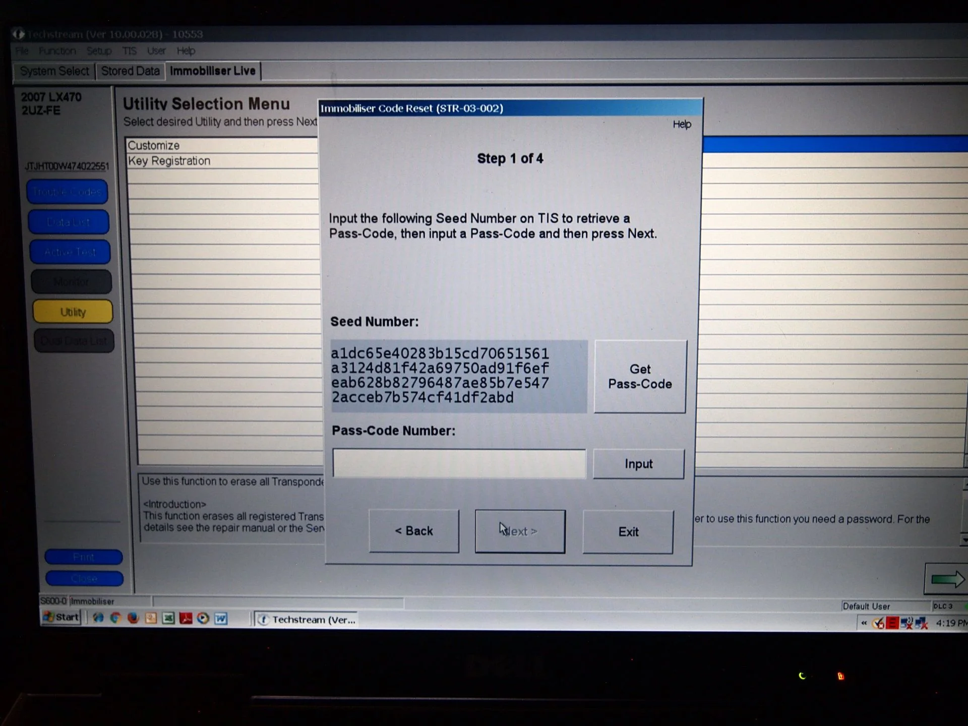

There is a web page, that will produce the 96 seed char by inputting VIN # that is needed to get pass code to enter tech stream without a master. This was not available in earlier 98-02 models.
