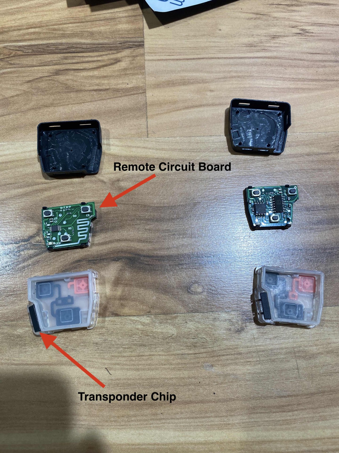

Last night I successfully got keyless entry working, thanks to the generous @90WT who donated me his extra aftermarket LX470 blank (which I gutted for the electronics).
It seems the problem was the remote itself was incompatible. Since the remote electronics and the transponder chip are different pieces, I just swapped the remote's circuit board into my key and now I have a key that starts the car AND works for keyless entry!
@90WT has a 2005 LX and I have a 2000 LC, the transponder chips are incompatible. His is a 4D chip, mine is a 4C chip. Check out the following picture:
Some things I learned which may be helpful to others:
  • Be careful when you take apart the key fob "brick"... the black housing (top of above picture) plastic is fairly brittle, so take your time with a tiny flathead screwdriver popping the tabs. There's a side with two tabs right next to each other, I recommend starting with that side when prying it open.
  • You can program remotes independently of the transponder chip. You do not need the transponder chip programmed to do this.
  • Order the correct transponder chip for your year of vehicle. 4C for a 1998-2002, 4D above that and I think some 06-07 need a different one 12BBT or something. (Look it up)

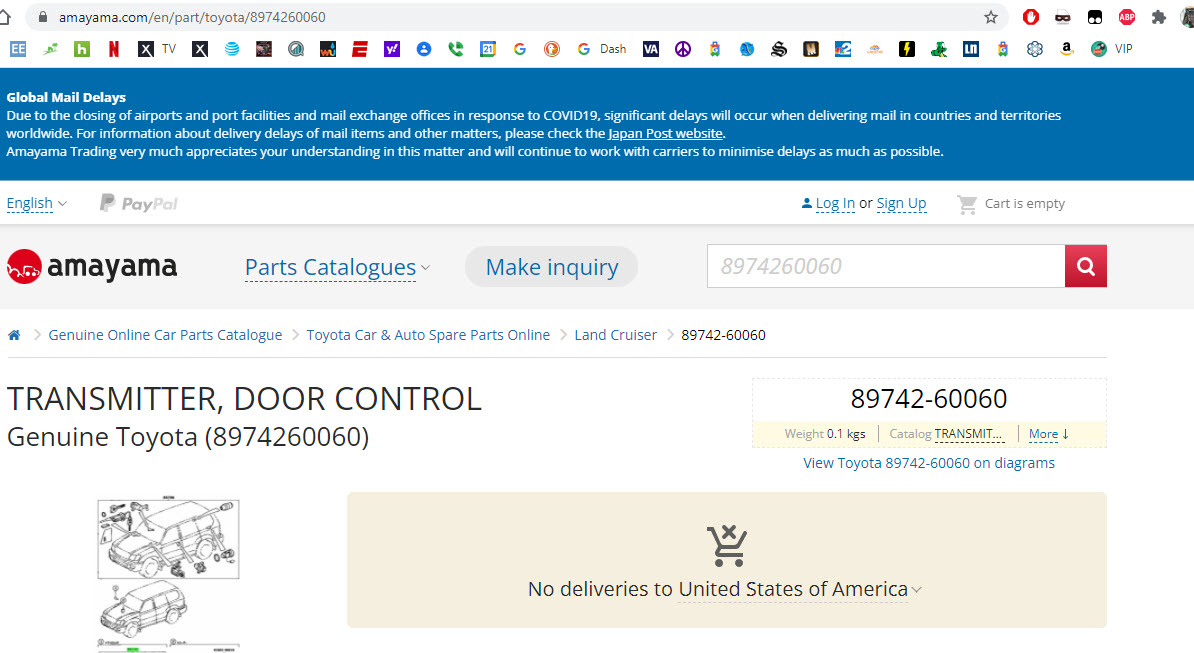

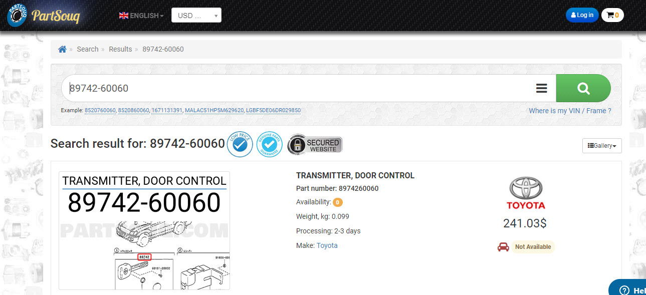

(Toyota seems to be pretty proud of that thing) I hope this helps you out. I didn't have more time to search but here's a start maybe. TRANSMITTER, DOOR CONTROL 8974260060 | Toyota Parts | PartSouq - https://partsouq.com/en/search/all?q=89742-60060
yes, i have tried these 2 sites, no luck also.
i did contact the local dealer, the key have been discontinued.
Sorry to hear that. I'll continue as I can to see if I can find one.
This site is another, I added it to my cart but will likely end up with unavailable.
