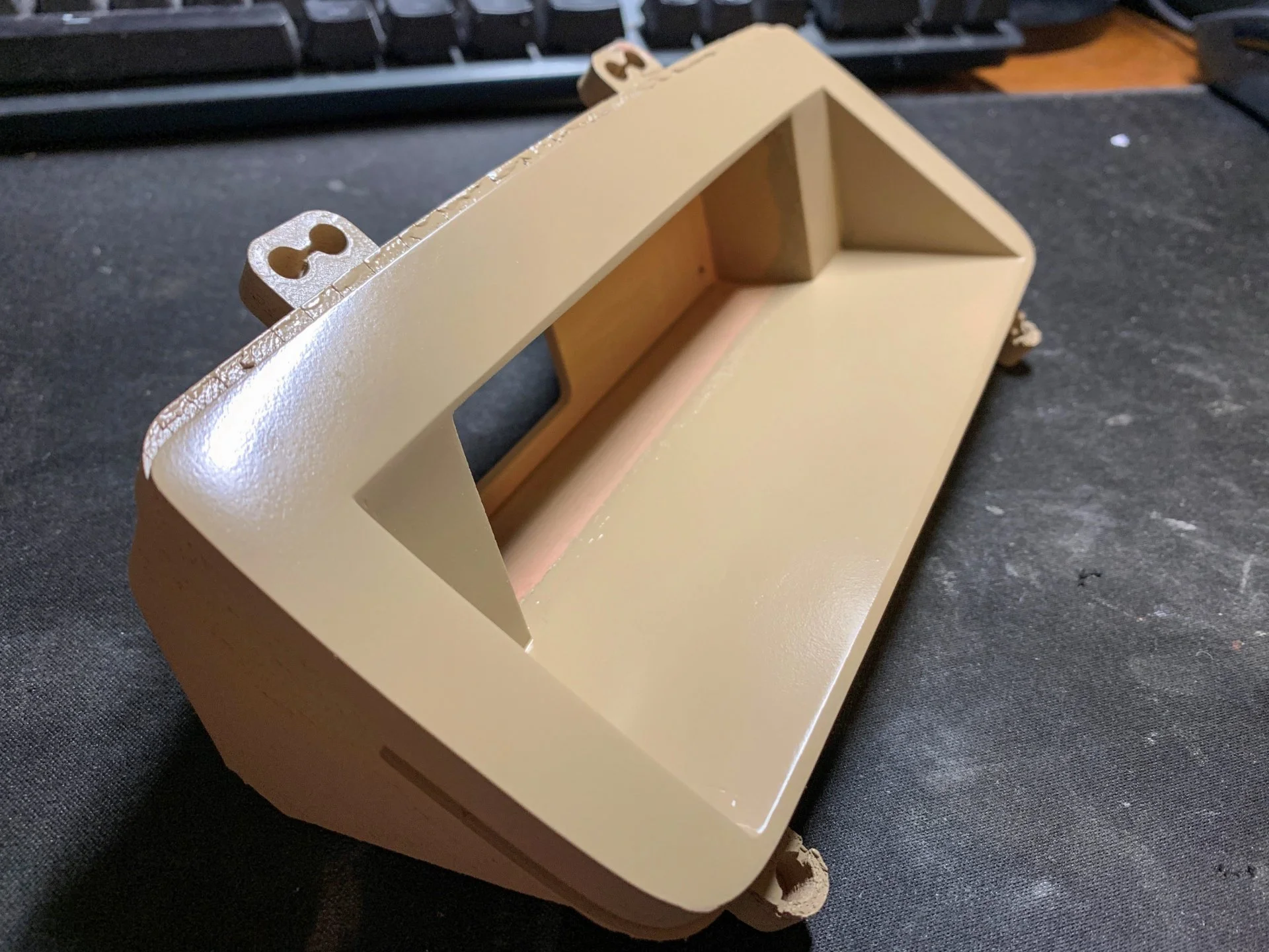

Use glazing putty. It's a much less viscous version of body filler and fills in all the tiny layer lines very well. I had a Scangauge mount printed for me to replace the sunglass holder in the headliner, and I completely smoothed it over with a few light coats of glazing putty using a plastic squeegee and wet sanding in between each. After that it can be painted whatever color you want, I chose the Dupli-Color Perfect Match BTY1596 Khaki. I could do a lot better if I did it again and didn't rush as much, but I still think it looks great
EDIT: I would not recommend wet sanding because different filament types have different sensitivities to moisture. Stick with dry sanding

do you by chance have any photos of how well that color is match to the tan 100 series interior ? trying to find something close for the upper storage console.
Duplicator "khaki" is a great match for the tan interior in my truck. Not sure if shades differed at all between models.
Now that you mention it, I'm almost positive this was the color I actually used. I got several and tested them on small pieces of sheet metal first and I'm pretty sure sure khaki was the closest.

This is a super nice finish! I will definitely try that out on some switch panels soon!

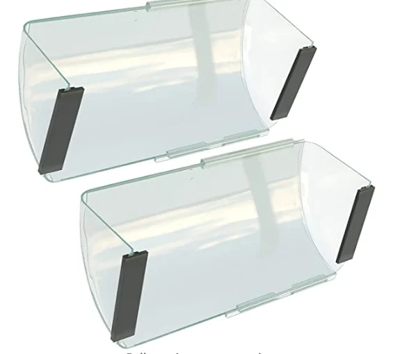

I saw your concept drawing for the rear AC redirect, I know it is just a concept but think the unit itself is too bulky. How about something like below? I actually have this on my house hybrid water heater to redirect the cold air coming out of the side. But something to this effect is much compact, similar idea like you see on AC vents in commercial settings.
From what I can tell , the thing with this design is it will only turn the air down. The idea of the vent redirect is to turn the air specifically forward in to the 2nd row area. If thhis did have enough of an angle to get air pushed forward then I dig it.

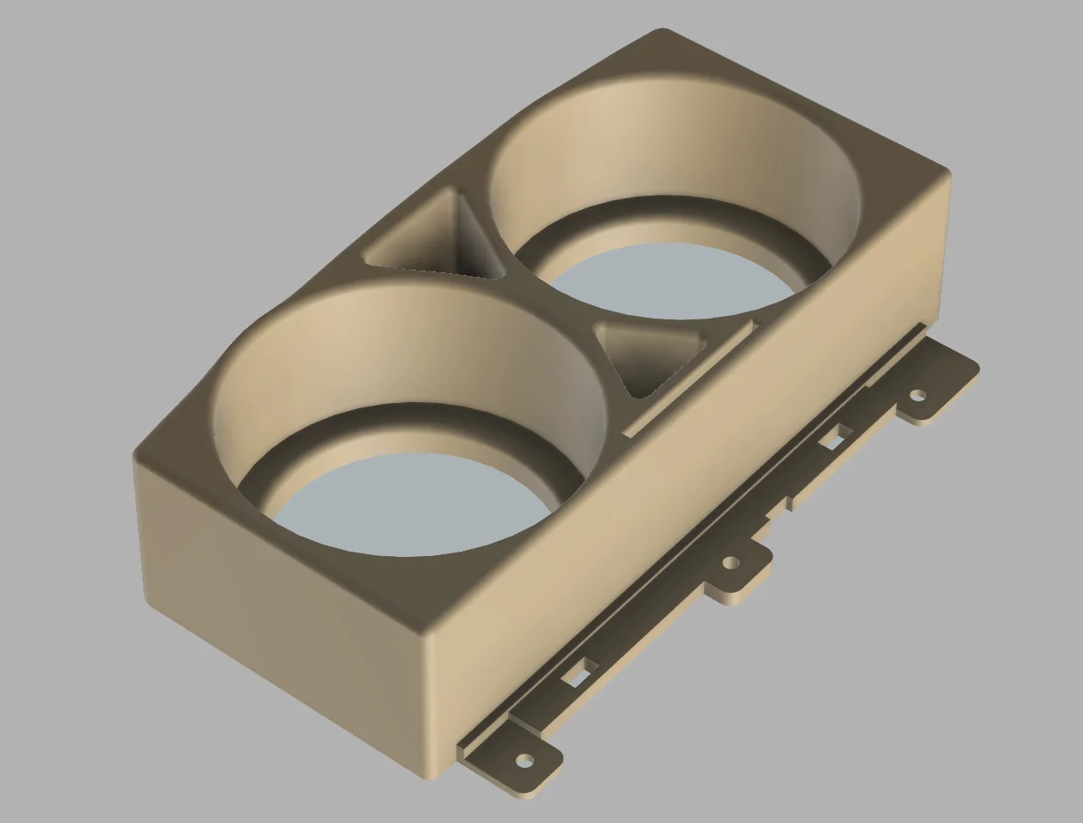

Also! The 100 series cupholders have a new option. I've added a credit card slot and a couple cubbies for pens, lighters, and whatever other garbage you fellas like to carry around in your rigs. No additional charge, and you can still order with or without. Here's a rough render, printing the first one now.

Great idea since one side of mine is used for pens and a tablet stylus.

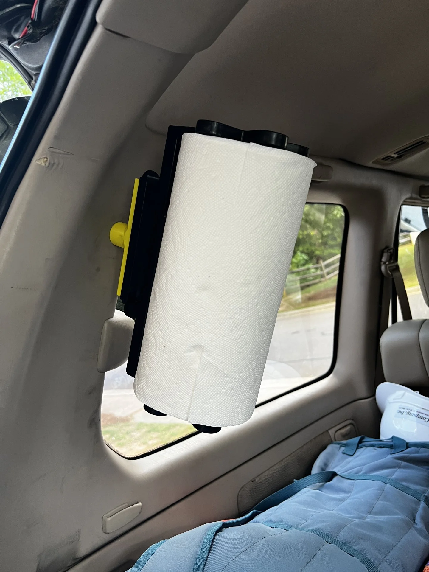

In the meantime, I've produced a couple new things. Most excitingly, mounts for the third row seatbelt bolts. This is for those of you who just don't run the third row seats or have installed a drawer system, and have those huge holes where the third row seatbelts went.
The first of these mounts being for the camco paper towel holder. This thing is super neat because you can slide it right off of the mount, and carry it around! Perfect for having a roll at camp, having to work on your rig in a pinch, or just a good old fashioned tailgate. see some pics:
I'm working on snugging the mount up just a little closer to the trim panel, but you can twist it horizontally or vertically by hand and the door shuts no problem! Rode around with the windows down for a few and there's a bit of wiggle in the camco holder but nothing crazy.
I would probably just store the roll and holder in a drawer if I was going for a long windows down highway trip so they didn't unwind and flap around, but should be no issue for an offroad adventure.
I plan to iron this design out and offer two more options, one for a QuickFist clamp (These things are great for holding axes, tools, anything cylindrical really), and another basic closed 3D Printed hook.
Probably looking at $40 for one mount or $70 for two. (Prices NOT including the Camco Paper towel holder ($10 from amazon), or quickfists (Around $10 per from amazon)
Let me know what you guys think, I'm pretty excited about this one.

How are these mounted? Are you using the seatbelt bolt or just attaching it to the trim?
