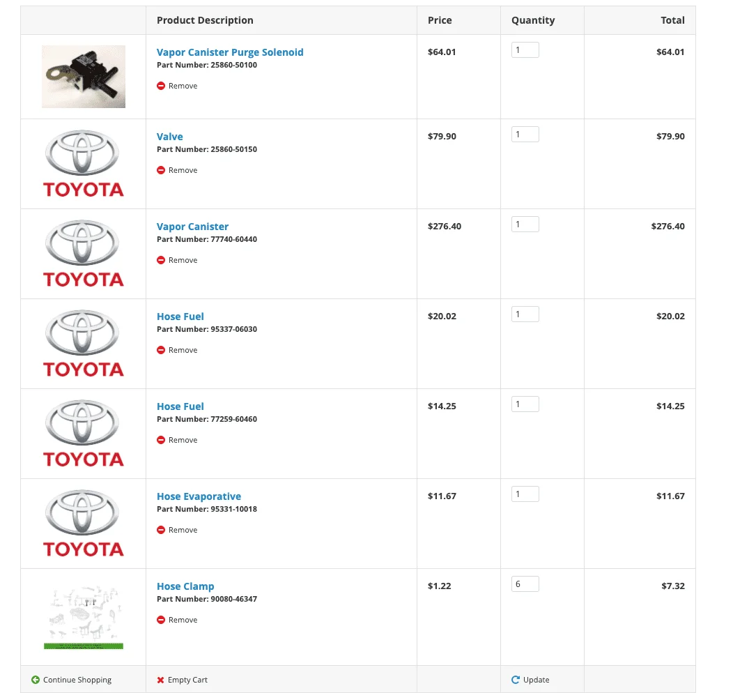

I'm still chasing this as well... So far I've done:
- Gas cap (didn't work last summer)
- Muffler (haven't test yet)
- Wrapped fuel lined with heat shielding (haven't test yet)
- 2 pre cat o2 sensors (haven't test yet)
Next up this weekend:
- Fuel pump
- Building heat shield
Then I'll order the CC, VSV and hoses:
I've been dealing with this issue over the years and I really believe its a mix of a couple different things. The fuel lines next to the drivers side cat gets REALLY hot so I think the trick will be to stop that from happening and then replace your EVAP system. Whats weird is there are several people on here that have said they have fixed it with just doing one thing like fuel pump or CC for example.
