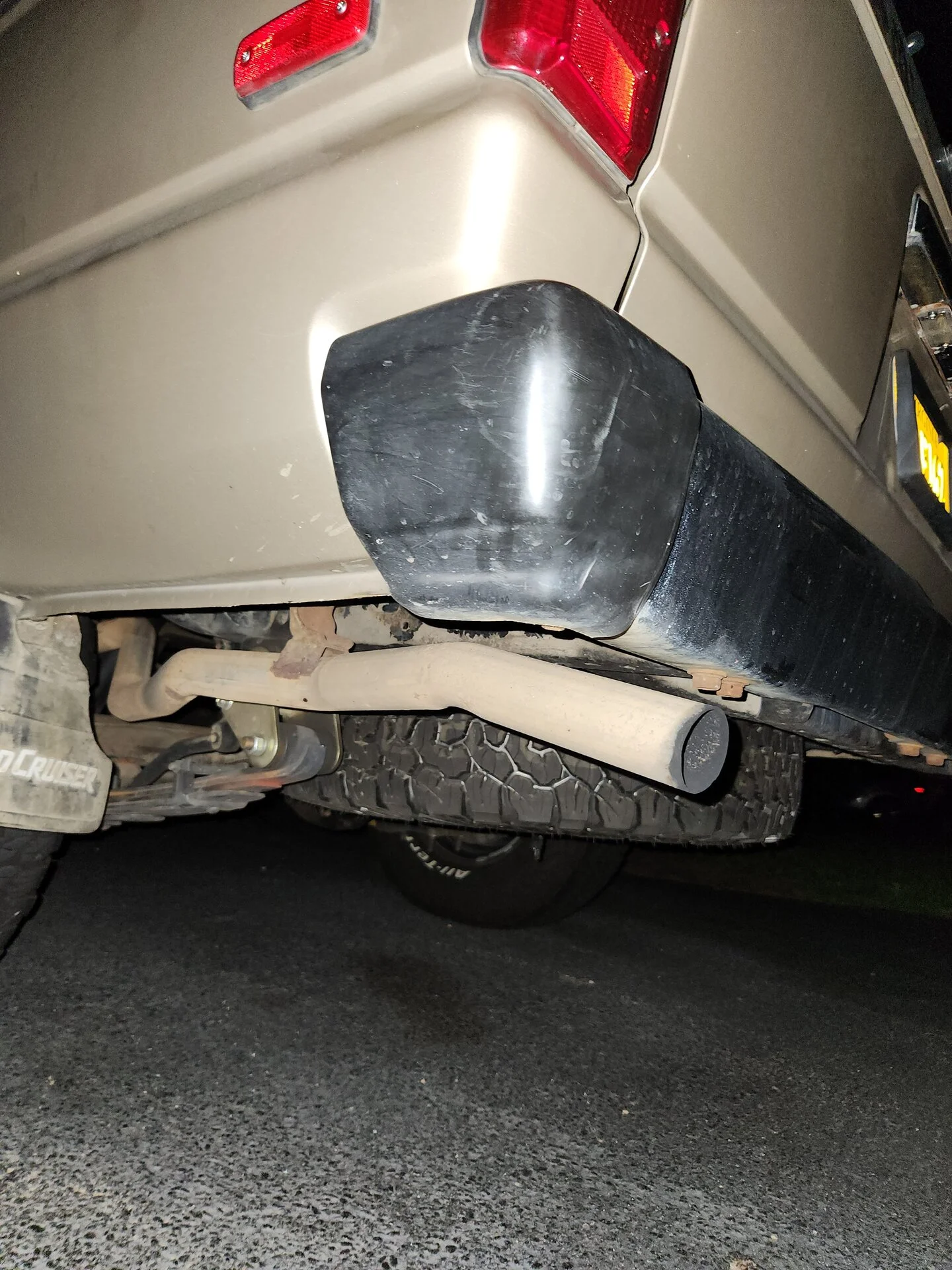

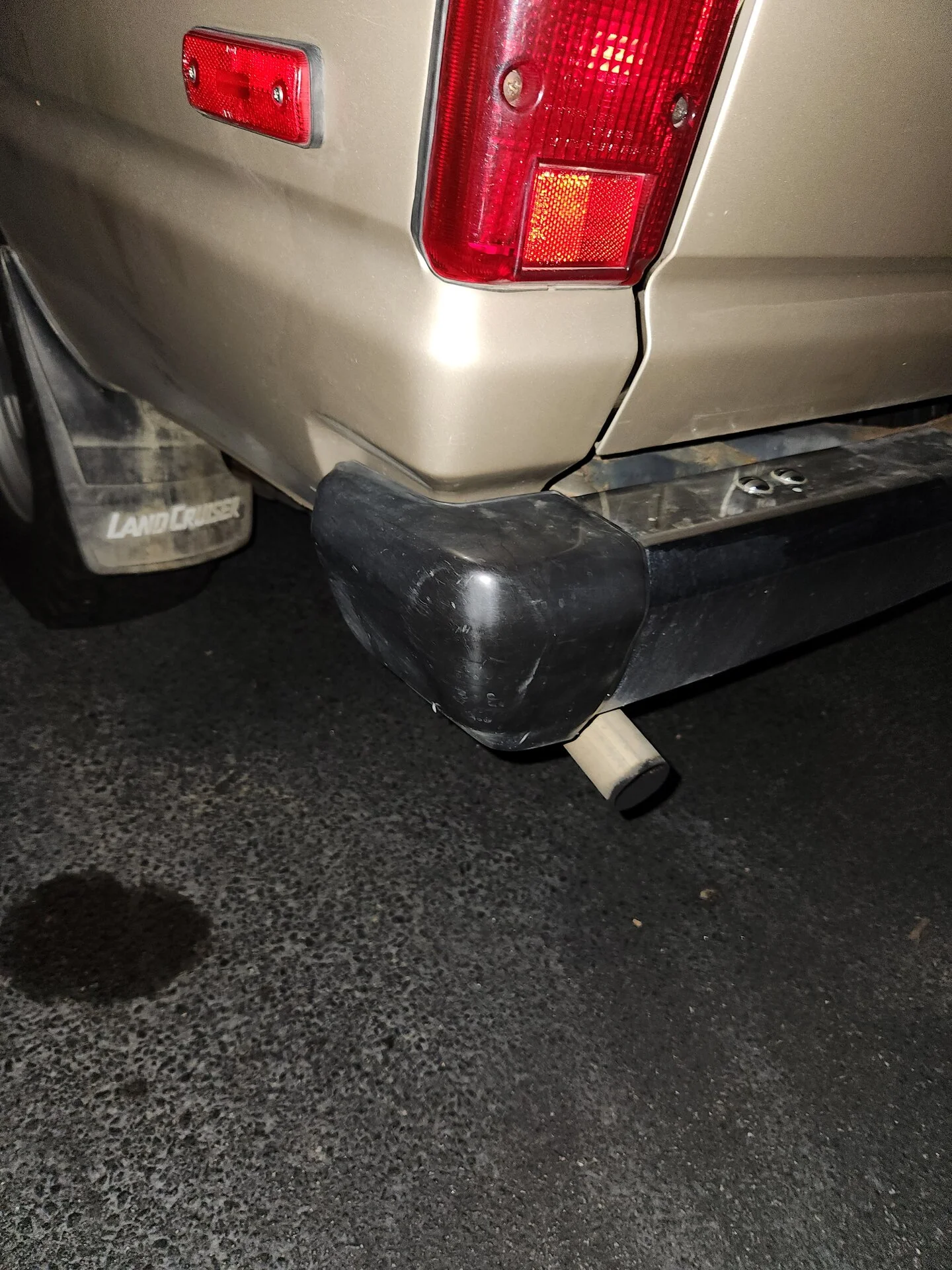

Here's my exhaust as I got it from the little old lady.

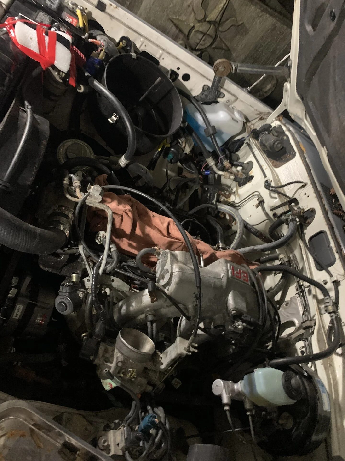

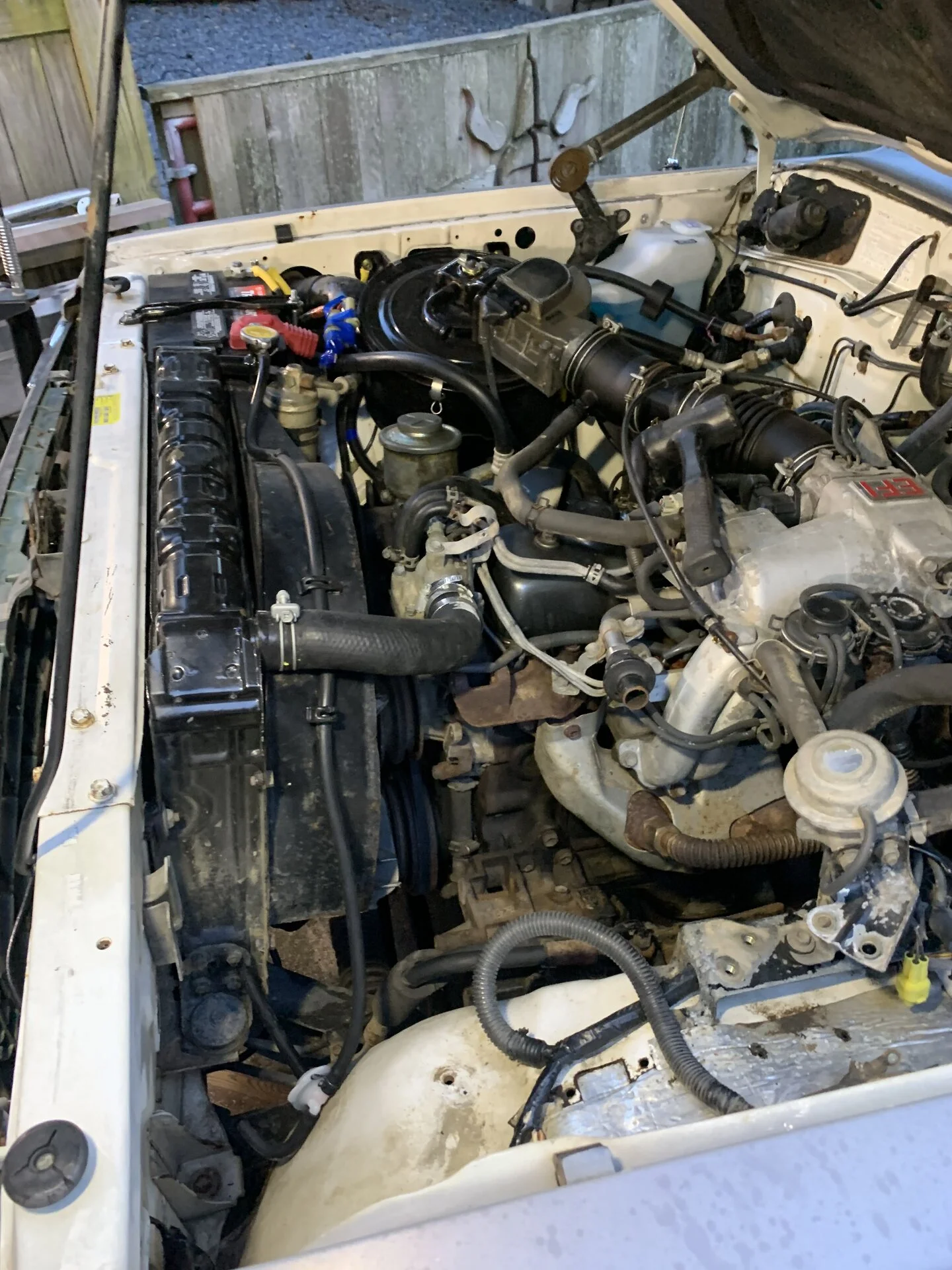

Finally the weather has broke and some much needed Hobby Enthusiast tech-time can occur
- the main areas of focus are the concept of my pipe-dream 100% TOYOTA OEM japan spec. 3F-E desmog kit parts ....
- i am well on my way and can report the KIT is installed and NO CHINA Dornman crap or silly sad USA made sissy drive belts either

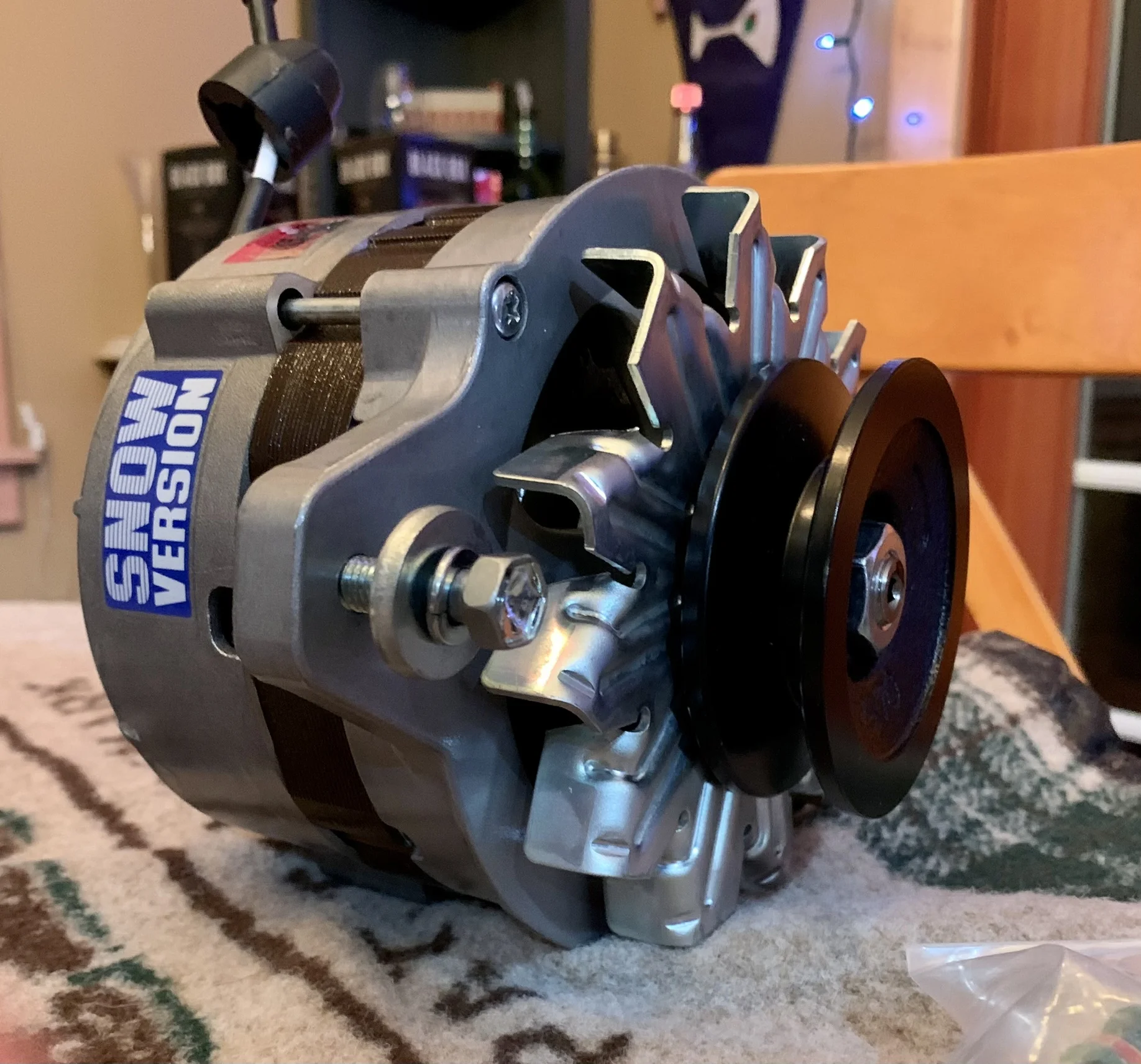

- replacing the original 1989 80A External Fan ALTERNATOR , with my 90A variant makes logic and sense here , and simply adding and including a NEW OEM Single Groove Pulley and teh updated new Flange Nut to my highly anticipated De-SMOG kit will say something special , and look killer kool too at the same time , so that will be done ....

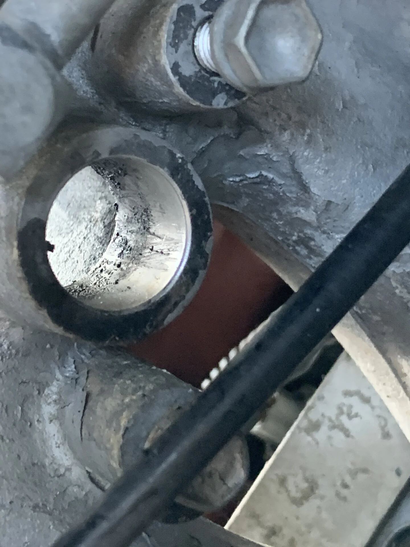

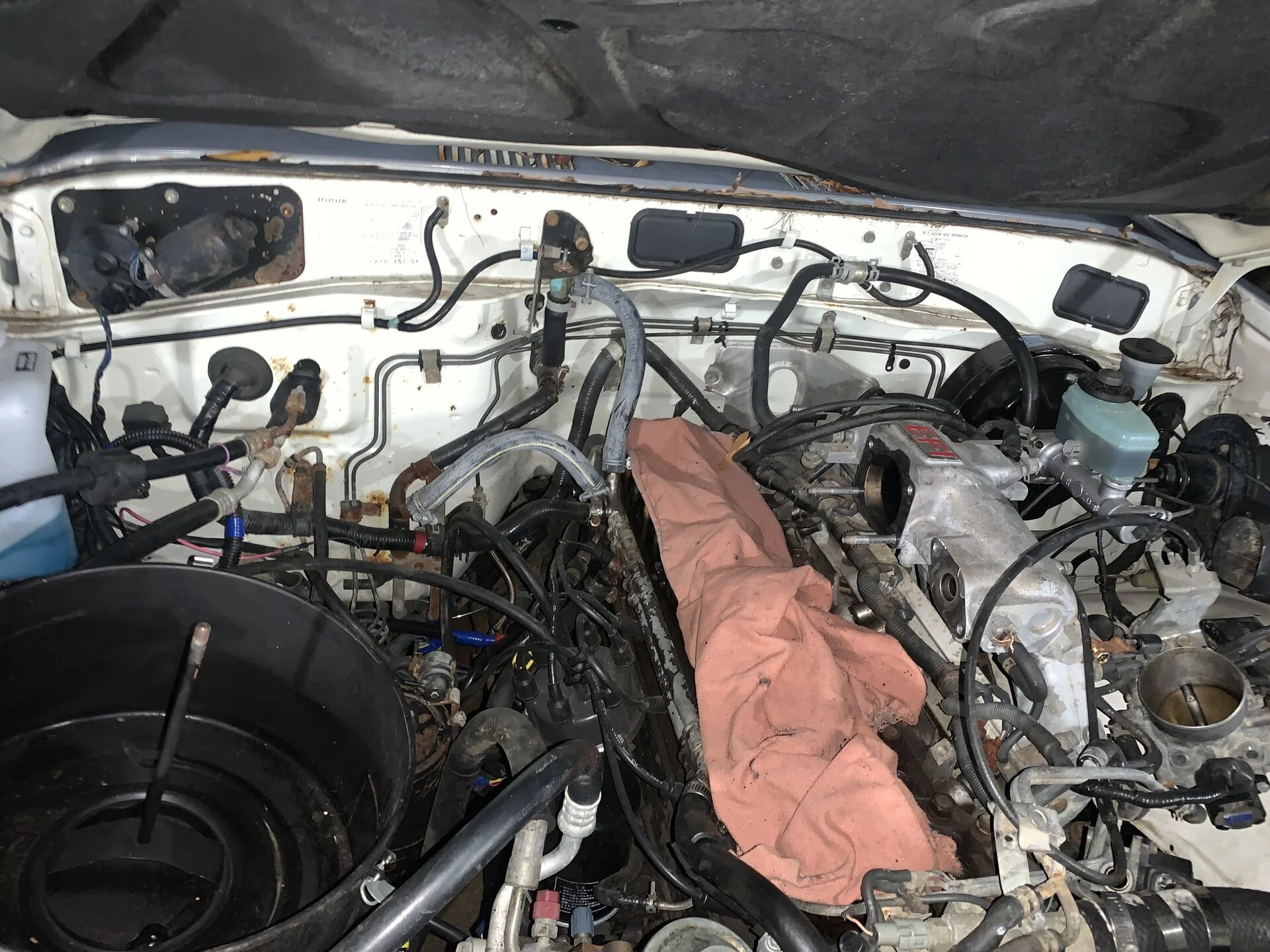

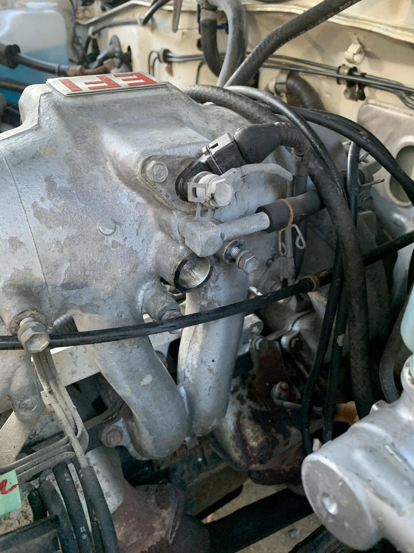

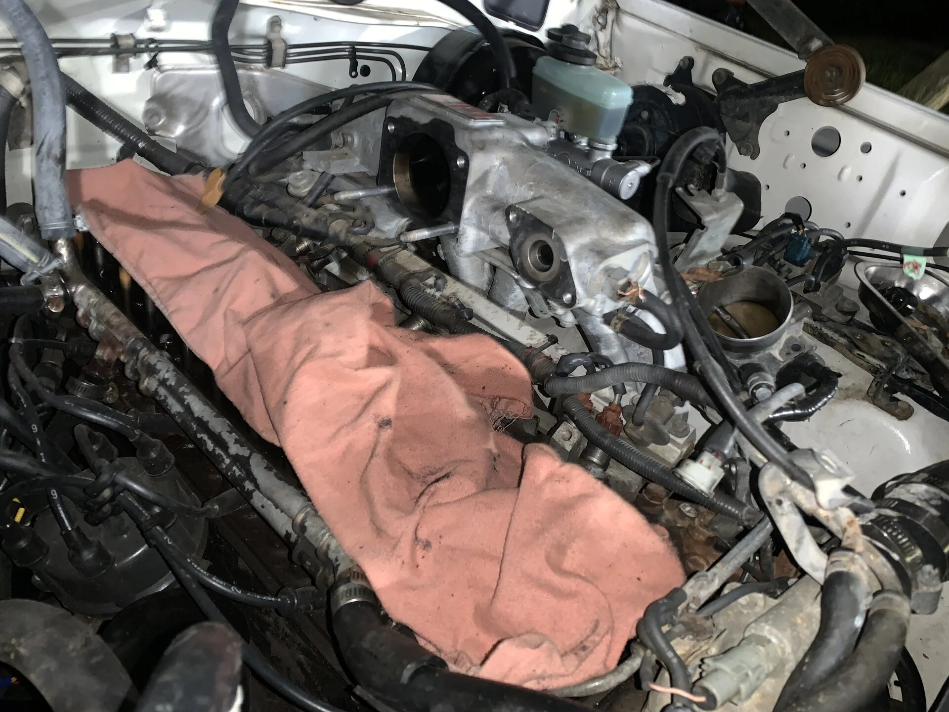

- air rail removal and install of the OEM TITANIUM service plugs only qty x 4 oddly ? proved to be a azz-kicking should of just listened to @cruisermatt and NOT tried to invent that dam wheel !

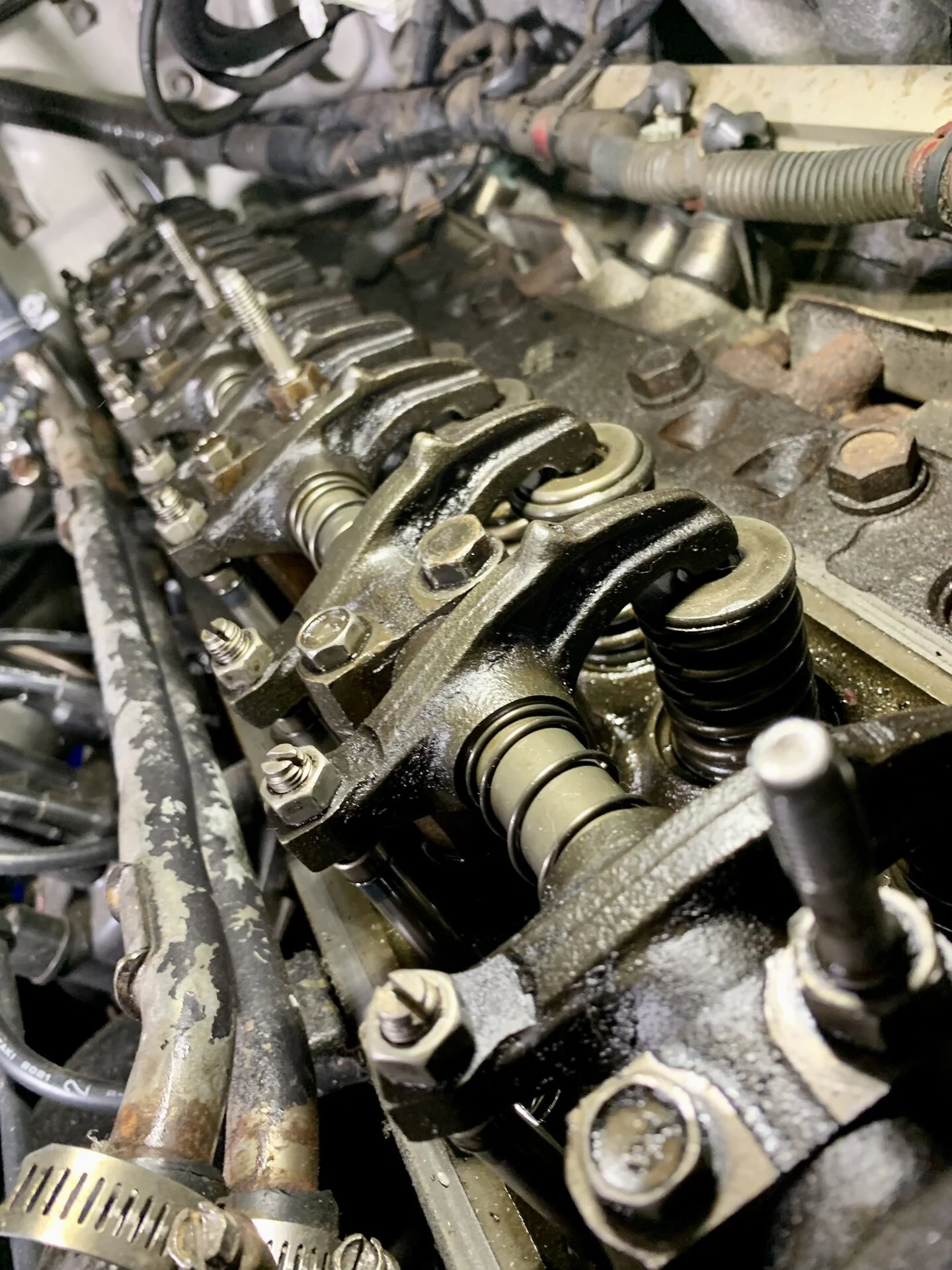

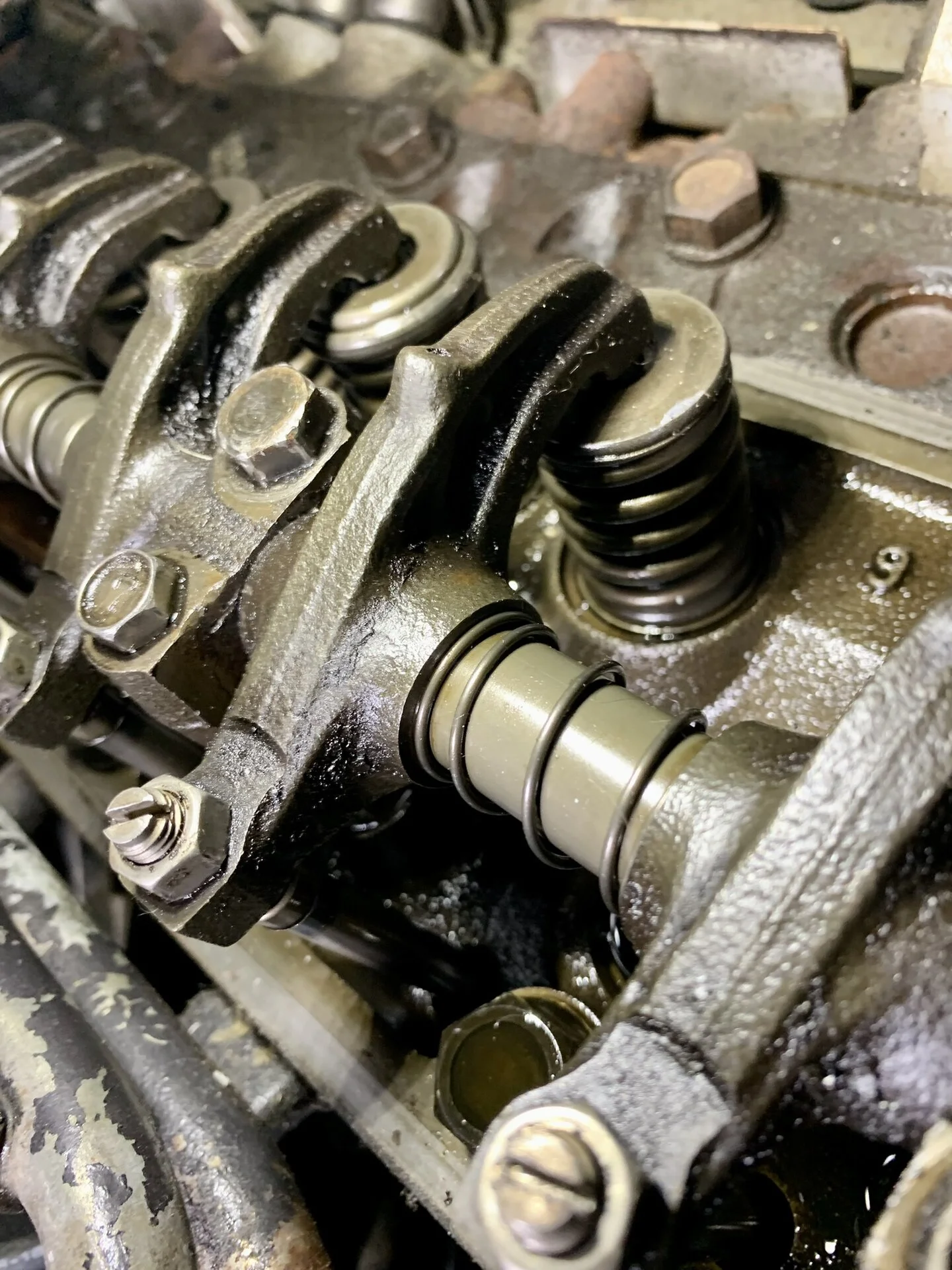

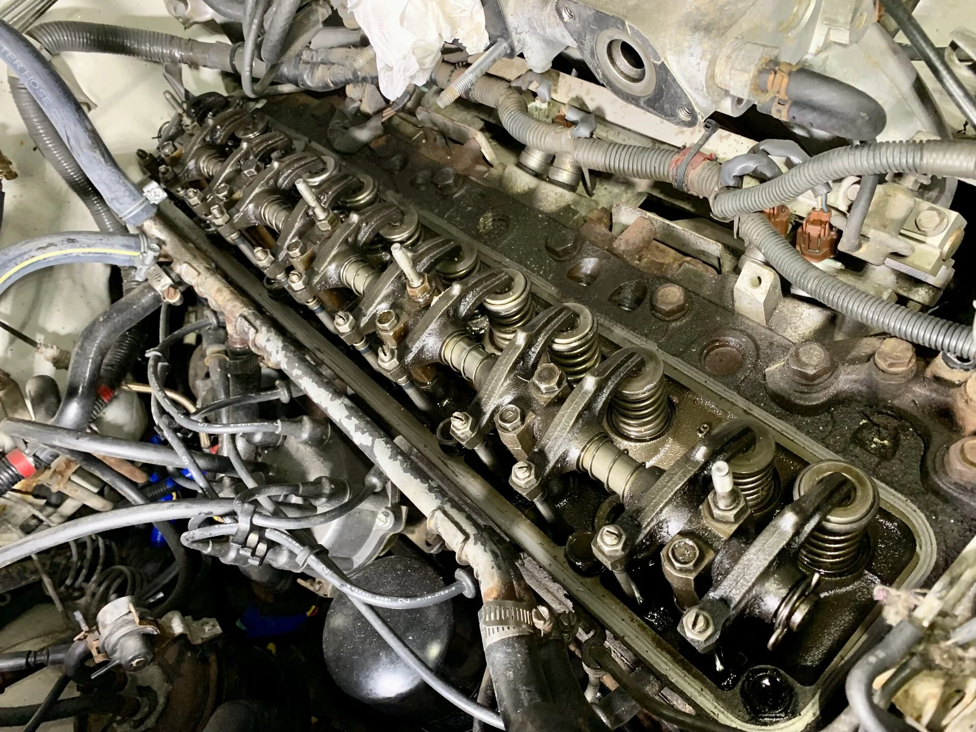

- valve cover off , i cringed my fangs to see the age and time sludge factor , and to my dear delight , i am very pleased , some cake on the rocker arms , and we tad bits here and there , but otherwise 94% Spotless ! ..............yea i win for once on a GHOST un-known ...🤣

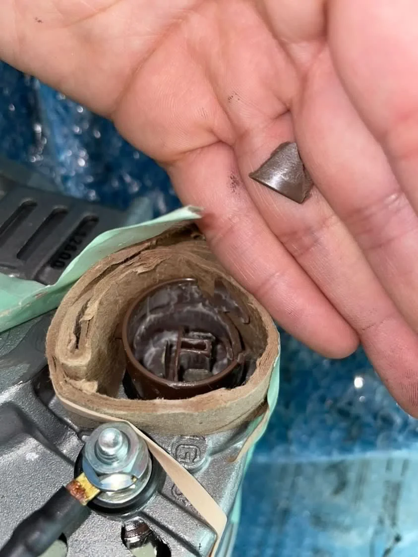

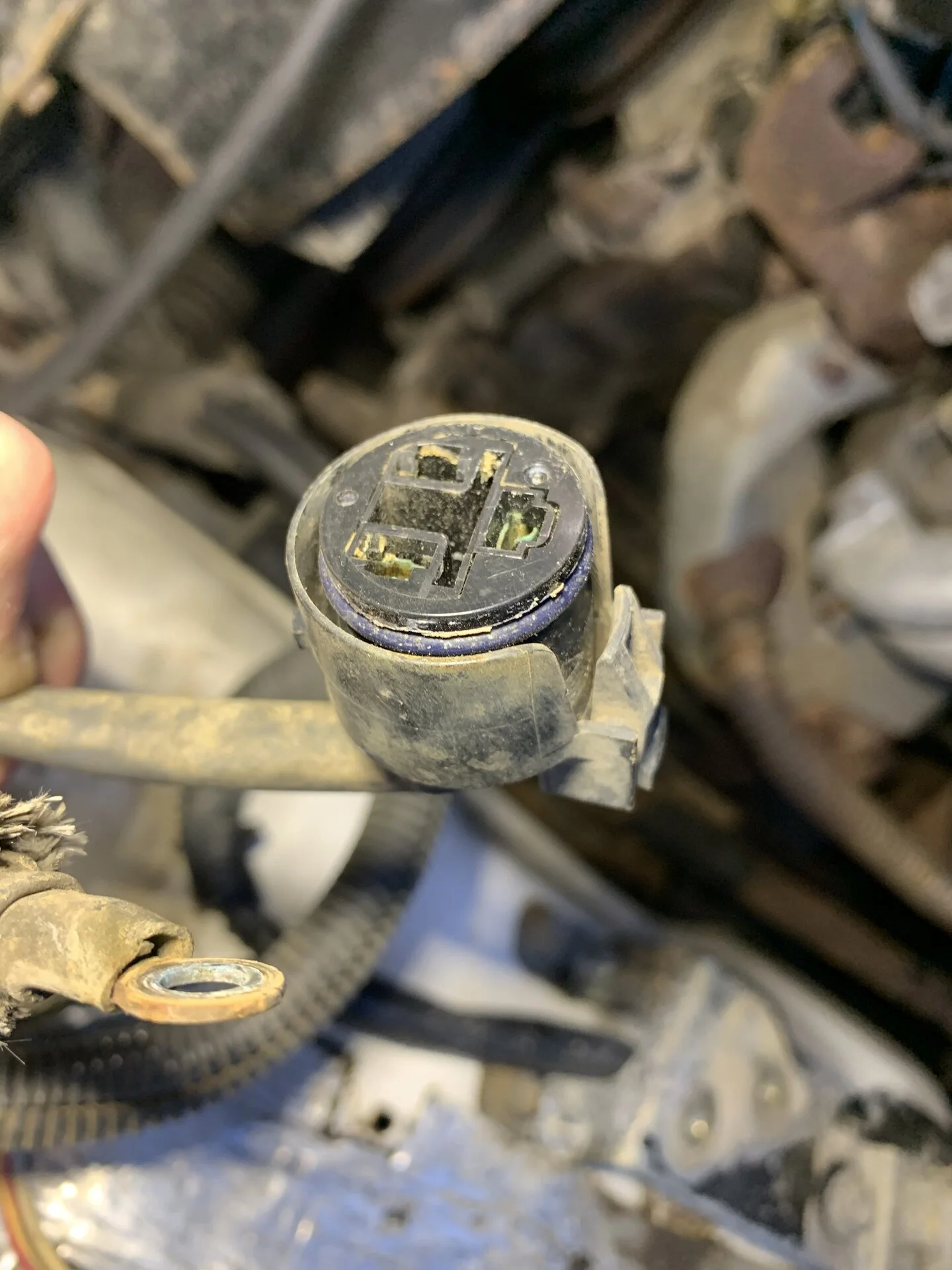

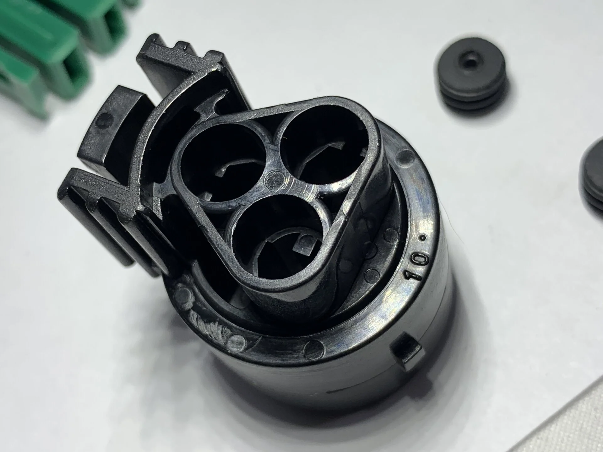

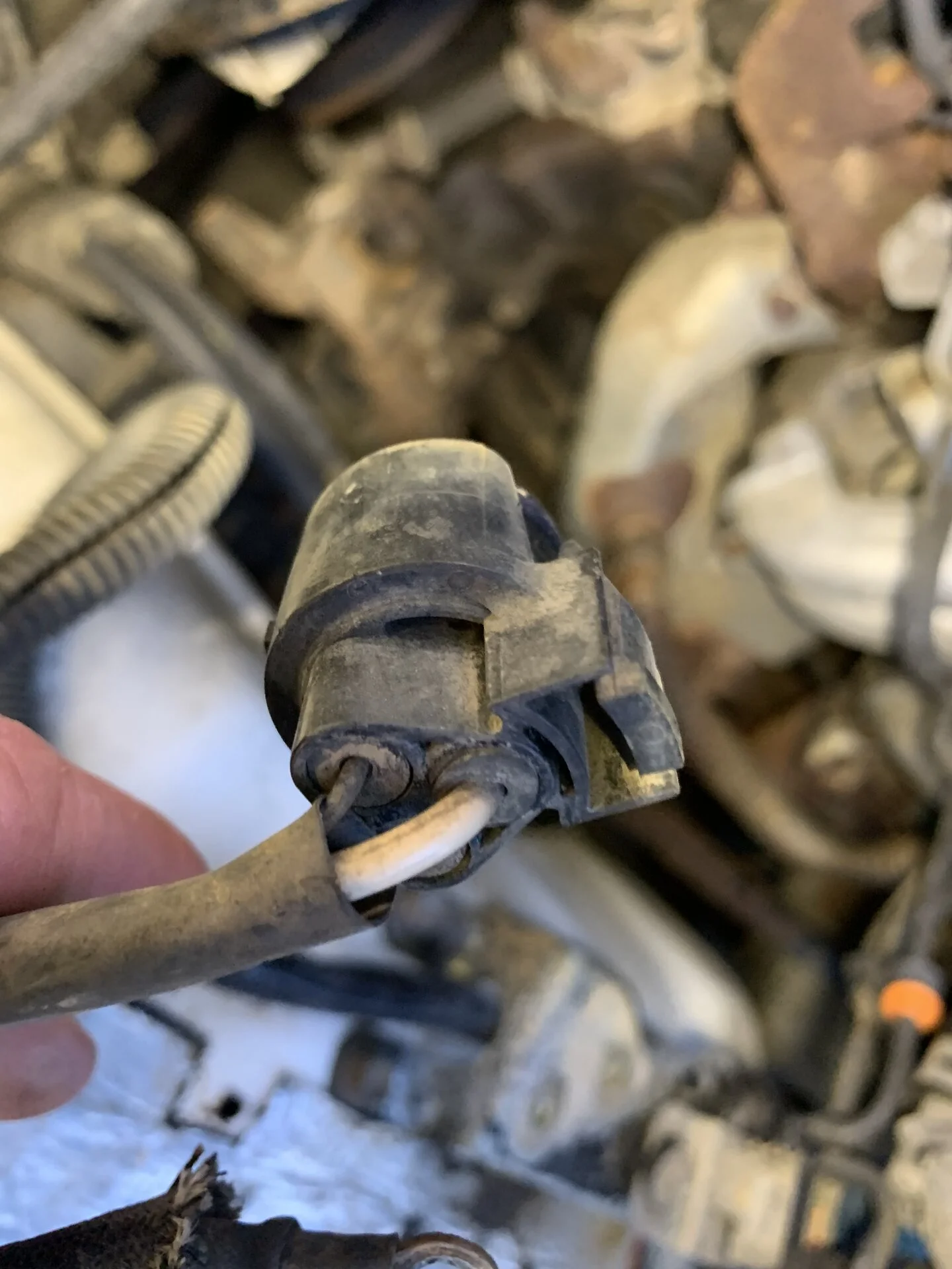

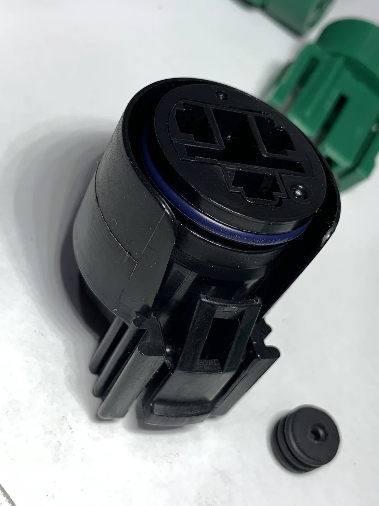

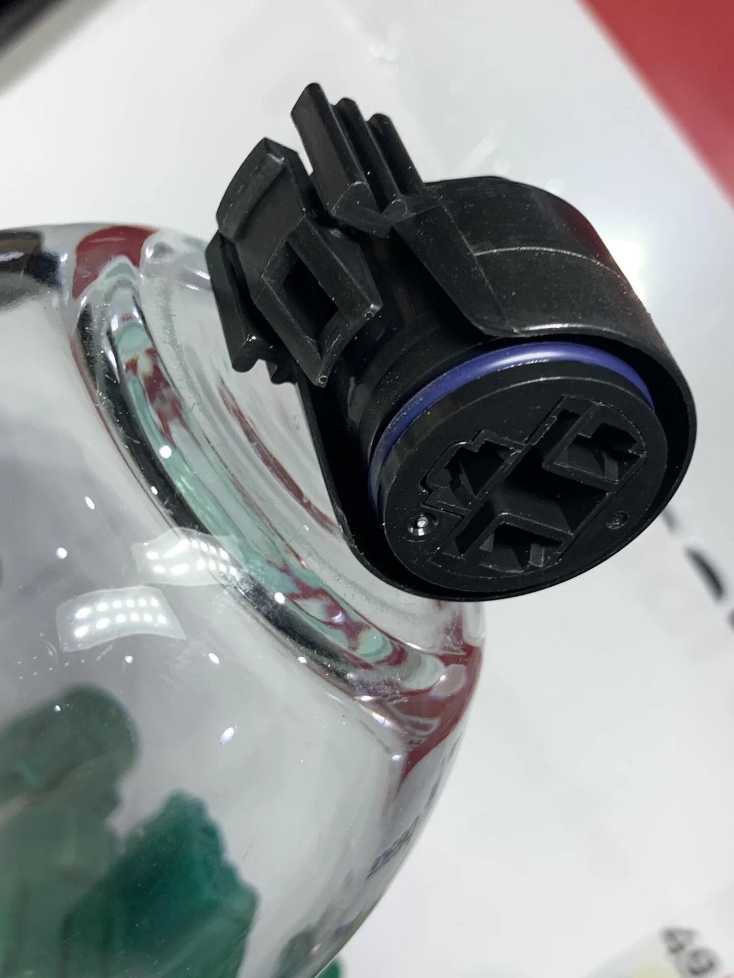

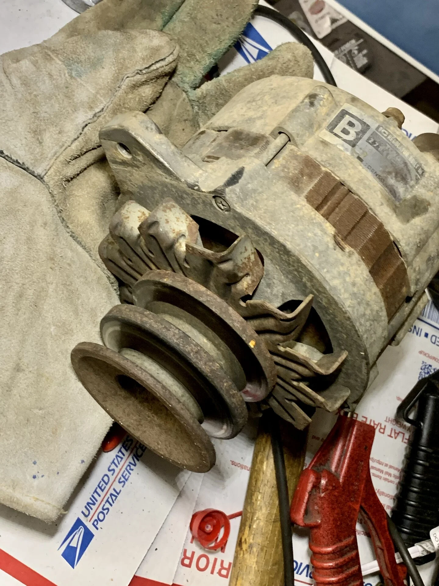

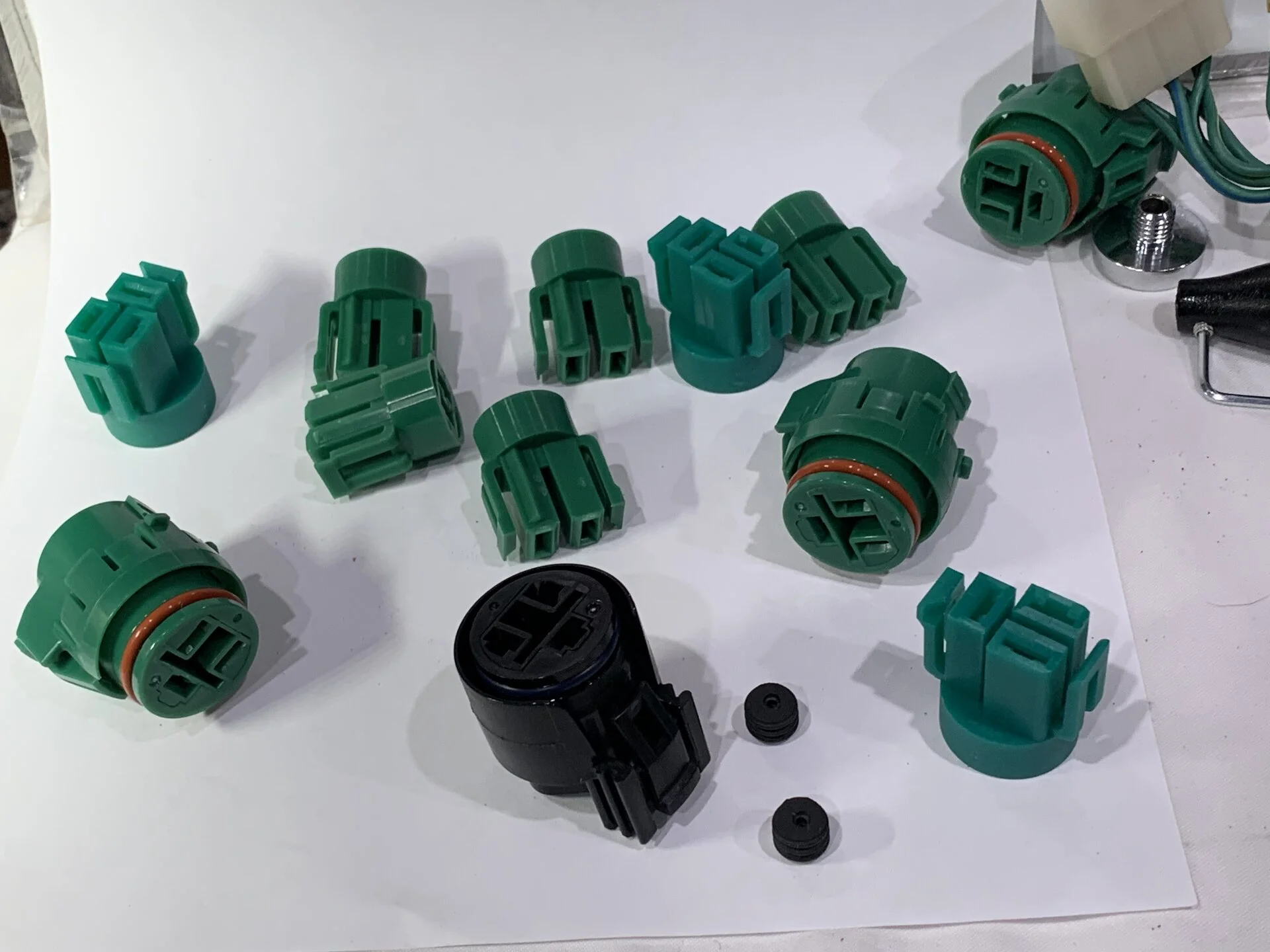

- NOTE my alternator 3-wire original PLUG photos , if your ever told this is not a matter of course , or NO big deal , your being lied to by a person that should not be giving such amature hour advice ......:rolleyes:

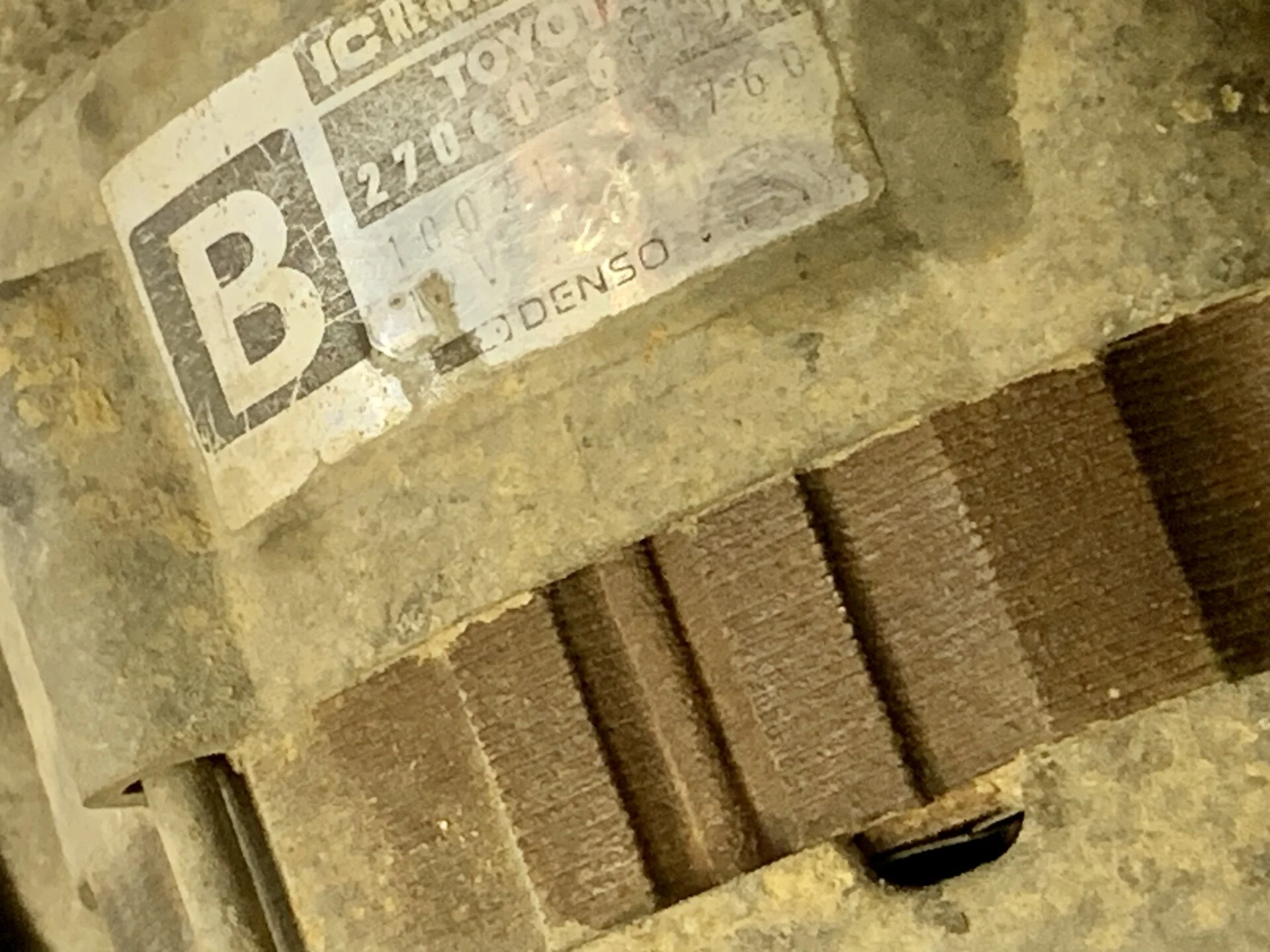

The original PLANT A11 installed 80A amp alternator , note the killer kool original decal , i created super detailed file on it and have it inb Reproduction process now , if anyone has this same original decal still on there unit PLEASE post some pics here , i can ONLY determine it was a ALL black ink on the chrome foil background , NO other pastel colors , but i ONLY have ever seen this unique one example too ?
- input is welcome on this super rare FJ62 decal TECH....:)
- the original unit was working normally and i had ZERO problems requiring its replacement , the BLACK 3 pin input connector plug and the ring B+ terminal are stand alone topics , but in all reality AGE , TIME and the fact i plan a FULL Documented autopsy to see the actual internals like brushes remaining status is simply way too kool to pass up .....
- the accidental below new unit falling and breaking the connector and my pride simply presented itself as a mis-fortune or sorts creating a why not in-fact do this , AFTER i had it very well bench tested to make sure internally no damage , and then the black new OEM plug covering up the entire brown cracked device side connector a no brainer in my world , as it could NO LONGER be mailed out to a client customer , it was now mine as these things and topics rarely happen but when they do , think how it can be turned around to be a UNICORN of a opportunity too ...:D
- THIS WAS THE WAY ...
also , the result of the new 90A one rolling of my shipping station table approx. 36" inches ff the ground , i DID have my usual cardboard tube from a spent tape gun roll all nicely in place too , i guess approx. 15LBS of shear lump sum matter falling like , could of easily broke my foot or worse ..../:oops:
Creating the 100% ALL OEM Toyota Genuine Parts Japan Spec. 3F-E DE-Smog kit has been a unique challenge in a few key areas / Topics : , The cogged drive belt , EGR Exhaust manifold Plug , Intake Manifold Hole from the long tube itself location going in there . lastly , exactly what all vacuum ports , VSV 's BVSV's etc do u cap off , delete al together and or re-route them ?
- so , like Rick on PAWN STARS , i have called in a Expert , my solid mud buddy @Spook50 , who ...well is the Expert on this topic in my professional and personal opinion and according to the MUD Advance Search archives as well .... :D
- this whole broad brush de-smog topic as a whole , has opened a few special 3F-E pandora parts boxes , that shall soon be a reality via my store offerings , as i needed them to complete the De-Smog step by steps , and or ran into them in the course of doing so as well , such as both the Drive Belt Pullies / Tensioner hardware topics , the Power Steering Pump assy. , and again sticking to ONLY TOYOTA OEM Parts has this far been achieved down to the A/C Drive Belt Tensioner Pulleys unique run down bolt detail , you will see below ....

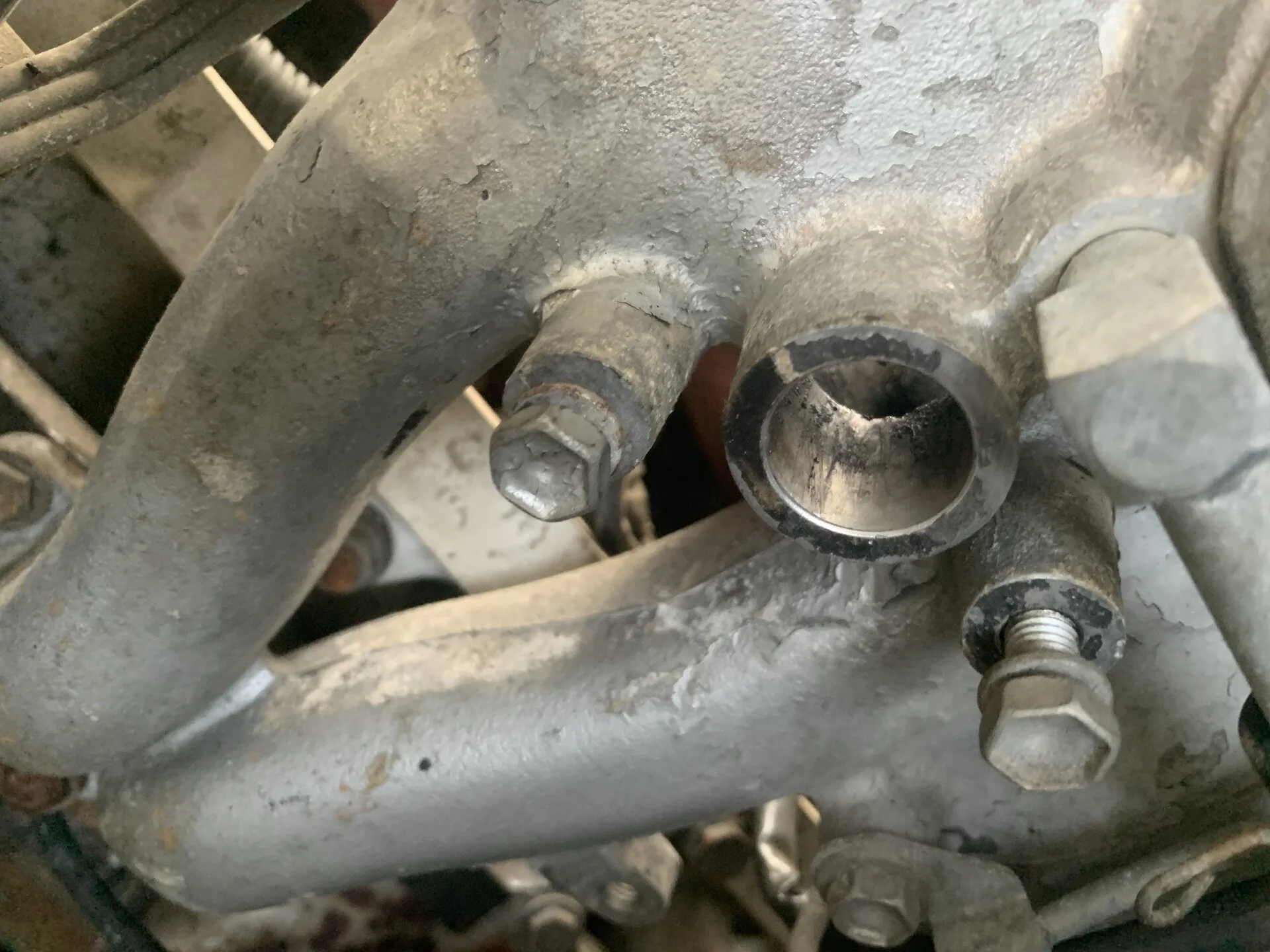

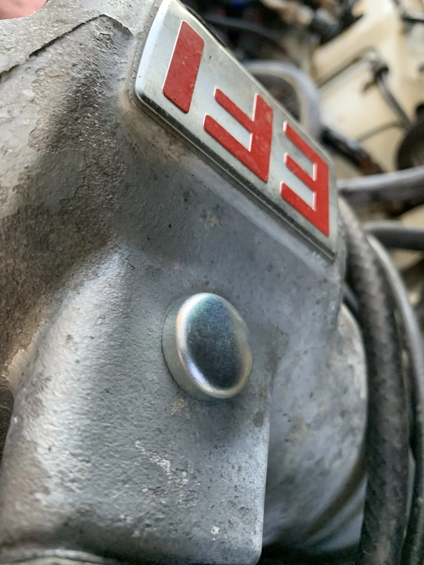

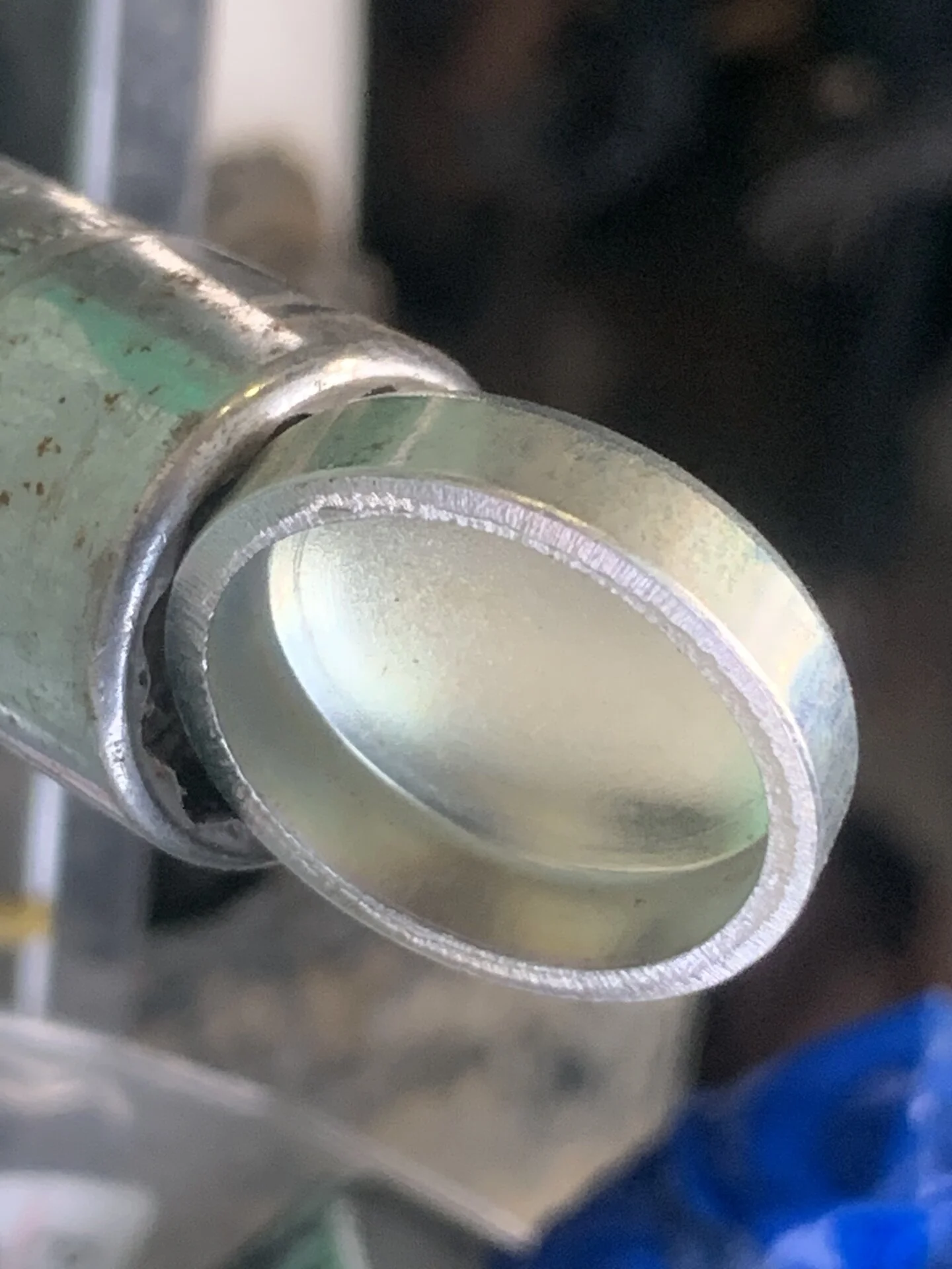

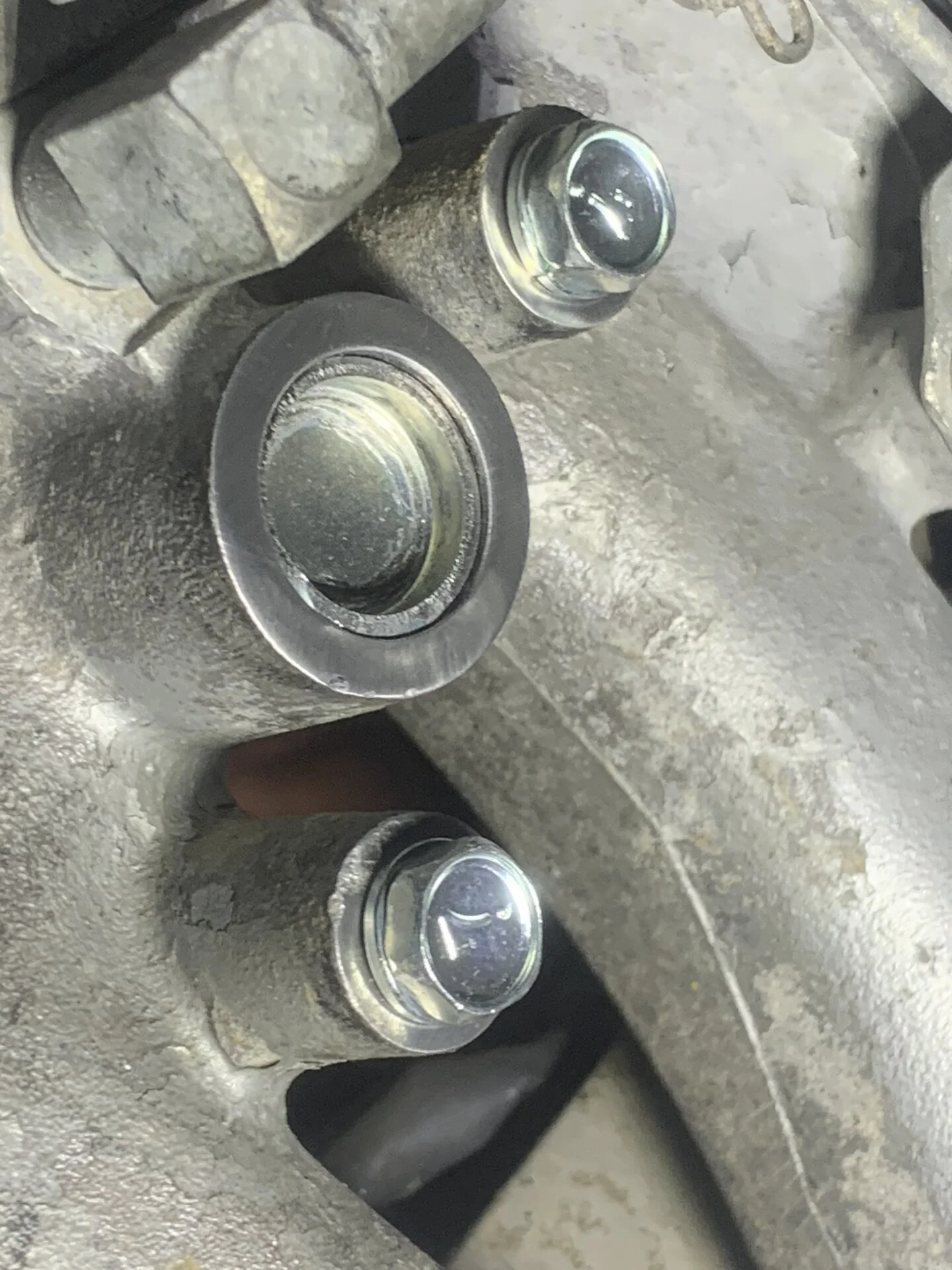

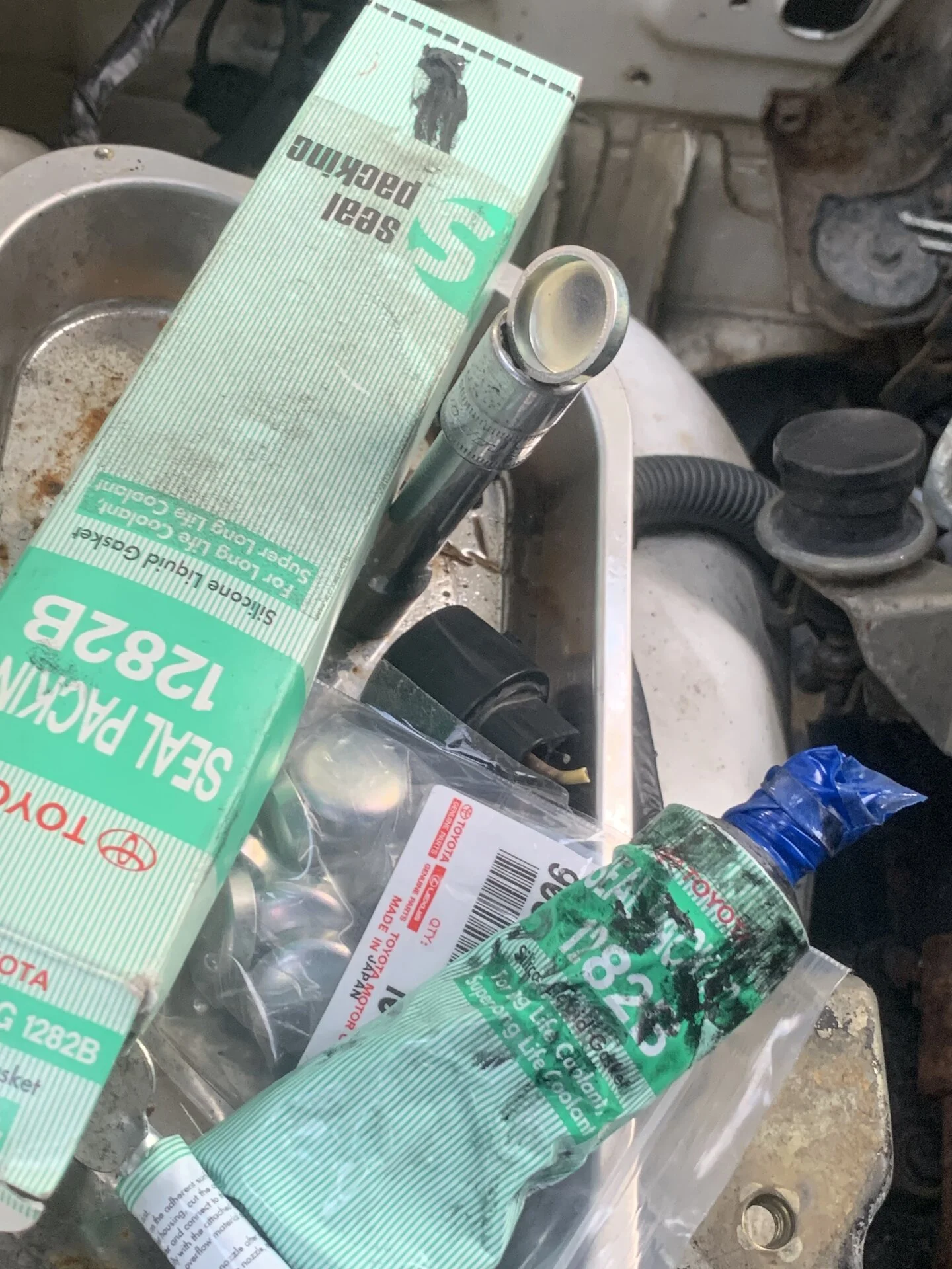

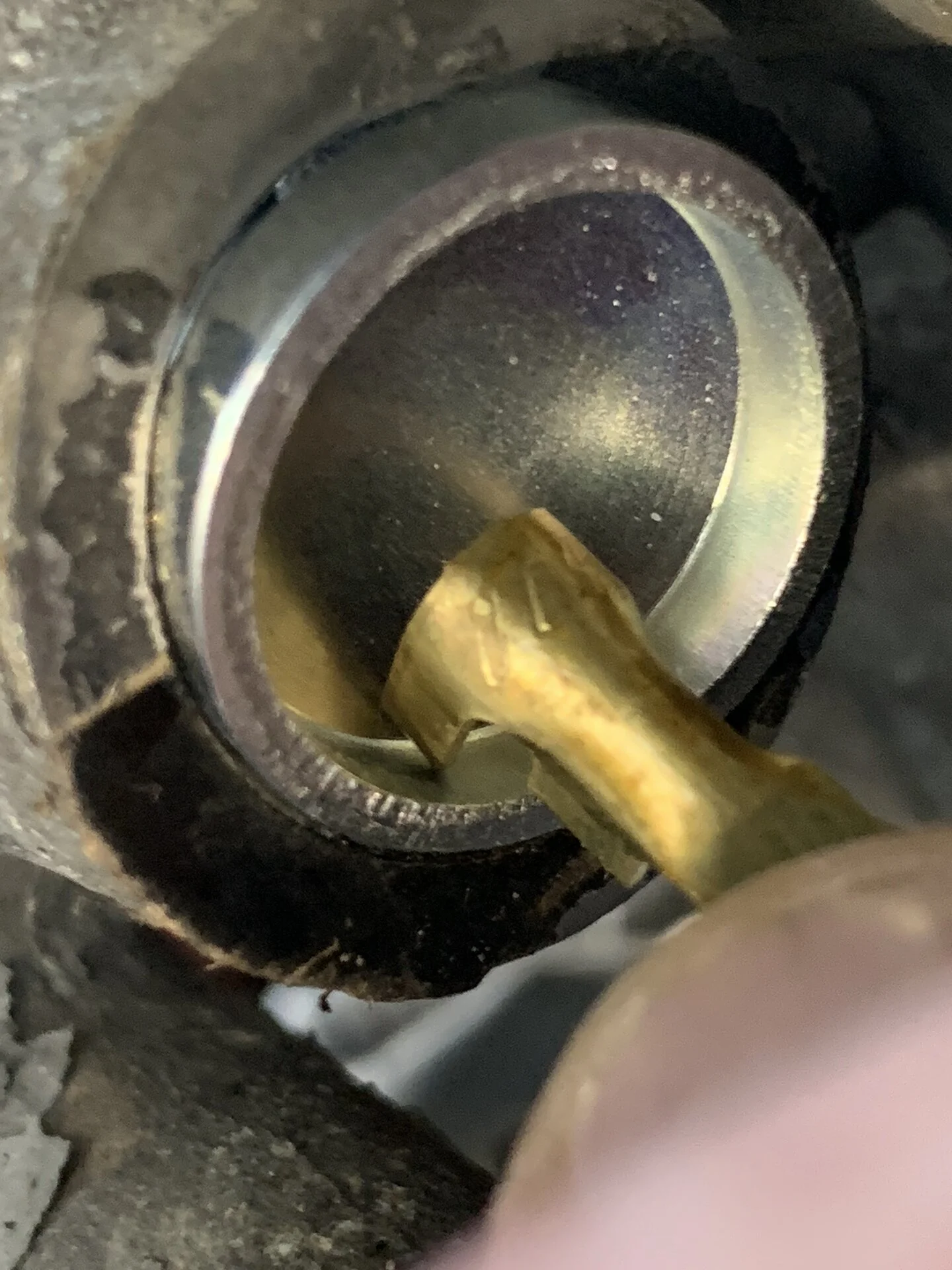

OEM a toyota Freeze Plug as part of my intended 💯 % toyota OEM parts 3FE de-smog kit ….
It took me ordering 7 different part numbers to find the winner ….
Confusing parts TEq on freeze 🥶 plugs for sure
I added a bit of FIPG for good measure 📐..

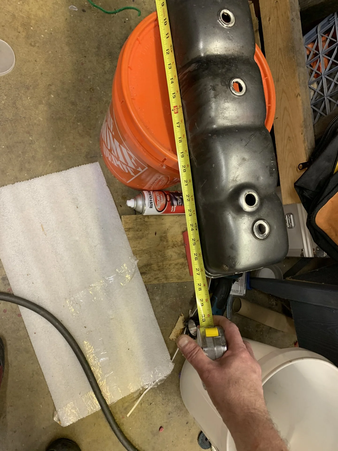

my valve cover gasket was seeping , and despite the wise-words from one of the 10 wisest men i know , @cruisermatt .....i kept saying , " sure i can pull that air rail with the valve cover still on , sneak-attack it out ,,,,,,,, yea right ! 🤣
+ i really had to know the sludge-factor or well lack there of here below ....
It just shows that an every 3,000 miles oil & filter change is the word and it speaks here …
