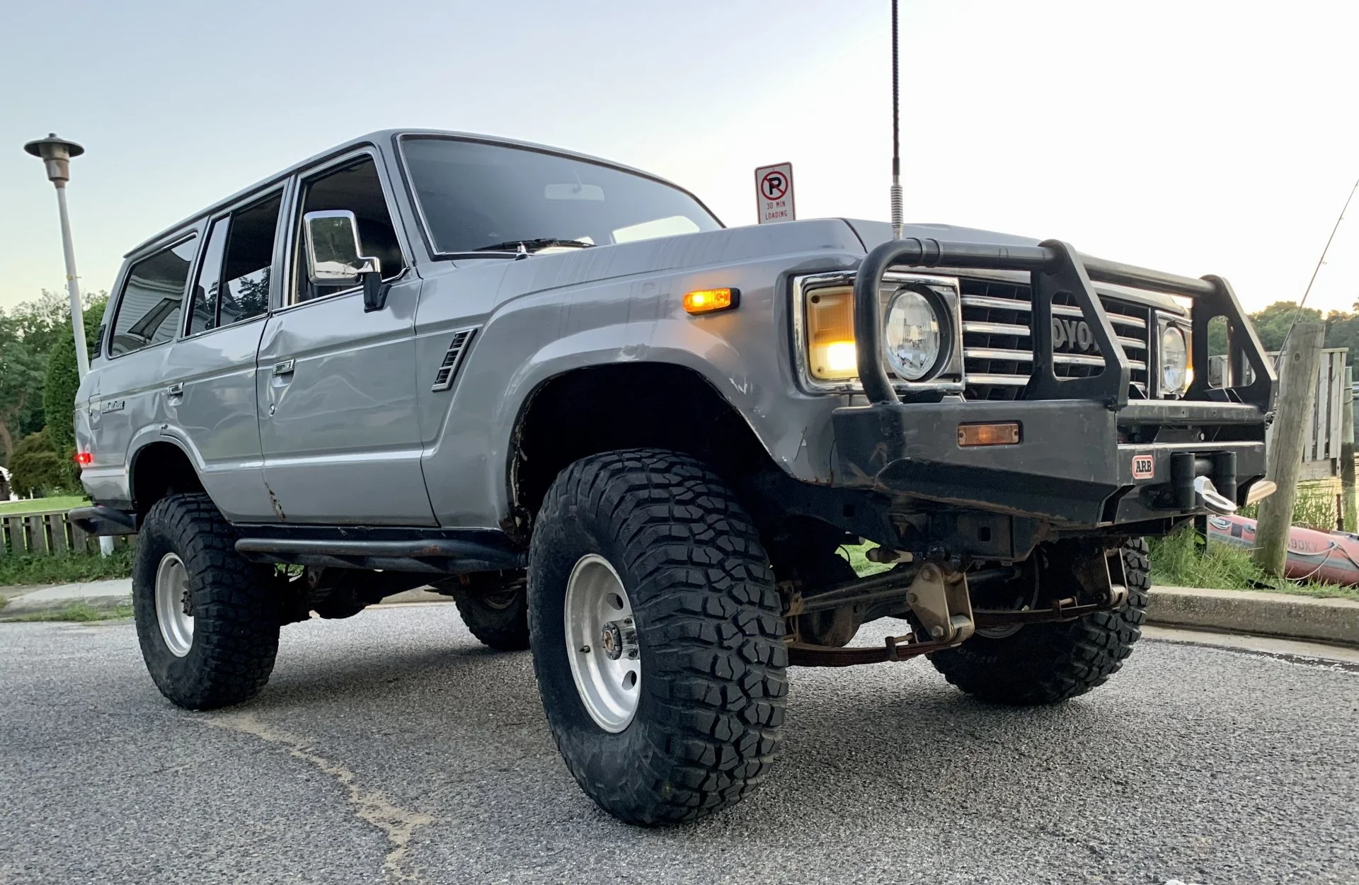

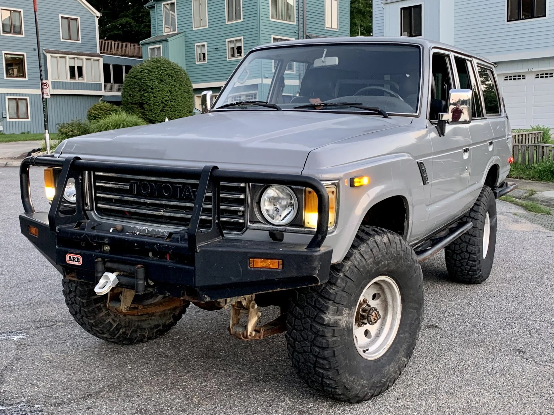

This is the official BUILD Thread of :
" Cement Ghost "
- the Rising Sun Mechanical SKUNK-WORKS new Shop & Parts Road Runner ...
- i acquired her today from a fellow TLCA Member and Friend .... :)
- she was nicely painted OEM TOYOTA paint Code 1H5
- has a 1987 FJ60 Front End Conversion
- Manual Transmission H42 late Modle aluminum Shift Tower w/ split case and Spacer between the two gear boxes

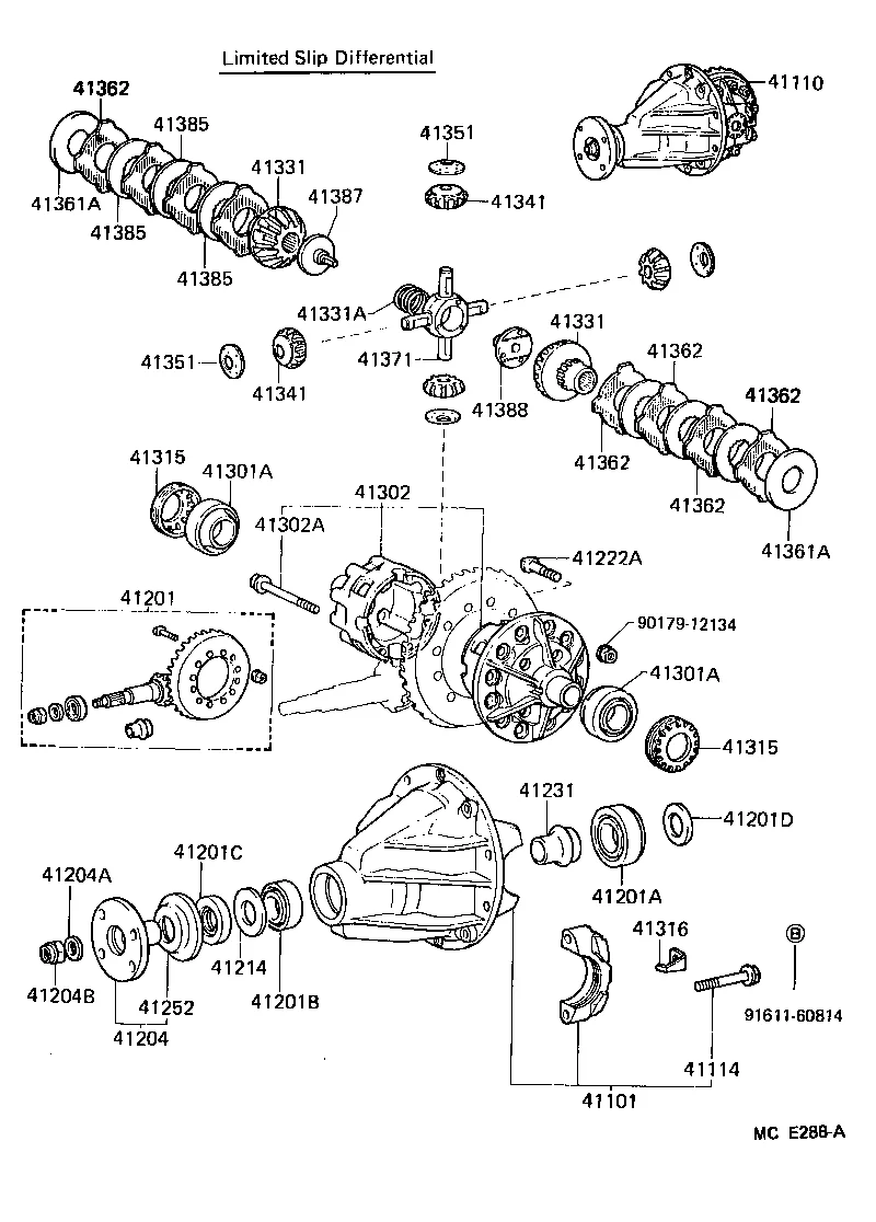

- NON-USA FULL Floating Rear Axle w/ a Factory Limited Slip Differential
- current today mileage of 131K
- future plans include H55F upgrade ,
- this will become a as much as i can and know a true
SNOW-VERSION / ACRTIC Spec. 6# Series
- i plan also to apply the most possible OEM Themed Body Graphics and stipes known to mann-kind as we currently understand that to be

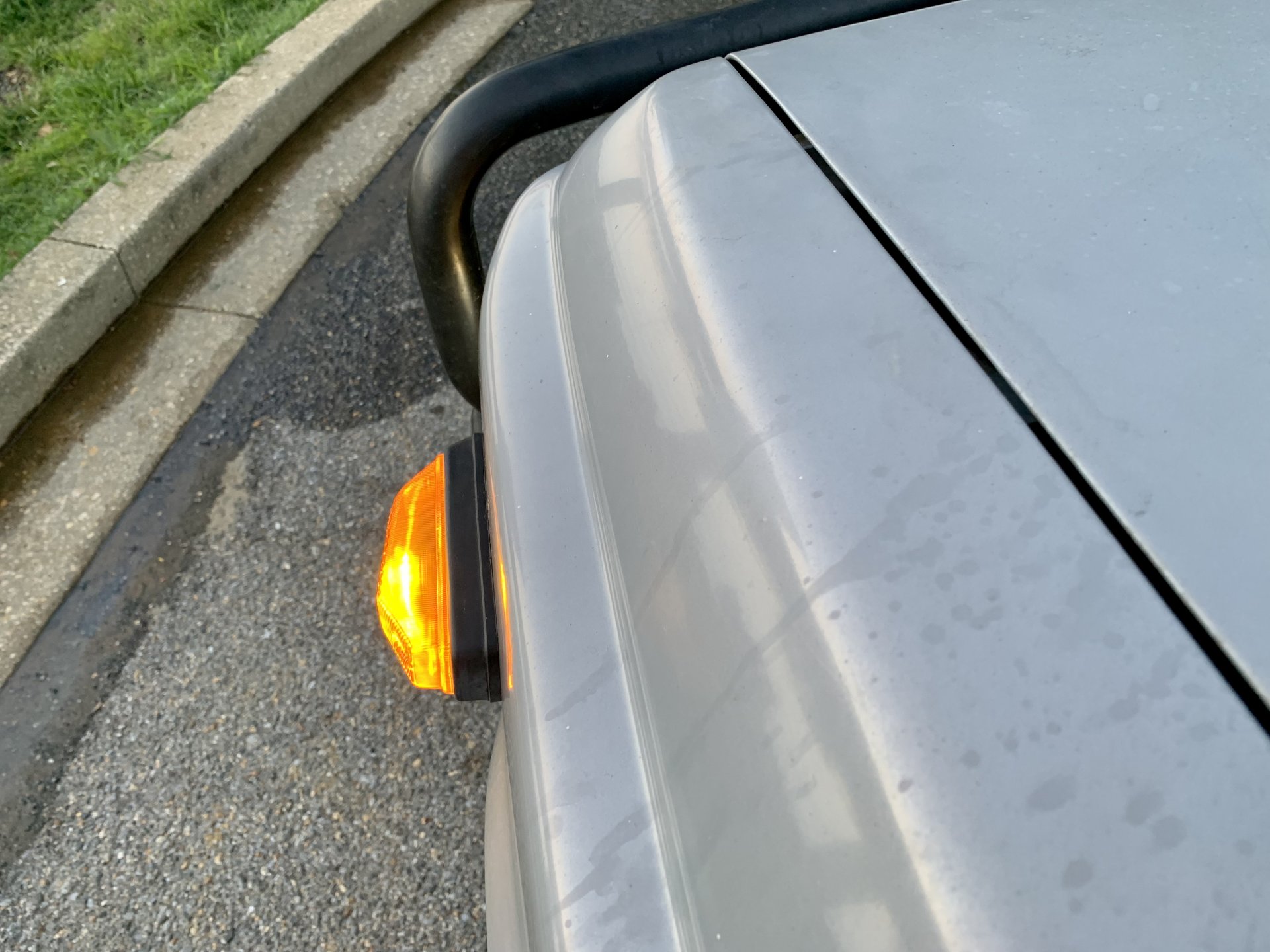

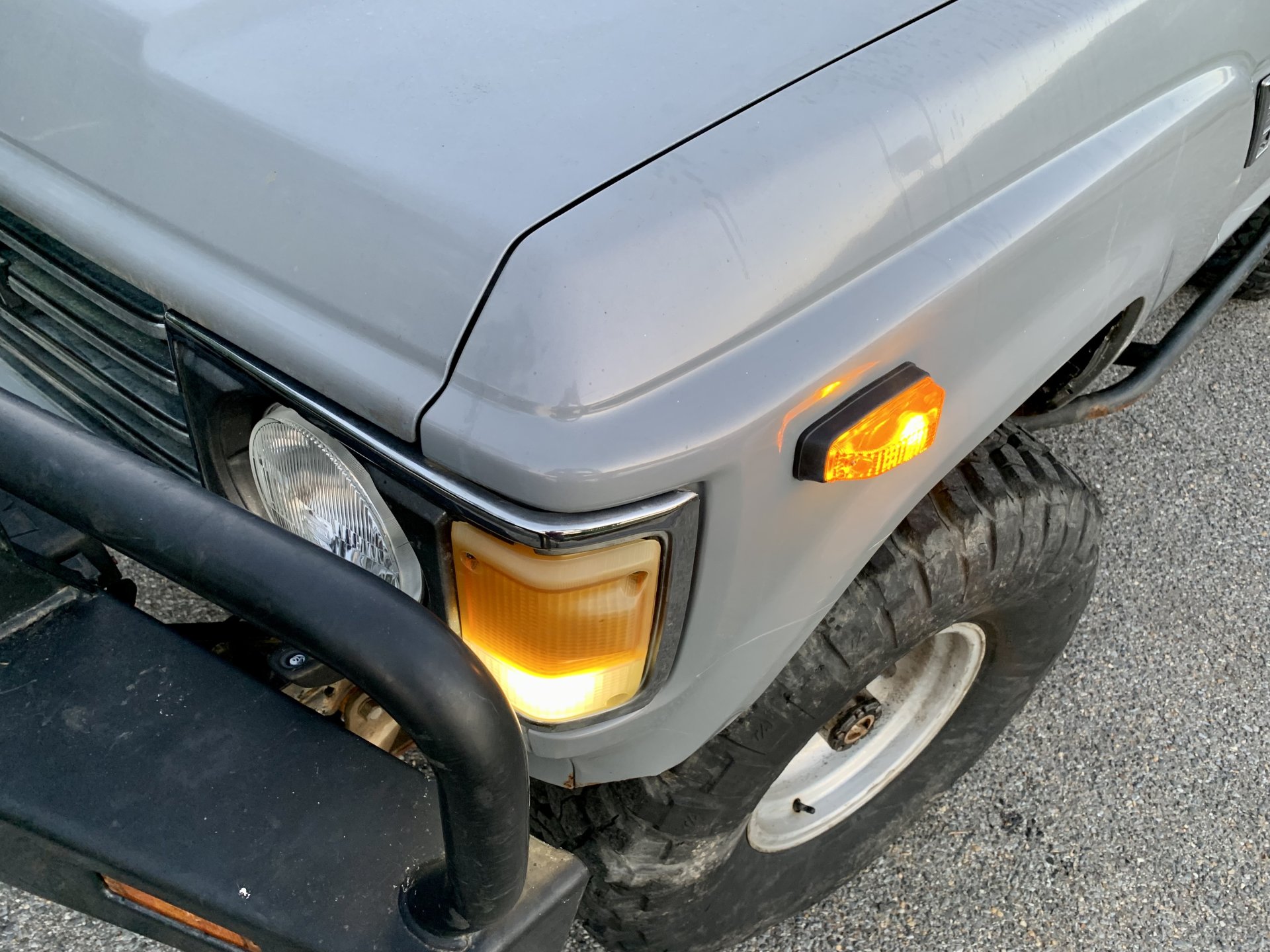

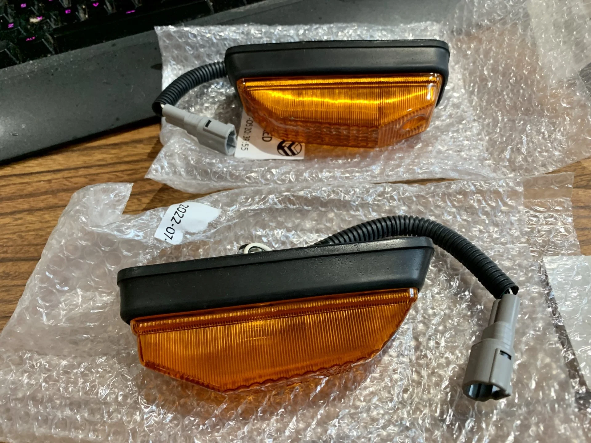

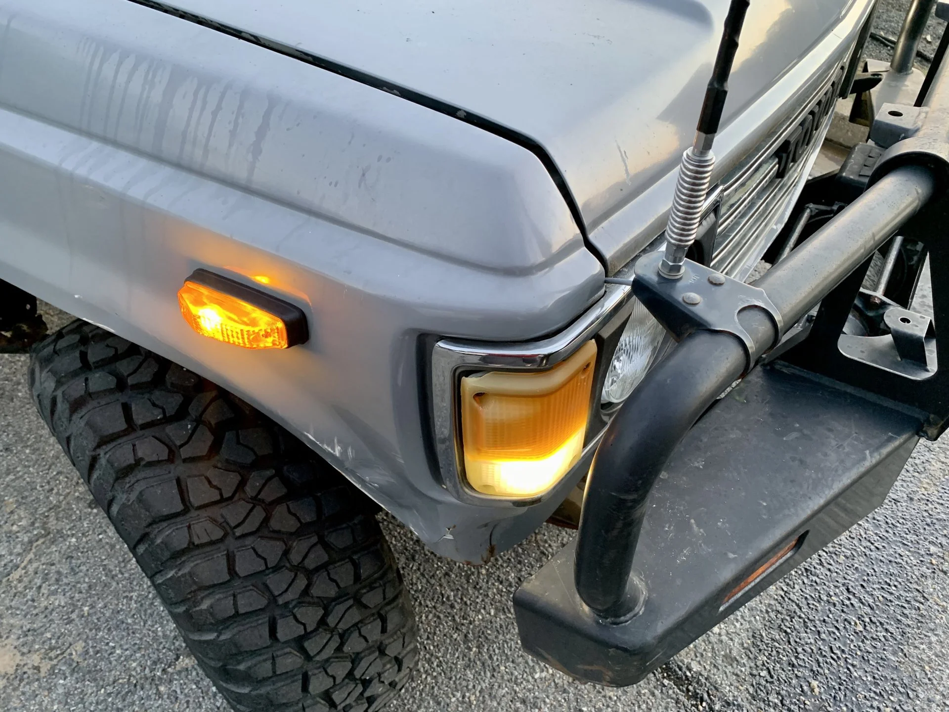

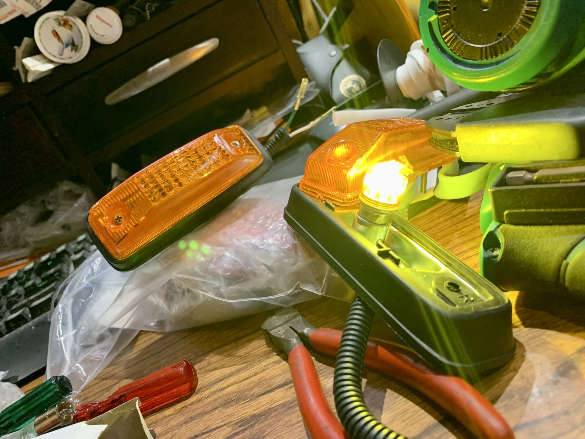

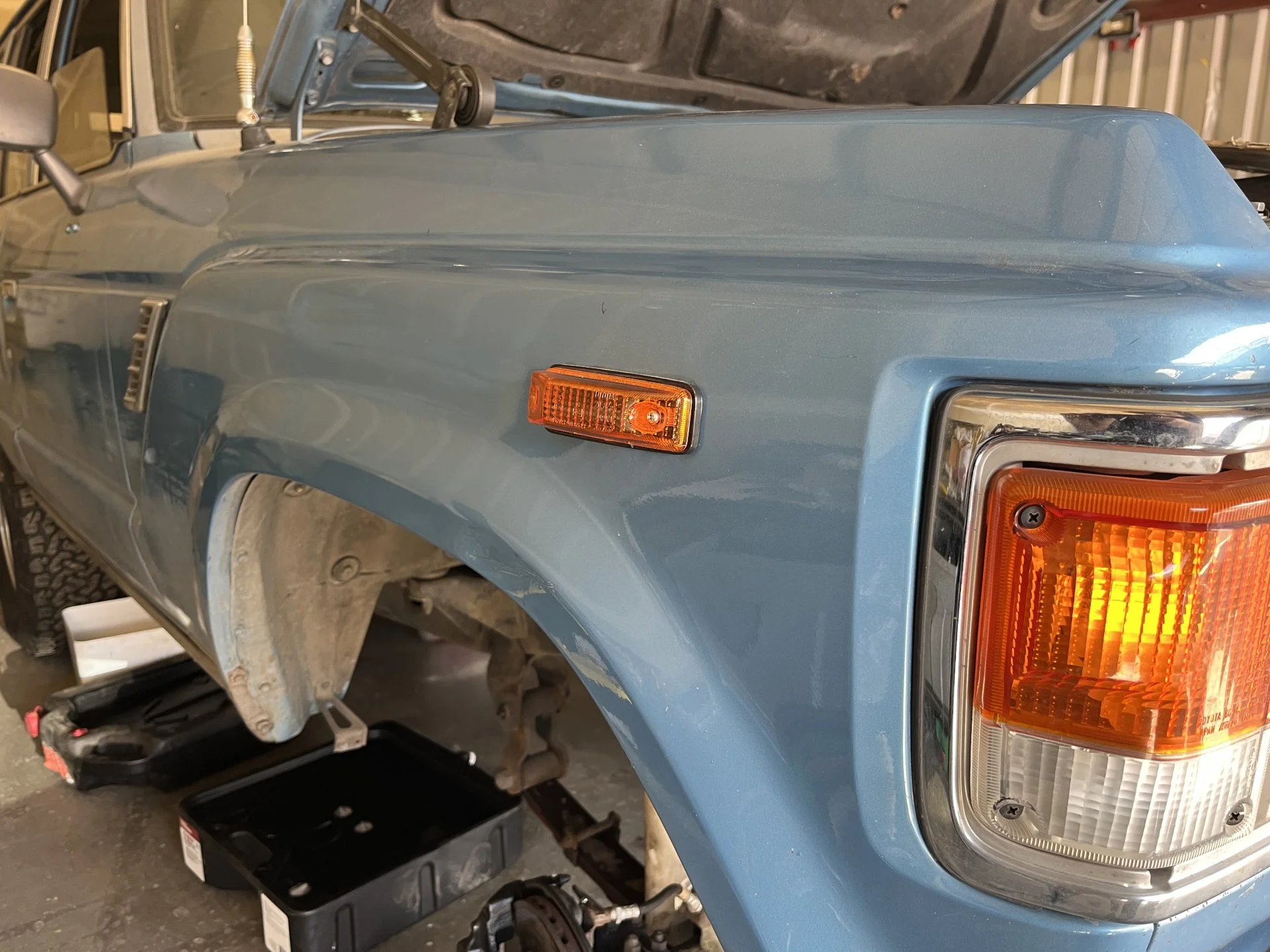

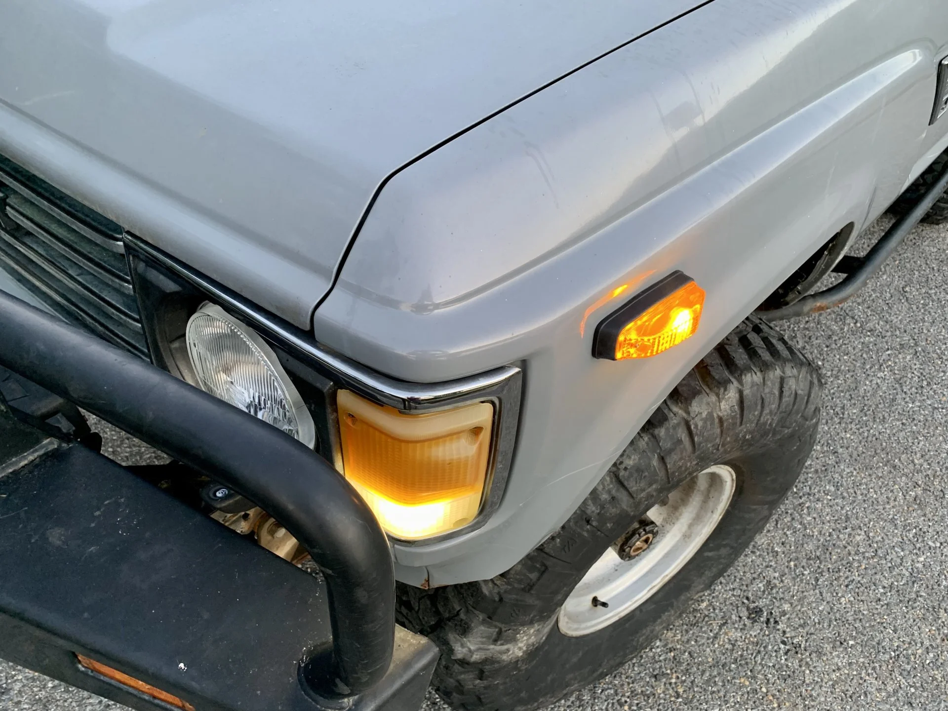

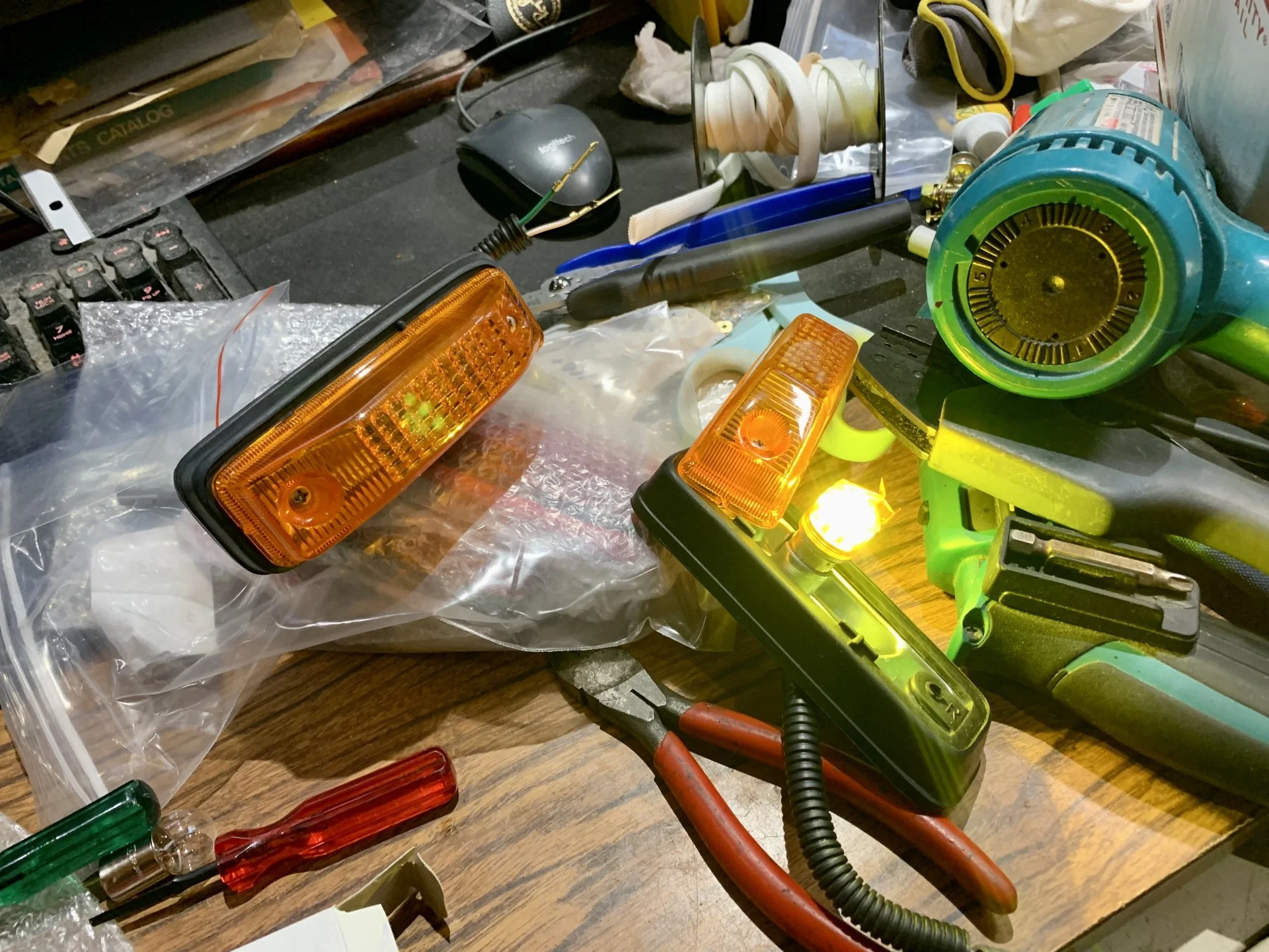

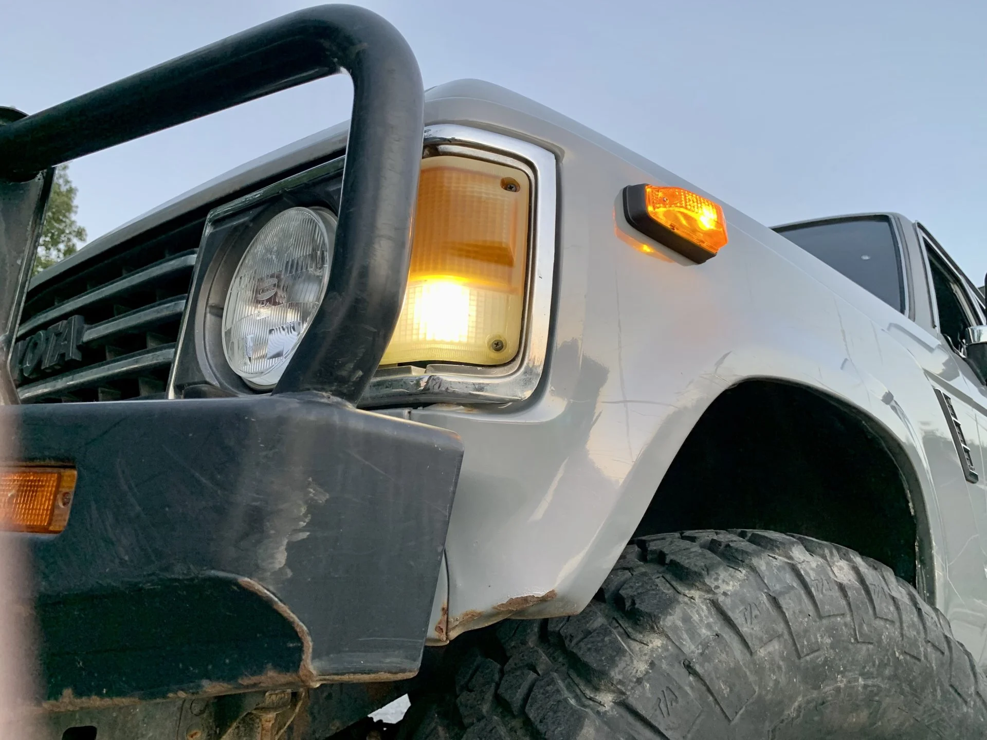

Congrats on the 62! You probably already know this but those lenses fit the US-spec side marker base like a glove.
thanks !

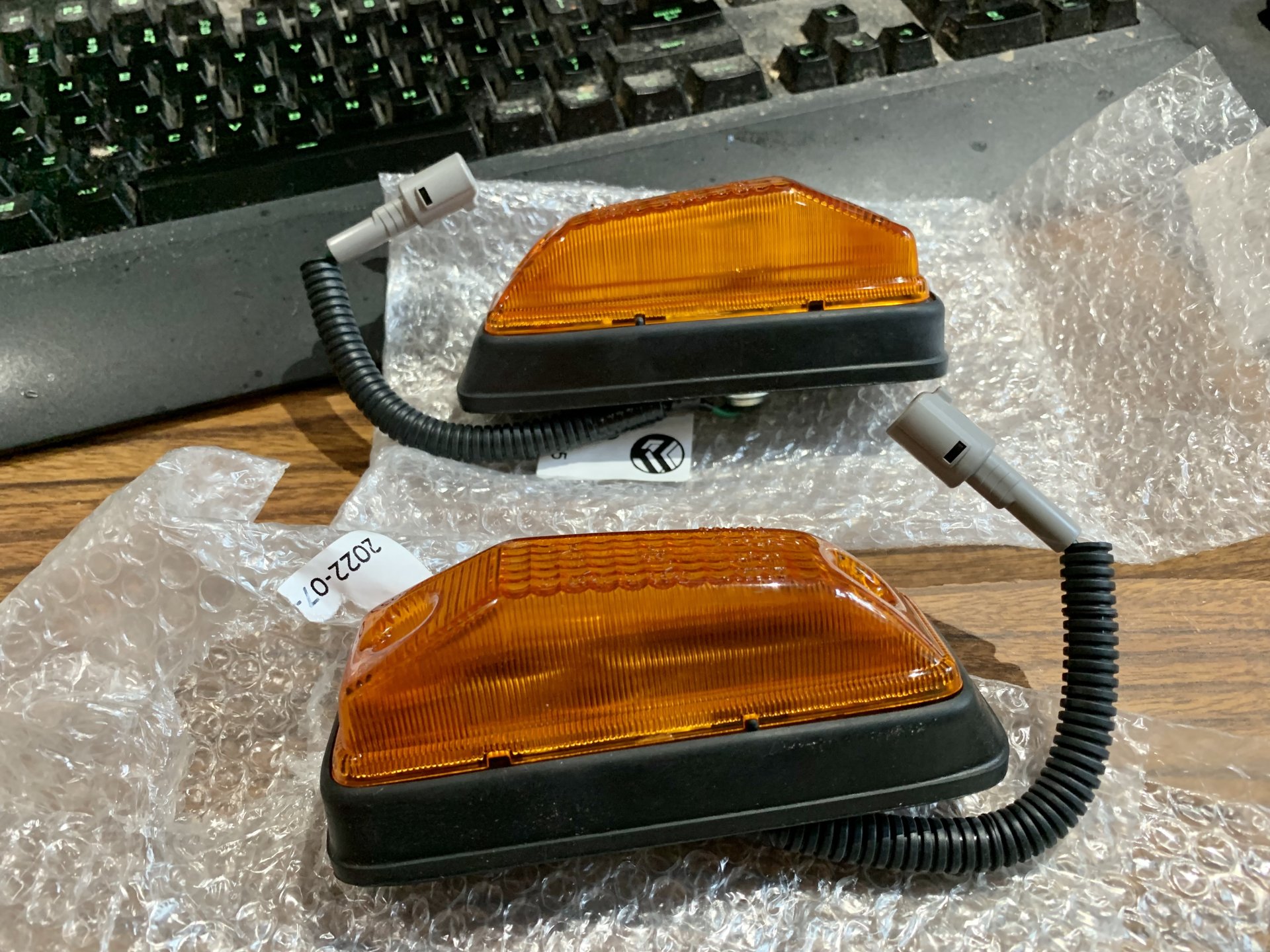

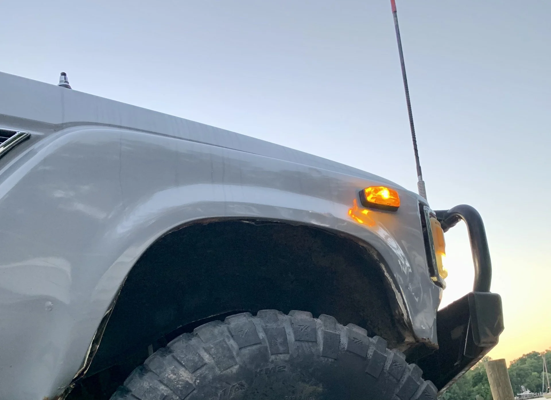

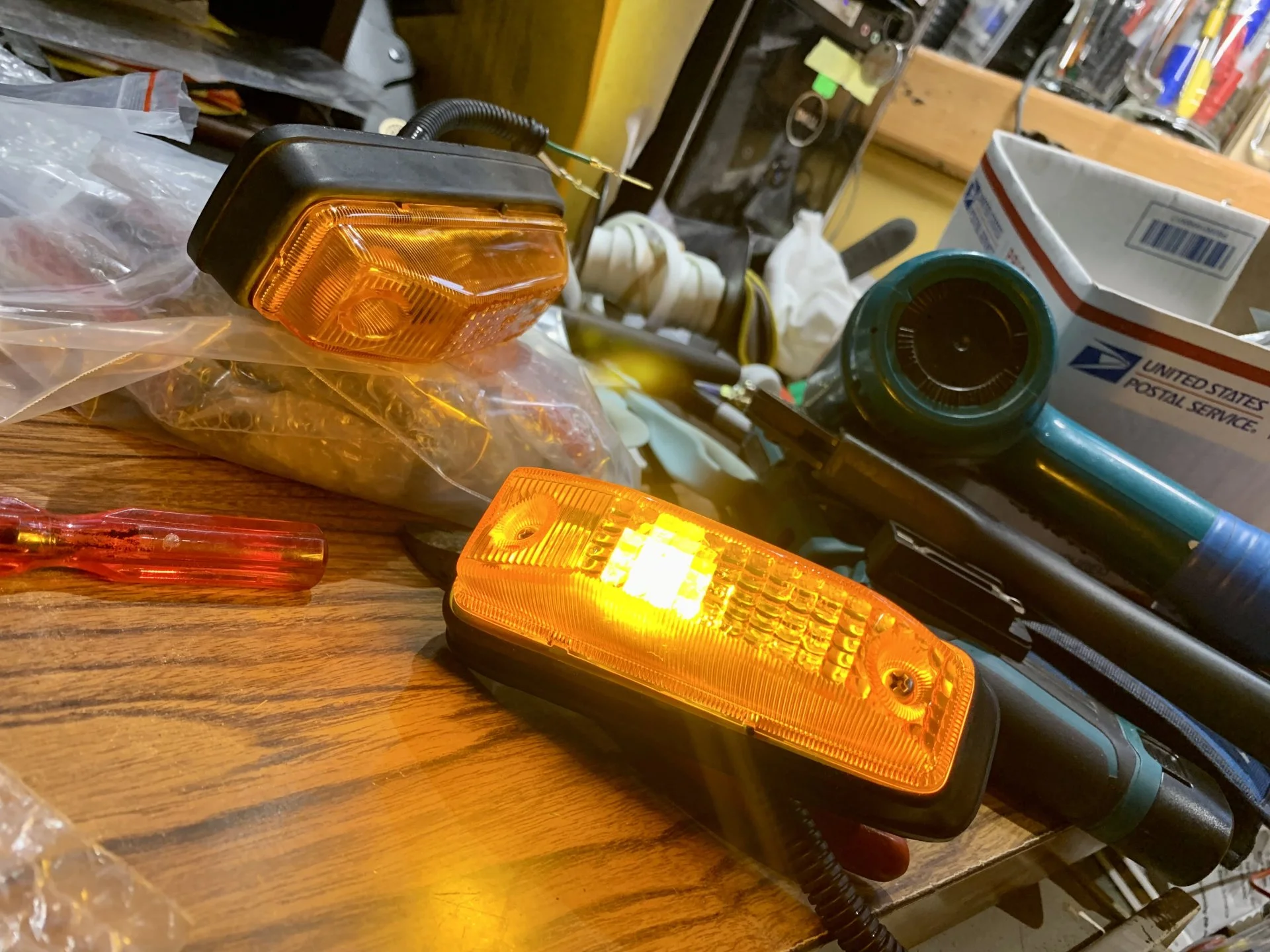

the HJ61 Complete assy.'s use a larger TWIST LOCK bayonet style bulb , i would call it a #67 or #89 style , same as the white lower clearance lamp assy. on the front
corner lamps ....
so i figure more LED PURE YELLOW LUMENS .... :)

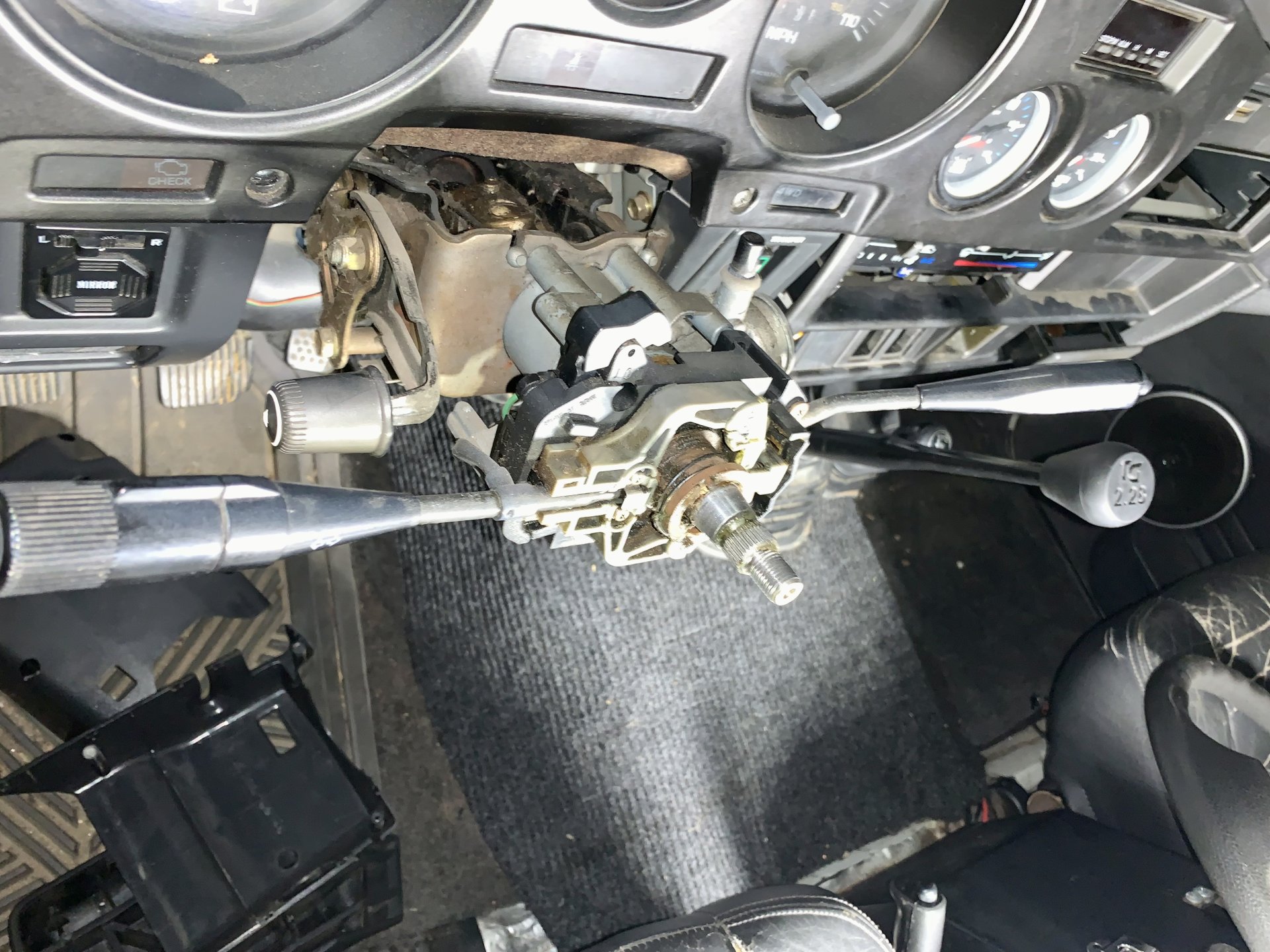

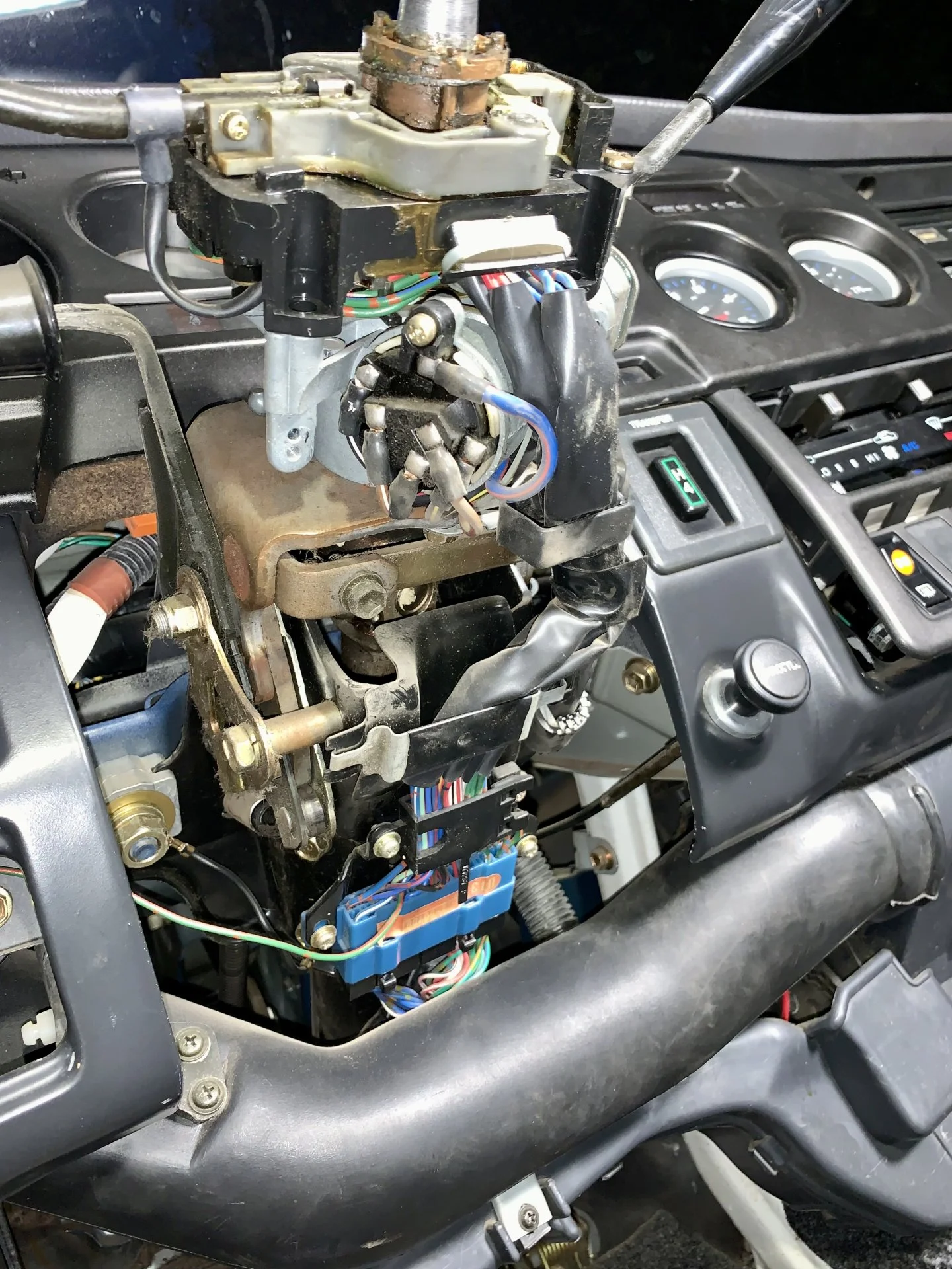

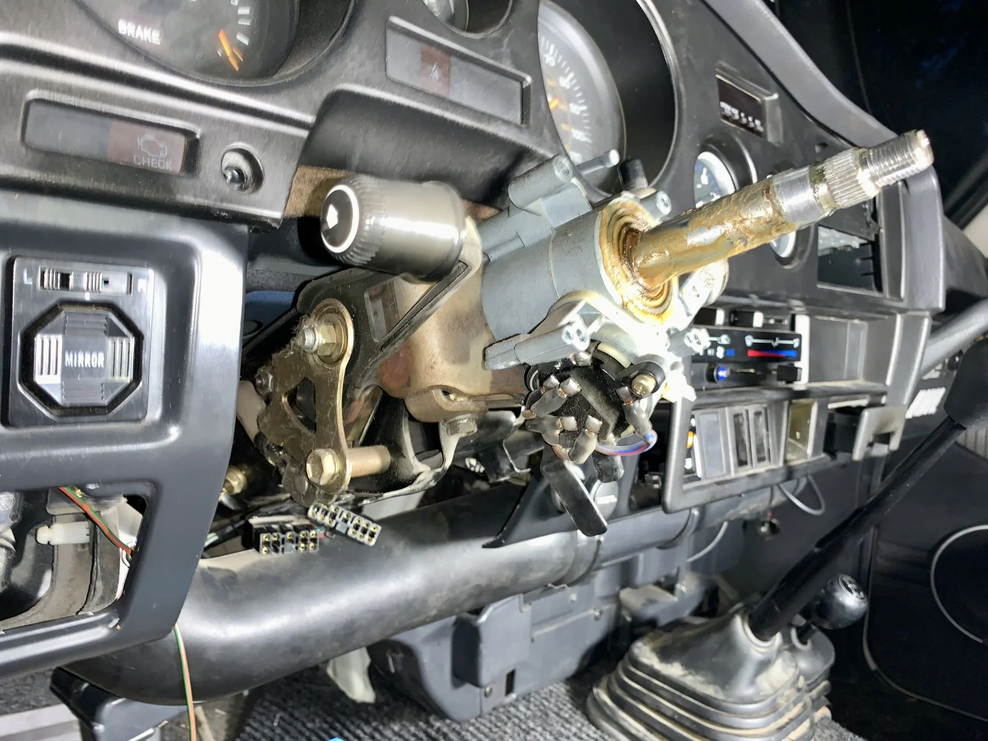

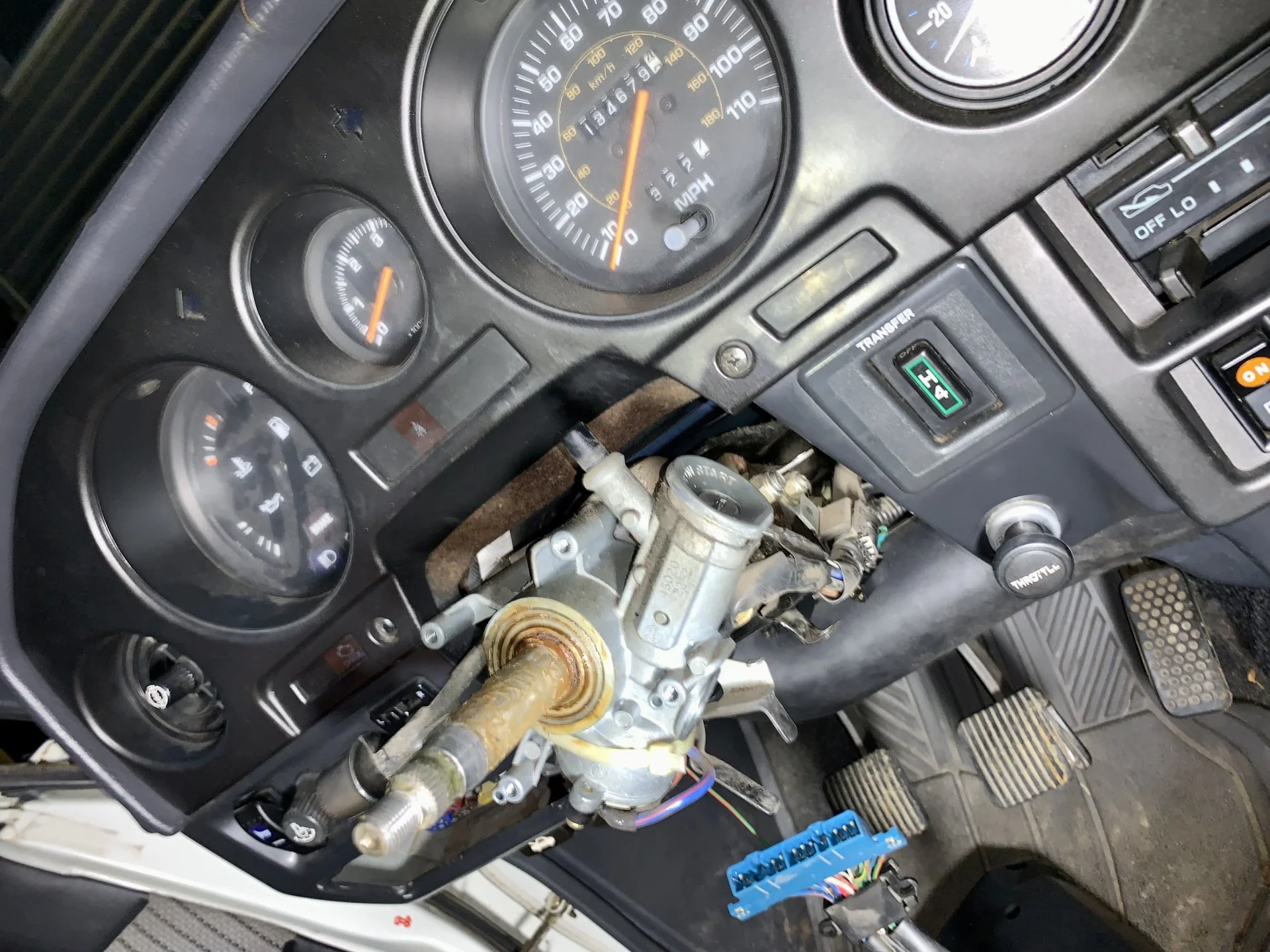

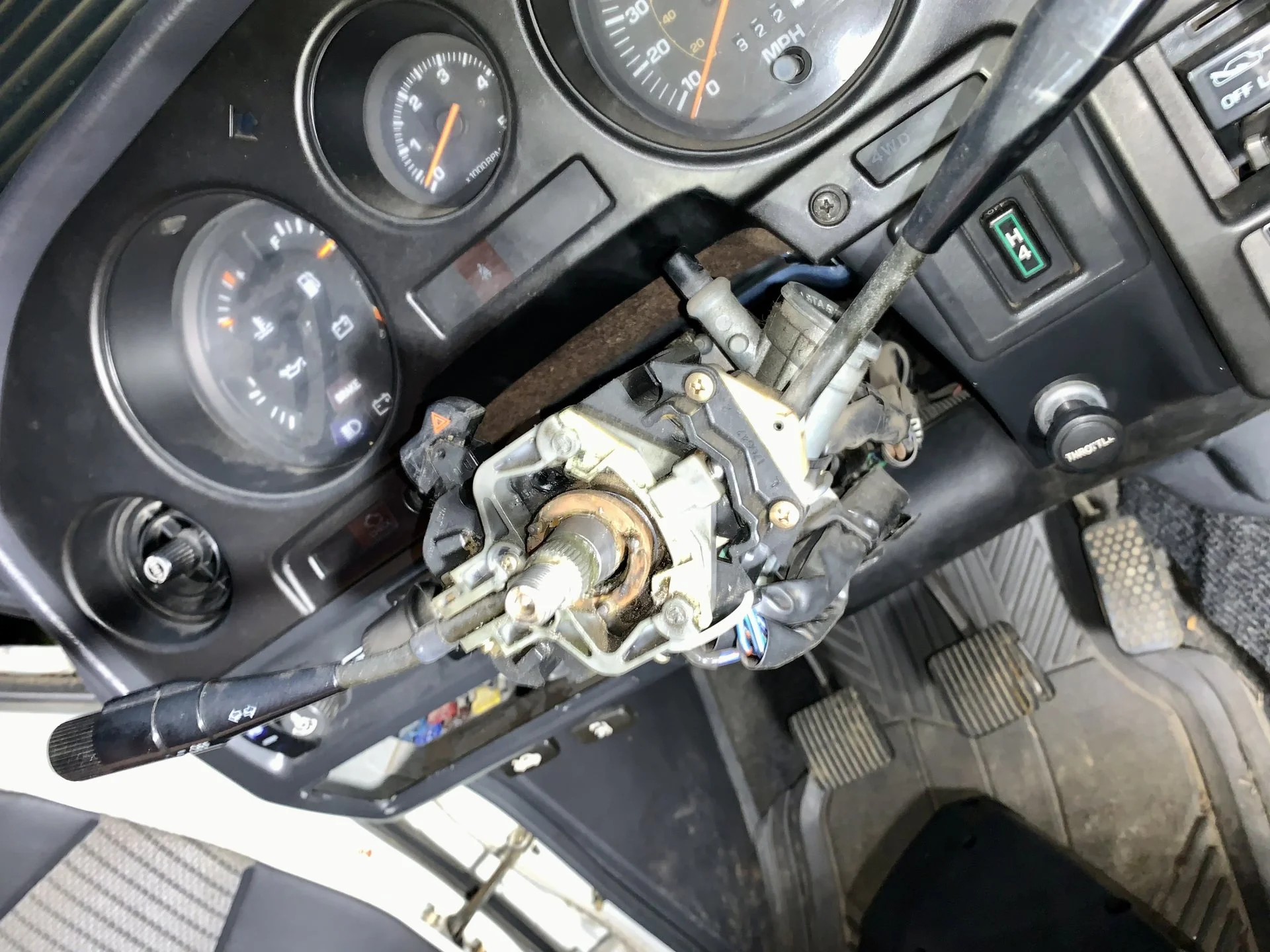

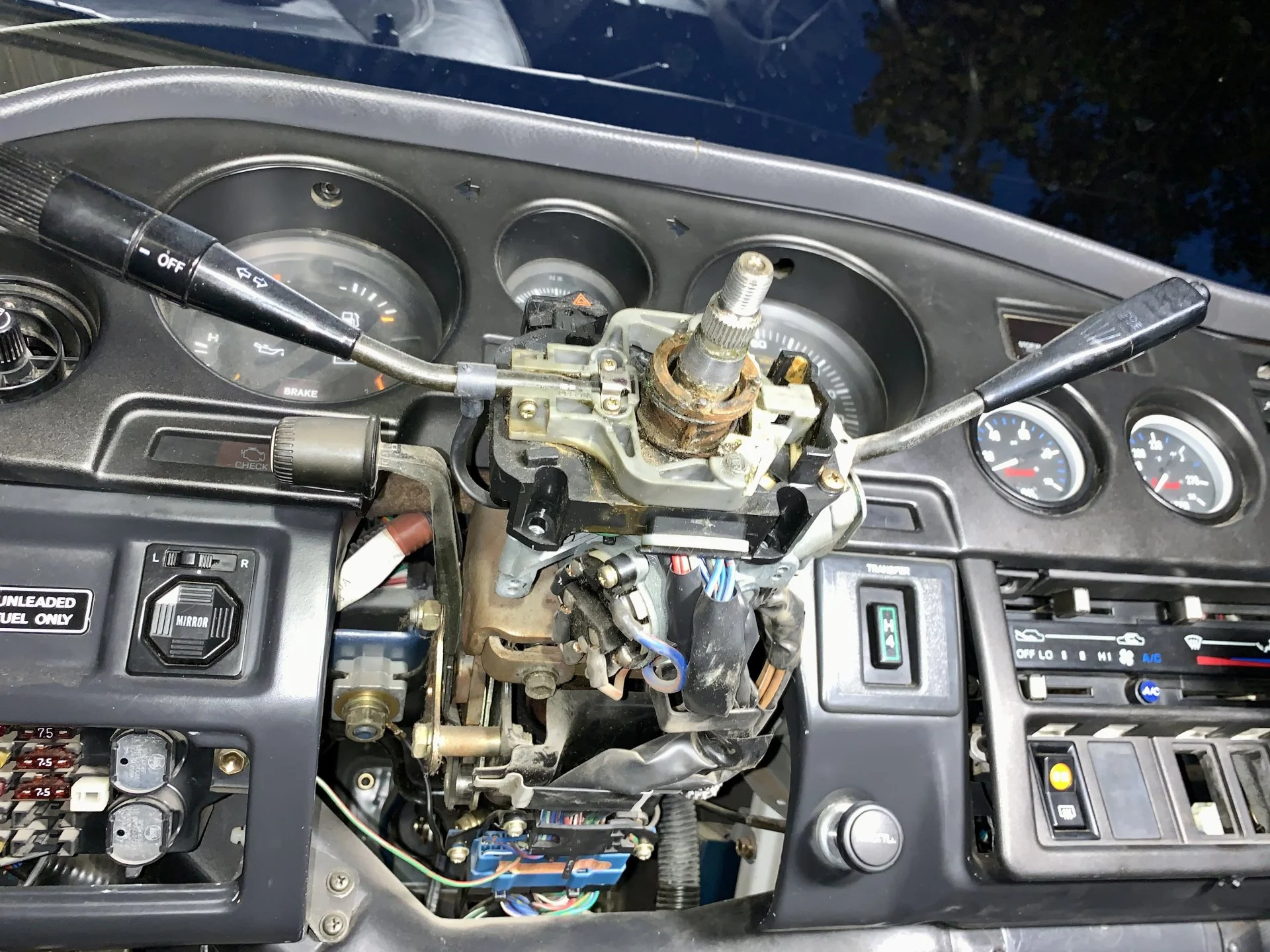

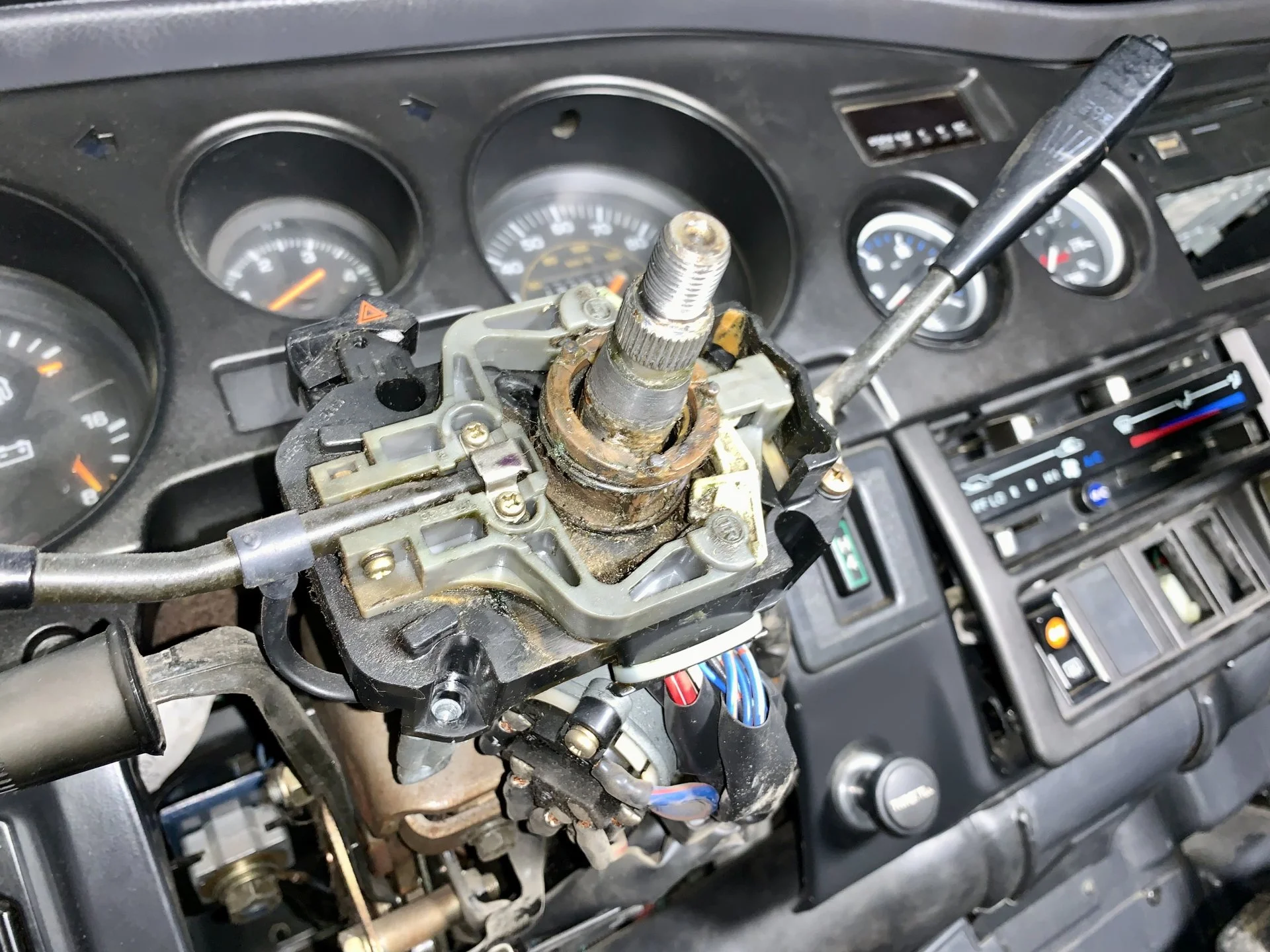

Replacing the Combo Switch this evening and the Electrical Key Switch and ignition Lock Cylinder
Why ?
- combo switch is simply old tired and sloppy
- I have a full NOS all matching 62 lock set 69005-90A14. So since I’m in there no better time , all lock cylinders are old sloppy tired and some shutter doors or broken in the open position …
- and well I must practice what I preach , anything else would be simply Passé’
- a new OEM Land Cruiser TR-33 lock cylinder of any kind FJ40 , 60 , 62 etc . Is a much more Secure and over all theft proof method of the SCUM not being able to gain access to CEMENT GHOST …
- I have never personally ever been able to jiggle open a new OEM lock cylinder with simply a old random tired TR-33 code cut key from another toyota Vehical that uses a TR-33 land cruiser Celica Corolla pick up 4runner cressida Corona carina hilux and do on all used TR33 at one production period time window or another ..
- in my opinion the best offense is a good defense to begin with , then you can ponder such creative addional security features such as a kill switch or the like
- what good is a kill switch if your $800 google chrome book is swiped ?
With a jiggle key method ?
That’s the cost of all new locks cylinders to begin with …
My 2 cents there
