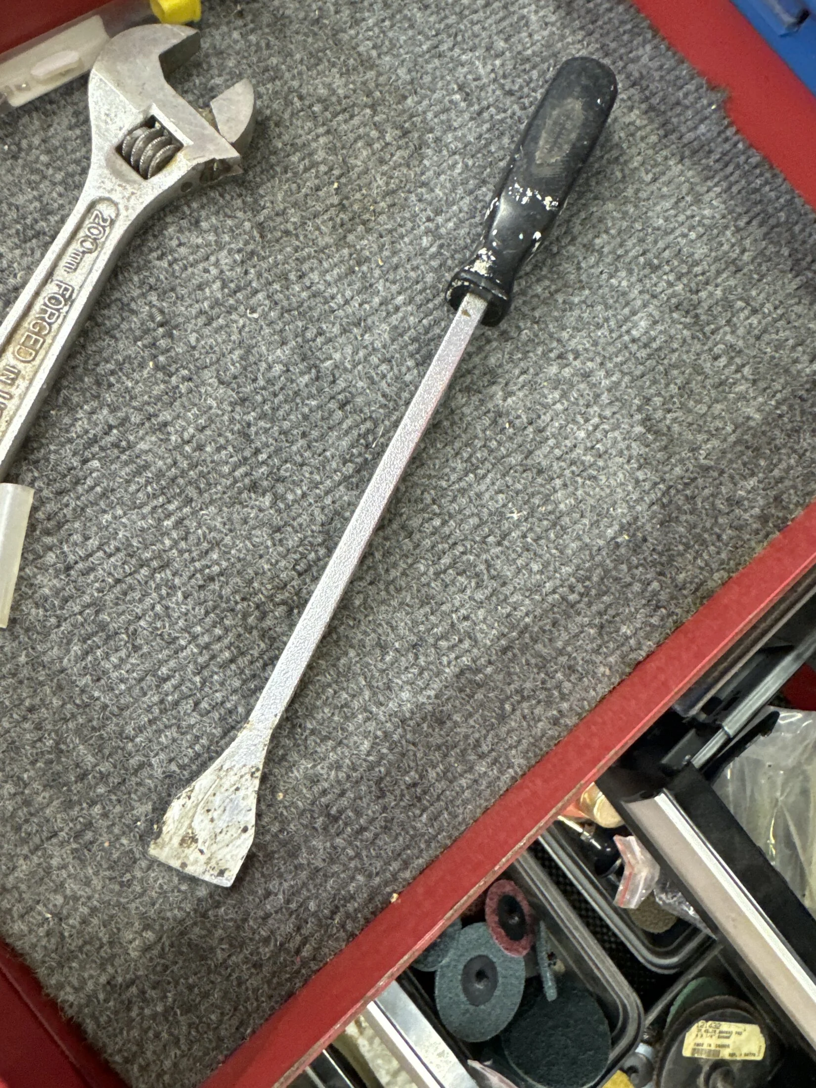

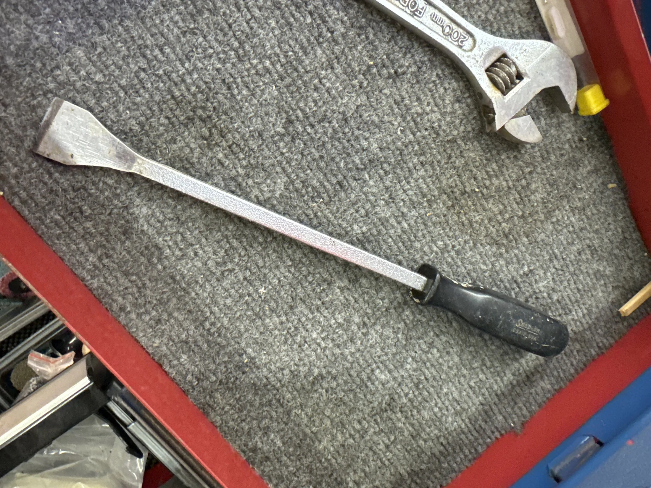

Trusty old Skool snap on gasket scraper
I can’t believe I forgot to take photos of this in action ?
Dam

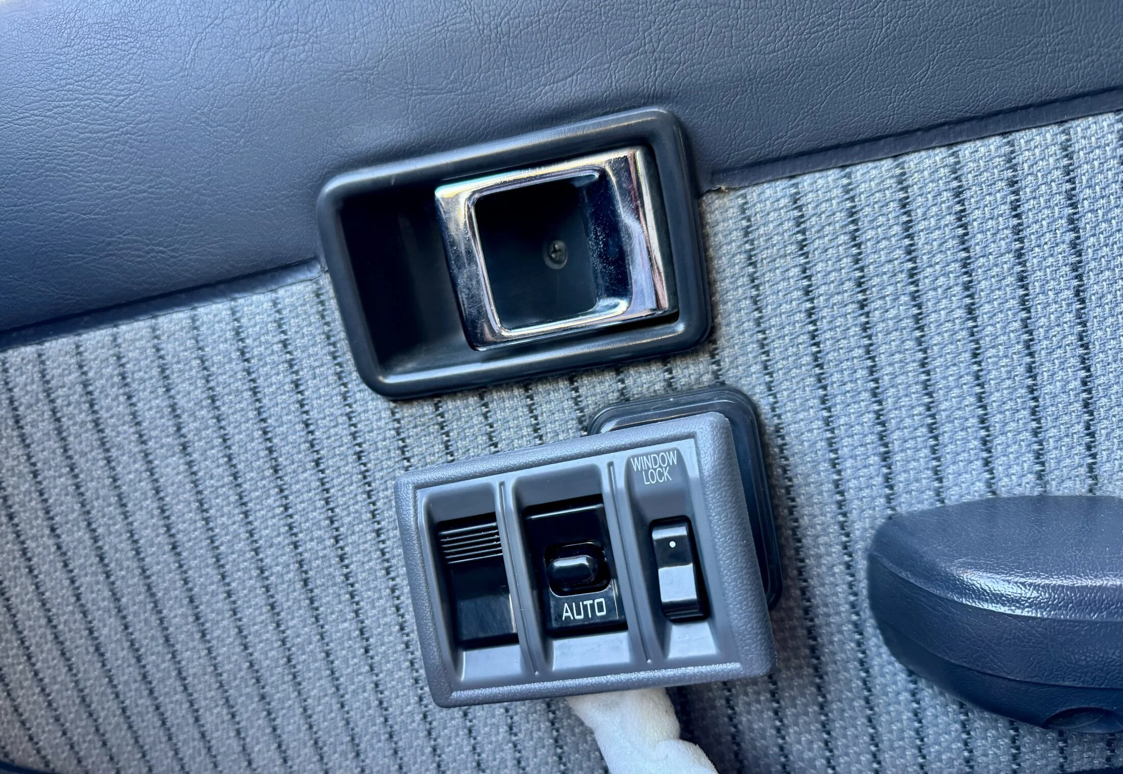

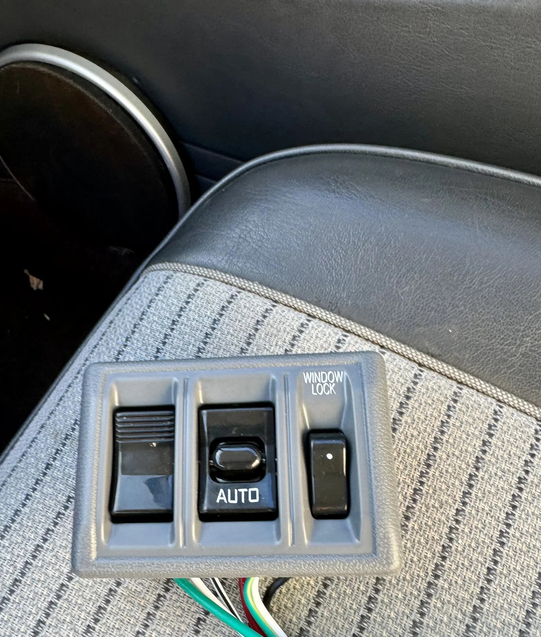

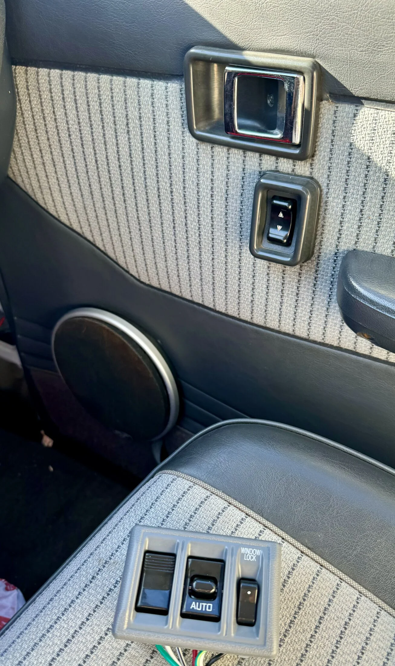

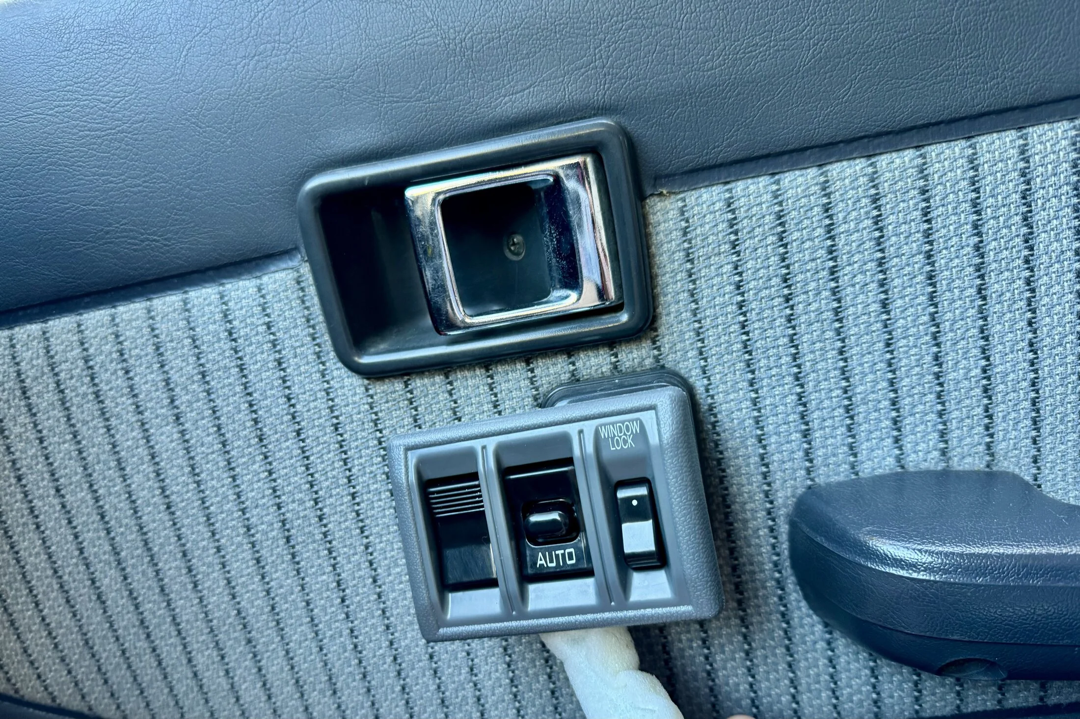

I can’t stand not being able to lock the doors from the passenger side like loading packages or boxes or groceries whatever …
Well well …..
This is what I crossed paths with …
The auto down is inside the little computer box Inside the back side ..
I do not know if Toyota wired the door locks on a B+ hot constant or on the ground ground side circuit that is still to be determined
But as far as factory fit form function and aesthetics, I do believe I got it as far as the difference in the trim code one I have color match parts ready and I’ve got that dialed in. It’s funny. It’s the same height top to bottom and I have like a little dremmle under the handle and then sweep it forward towards the front of the handle. I have to say if this works it’s pretty cool. I will have the only 60 series on the globe that has a passenger side door lock feature and window down. It wasn’t expecting the window down, but I guess it comes with territory, anyone have anyone ever done anything like this? Let me know. It seems pretty straightforward. You know how it comes in for the actuator. You get the window up and down and then the auto lock and then the other little button is like the window lock for like anti-child thing I guess I don’t know, but anyway ..

View attachment 3767066View attachment 3767067View attachment 3767069View attachment 3767070
That's gonna be pretty neat if you get that to work Matt

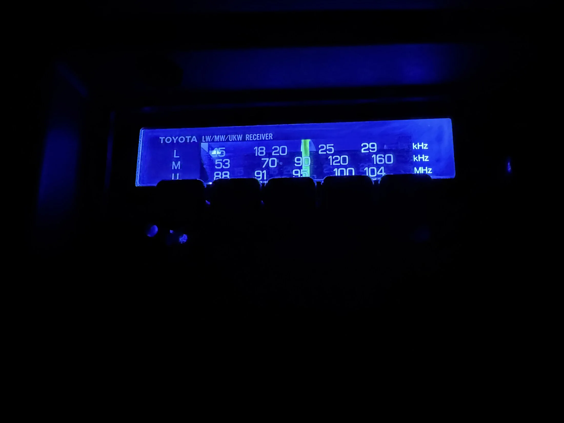

finally got the below ⬇️ dialed in .
a few notable tweeks to make it factory , fit , form , function etc ….

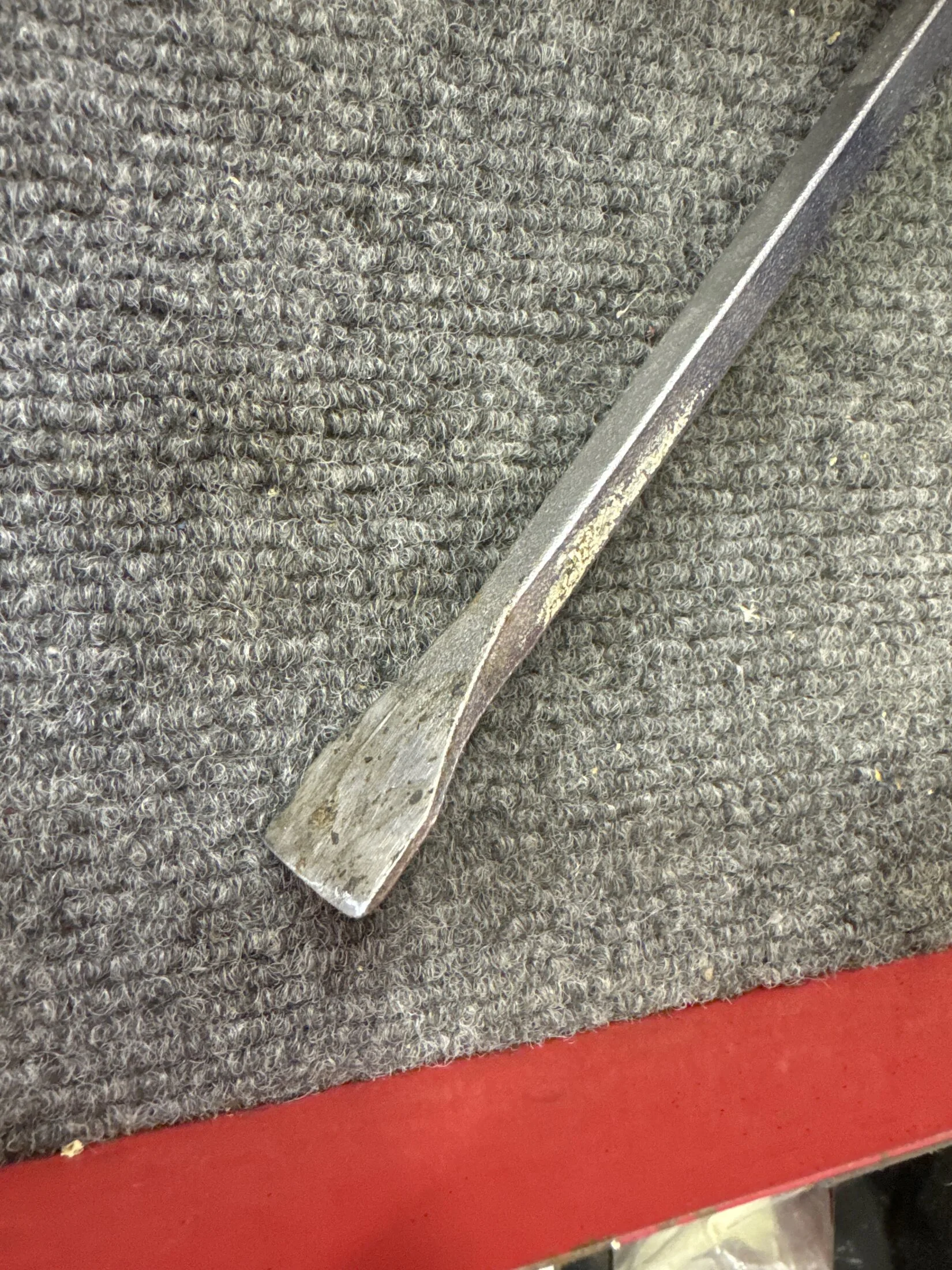

- trap-door OEM box , each side was rubbing the ID of the factory 62 radio bezels most end edges , enough to make me pull off the surround again ( I had not yet P2 JIS Vessel’d it home yet thankfully …

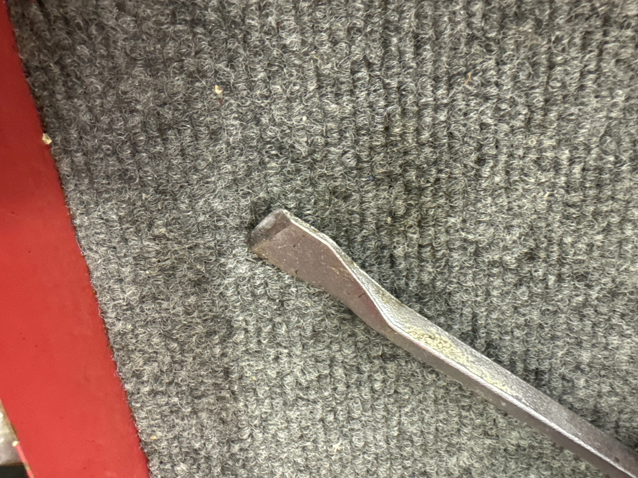

- I used a hand-held snap-on super-fine flat-bastard on each side live-edge of the trap door box , only taking the little sharp-ish angle 📐 end details down to the flat where the box door is the normal thickness
I would say : 1.5mm ishs tops …
That ways prefect and after loosing up all 4 main OEM Radio Double DIN screws to the dash exoskeleton , to give me a forgiveness factor
I center radio with radio trim panel again just snapped in place no screws
I was skooled back in the day on Double DINS if you do have a centering alignment tweek to make / preform ?
You take a site protection device , clean shop rag or big clean full length leather welding glove neatly folded square and get your left hand ( because I’m right handed ) and press in the right outer perimeter non-display or other kid-gloves areas and apply the “ death-grip “ push and don’t move that left hand a micron …!
You take your right hand and and un-snap the double DIN radio bezel over your left arm telescope style as far as you can and have your SST at the ready within reach and star-sequential pattern all 4 screws down even -steven so that mother will not move once you release the death grip push-technique…
It worked clock-work Smurf as it always does …

Below ⬇️ are the desired results :
TECH :
- Non-USA far away 3-Band / 3 international multi-frequency ranges
I do not know if there are more than 3 bands out there ?
- I had never seen this before I saw it online
- It was a NEW CAR TAKE OFF condition , & seller guaranteed it worked. / was his personal Double DIN he replaced with a GPS touch screen updated aftermarket set up …
- AM
- FM
- 3rd band range is : Short Wave band width / frequency range
- It’s user for : a non-usa far-away Emergency Broadcast System
- It’s a dedicated range / frequencies
- So it can be transmitted and heard over long distances
- So far I can’t find human generated audible anything …🔇
- I knew that might be the case or maybe no AM and or FM too ?
- so the now new de-void channel can be utilized for my planned stand alone satellite 🛰️ radio subscription gizmo exclusively and no Lame antenna jack T-Splitter monkey 🐒 business that can be finicky often ….

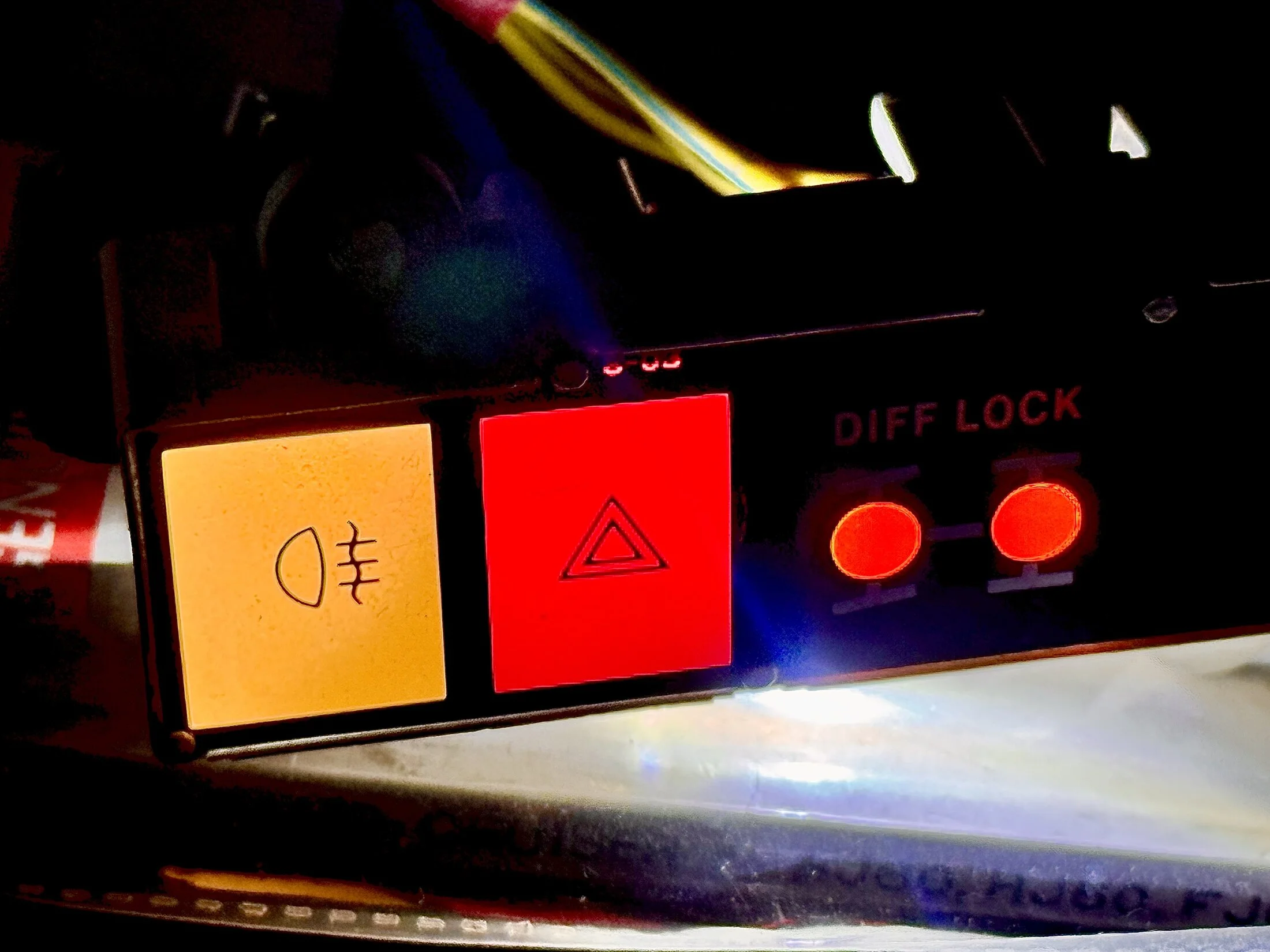

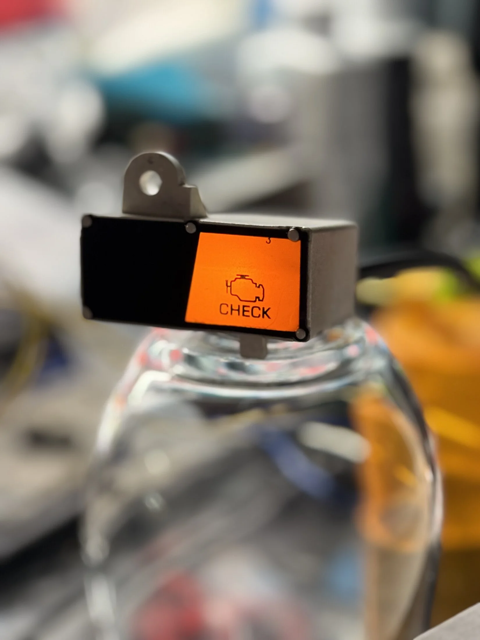

note : I swapped the incandescent little green rubber cap equipped OEM KOITo for a OEM blue LED , I also added a 2nd same spec. Micro-peanut bulb socket w/ pigtails and looped it around the rear to avoid the moving parts , it lands in the LH / opposing side and clocked at the same angle and general distance to the clear tuner display lens …
This is my form of : Fujitsu his & hers TEN interior Illumination upgrade , it truly balances the lumens and even warm rich glowy-glow-glow …

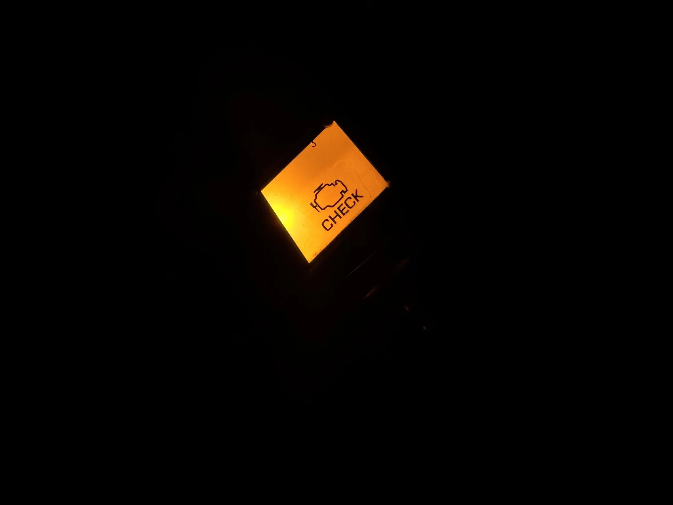

These are a working work in progress , my current task is stabilizing the rice-paper lens material so a FLY can’t kamikaze it useless ?
So far very Solid results I will share upon the final step by steps and recipe of poison chemicals involved …

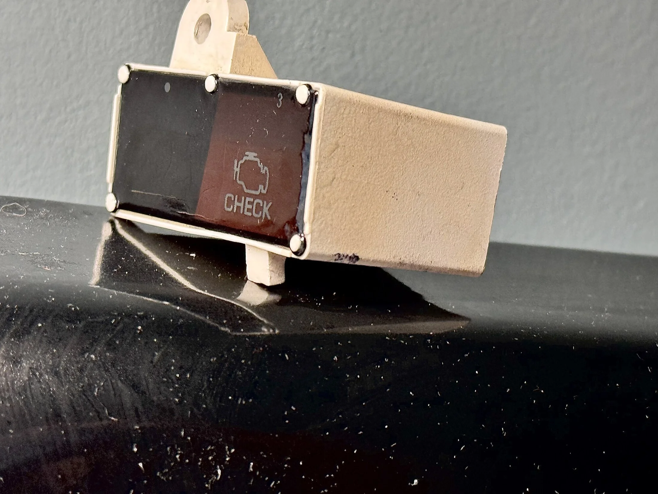

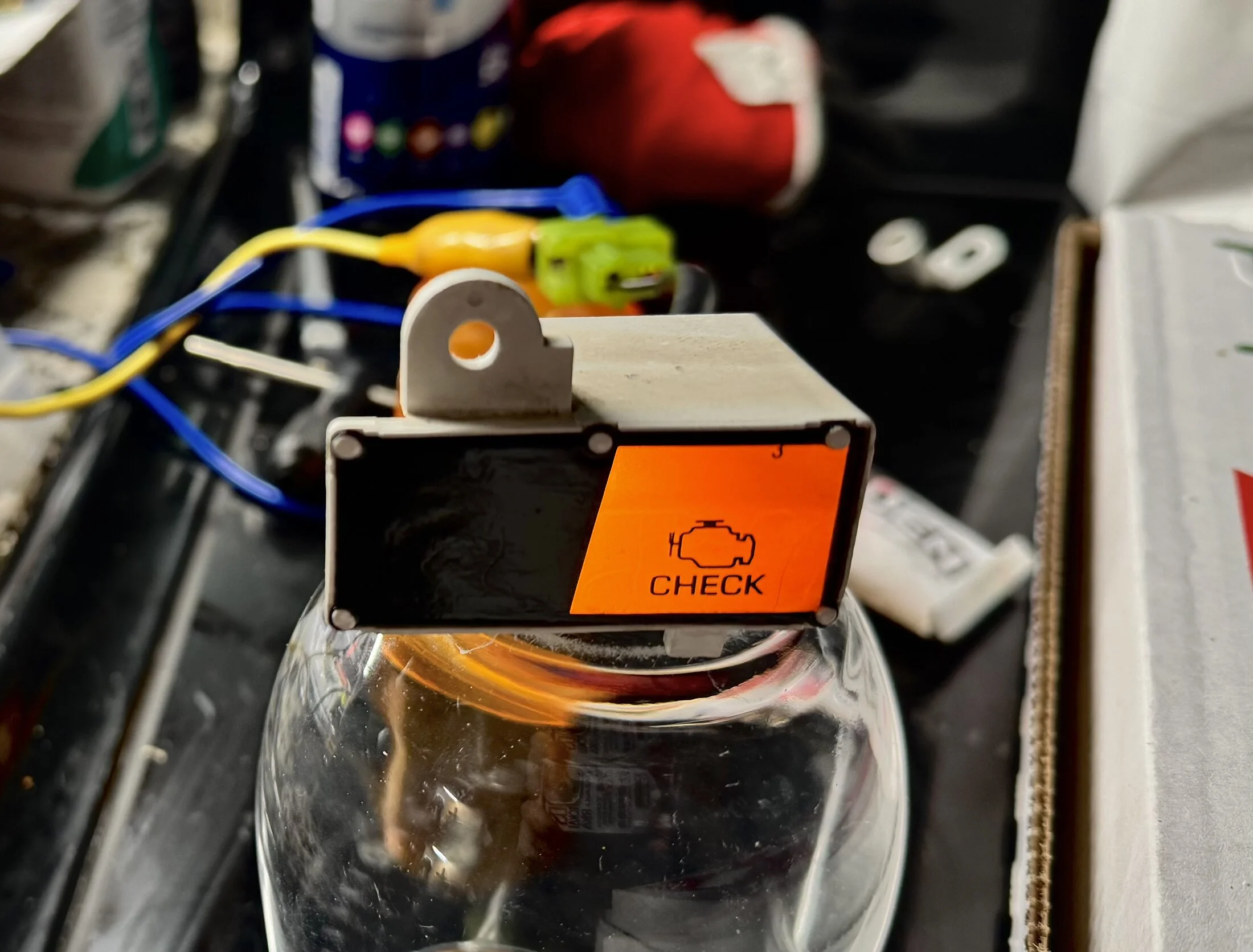

I am super excited to finally have the 10/87-12/89 OEM amber stand alone FOG indicator box build sheet build option going on …
the 2 little red globes ? not so sure what I will assign them to say tell me yet …..?🧐
