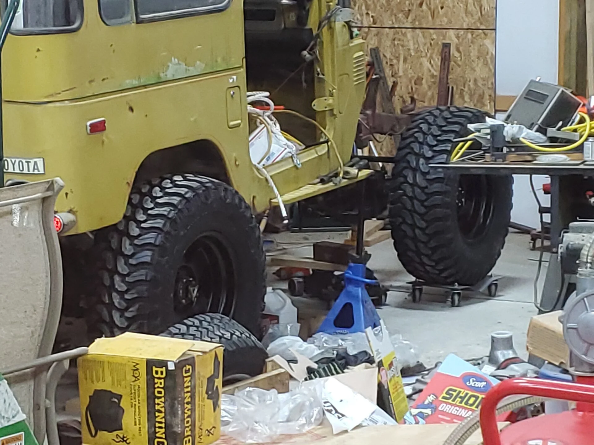

Reviving an old thread. I’m currently running 4in TPI springs with 1.5 shackles and plan on running 35’s. I’m going to run a factory style soft top and the bow sits about an inch higher than the garage door. I’m thinking to go back to factory size shackles and still run the 35’s but not sure if the tires will be rubbing the wheel well. I currently have one 35 on it and the others are 33’s but need to be replaced. Any help would be appreciated. The picture attached is the 35in tire to give an idea the clearance I currently have.

If it clear the fender now (with full suspension cycle) it will clear with the shorter shackles too .
Bump stop is the only thing that make it clear or not , in fact the distance between the axle and the frame in a full flex situation will be the same no matter if you have stock or 4" springs

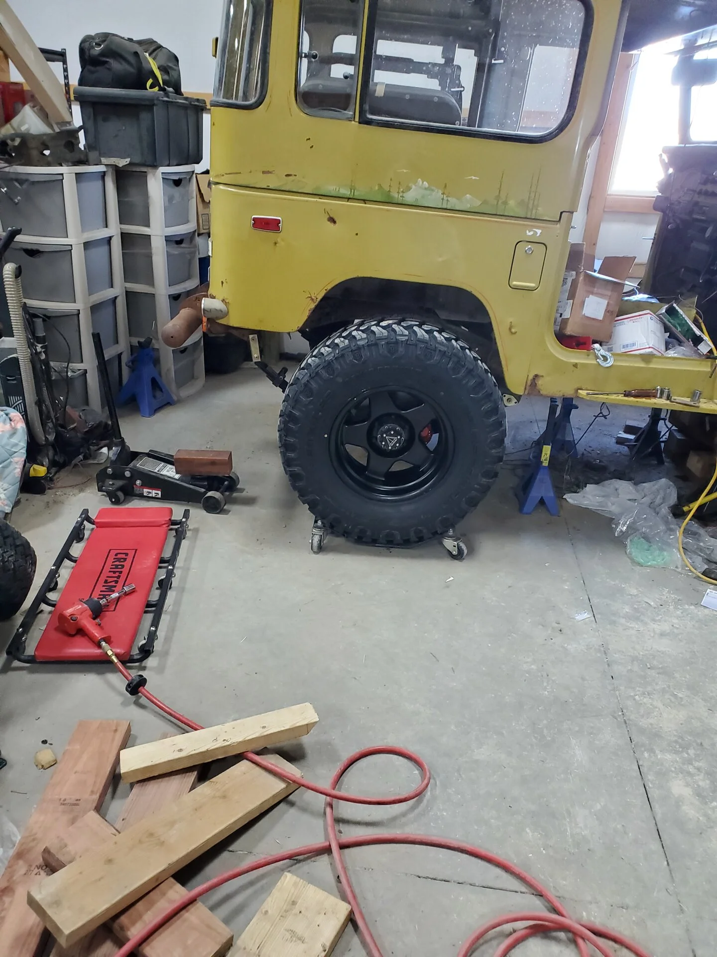

I just installed Alcan custom 4" rear and 3" in the front and have stock length shackles on my 78 but as of yet don't know how it will ride yet. I also installed 12x35s on 17" rims. Looks like trimming the rear fenders will need to be done and will move the rear axle back.

Yeah that’s really close! I’m definitely not plan on cutting my fenders. Worst case scenario I’ll go back to stock shackles and run 33’s if it’s to close.
Stock length shackles are too short for 4" rear springs, the spring can´t fully straighten.

I did not want 12.5"s but I live in central Wyoming and my local dealer was not able to get Micky Thompson 10" because they were out of stock or slow to be manufactured. The shipping alone was $150.
Are the wheels 10" or 8"? I wouldn't alter the fenders until the whole suspension is set up.
If I remember right they are 9" wide. I am still working on the mechanical any way, and the rear axles perches will have to be cut to get it centered and moved back and possibly rolled to get the pinion angle right with the transfer case.
When the body work starts we will look closer at if opening the fenders is needed.
So currently the 35” tire is on the back passenger side and the rest on 33’s. The side with the 35 is where I measured from. I have a theory that once I put 35’s on the other three that it will lower back end of the cruiser to give me clearance I need.
When I got the suspension and axle back under the the front with the 35s the back did come down a little and with it sitting on mismatched skates the front looked to high. When I get the motor and drive train back in I will check how level it is.
You'll need to install the other 3 to get a true reading. As other have mentioned a stk shackle might be a problem when if lift spring has to flatten out. I would guess your tires are going to rub the inside of the fender wells, if it's on the trail. A lower bumpstop would probably fix both issues. You could add 1/4" spacers to help a bit but they'll still rub a bit. I run 35x10.50 boggers on stk wheels and they rub. The tires actually measure 33".
