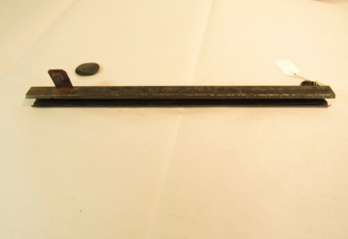

The rear glass holder has 4 bolts, or lugs, or what call you, that attach to the Regulator channels; two to a side. One of my lugs is rusted/broken off, as is shown on the picture above.
This is in addition to some stripped teeth on the rear window gear, and one of the regulator arms (the one that attaches to the regulator channel shown, has too much movement to it.
Another project.
Looks like I'm not the only one having this issue.
Unfortunately, this is my DD. I need to get in the back, and I need to not have rain get in the back. So I can maybe bubba it somehow.

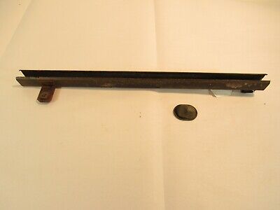

These are a bit pricey and I don't think they include the pins but thought I would share anyway. There was recently an entire assembly on ebay for $150 IIRC but it appears to be gone. I don't think the assembly came with the window glass channel or these two parts however. Good luck. These rear windows are great.....when they work.
