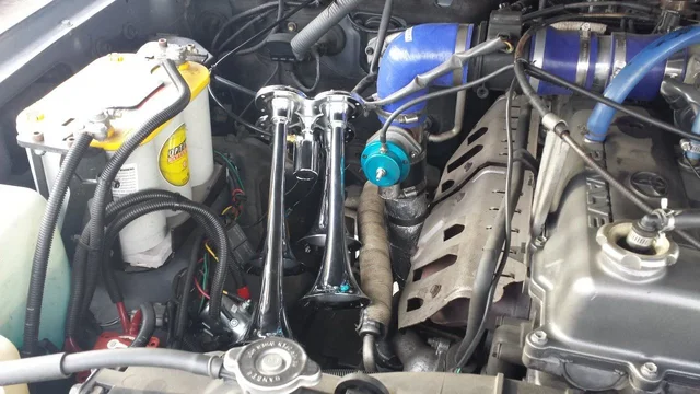

Mounted an ebay tank down under the front driver side frame rail. Used the Viair compressor with a in cabin switch and auto shut off pressure switch. Extended the stainless steel line for easy access to attach the air hose. Also mounted an air horn which comes in very handy when prius drivers tend to wander :steer: beyond their lanes. Been using it for a year now with no issues.
