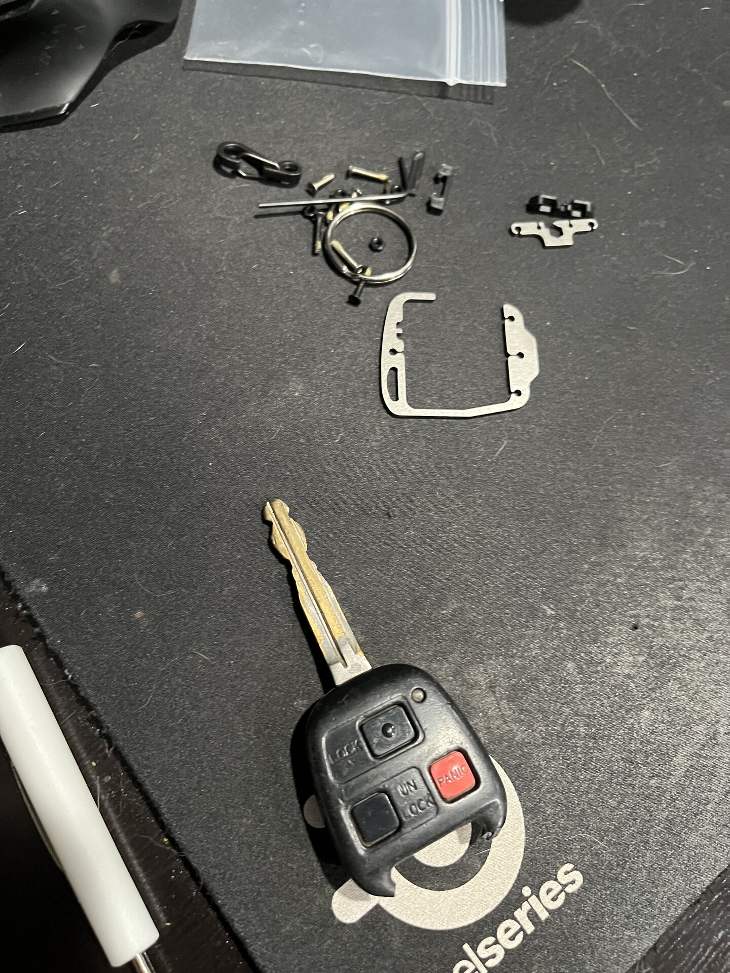

Anyone ran into an issue where the key is molded to the shell? My 05 LX key is molded in, not sure how to get it out.
Remove the transponder module then break off the remaining plastic bits till you're just left with the metal key. Easy enough with care.
They're all like that. The key blade is always molded into the plastic case and must be removed. Since most shells are already cracked the key blade tends to come out easy, but you might need pliers or diagonal cutters to get the key free if your shell hasn't cracked yet.
