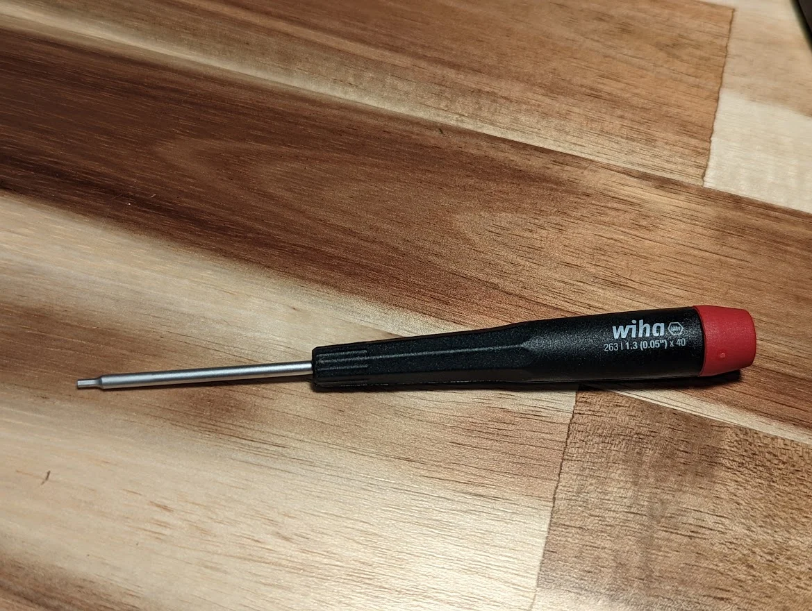

Thanks for all these comments everyone. This wiggle phenomenon finally popped up in my own key. I went to change cases and the key (which was previously fine) was putting up a lot of resistance. I started slipping my standard L wrench and had to switch over to the dedicated 1.3mm driver bit.
The problem was simply gummed up threads and a little extra threadlocker on the screw. Cleaning off the threads and chasing the screw through fixed it, but it was very difficult without the right tool.
So on that note, I'm now stocking these Wiha dedicated drivers. They are AWESOME. Made in Europe (Poland or Germany, pending the batch I think). These are not something I can include in every kit, but I do want to make them available to anyone that wants one. I'll also post up some options on Amazon as well.
