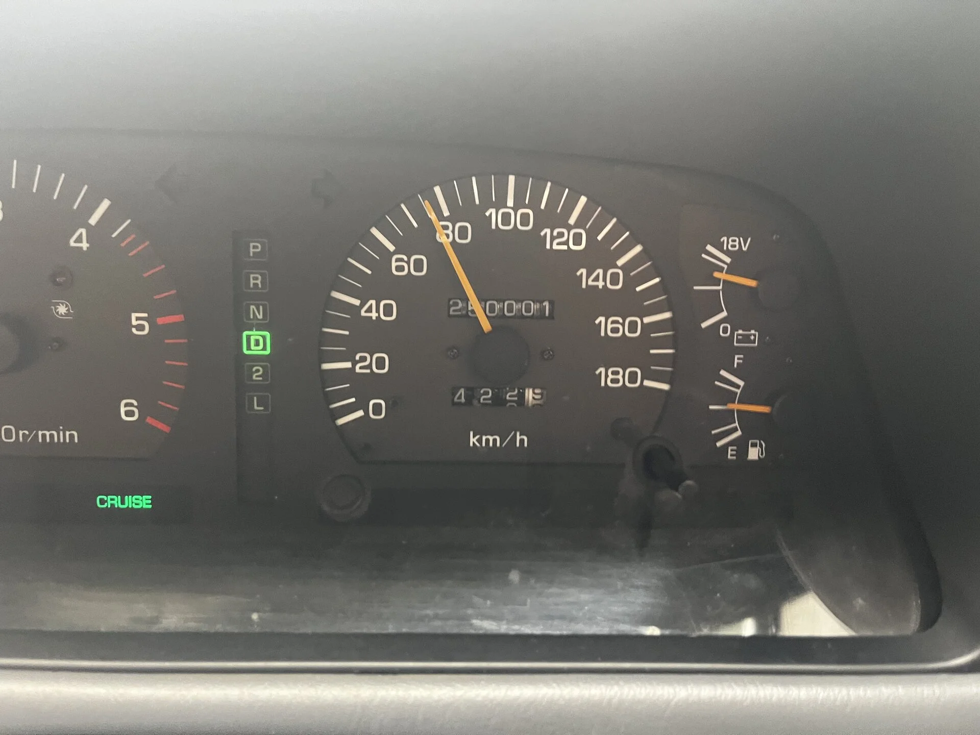

Yoshi did tick over 250k km yesterday near Forks! To celebrate, hauled a bunch of buddies from out-of-town all over the Olympic Peninsula. Second picture is of the Hurricane Ridge wildfire... nasty stuff.
I wonder why yours says cruise and mine says a/d

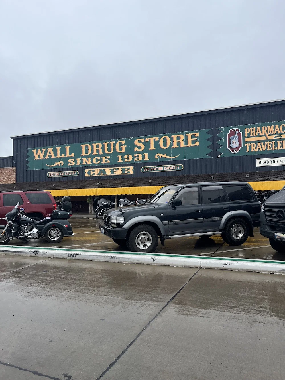

Some phone pictures from the last month in South Dakota:

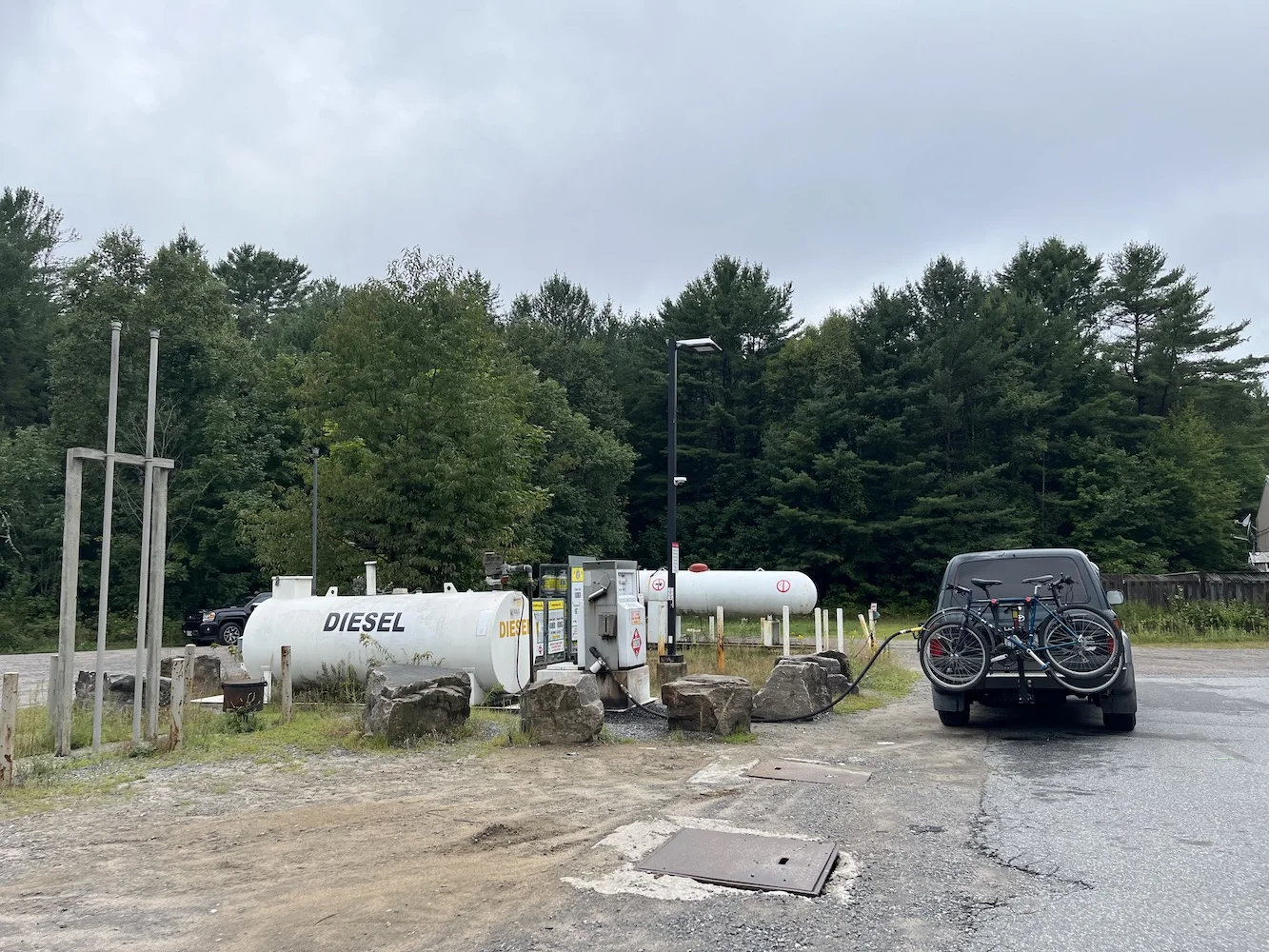

And backwoods Ontario with the most rustic fuel pump I've ever used:
That's not near Atikokan is it? It looks like a gas stop I attempted with only fumes in my tank and they hadn't received there summer delivery of fuel....
No idea, but i like the idea of "Auto Drive" from What does "A/D" mean? - https://forum.ih8mud.com/threads/what-does-a-d-mean.402948/
No, just near Algonquin. I've never been that far north or west in Ontario. Wouldn't be surprised if that's what lots of pumps look like though outside of southeastern Ontario.

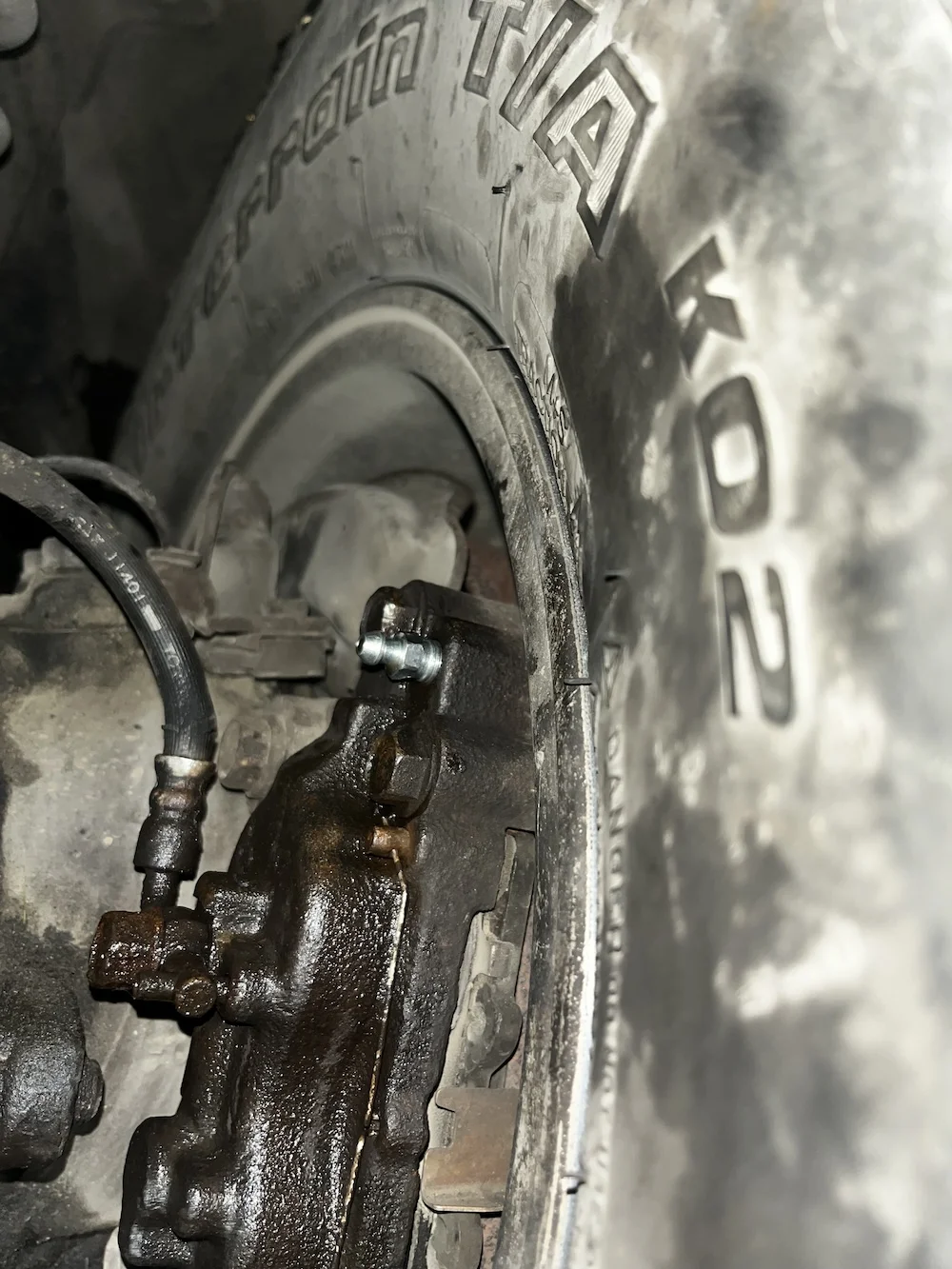

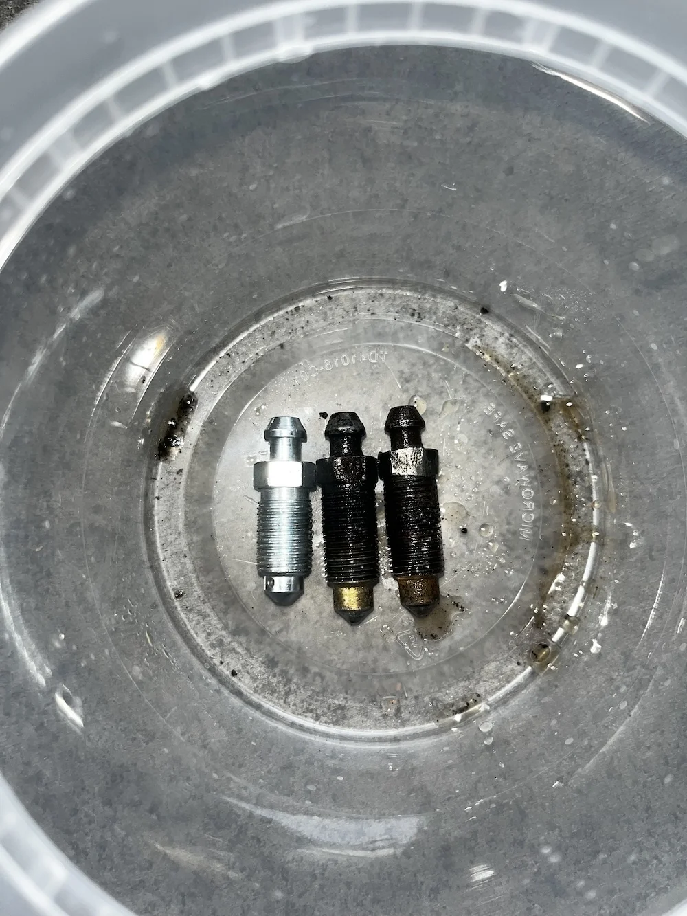

The blake bleeder screw is really close to the two nearest bolts on the front - if you have a shorter screw (like the one for the rear) you can't access it! Beware! See below with the NAPA 22070 rear brake bleeder screw installed.
Showing the length difference below - on the left is NAPA 22069, in the middle and right were the front brake bleeder screws off Yoshi. NAPA 23927 is the right length, but isn't fully threaded the way the Toyota ones are - it has some unthreaded shaft which is fine.

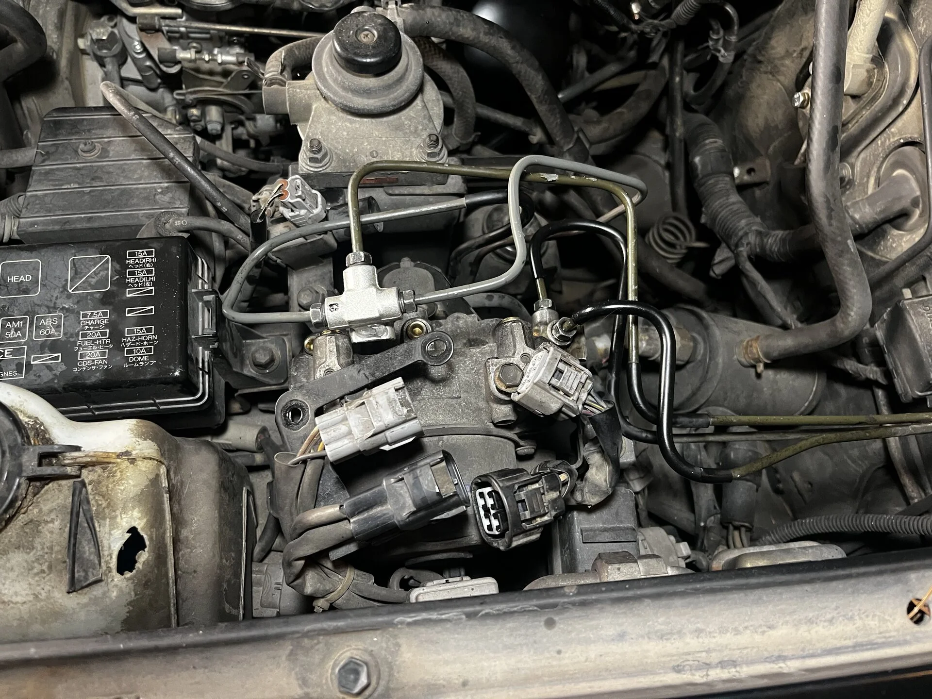

Been a busy couple of months again, but I did work on the brakes some more. I tried triggering the ABS actuators multiple times and then bleeding, to try and address the possible 80-series apocryphal bubbles that form in the actuator. That make no difference, so then this weekend I bypassed the ABS actuators and that made a marginal improvement. I think my next steps are just working systematically through the braking system - replacing the LPSV and then maybe overhauling each corner.

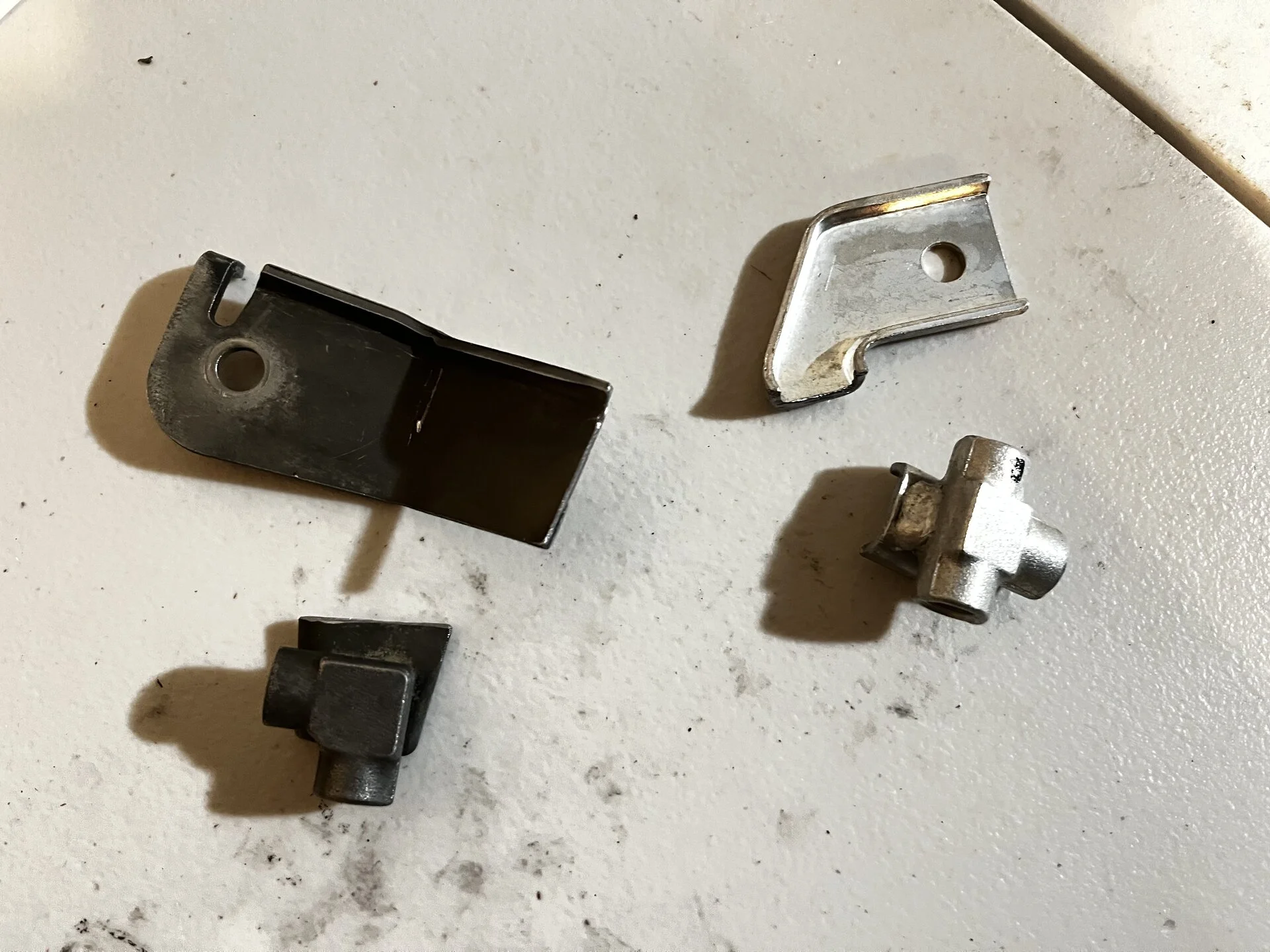

I haven't seen a writeup on bypassing the ABS on a RHD vehicle. I could not find right-angle fittings or Tee fittings in M10-1.00mm bubble flare (stock 80-series), so I bought a right-angle fitting from an axle from the local dealership (PN 47392-60020) and the tee below the master cylinder used from SOR (PN 90413-10058). They come with brackets, so angle grinded the brackets off; then unbolted the lines from the ABS actuators; plugged the ABS actuators' ports (would love to hook it back up someday); then carefully bent the lines and installed the fittings. Need to still clean it up (adding some padding for the fittings against the actuators at a minimum).
Those original fittings
My first ever at-home metalworking
The tees aren't pretty, but they work

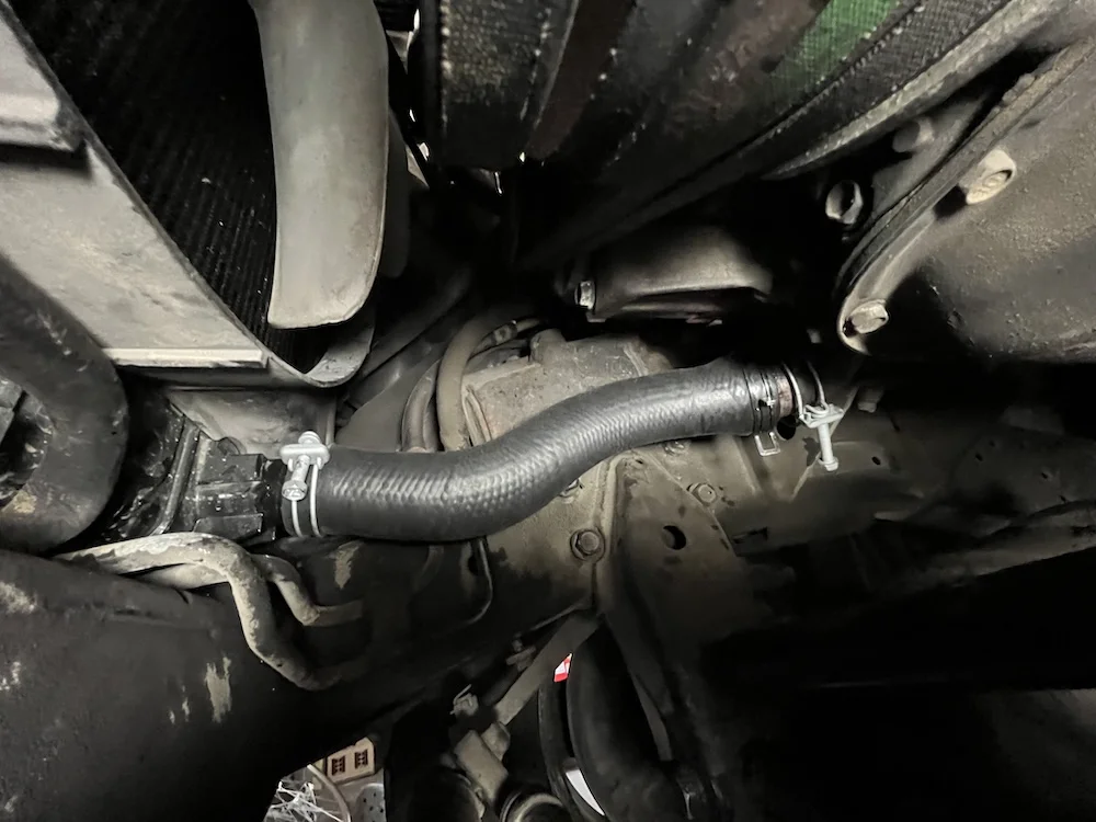

UPDATE 06/22/25: I ordered the wrong OEM lower rad hose! I ordered an upper rad hose, and shoehorned it to be a lower rad hose by mistake. See this post for details.
Original post:

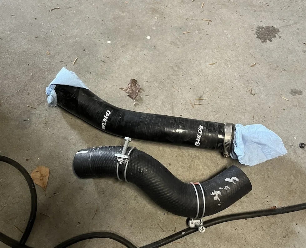

I also tried to replace my lower rad hose with OEM parts (instead of the Chinese kit I bought two years ago).
I need to do a full writeup on my coolant hose setup because I've never written it all down, and I've learned a few things since then.
For the lower rad hose, it's barely long enough to make it from my 1HZ radiator to the thermostat housing; and I had to heat it up to get it to fit around the thermostat housing. The hose clamps did not fit on the thermostat housing end, so I went out and got some 2-2.25" constant tension clamps (Dorman 14188 for ten, 14088 for two) and they just fit at that end. This is enough for rolling around; but if the hose doesn't relax into a better shape I will look at replacing it with a straight-across piece that I bend a little bit.
