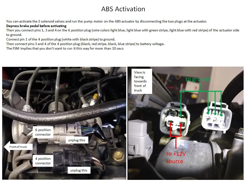

Wyatt Pine - sorry did not see your request in post #29 until today. Below is how I activated my ABS. I did this several times in short bursts (5 secs) and then bled.

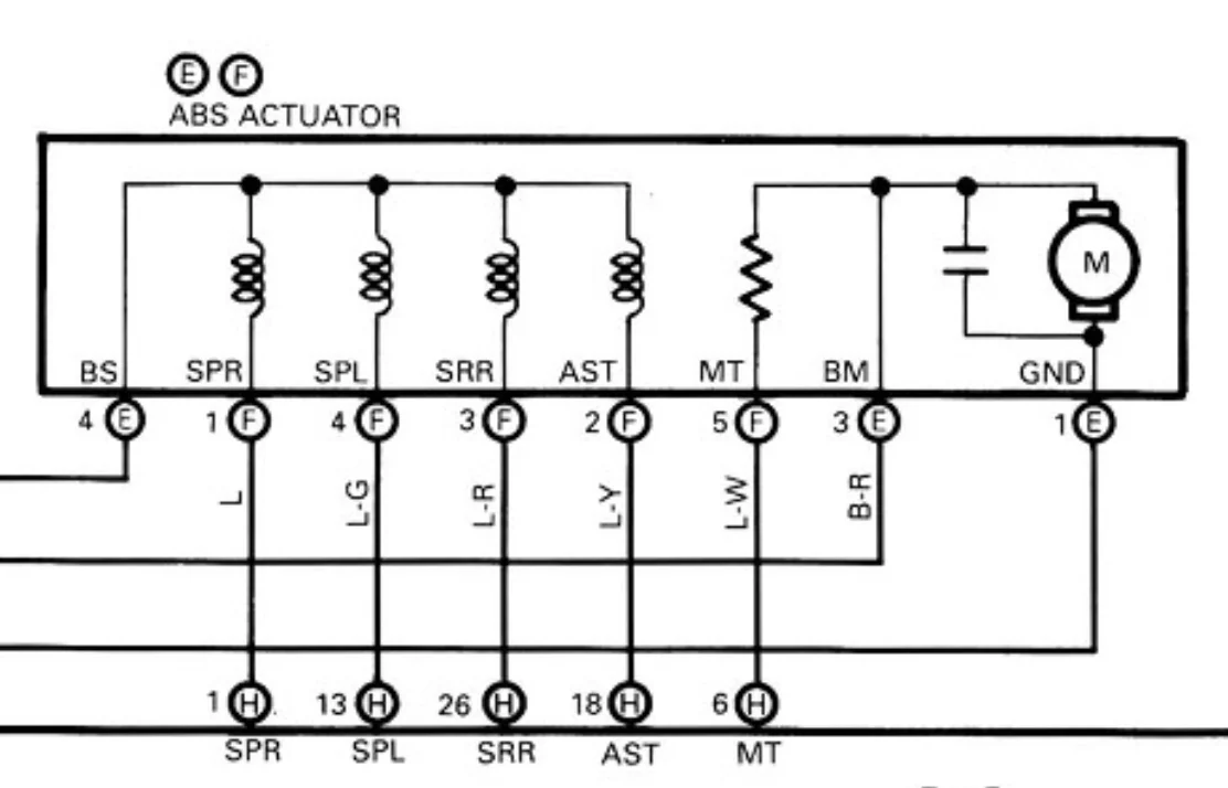

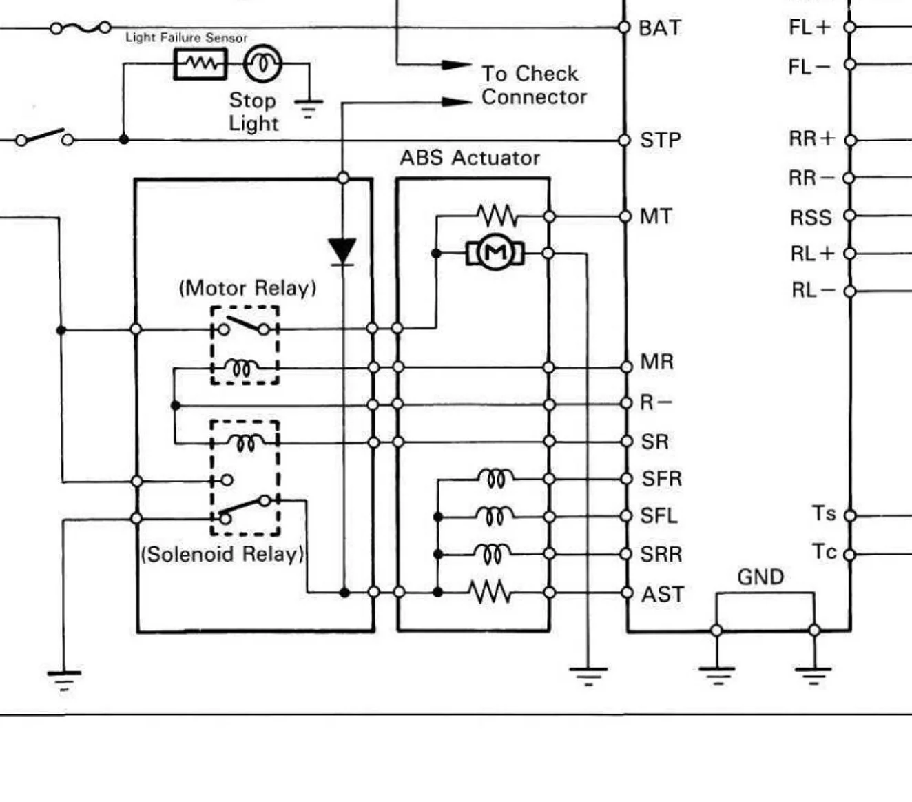

I manually ran my ABS actuators today, to flush out the remaining fluid and air, to try and get rid of my soft pedal. Unfortunately my pedal is still soft after bleeding at all five points, so my hunt for bubbles will continue. But I did it a bit differently then @cartercd based on the FSM. It looks to me that you want to attach +12V to the same pins he indicated, but on the six-pin connector actually connect pins 1, 3, 4 to ground (not 1, 2, 3).
Pin 1 is "SPR" which I figure is "right" as in front right

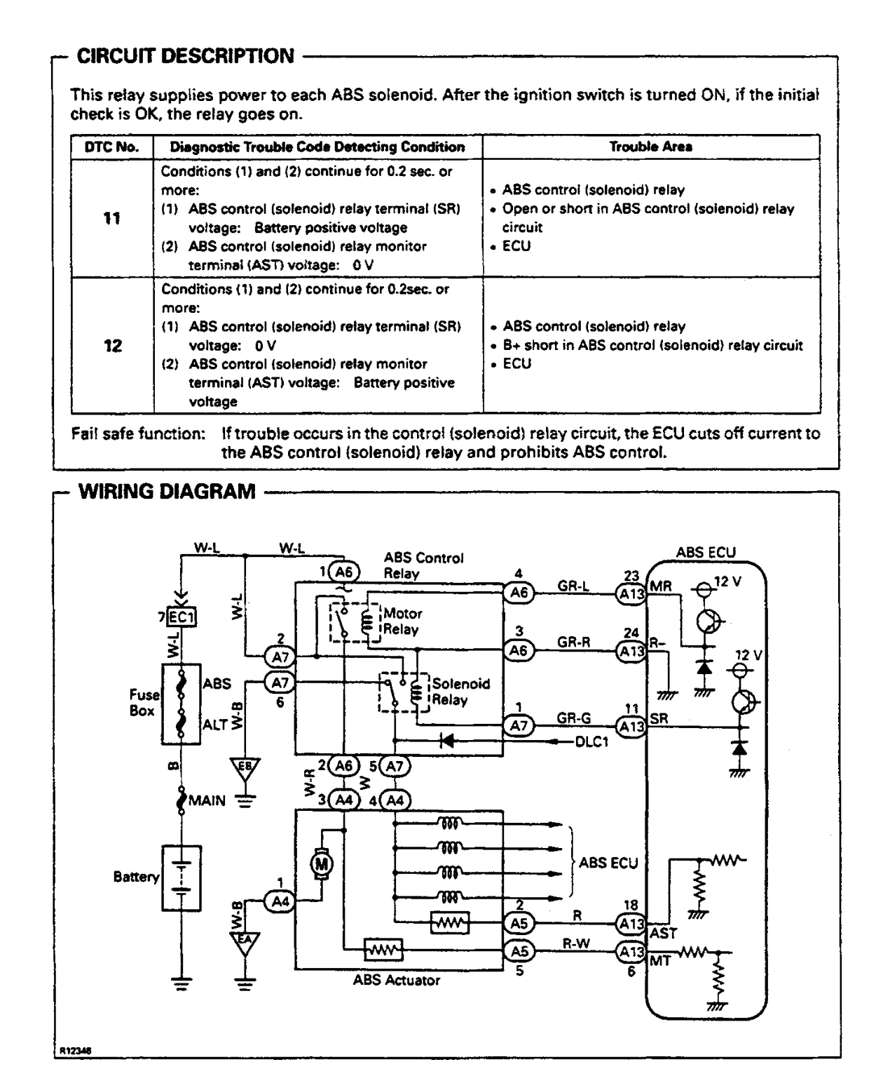

Pin 2 is "AST", which is shown as being a solenoid in the overall vehicle wiring diagram below. But the ABS-specific wiring diagram shows "AST" with a resistor. I did not close the circuit on this pin... not sure what it is. Does anyone know what it is?
Pin 3 is "SRR" which I figure is "rear"
Pin 4 is "SPL" which I figure is "left" as in front left
Finally answered my own question by finding this random Lexus technical training doc on ABS for vehicles of the era (notably not the LC/LX): the AST pin is a status pin. If the ECU sees abnormal voltages at that pin, it will throw error codes (described in the FSM). So not needed for jumping the ABS actuator.

@kenavt
What would you change about this connection strategy after your recent reading?
I don’t know what you’re getting at here… so here’s a couple of attempts:
  • I didn’t mention this, but I was also running the pump on the 4-pin connector.
  • The correction I had was the difference between the words and drawing in the original picture: the drawing shows 6-pin connector pins 1,2,3 shorted to GND, but the text says pins 1,3,4 (which I think is right).
Thanks @kenavt
I was trying to tie your recent observations back to the images from @cartercd that he shared in post #19 and #35 in this thread. I've used the post #35 image to actuate the ABS pump on my '97 80 during a brake fluid flush with good results. I'm up to changing the approach if there is more/better info available but I'm not sure that your observations indicate a change of approach for the goal of activating ABS while flushing brake fluid. Given the overall focus of the thread I thought I'd ask for a little clarification.

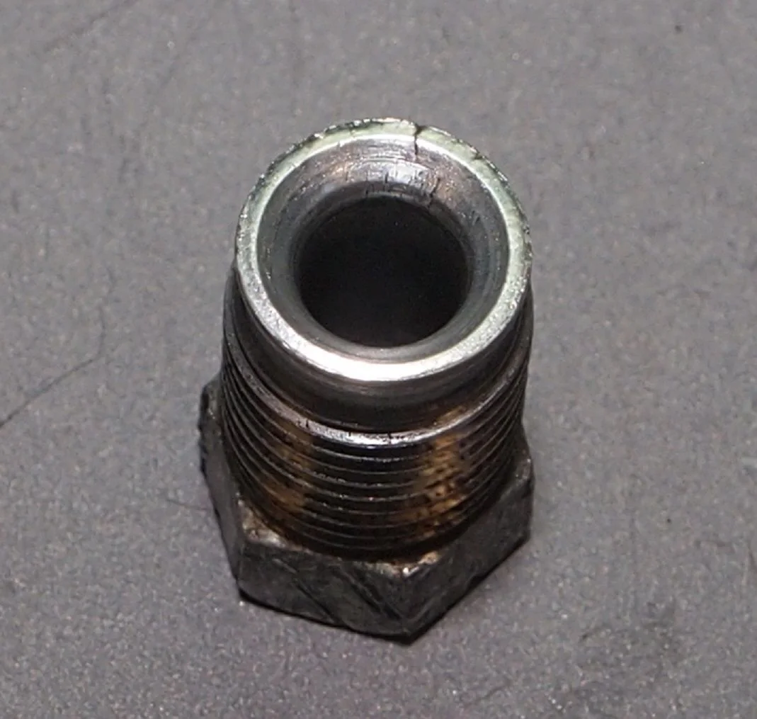

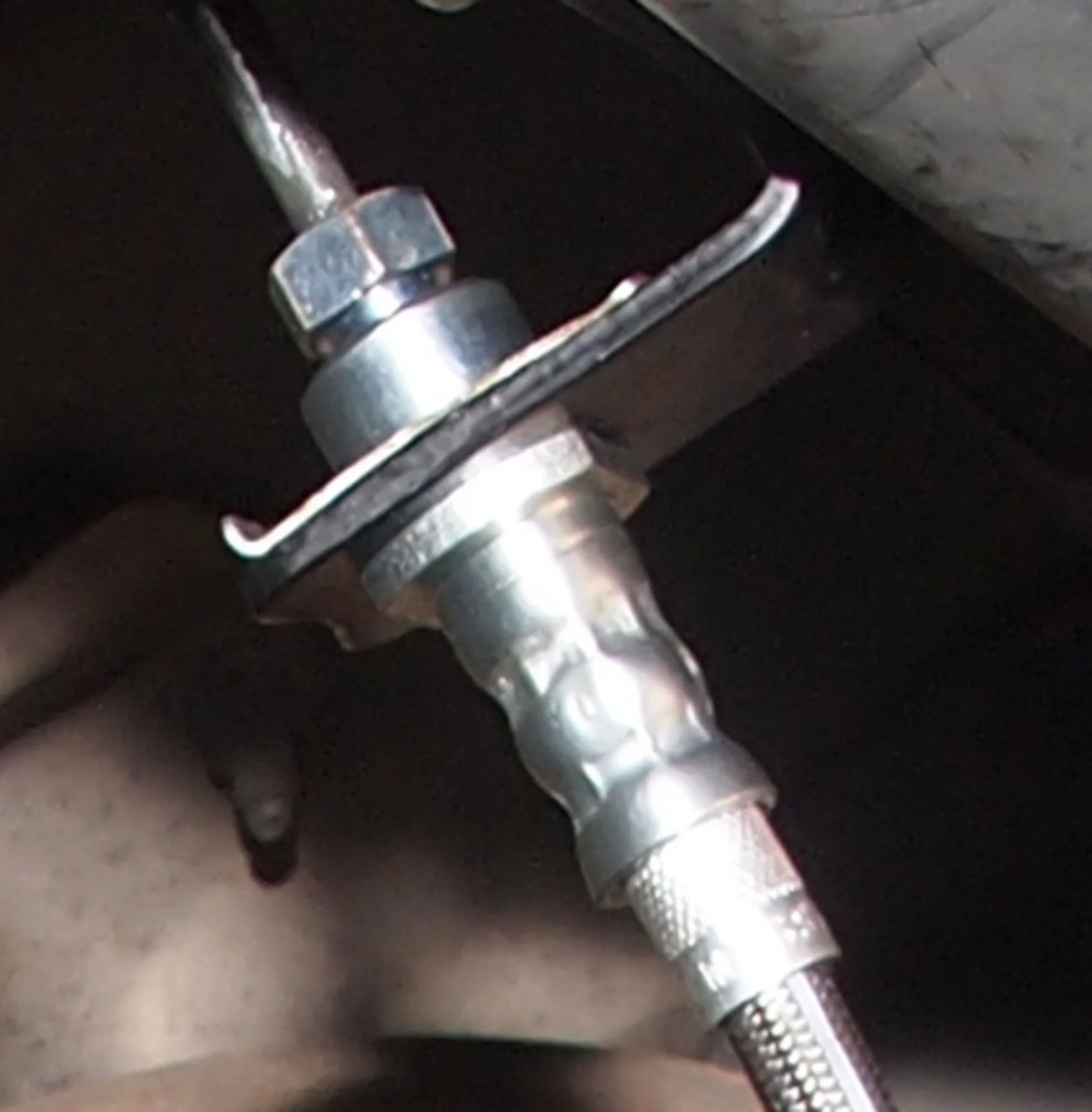

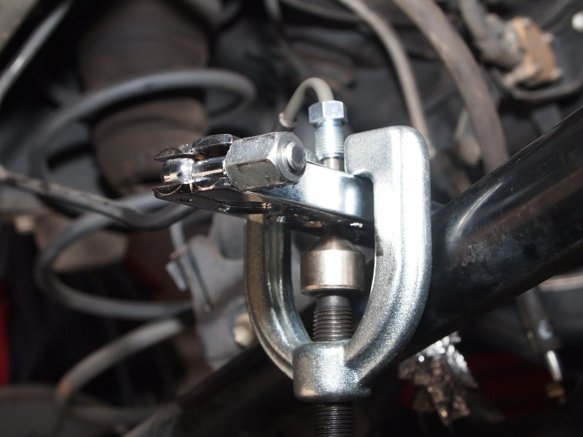

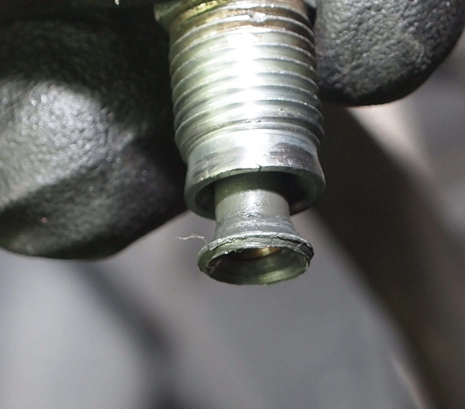

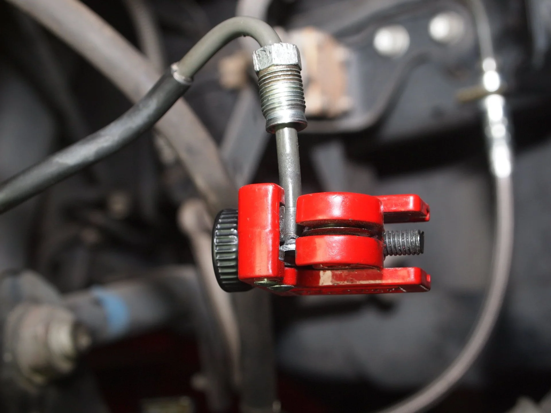

So I got under there with two vise grips, which gave me more control. By pulling very hard as I twisted I pulled it off. Like I thought, the flare nut lip had rolled. No doubt from being over torquing at the factory. Funny I can't find a torque spec, in any FSM hard cory or TIS for these brake hose to pipe flare connection. I only find pipe flare to master spec of 11ft-lbf.
Flare nut end was rolled (enlarge) and hung up in female end, it also was cracked. The male flare nut, deposited metal into threads of female end. So I cut off tip and re-flared the pipe with a new flare nut in place.
View attachment 1693458 View attachment 1693460 View attachment 1693459
I didn't like the looks of my first flare so cut off and did a second. Any more cut off and I'd not gotten flare tool on, due to bend.
New SS braided brake hose installed with aftermarket flare nut.
After I've bleed and confirmed no leaks, I'll paint pipe and grease to protect from rusting where I damage paint.

This year I added ABS pump actuation per the photo above in a few different places. After running brake fluid through the front, driver caliper bleeder until clean I then closed all bleeders and ran the pump for 6 seconds and moved to the rear wheels/lspv. I ran the abs pump for 6 seconds in between changing from one bleeder to another since I go check the flush tool pressure and keep it at 20 psi between bleeder changes anyway. A few times I also ran the ABS pump for 6 seconds while a bleeder port was open and fluid was being pushed out of the bleeder port.
I wasn't setup to observe if dirty fluid came out after the ABS pump was run and I don't know if my approach above is ideal, it's just where I've landed after doing this every few years (and multiple times after changing brake components). In the past I would activate ABS on gravel before/after brake fluid flushes so I don't think the fluid was super old though it does seem like a little air may have been knocked out of the system this last fluid flush, that previous flushes without running the ABS had not gotten. Of course, running the ABS pump may not have made a difference and/or there may have been a better way to do it. It was an easy addition to the whole process though and I don't think it hurt anything.
