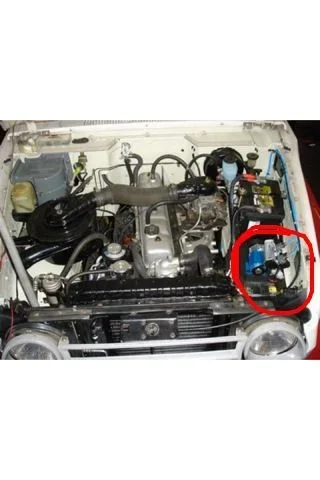

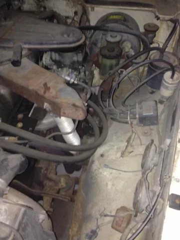

What do you think of the air cleaner assembly and orientation for mine?
Have to relocate the battery, but the DS fender well will be free of all, so that is doable.
Other thought was shortening the intake tube and mounting it on the DS fender, but unsure of the consequences.
the only thing to worry about mounting it drivers side, is heat soak- so no worries really. I don't see a problem with that air cleaner set-up on either side of the bay-I have always thought that was a better air cleaner type...
May not be enough room here....
Height wise. Think I still have an OE 80 cleaner, which should be similar in size, to play around with.
Not opposed to moving battery, but would hope it could be done with the OE tray and a little reinforcement in the inner fender that it attaches to.

You should be able to fit a can style air cleaner and battery on the pass side.
Think the the cleaner in the front corner, leaving battery location alone?
After measuring, the OE 2F cleaner that's on the Pig now will fit the 3F carb with minor modifications and cleaning up the unused ports.

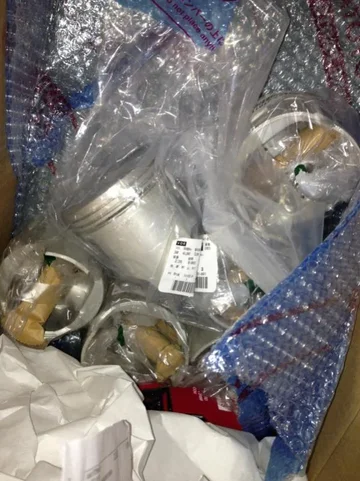

Sadly, some of the boxes have intermingled so need a full day with bins and direct line to Onur to sort out. (I hear you cussing me.)

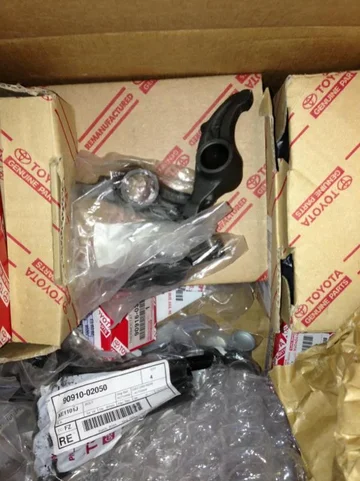

For the 2F, all but the head, H55, 60 series big cap dizzy (dented cover), 3F Aisan and the split case brake are on hand....I think...
Going to try to get inventoried and packaged in preparation for the overhaul to commence very shortly after I have title in hand....whenever that may be.
All for the 76 2F. Already have what's available for the 72....which isn't much when it comes to the engine internals. Sadly, some of the boxes have intermingled so need a full day with bins and direct line to Onur to sort out. (I hear you cussing me.) For the 2F, all but the head, H55, 60 series big cap dizzy (dented cover), 3F Aisan and the split case brake are on hand....I think... Going to try to get inventoried and packaged in preparation for the overhaul to commence very shortly after I have title in hand....whenever that may be.

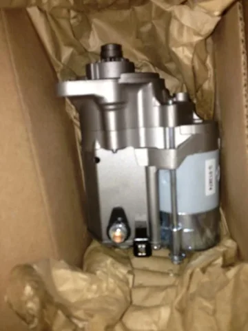

Since the '76, or the 2F will be stock, I hope that is a gear reduction starter from a 60 series?
It is.

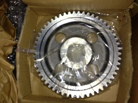

To preface, I AM nuts, period.
Saved a seized 2F from the scrapper a few months ago and wound up with this....even though I had forgotten I had. (Pretty much, found it in the bed of the Ford).

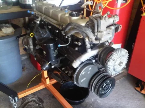

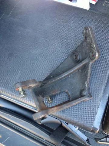

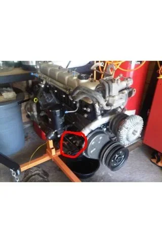

I ran the stock PS and alt configuration on my 3FE conversion, the wiring wasn't bad and you can run the power steering lines across under the radiator using stock FJ62 lines. I would think the mounting points in the head would be the issue, not that a little fabbing couldn't work around that.
Two mounting bolts in head:
Bracket mounted:
Hardlines running across;
Alt bracket:

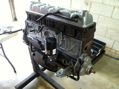

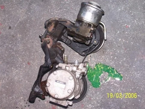

I can't find the thread now, but I was under the impression from reading that the 3FE PS and AC mounts utilized existing 2F threaded block mounts.
Can't say of that's early or later, or if I hallucinated it, BUT IF so, then I'd consider mounting both the PS and AC in that location, mounting the alternator on the DS, using either the smog pump bracket, or even an F's...
As you can see, that's simply not true for the PS. Don't remember how the A/C mounted because I removed and sold it (this was going in a 40), but it was below the PS pump. The pics are of an '89 3FE -
Tucker

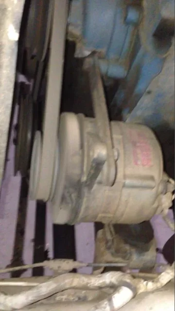

As you can see, that's simply not true for PS
That's just it, I can't see it. I have no clue how the alternator is tapped into the passenger side of 76 2F block.
Going to look for pics....
Edited: OK. You win....I think....
I can't tell in pic, but looks like my idear is flawed, as I see no provisions for the alternator bracket on the side.
Guess LambCrusher is right. I do better at picture reading.
Edited again.
That head appears to have provisions for, or am I hallucinating again?
