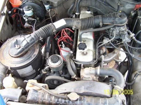

That block appears to have provisions for on the head, or am I hallucinating again?
Yep - looks like you'd be good to mount the PS pump on that head ;) IIRC the alt mounts to a bracket that bolts across the water pump. You can kind of see it in this pic:

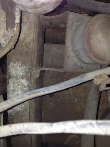

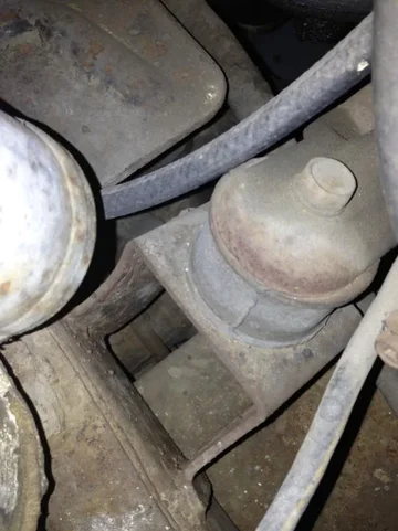

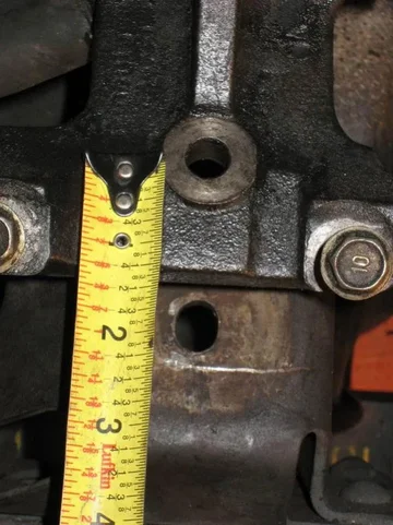

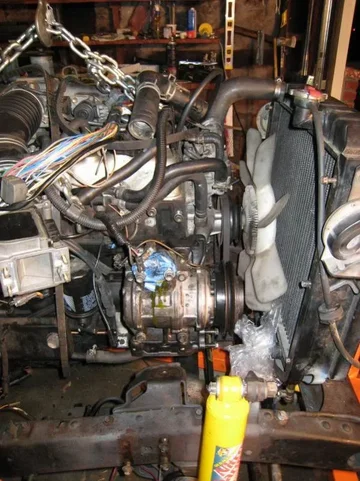

The issue you run into is the stock AC compressor mounts to the PS motor mount, which you can't use (1 3/4" short) :frown: MMW68 fabbed up a bracket to mount a york compressor up high on the PS on his which he ran with the vintage A/C unit. This is where the PS pump resides if you're using the stock setup ....

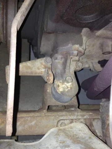

I heard something about that.. that you cant use the stock 3FE motor mounts and I ended up buying the 2F mounts.. I then realized that "my" 3FE motor mounts fit on my stock 72 FJ40 frame.
So I am running the stock 3FE motor mounts without any cutting or any mods. fits straight up. I used the puck style mounts and all I did was cut a recess in the motor mounts just to be a perfectionist and have them sit flush on top.
I can stick my stock AC back up no probs.
I don't know what to tell you man, the mounts were too short when I tried them. It wasn't by a little either ... here is what I made work:
That PS is longer than the stock 3F mount with the AC mount, the DS still had to be slotted because it was too short. Maybe he had FJ80 mounts or something, mine were out of a '89 FJ62.
Tucker

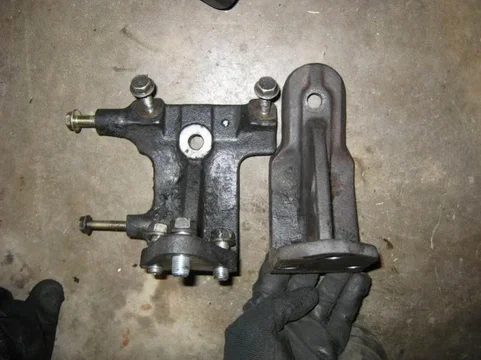

Hoping to get my hands on both the 3FE PS and compressor mounts, already have the early 2F AC motor mount, OE smog pump bracket, OE alternator arm, and a late 2F power steering pump mount.

Exactly what I saw -

Last of the puzzle pieces from Onur, except the H55.
So, am I wrong in thinking you could just make the bottom bracket, that bolts to the frame. Then use the 3f motor mounts.
I'm sure that could be done, stock is riveted but welds would work ;)
