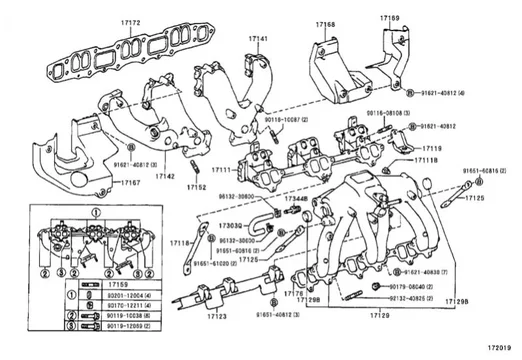

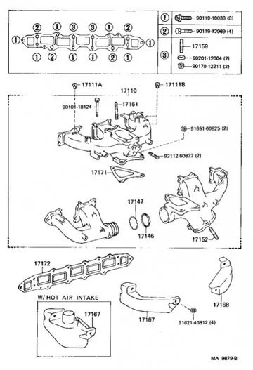

How important are the heat shields on manifolds?
They list a "hot air intake" separate and unsure how necessary.
They're not cheap and not easy to come by, but if necessary I'm on board for.
you'll prolly want to get or make a heat shield at least for the firewall end of the manny- it's real close and they do get warm from time to time. You prolly do want to use some sort of shield...prolly get away without except in the hottest summertime temps of southwest. I still need to get the front shield for mine and motivation to mount the rear shield I have:rolleyes:

Wondering how close that'll be to the booster on the firewall side...

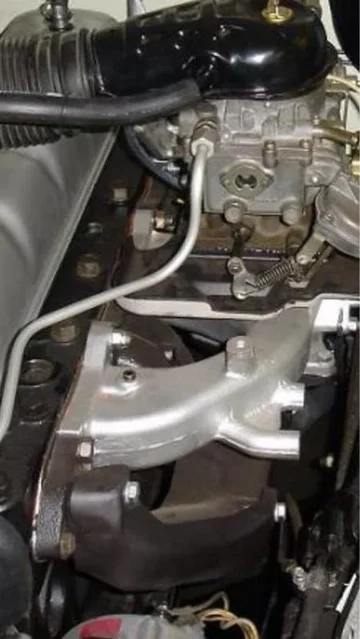

Since the pic has been enlarged....
Another observation is the two mounting points cast into the intake on the forward most DS. I've seen an EGR apparatus mounted there on some and an old school appearing F air cleaner, with a slight bend to lower it right after carb, mounted, as well.

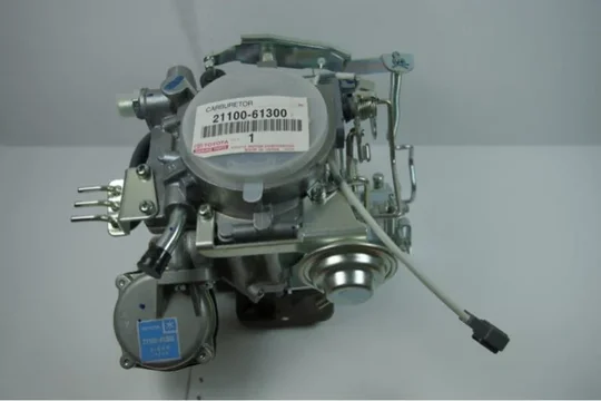

OE 3F carb is on it's way across the ocean, thanks to Yan (akella). Not sure what modifications will be required to utilize the Pig specific linkages, but surely can adapt to, or incorporate a throttle cable.

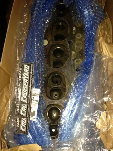

Head is on its way from Jason at Cruiseryard, as the PS welded frame mount will be in a few weeks.

I know some of y'all are capable of looking at a taillight and can determine dizzy issues, so here goes...
What can anyone tell about the linkage or caving issues by looking at this carb?
I have to send a dizzy to Jim C, and wondering if this should go, too. He can't run it, but betting he's set up enough that a test run is unnecessary anyway.
