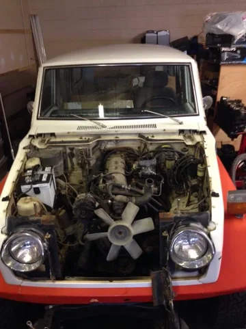

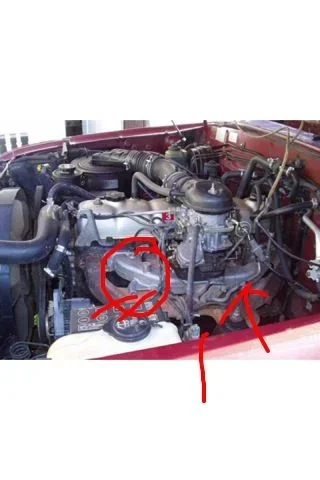

So, I'm a little lost in many aspects, but have been thinking about the manifolds, mostly a permanent, unnoticeable fix the the EGR port and the unused mounts (can't find anything that mounted here, except possibly EGR valves on RHD 70s...)
In question...
Hunting further explanation to Jim's comments and how it may relate to these manifolds and/or valve cover.

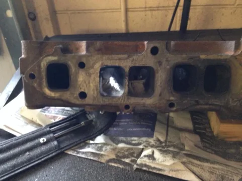

what are you plugging the hole in the manifold where the EGR connected? I assume it would be good to get a gasket and have a mchine shop fab up a couple of "blanks" in the same dimisions as the gasket and use this as block-of-plate?
I prefer to put a coin of 1" bar stock in the hole and MIG around it. but that requires removal of the manifolds.
Yes, you can have a block off plate made. but note how the pipe pilots up into the manifold. The pilot helps align the gasket and protects the gasket from direct exposure to exhaust heat and pulsation. A flat block off plate doesn't work so well at holding the gasket in place. If possible, machine the plug to have a raised pilot in the center, like the original pipe.
I just cut the end off the pipe, flatten, weld shut. Then bolt it back on w/a new gasket. Not pretty, but due to the location it's invisible.
The PCV hose connects to the intake manifold, as does the EGR. Cut the EGR tube off, weld shut, grind smooth, paint grey. It's now invisible.
Does this seem viable? There's not any block off plate in can find and don't really want to use, anyway, but I sure as heck don't feel comfortable welding the intake manifold.
Similar deal....
Can't see any reason to maintain the mounts cast into the intake manifold, and haven't found many instances where Toyota did, either.
The rear most appears to be a mount for the EGR pipe, so it should be unnecessary, too.
Cut off to remove?
Look worse doing that, since the casting surfaces won't be present after ground down?
EGR inlet is ALSO PCV supply vacuum port. A plate can be made to mount a pipe for PCV hose and simultaniously block off EGR inlet. ALA 2F desmog threads in 60 section...
Leave that poor thing BE! it is just FINE HOW IT IS!!!
just tell people thats where the supercharger bolts up- but that you didn't WANT IT;)
you'll have to do the PCV inlet/EGR block off plate...just have it milled for perfection...
they're gunna use your blood for the vaccine- the flu is strongest in you:lol:
before you go cutting mounts off of that manifold, you might just have one made to your liking, and leave the rare parts for PURISTS:flipoff2:
fine. cut down front mounting where the EGR valve would have secured but one of the holes below the carb is for PCV, which you will need to keep. in fact, the pipe leaving that port going towards the firewall being supported by the rear mount you are asking about is the PCV line, whose support you will want to keep, in order to keep the PCV pipe...When you look in FJ60 desmog threads, you find the JimC EGR delete...this is in effect what you will want to do; execution may be differed, but principal will remain. As factory, there would have been a cast base plate with a preformed tube leaving aft going to rubber hose connecting said tube to PCV in side cover, and a compression fitting going fore toward the EGR valve/tube mounted in front of carb/egr/pcv inlets on intake manifold. Welding holes shut on the manifolds would scare me- warpage or craking, and anyhow, you need one of thse holes for sure, so then you'd need a custom plate and pcv tube so on and so forth...only trying to help
only trying to help

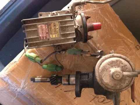

Cleaned up a dizzy and igniter from 3puppies last week, sent to Jim C. for him to do "unspeakable things" to.
