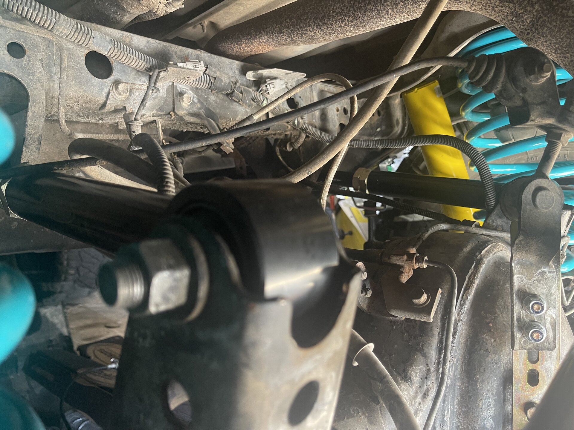

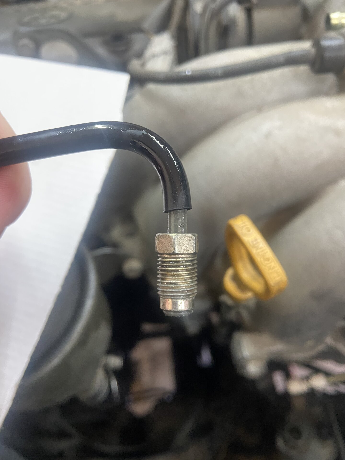

I learned that the “long” style OEM fitting will not work with the adapters (not enough thread engagement), so you have to use the “short” side. This caused me a headache as I had to rebend one of the lines, and it looks like crap.
View attachment 3257899View attachment 3257900

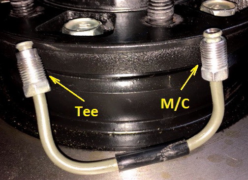

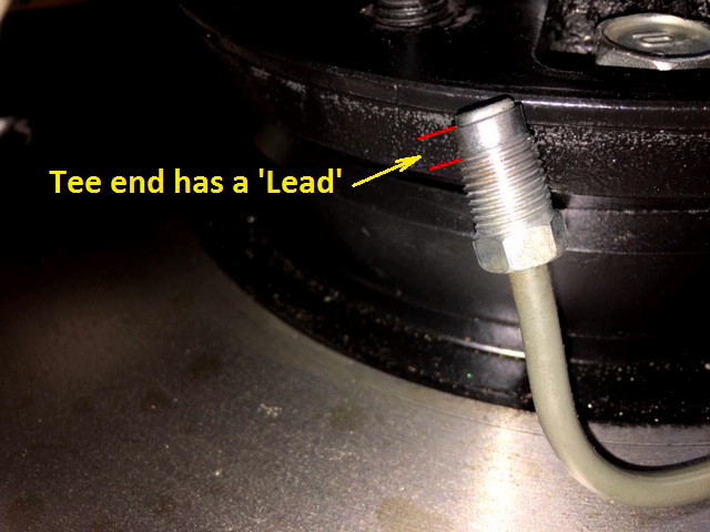

IF/when reusing the OEM lines, the ends that went into the 'Tee' below the Master Cylinder all have a slight 'lead' built into them. So if you place that end into a shallow fitting....there won't be much thread engagement and a leak might occur.
It's an easy thing to overlook.

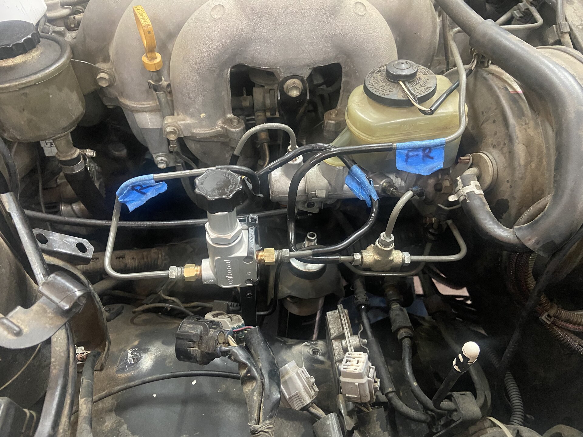

Going to install the Wilwood valve (1/8 npt threaded - ordered M10 x 1.0 female to 1/8-27 male adapters) in the stock location because of this:
I was going to use the L from the driver’s wheel well in place of the T under the MC but it seems much easier to just plug the “sense” line off the factory T with the above bolt.
Speaking of the “sense” line - are there any detrimental effects of pulling it if I’m keeping ABS?
I think technically the proportioning valve will do the same job as what the sense line was meant. But I think it would be better to disconnected it, as I imagine bleeding it would be very hard lol.

I removed it - here’s what I came up with:
