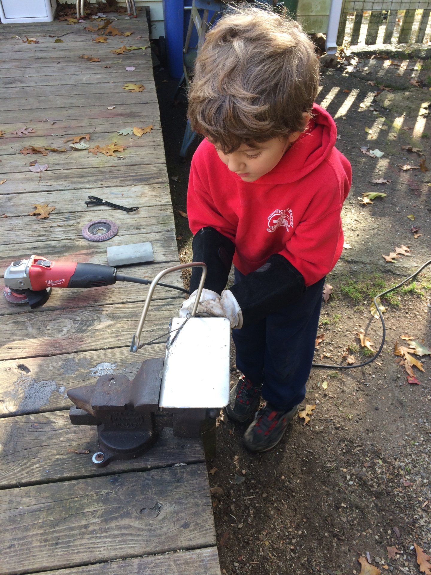

So it’s beautiful out... I’m attempting to get this patch fit for my frame. Had to cut it cuz I just couldn’t get any bends w/ it attached. So far I’m at this point and doing what I can to make the middle section fit.
Kiddo helped.
I could do this all day.
And this is all w/ a vice and hand tools. Imagine what I could do w/ the right tools!
Kid is sleeping so no noisy tasks till he’s awake, bedroom is right next to the driveway and only a number of yards from where I was using the angle grinder. I can’t risk waking him, he barely ate anything other than candy since last night and this AM. Just eat it and make it go away!

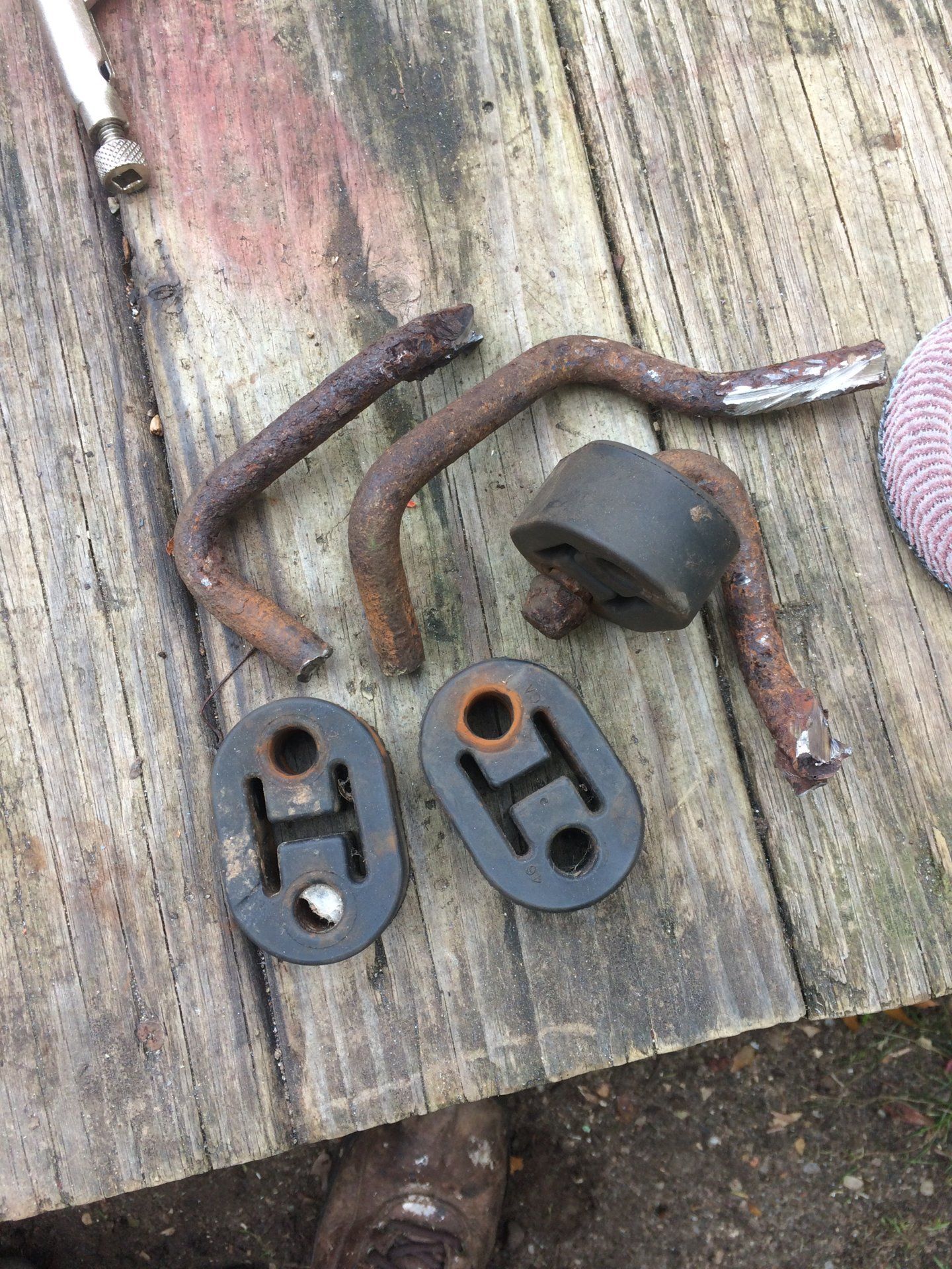

Greased and wire brushed the shackle pins. Spun the muffler around so the outlet is on the driver side to see about sending the tailpipe out the frame side of the shock. I’ve got the leftover thick rubber muffler hangers from my Nissans old exhaust system so I’m gonna see about fabbing up a couple brackets and hangers w/ them for the truck.
Now if this beautiful 70 degree weather would just stick around!

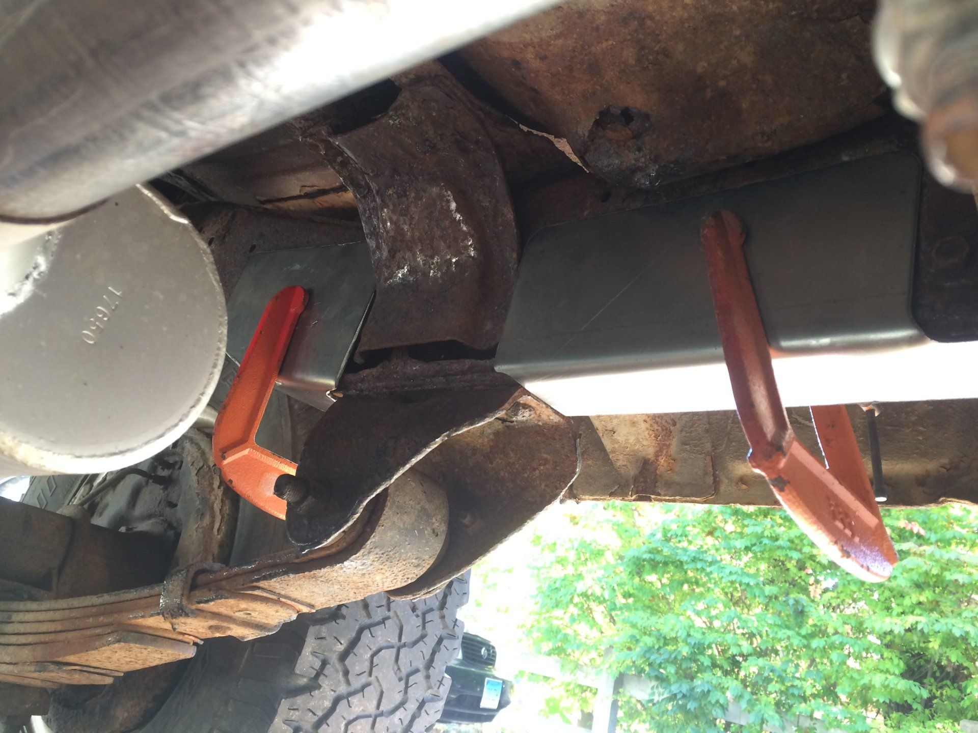

Well I’d love to make these work... save a few dimes and recycle something that’ll only go in the garbage. Got the middle section of patch bent up and smoothed out. Is it overkill?
Those arent stock exhaust hangers. Something that I have been looking at though for my front mount.
Yeah no, as I’d written above they’re left over from my Nissan.
