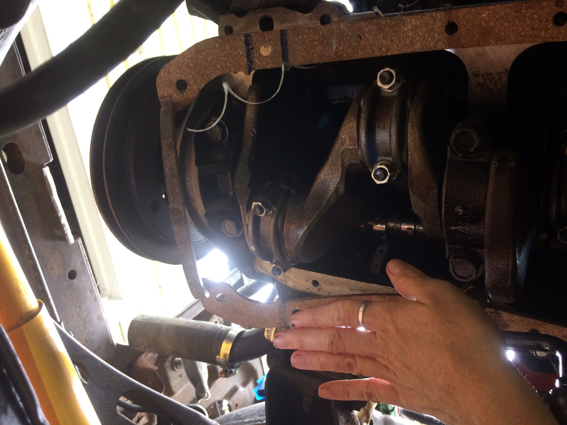

I think there wasn’t much to read after the first page Re: oil pan gasket, unless you do the rear main, I personally tried to unfocus my perception from it - while reading those posts ha ha - I really think you can do it your way and want to see you succeed doing it any way you want. When I did mine, I had this undercurrent of fear that it would leak and I’d have to go through all the pain of pulling it off again. In hindsight, pulling it off again might not be that bad IF it leaked. :crybaby:
Ok so my plan is to keep the gasket tied by floss to the block. I can bend the arches down to add sealer, let it set up slightly tacky then push up, add two screws to hold the corners enough so it won’t pull away. Then I’ll add sealer on the outer arches, let that set up tacky then pull the corner screws, press up pan and add a few screws finger tight for say 30ish minutes then tighten further.
My reason for going this way and not gasket to pan then to block is that the maincaps have a C shaped inverted lip for the gasket to seat up into. IF I go the lesser route, gasket to pan then when pushing them together and up I will NOT be able to be 100% I’ve got the arch in the inverted C of the caps. Yes the cork is stiff enough that they’d tip and I’d know I wasn’t flush but once the pan is up I can’t get my hand inside to shift the gasket into the channel.
There you have it. Here’s a few photos while I get up the courage to add sealer. And since I DO have a brand new tube of FIPG, I’ll use it instead of the ultra black tube which is only 1/3 full.
We just did the same on mine. Used an oem gasket, ran FIPG around the bolt holes on the oil pan, stuck the gasket and let it sit for a while.
Raised the pan to the block, started the bolts and cinched it up. It didn't leak until the morning after. I let it drip for a few days, cinched it up again.
After two days and two more tightenings... I had no more leaks.

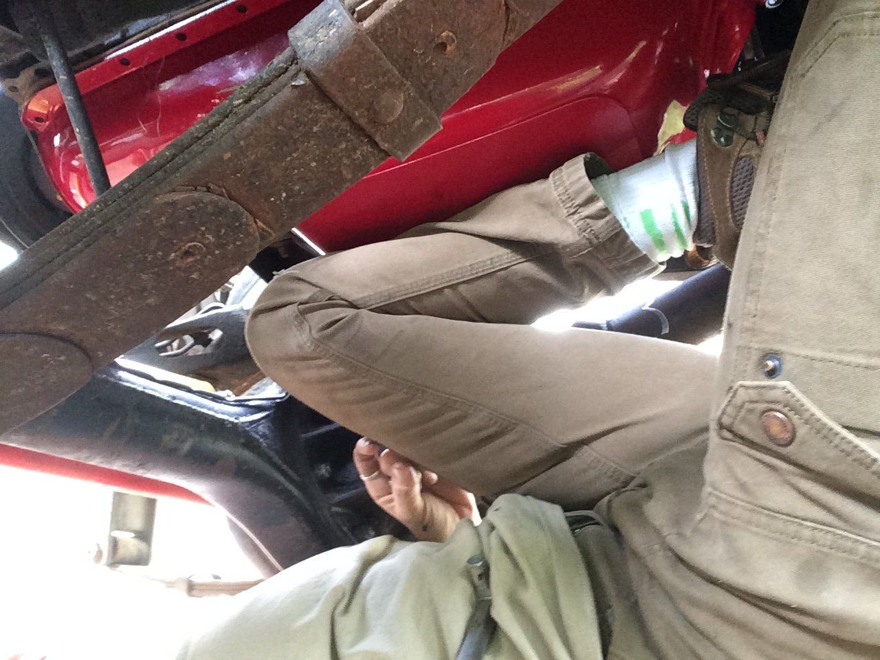

Yeah I did essentially what I said. Thankfully I’m thin and flexible. Used my knee/shin to hold it up while I fed in a few screws. Did the corners and screwed it up lightly till I saw the bead of sealer slightly squish out.
Adding screws starting in middle of the sides and worked my way alternating around the four quads basically.
New bolts from an Ace w/ new lock washer since my old ones are all worn out and threads were totally round. It’s going up tight. Periodically trying to push a piece of thin cardboard from the washer box in and it won’t go at all.
I’m feeling good about this.
Nice work! Is the cardboard just to make sure it’s tight enough? Sweet color, can you see it when standing outside the truck? Or in the car next to you!
That’s some Gumby move to hold up the pan and get the shot LOL

So I have not had to put a oil pan on a 2F before, on a Ford and Chevy, yes, 2F no.
On those if reusing the pan, old school is to make sure the bolt holes are flat as there were when new (the bolts sometimes when tightening would crown the holes slightly causing the pan not to be flat on the seal) . I am wondering with people having issues with leaking pan, is this a problem on these?
It’s recommended to lay it on a flat surface and get down low and see how flush the rim is to the table etc. I clamped mine on one end w/ C clamps and used a mallet against a block of wood to tap it more true again.
