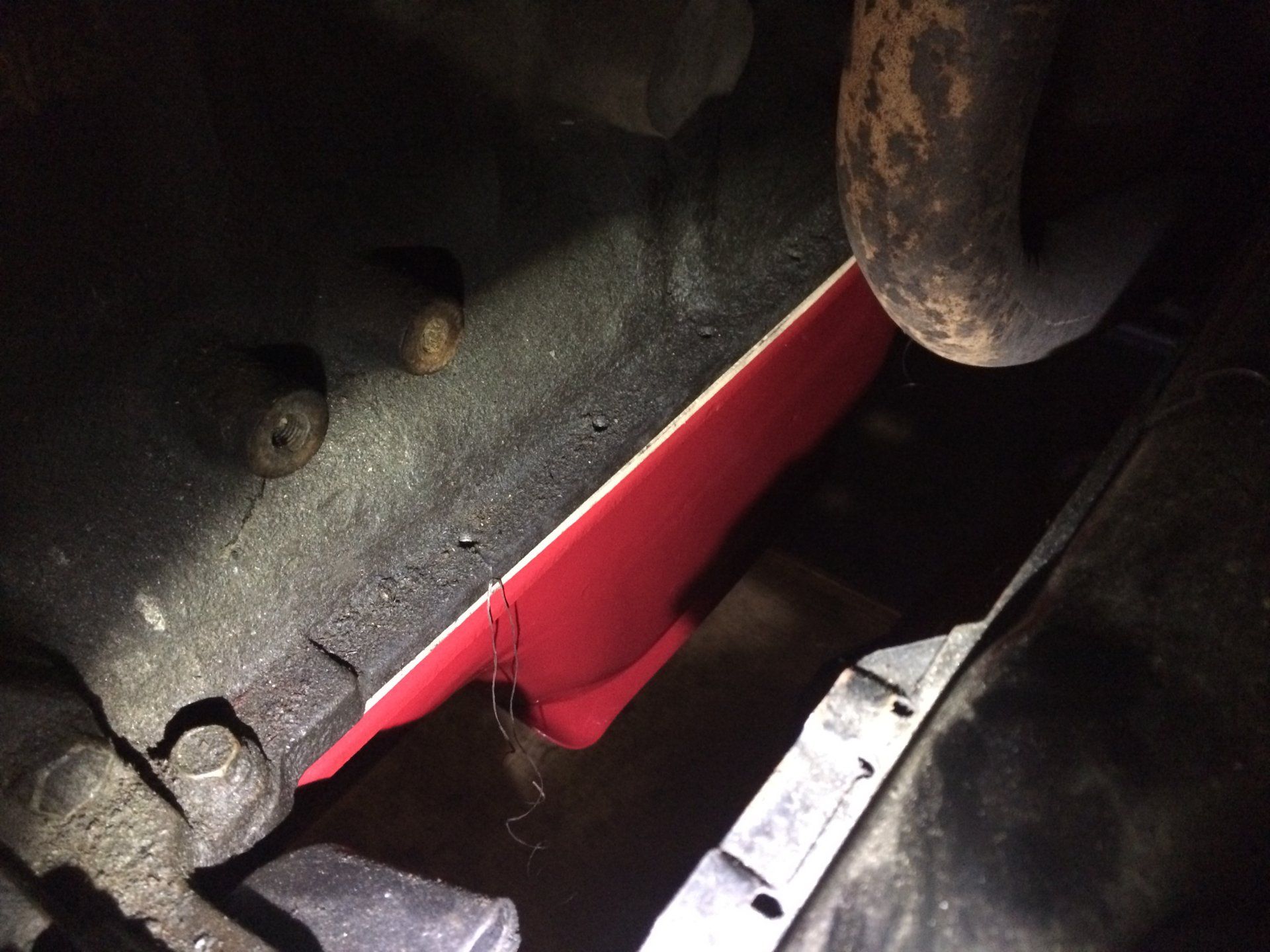

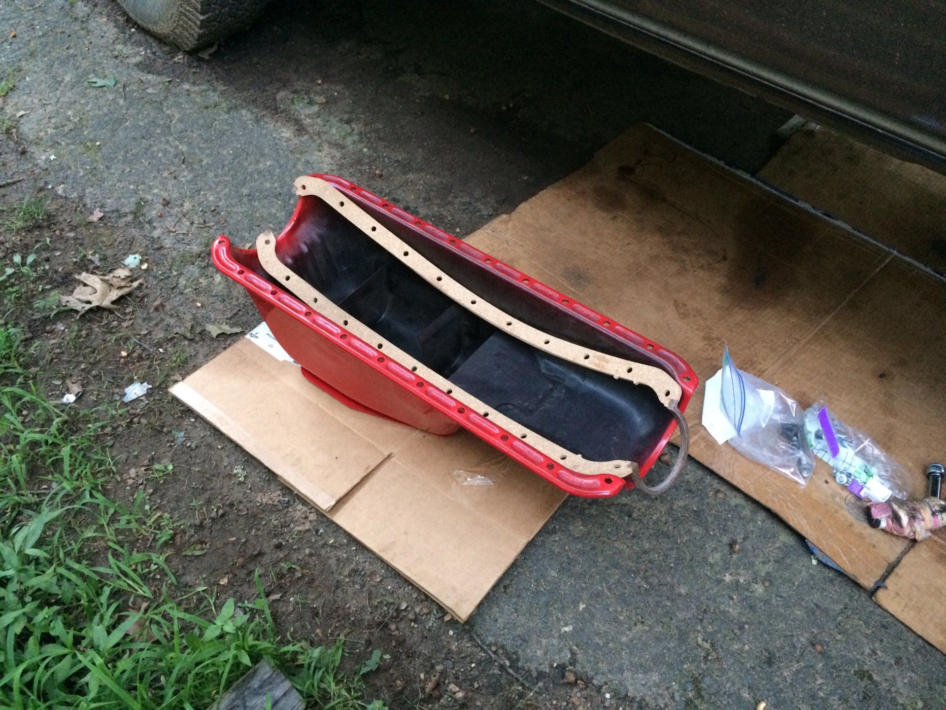

Fuel pump installed. Rod ends dipped in oil and zinc then installed. Held up oil pan gaskets (I have two) to see if one or the other was better. Both Toyota but one has red marking on it and one blue and the nubs along the sides are either inward or outward. Chose the inward one. Seemed to line up better. Tied up gasket in 4 places w/ dental floss leaving enough gap to turn down the arch ends to apply sealer tmrw. Pushed oil pan up in place just temporarily and MAN does it look nice!

@John McVicker and Felicity, is it obvious which direction it goes? Such as a front and back? I can’t remember. I really like how John did his.
I haven’t sealed mine. Just attached w/ a few threads of floss and added pan w/ 4 screws to see how it will look.

There does seem to be a fan side vs flywheel. Pretty sure it aligns specifically w/ the arches and screw holes.
I did mine similar to John, but his technique is better. Let it dry overnight and nothing will move on you or get pinched when you’re putting it up the next day. I kinda remember the corners not wanting to align or mate nicely to the pan - so the clamps help seat them correctly.
@evilorgoodtwin, as far as orientation of the oil pan gasket, if you are using a one piece OEM gasket there is a correct direction to put it on. Just do the testing with a dry gasket and make certain all the bolt holes line up perfectly perfect so to speak.
My suggestion is to go to the FAQ Section of the fj40 section and look up @Poser 's thread on oil pan gasket install. As far as I'm concerned he's 'The Man' with a lot of great tips... No BS just tips that work.
