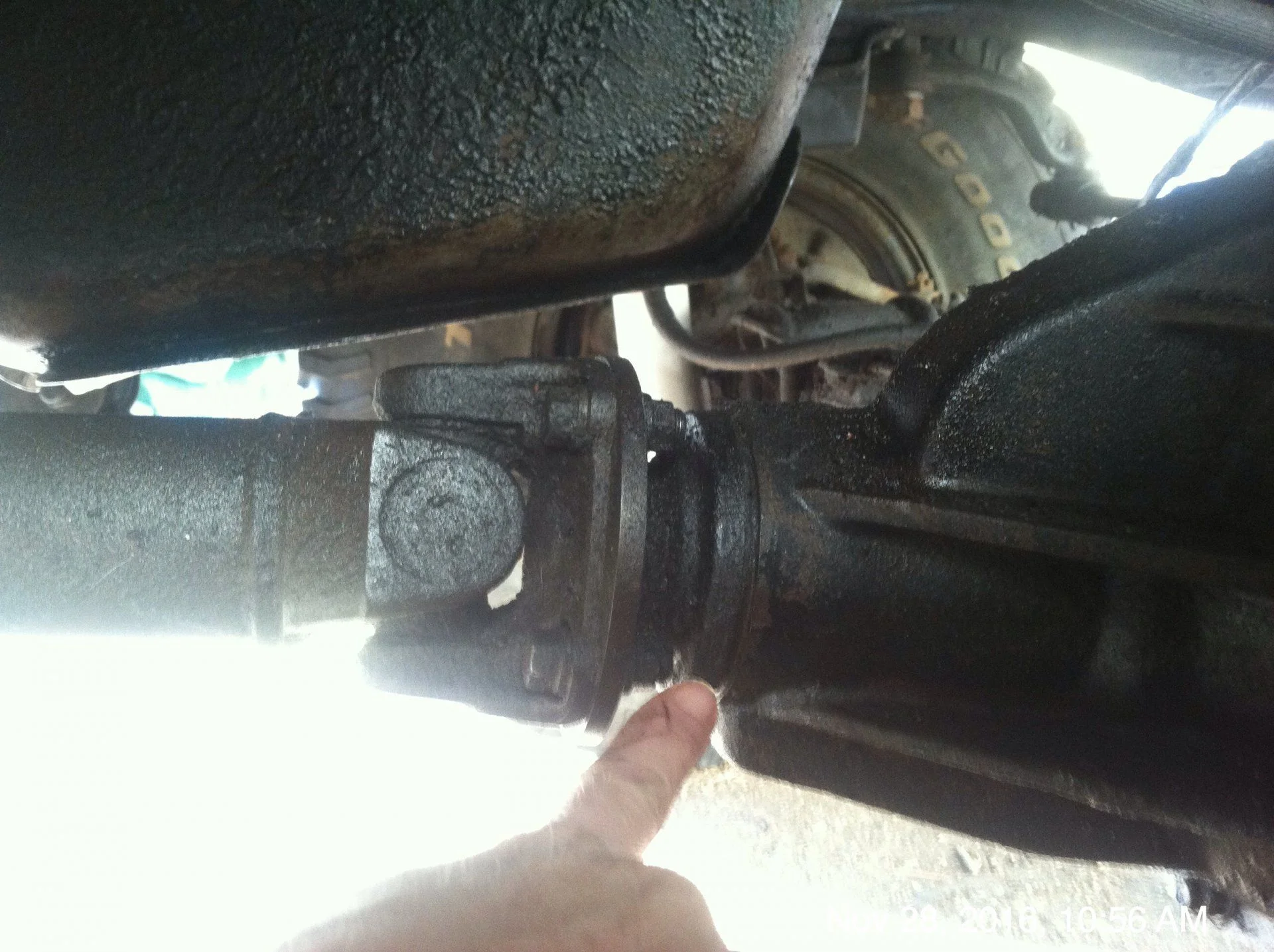

3) I also am fairly sure my front output seal is leaking and does not even have a tight fit to the flange (literally just noticed its not even flush all the way around, especially from looking down from above).

The gap on the pinion flange is just a shield. The real seal is protected by it. No need to worry about it.
