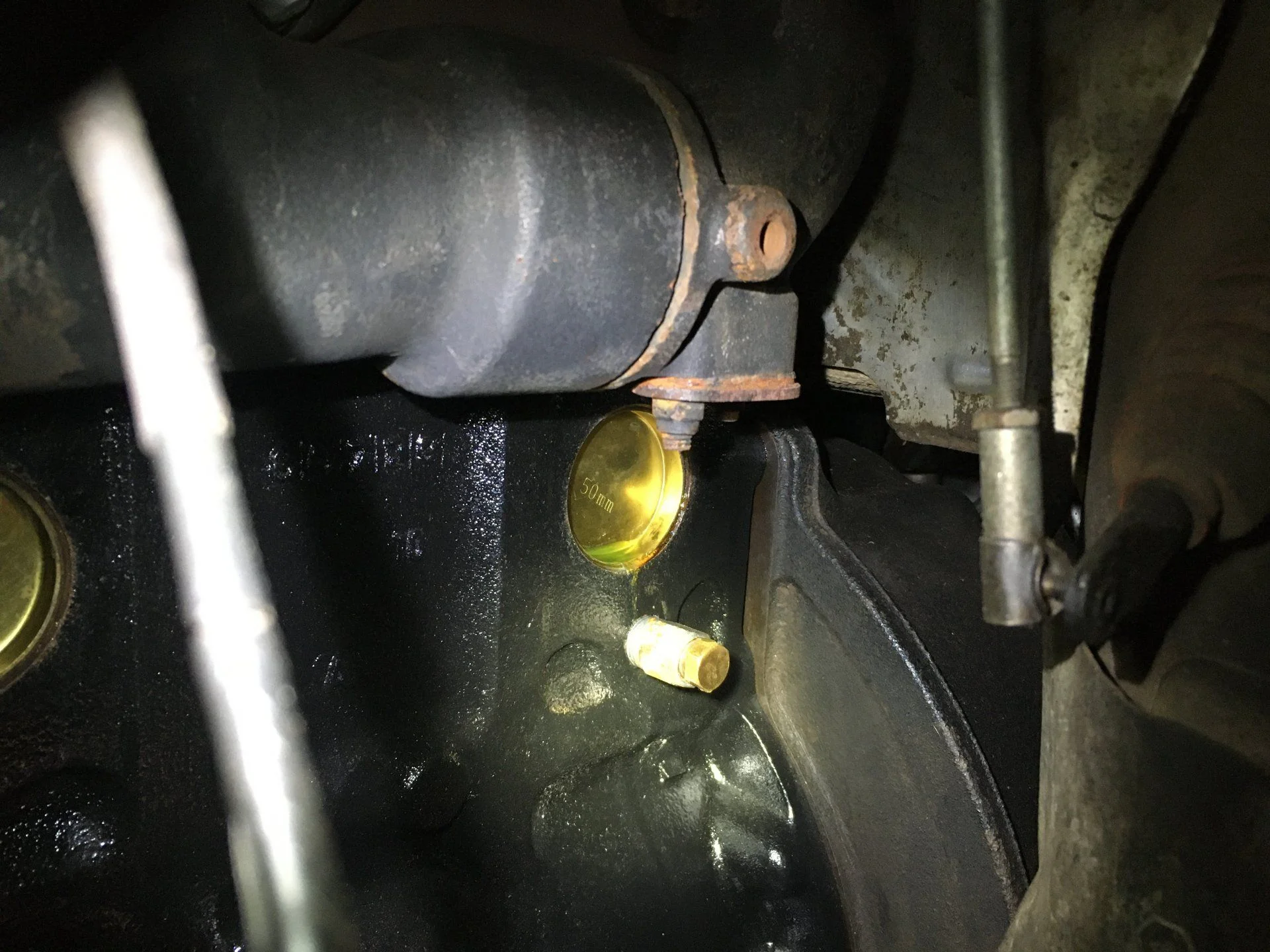

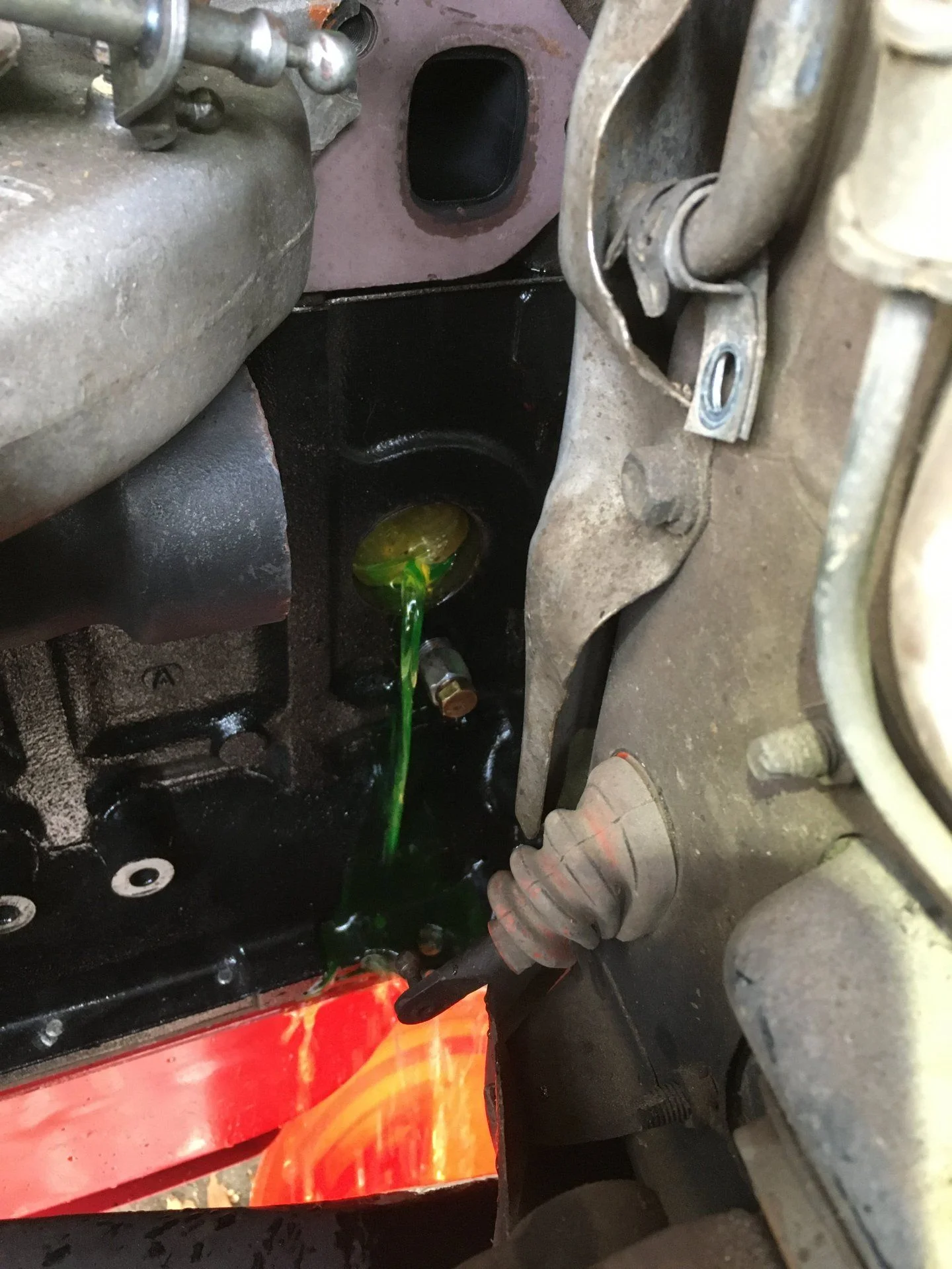

The plug is definitely leaking. Not as much while trick is running, more once shut down which makes sense. I’m still just thinking a lot. This is a photo of the plug before I started the engine earlier.

Freeze plug def needs to get changed out. Steady drip drip, 1/2c in about 30 mins.

Had come across this new thread on weird freeze plug failure in the HAMB site which I love.

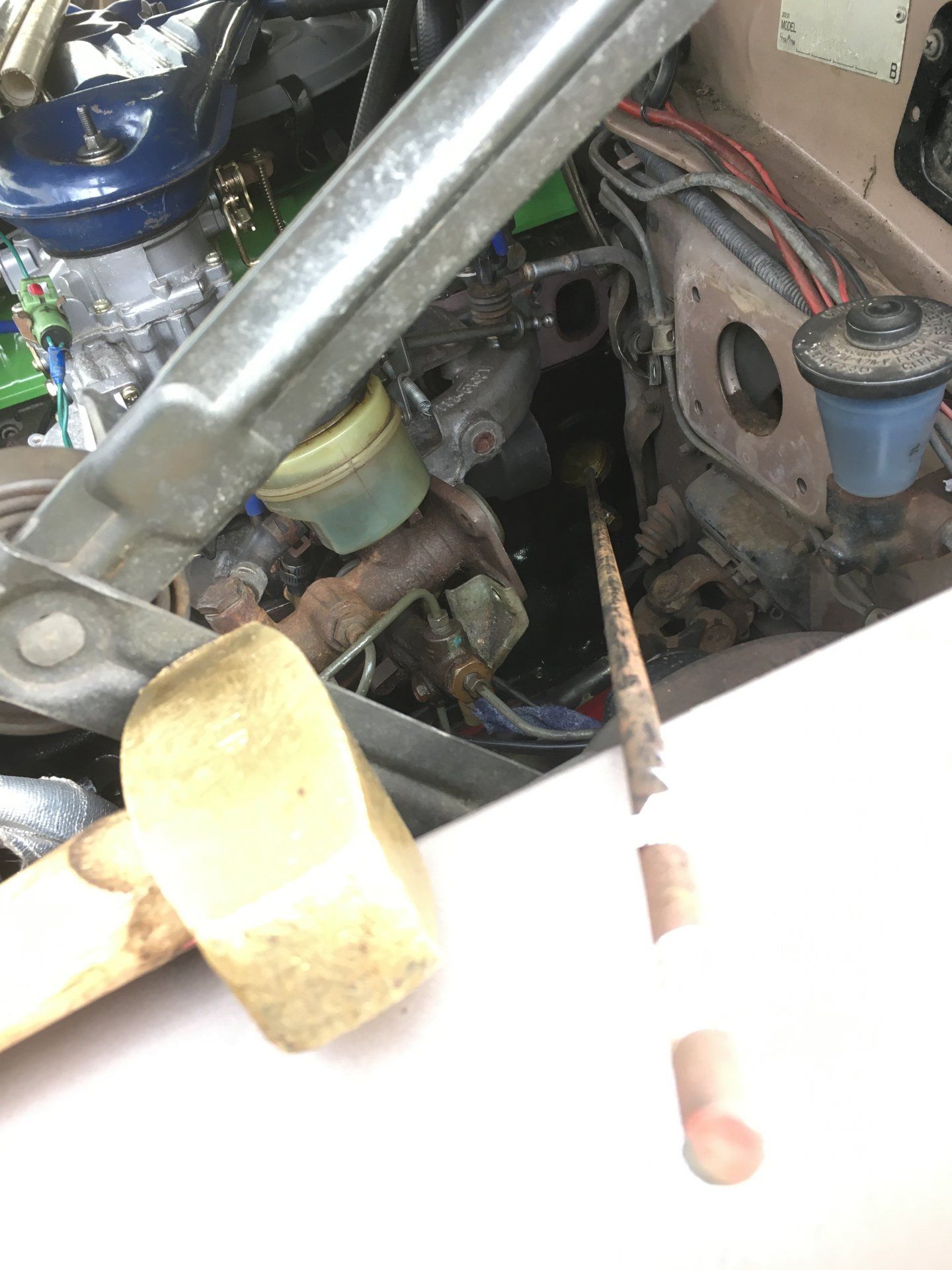

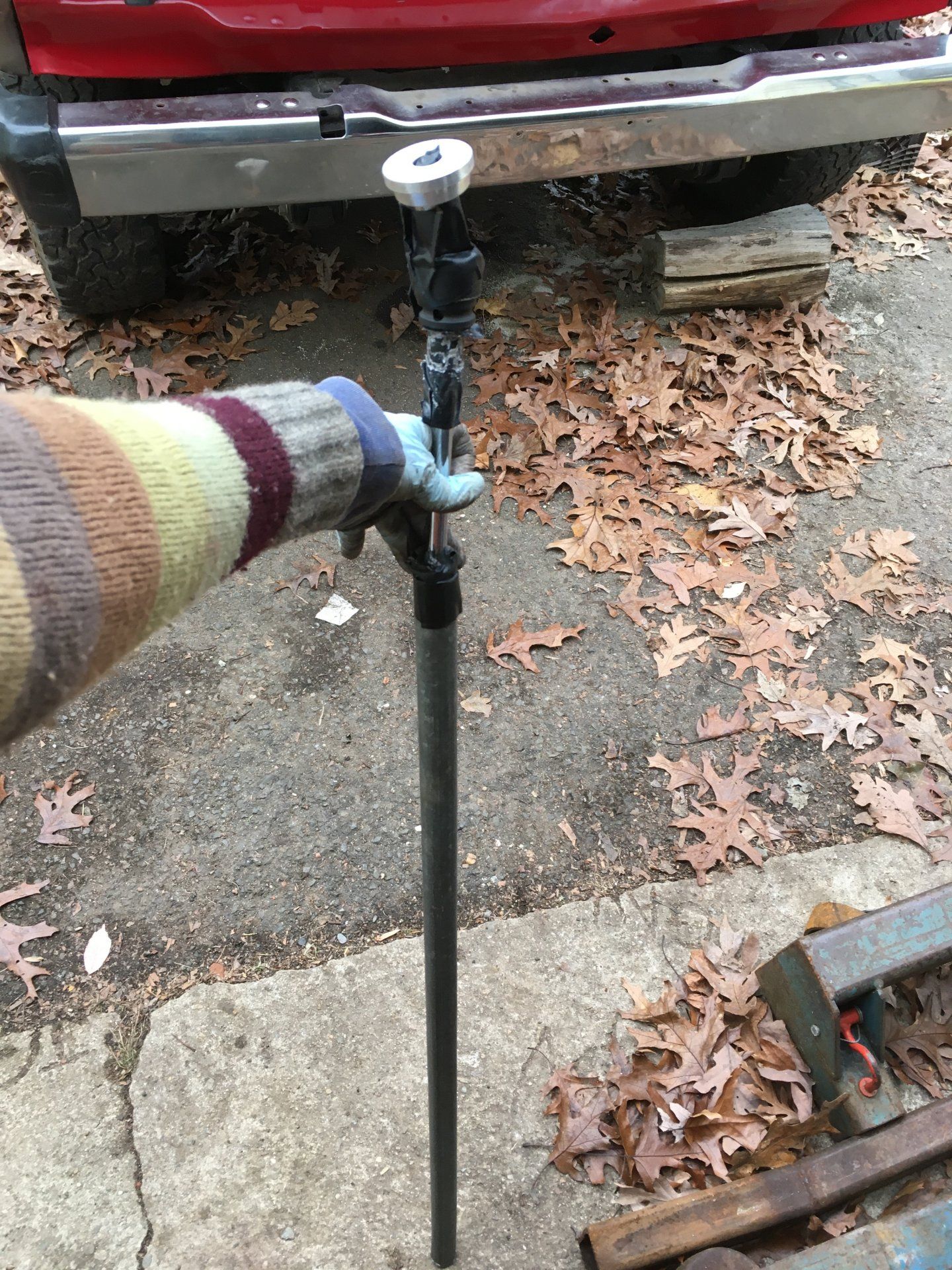

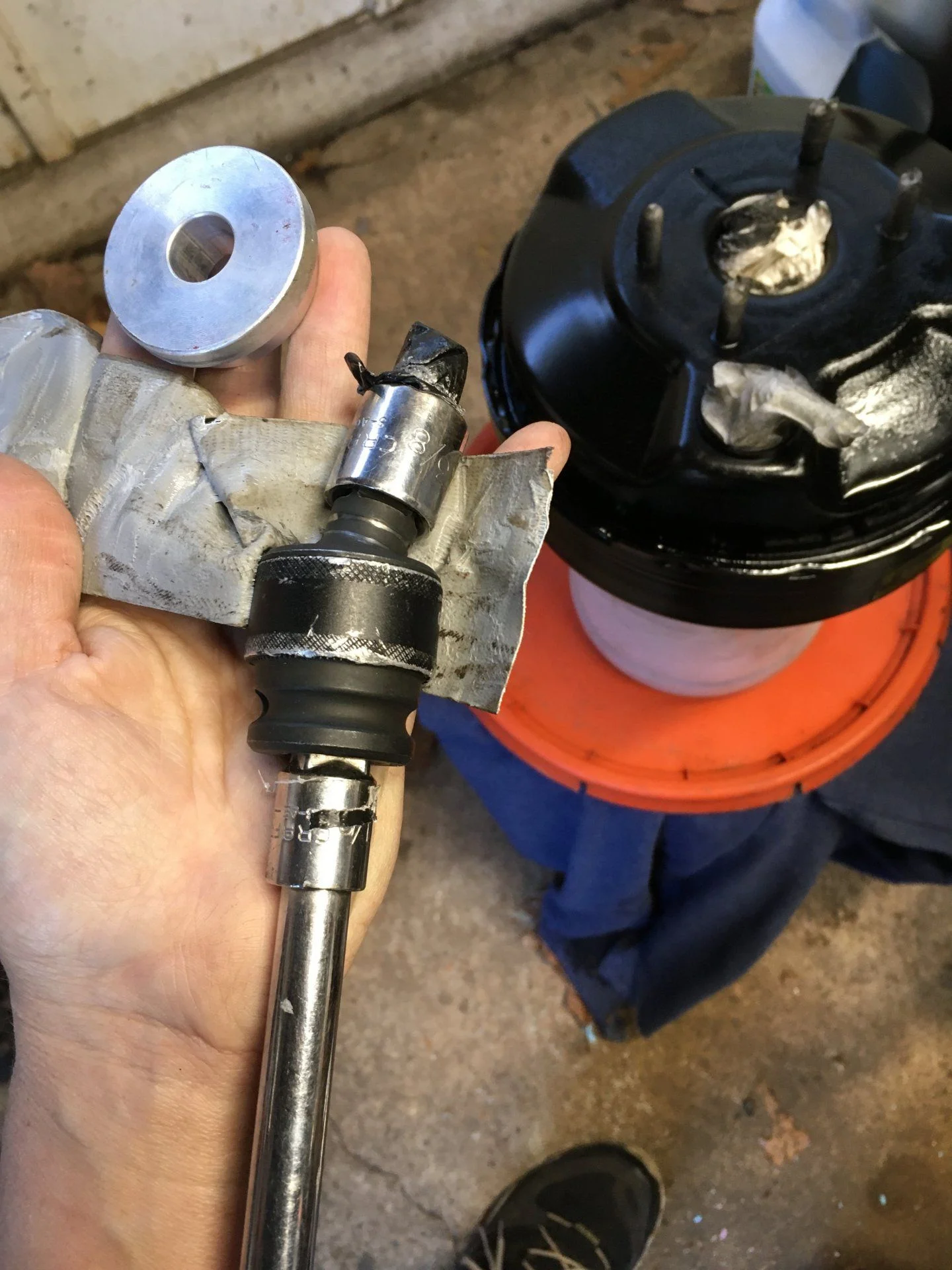

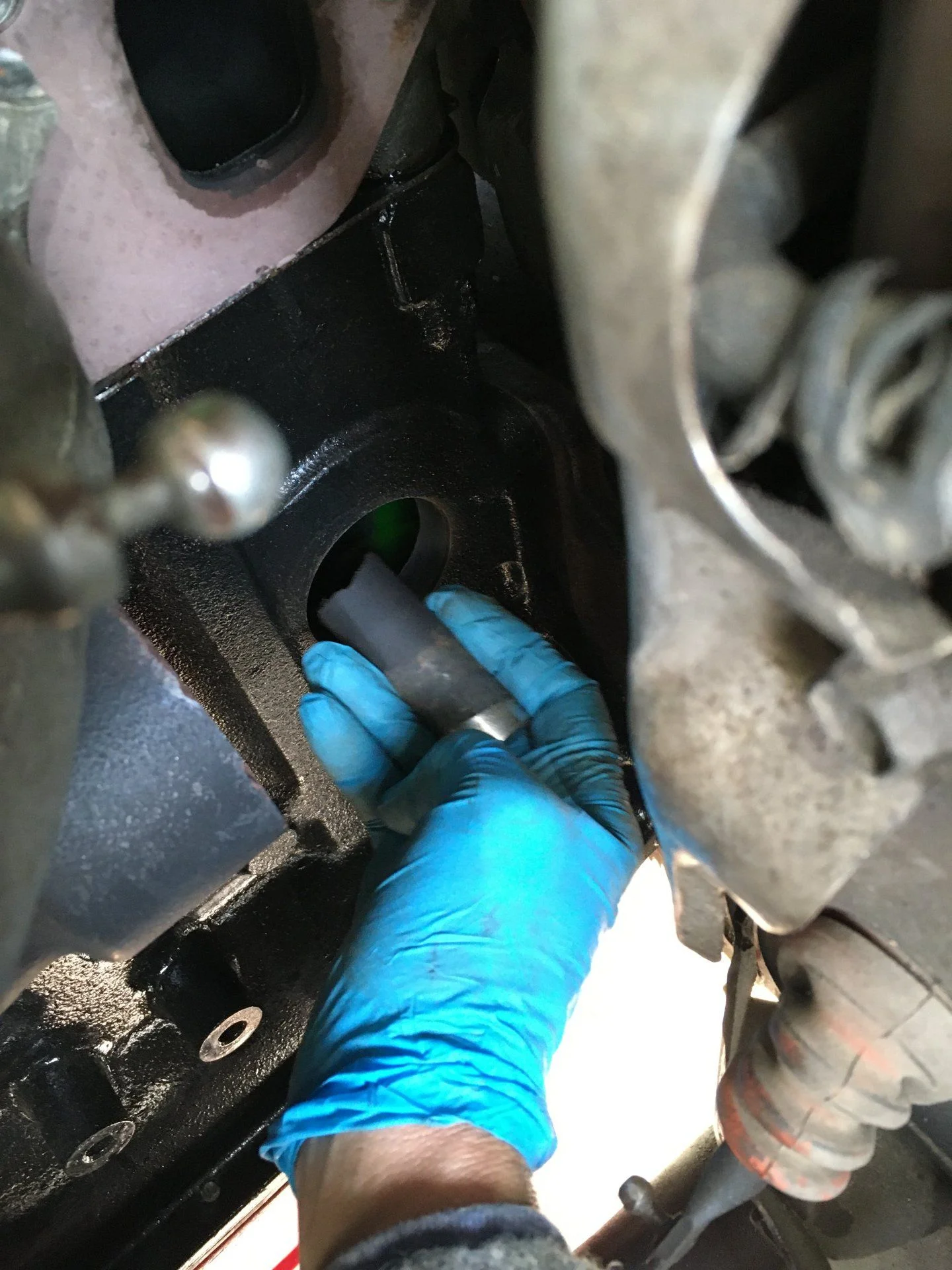

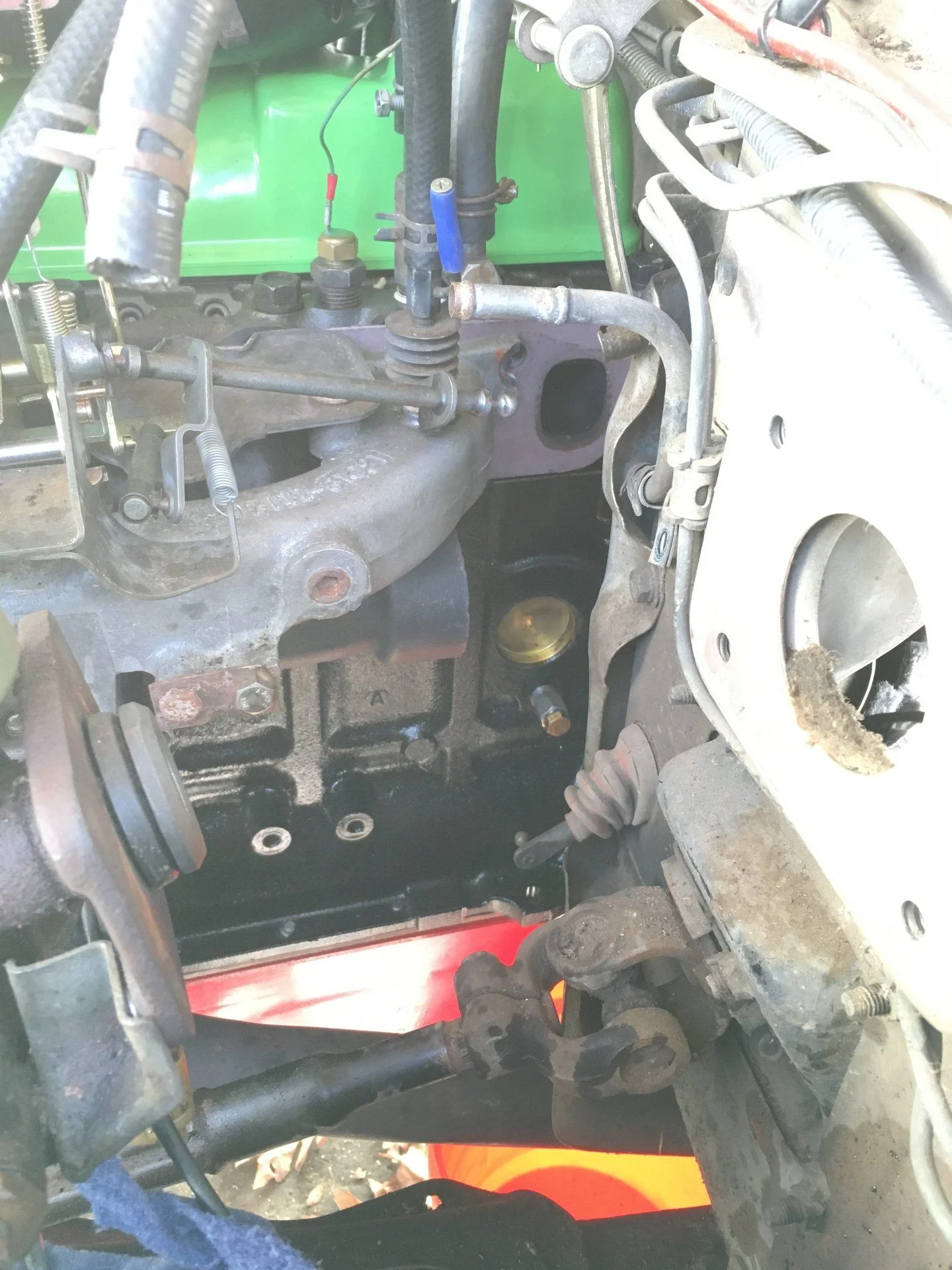

It’s in. I’m not going to discuss it further. It was a fowking BEAST to do. 600 grit sand paper to the ID. Worked on it until 2pm. Flew out the door at 2:25 w/ not 100% clean nails for work. At least I have to wear gloves for all patient care so no one except my coworkers will see.

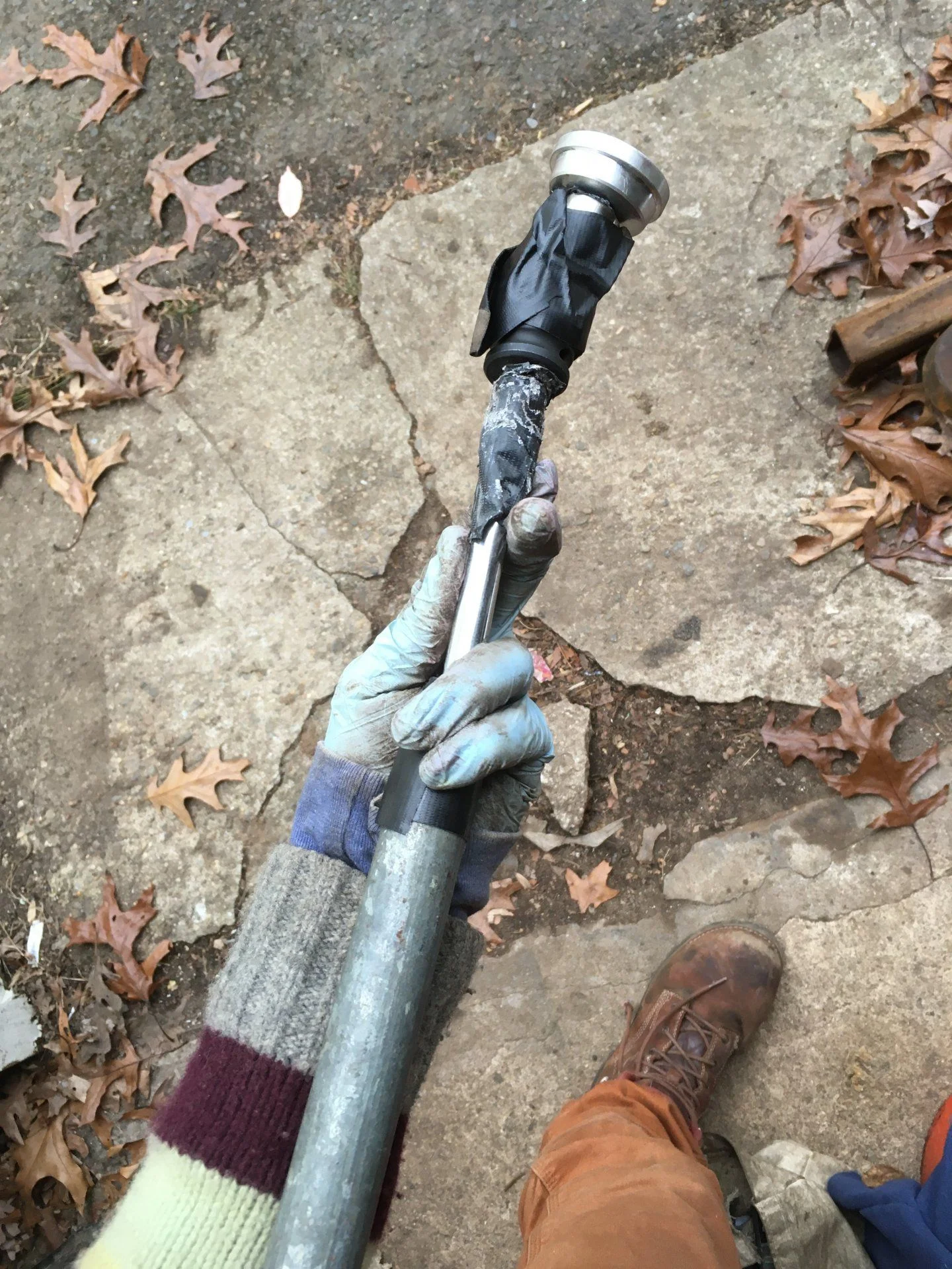

Those were my friends plus a 2lb mallet.
That's one helluva contraption! Look at you, taking care of it like a boss. Re-working things sucks but at times it has to be done. Nice going.
Just so it makes more sense... tape was to keep the wobble adapter from wobbling too much. Pipe slide over extensions was to make the act of hammering more effective from at fender height.
Just came across this tool designed for installing freeze plugs in situ. Basically the same thing I made. ABN Diesel Freeze Plug Remover 10pk Frost Plug Installation Tools Installer | eBay
In background, I cleaned up booster and gave it a spray or three of black paint.

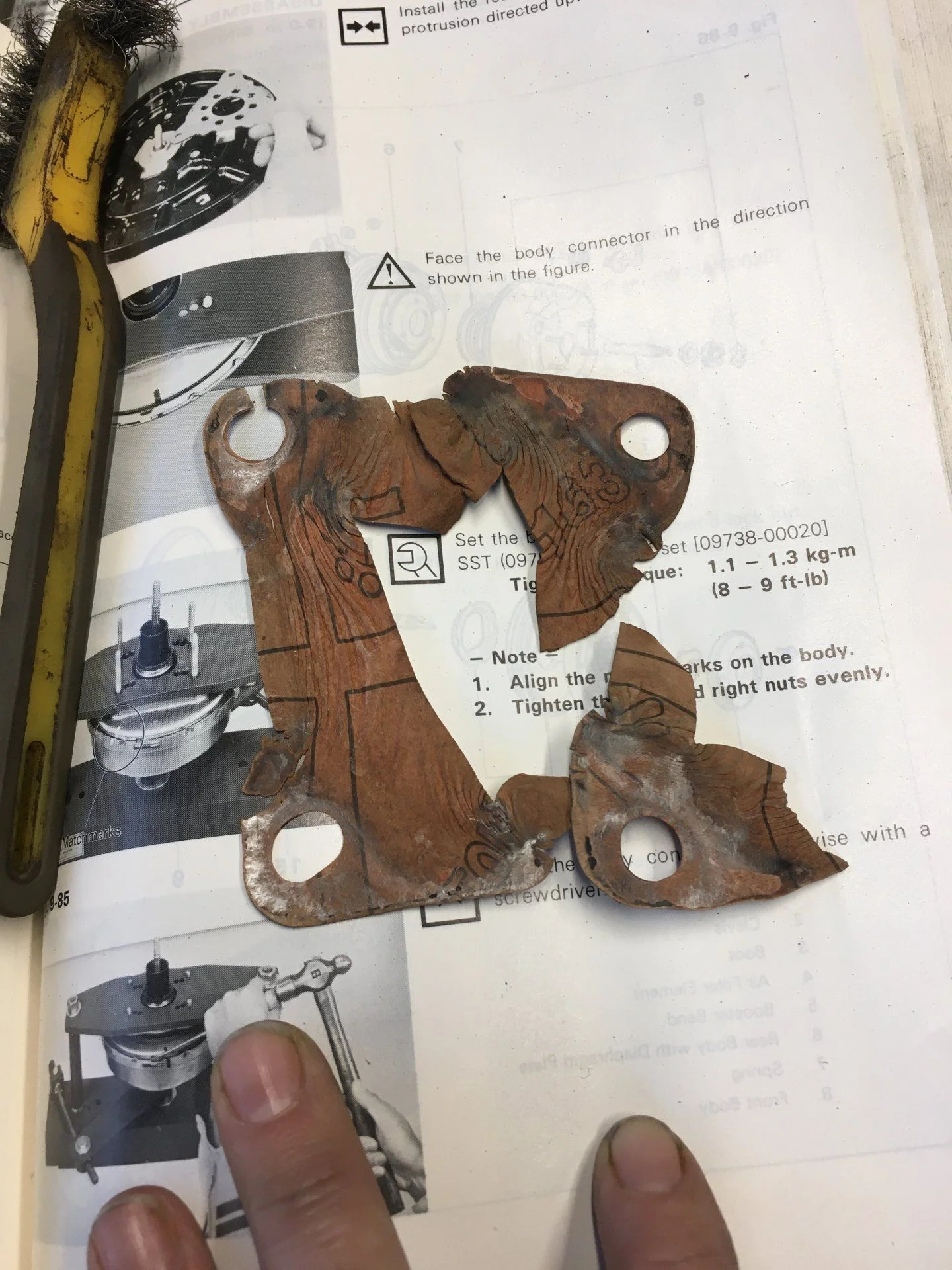

Homemade Ace Hardware cut your own paper gasket material suffice to replace this sad one for the booster?
