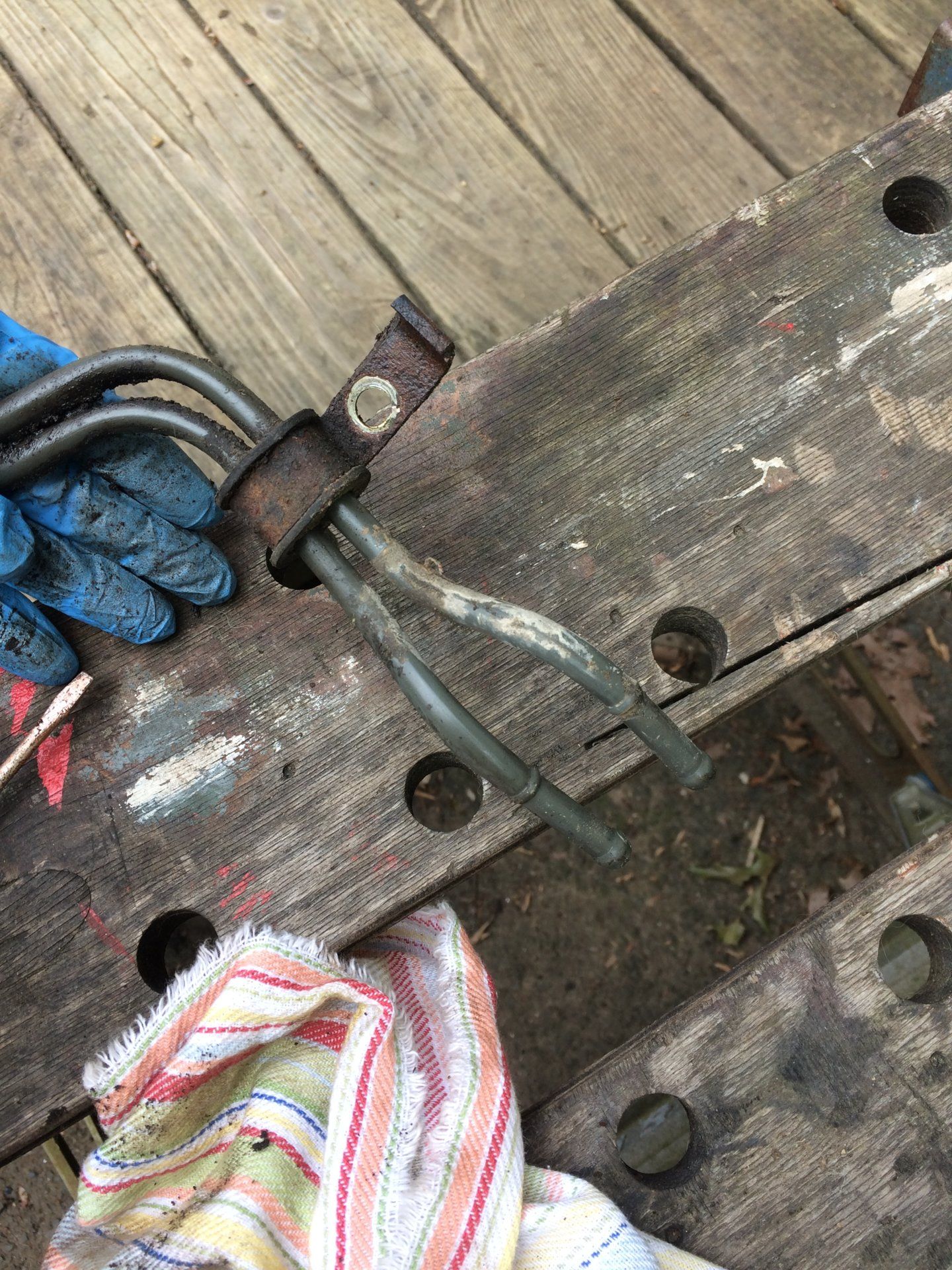

So I have to correct myself because I found while texting today that I did not remove two fuel lines and two brake lines... I removed two fuel, one brake and one fuel vent line. Whoops. Excuse my mistake.

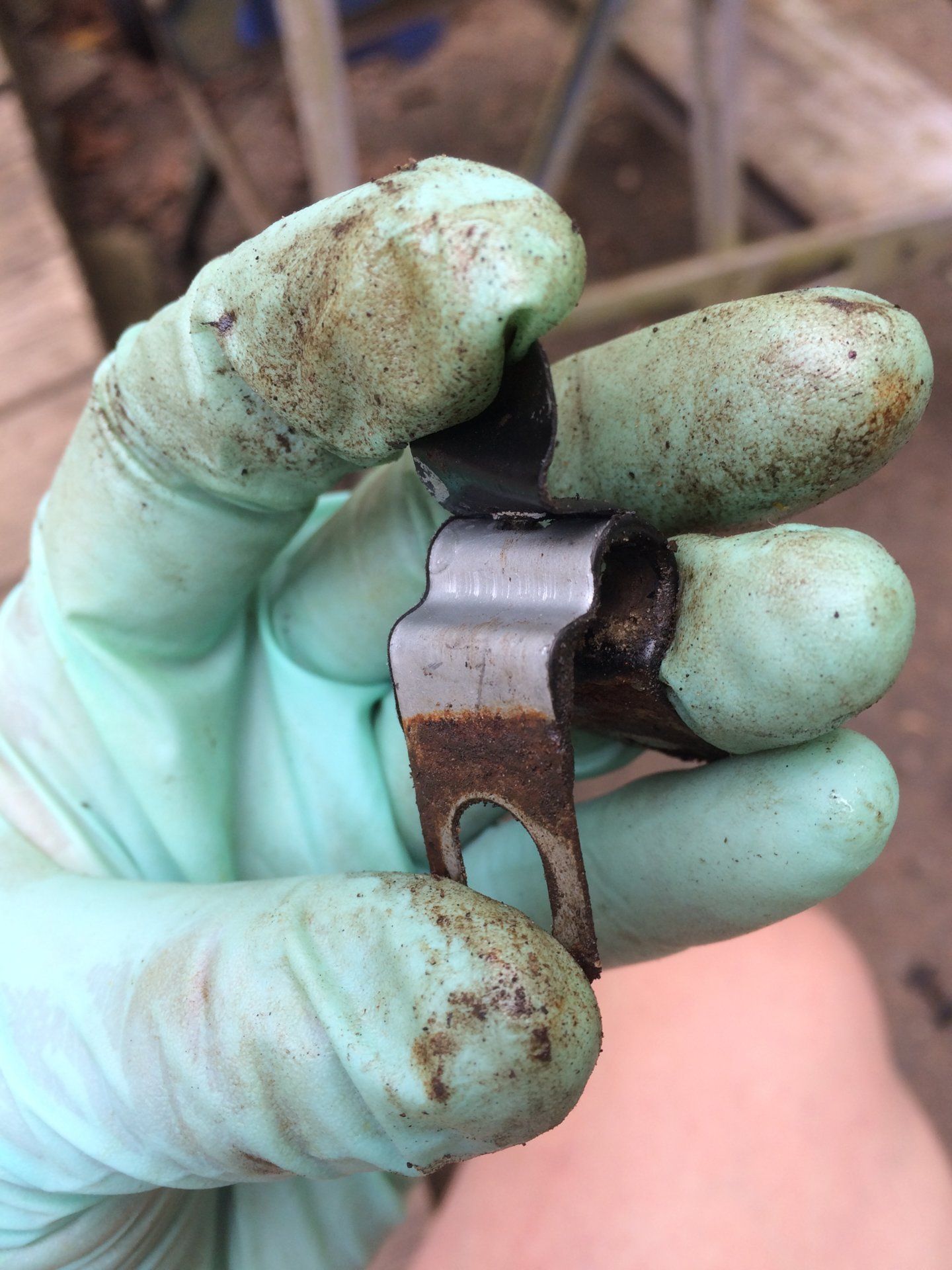

I pulled the brackets off almost all except the end of them so I’d know how and which way the new ones will be situated and where bends will be needed. Interesting that the brackets are shaped different from the brake to the vent line. And still so shiny under the rubber dip (I’m assuming).
The fuel vent line, I’m curious that could simply be hose correct?

If you’ve desmogged, you could vent the tank at the rear of the truck and omit the charcoal canister and evaporative system altogether.
I would keep the evap system. It's good for all of us. And I'll say your vent tube lasted 30+ years and for sure a rubber hose work around will not. Remind me why you removed all of this? Is it to work on the rusty frame? That makes sense to me. Thank goodness, we don't ever deal with that level of rust.

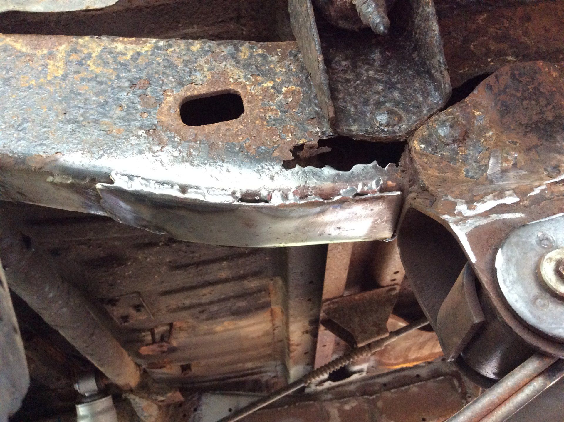

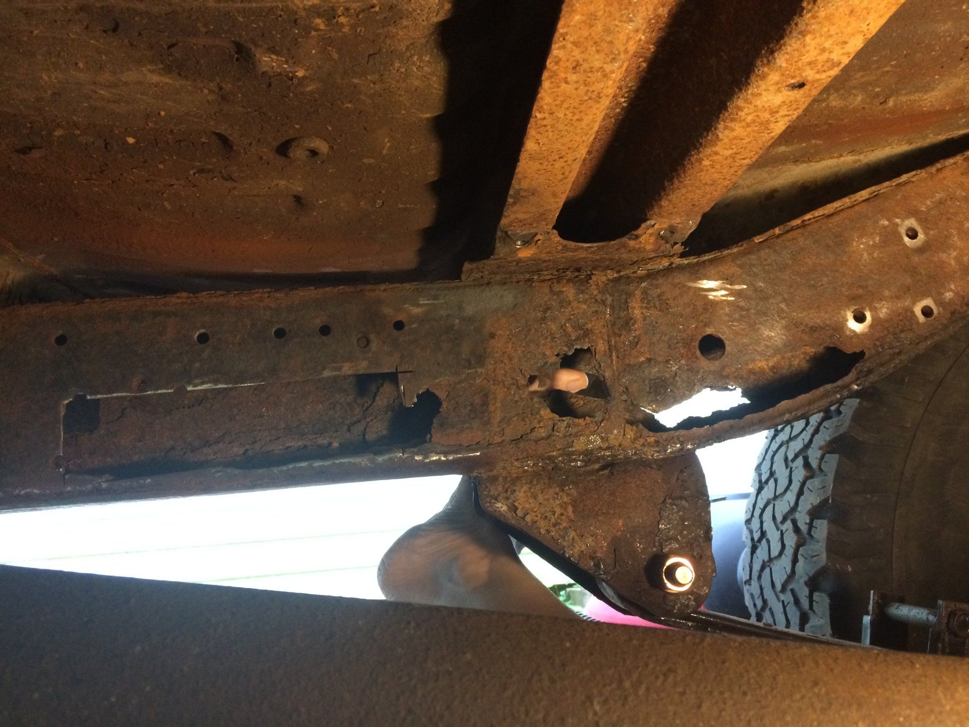

Last few days I’ve been tackling the rust on the inner rear passenger frame rail. It’s pretty ugly.
I’ve learned a few things w/ my angle grinder... as a thin sorta short female I need to lower my stance and spread my feet so I have a solid base. Friday night I started cutting some of the metal I had kicking around for this exact project. I broke three thin cutting wheels. First one caught my wooden work bench that was the first lesson. Don’t work on a wooden work bench w/ an angle grinder. It grabbed the wood and spun out of my hand. Luckily I’m fast and knew to step away. It hit the ground and kept running. I stood looking at it chuckling after the initial squeal of surprose. Wheel busted off in a bunch of pieces. And yes, I wear gloves and a face shield. The second two were just dumb after the first.
Today I finally moved everything (including the cylinder head which is surprisingly much lighter compared to everything I’ve done thus far) off my welding table and did most of my cutting thereafter.
I’ve really taken to the use of cracker boxes for making patterns (others use beer boxes but I’m not a big drinker).

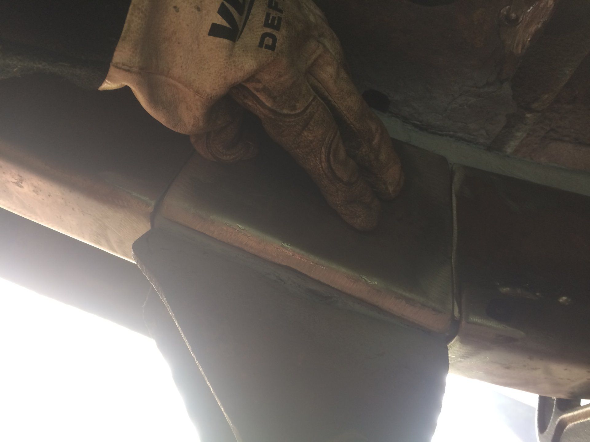

I made a pattern and set to it. Unfortunately that rule of measure twice, cut once... I failed. But next time hopefully I’ll remember. Regardless I’ve got three perfect fitting sections that I’ll begin tacking together tomorrow. I did a quick tack of the curved section but only because I had to overlap it.

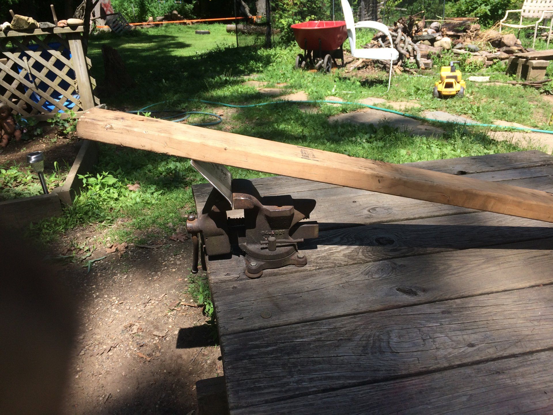

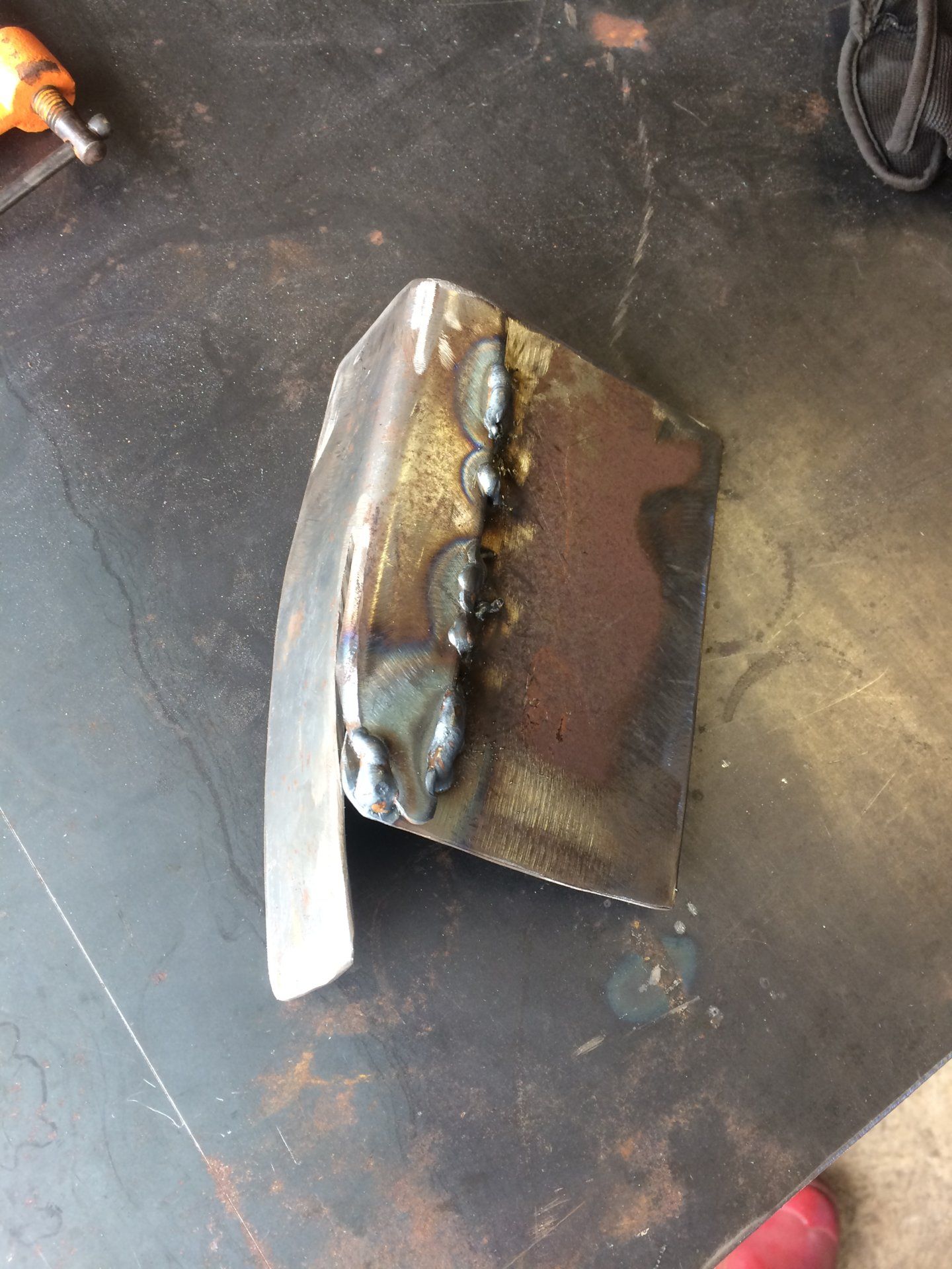

Also another tip I realized... when needing to bend metal and have no metal break... score on the inside then add it in a vice and go slow and work your way across. For a deeper bend I put it in the vice and took a 5’ length of 2x4 and used my weight to tweak it down further.

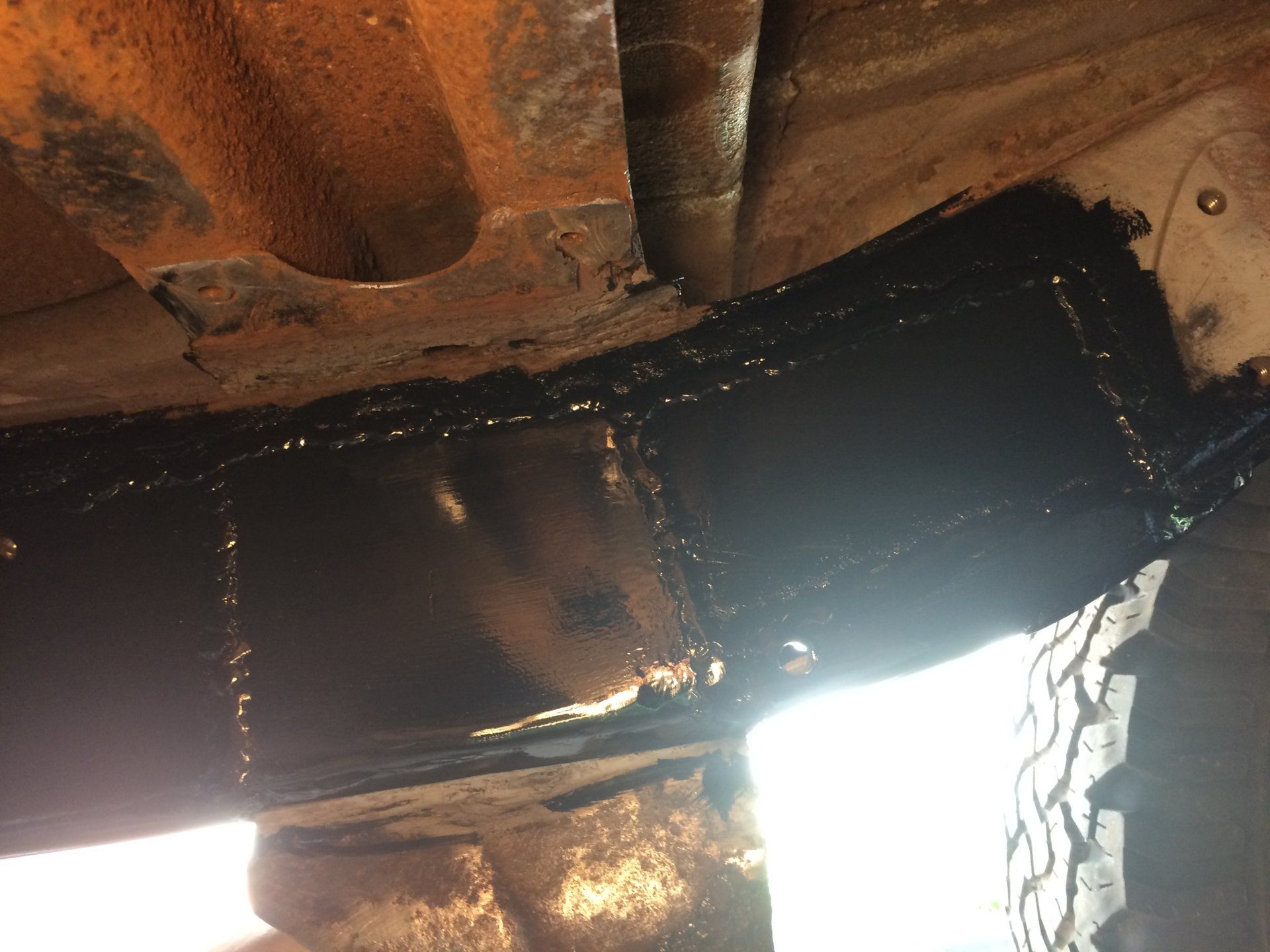

What I accomplished, I’m very pleased with.

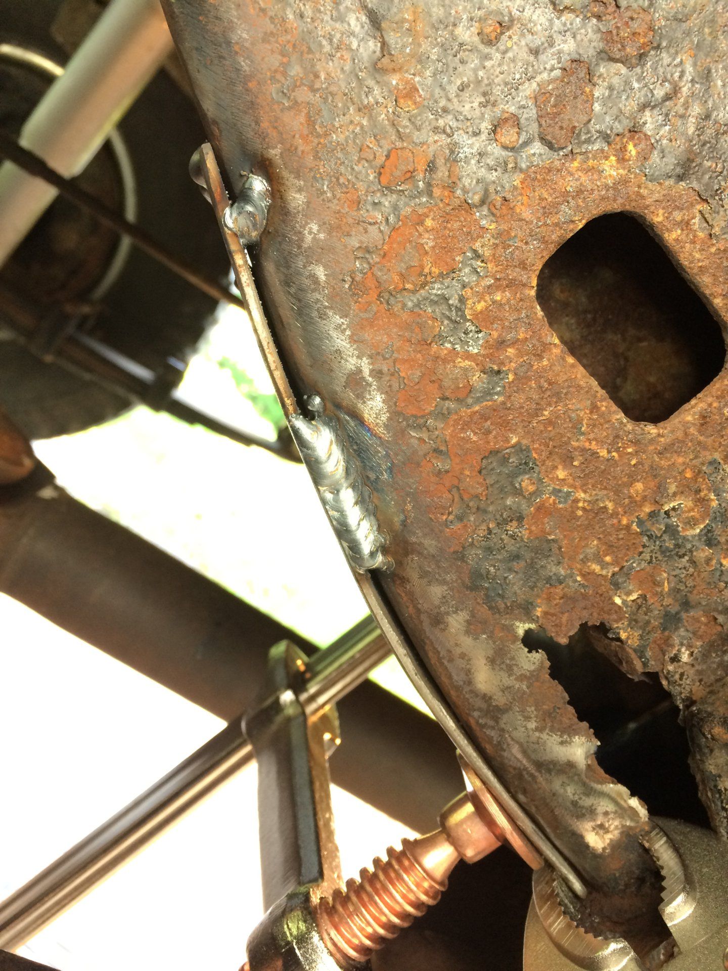

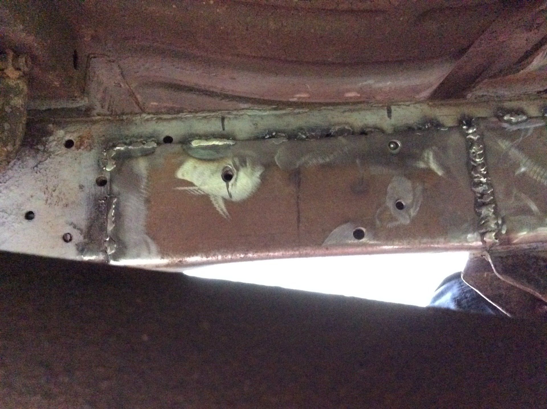

Thanks to some welding text guidance I’ve got the inner side mostly burned in. Not too shabby! And yes, that is some fugly ass rot. Well aware, no need to rub it in.
I took the advice of someone on mud and wet a towel to toss over my legs while on my back. And to combat the 90 degree temps here today in CT I wet my shirt as well. Talk about refreshing!
I was actually pretty extra wise and drilled a drain hole in each lower horizontal section. As well as I chased the threads of the bolt holes for the fuel and brake lines. One has a sheared bolt shaft in it, I tried to extract it but decided to let it go as it was simply pissing me off. Too hot to be worrying about one hole.

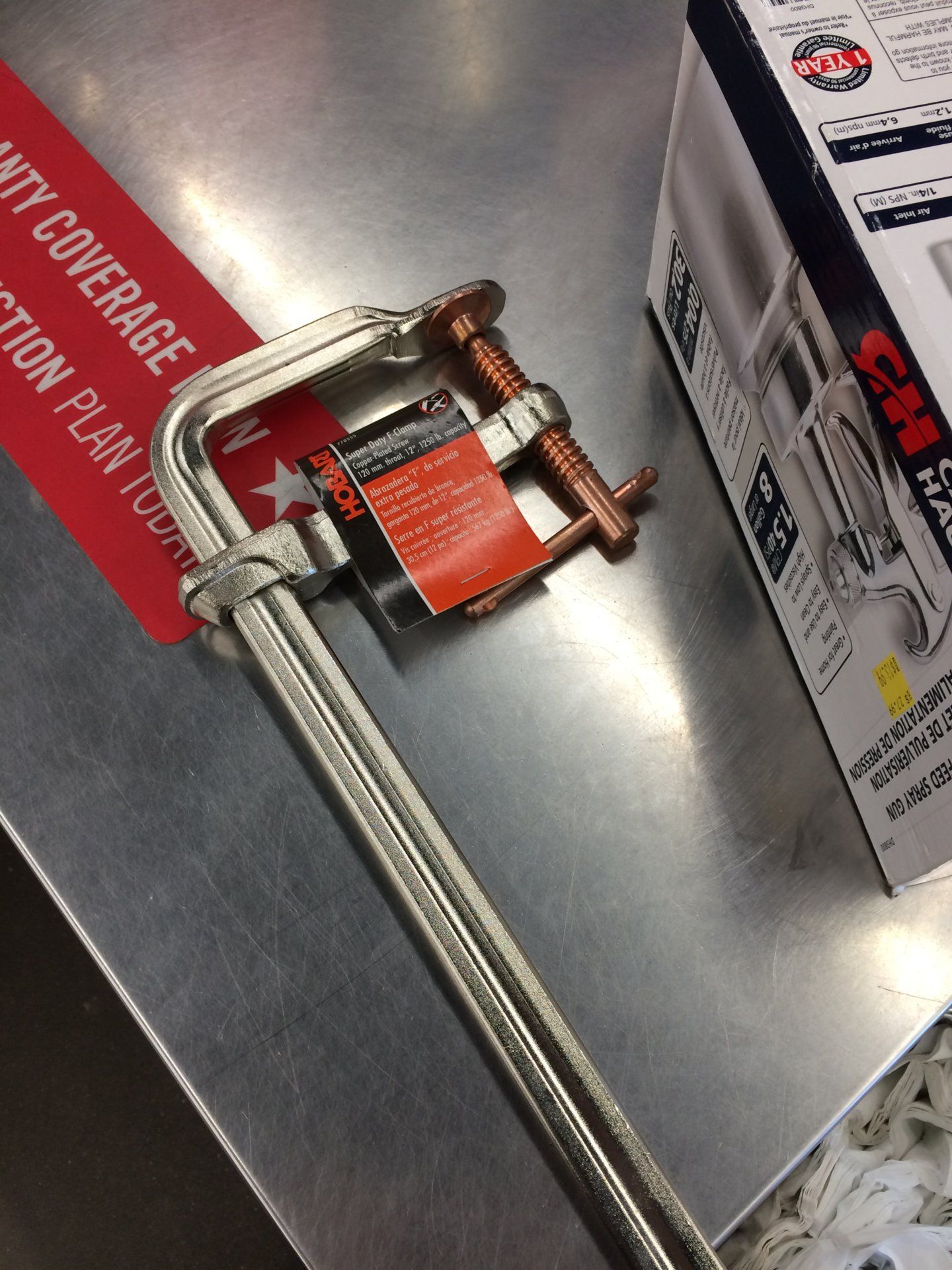

I NEEDED to bring one of the patches up tighter to the bottom horizontal so took a ride to a tractor supply and most likely spent far more on the name than the tool.
From this to this...
Another thing I’ve gotten very skilled at, flushing crap out of my eyes. Rule one, if you feel something go in, don’t rub, flush immediately.

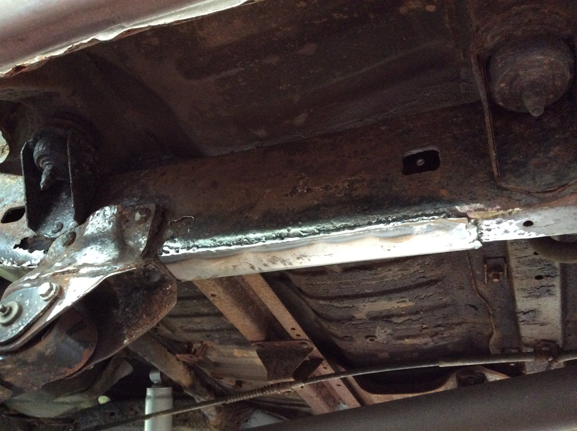

I added a layer of black brush on rustoleum. Next up is the outer side. I done for now. Couch is my friend for a bit then work at 3.

Bit by bit. Nice work. Once you paint it, only you will know how bad it was.

Thanks! Amazing how nice even one coat of paint looks on it!

Not sure I agree. Smog is an evil, but it won't cause your truck to go to the junk yard. Rust is the bugaboo that haunts all Land Cruisers from the start. Rust is death. Entropy. It always wins.
I feel fortunate that my old ones (actually they are all old!) are rust free, but I do realize it can be different. So far at least, smog has been a surmountable obstacle. Though one time my FJ60 required a new cat, carb rebuild and air pump. So smog sucks, but rust is an end game. Good to see @NeverGiveUpYota not giving up, because I would have, and been looking for a new frame!
Love your determination. Wow.
Fel, A couple of points to ponder:
Going forward, you might want to think about coating your patches front and back with weld-through primer prior to burning them in. Local auto body supply house will have it. The pic I posted is the copper based stuff. I actually like the zinc based stuff better. It welds better IMO. Having a layer of protection on the inside of the patch that you can't paint will help it to last longer and not rot from the inside out.
Also, Fluid Film. When your repairs are done, spray that sh@t everywhere. Try to get it into the inside of the frame through any holes that allow access. Fluid Film will keep the rust at bay. I get the aerosol cans at my local Lowes store. It can be found online as well. It's about $9 / can. Not cheap, but not terrible. Get lots of it and use it everywhere.
