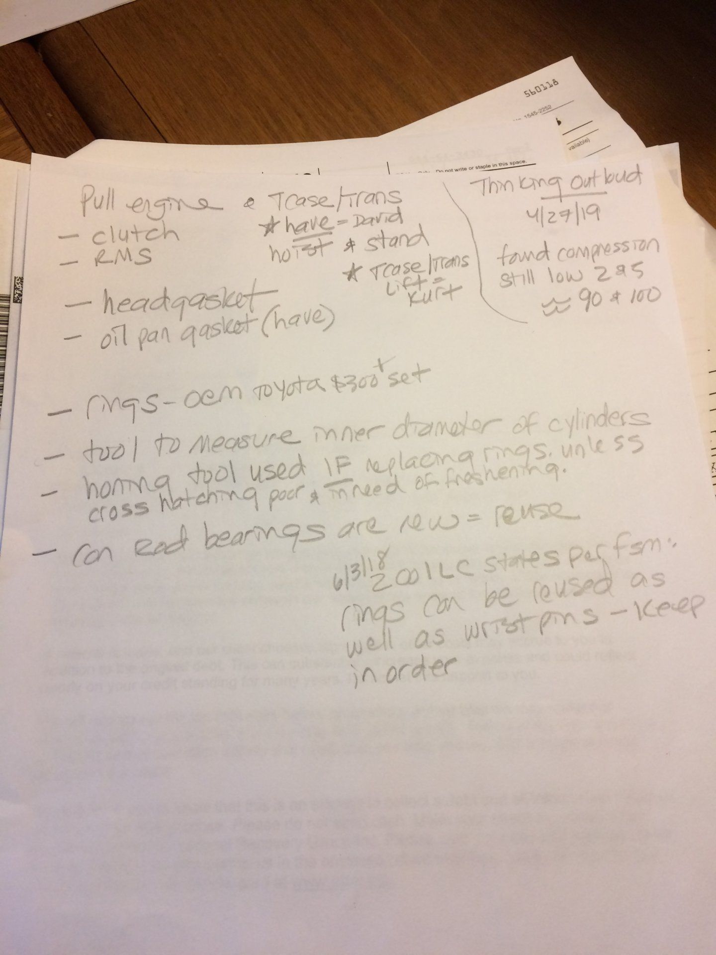

Started a list a few nights ago. What a pain in the ass.

Your list is missing beer....
And haven’t you said you might still have an intake leak? Not to give you more work or anything... are you re-using the gasket for that?
I’ve got spare gaskets, (2) for the manifold. Thanks tho for the reminder. And beer.... easy enough but that’ll be well after each task is done.

I'm curious, what leads you to believe your rings/pistons are bad?
Most recent compression test 2 & 5 were 90 and 100, same wet (two years ago when I jumped the gun for far less those two were 130 and 140). Coolant mix up top and in air cleaner base. Quite a fair amount of oil from air cleaner weep hole onto the pcv pipe and grommet too. Still reaching out for a leak down tester but may just buy a cheap one off Amazon.

Nah it’s okay. I’ll figure it out soon. My friend whose helped me a bunch really thinks after seeing the photos of the coolant up top that a leak down won’t show much more. If I’m pulling the engine I’ve gotta do it the right way anyway. I guess a leak down and it’s results will just solidify my gut feeling of my HG slowly leaking.
