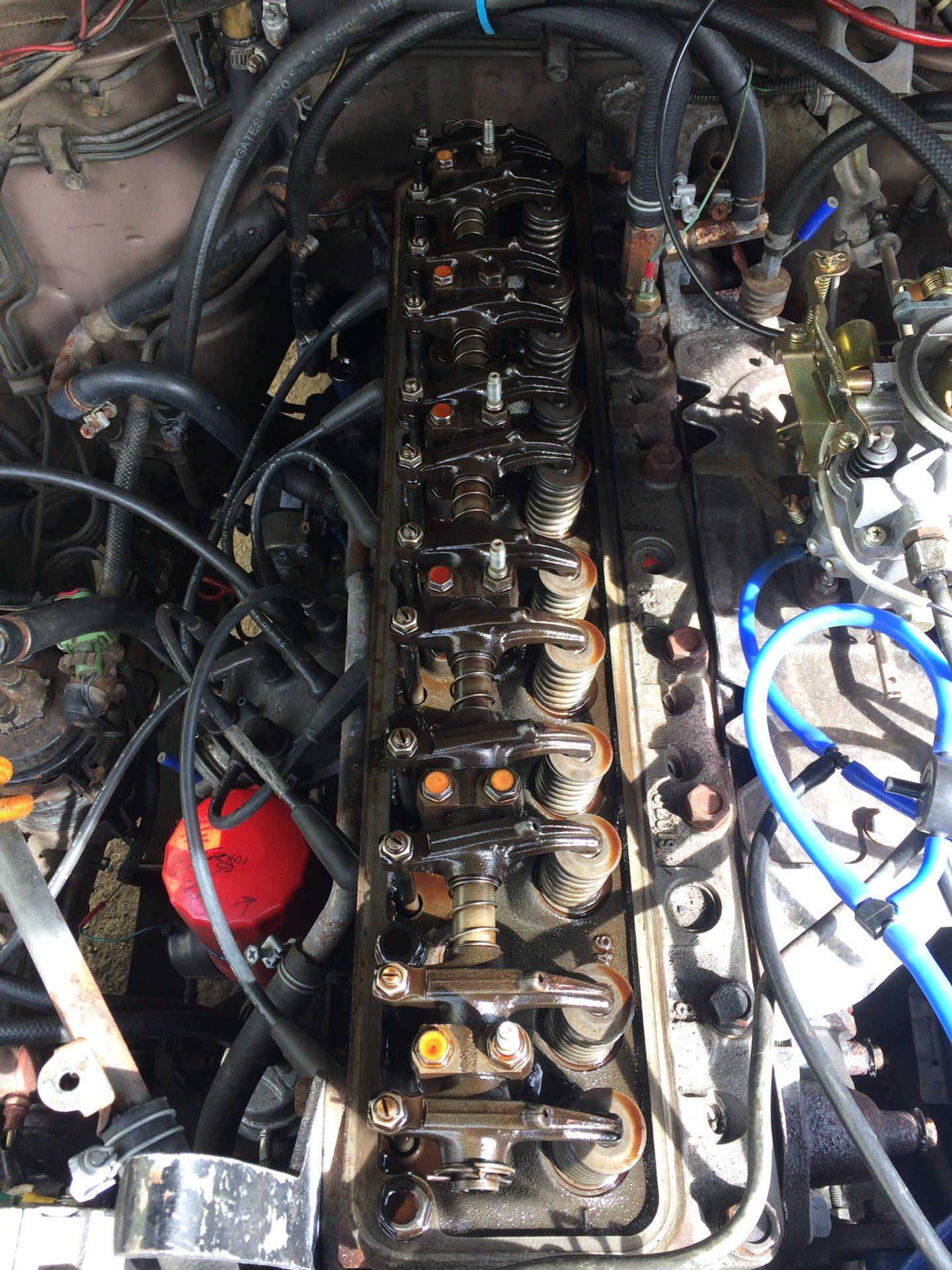

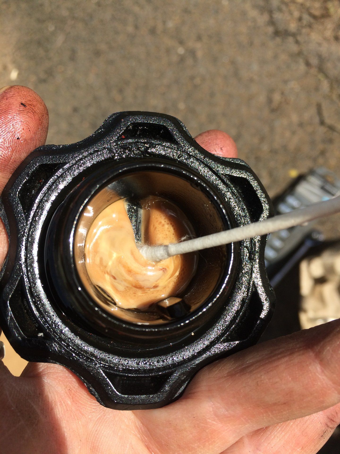

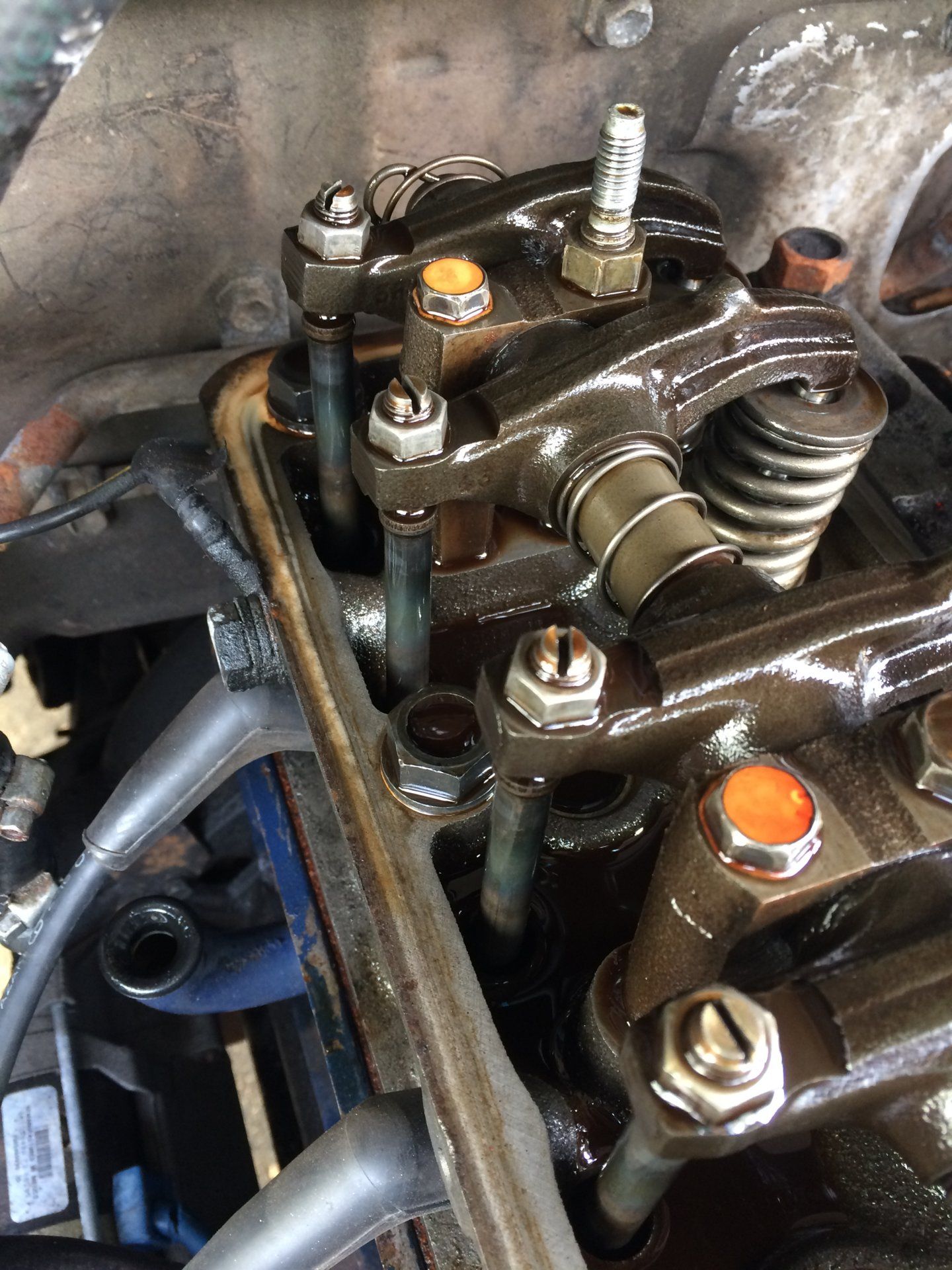

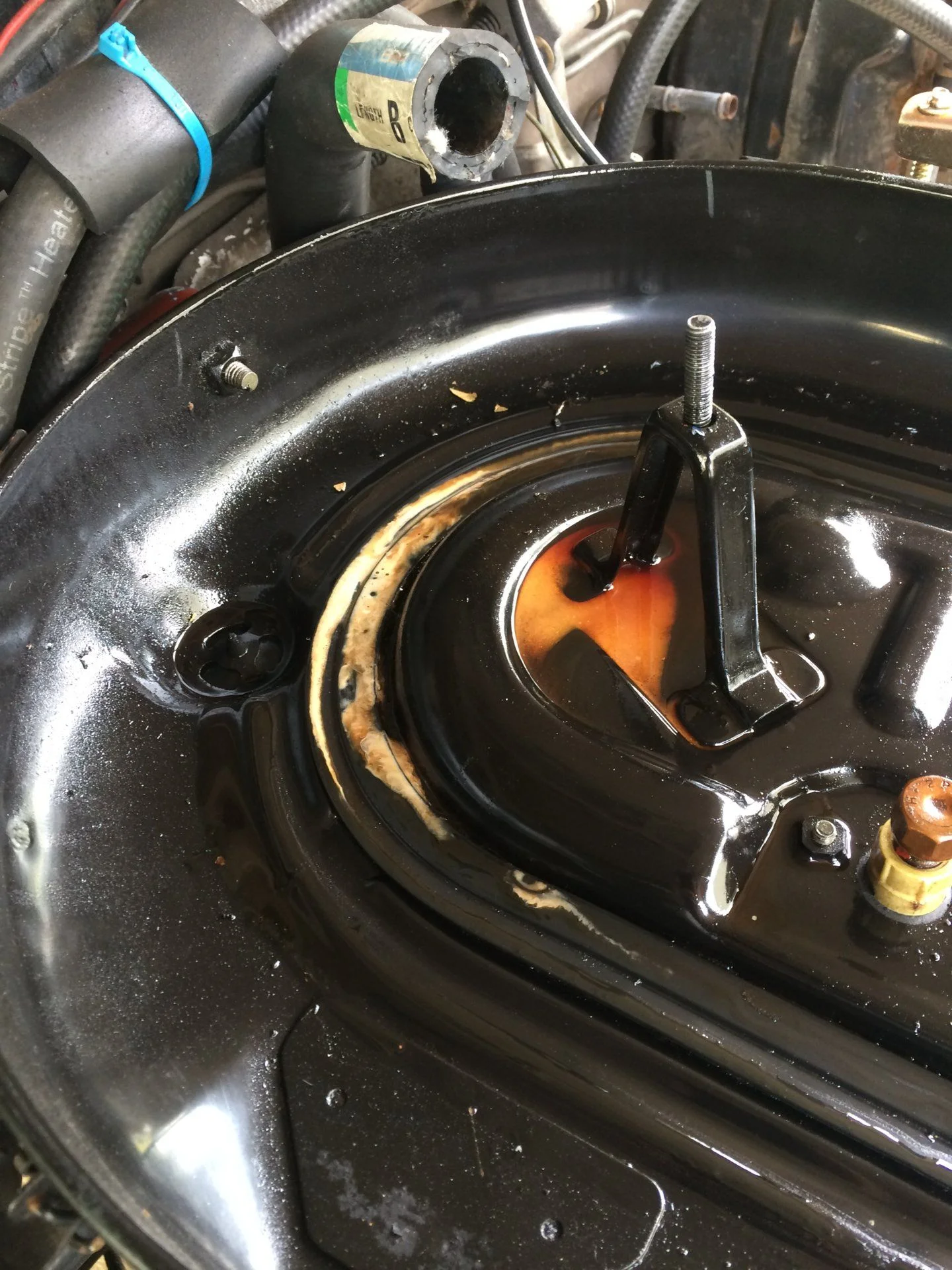

I think there is a more than significant chance, there is a cracked head. What do things look like under the valve cover?
Anyway, if you are sure the HG is bad, the low compression may just be related to that.
You really gonna rebuild the whole motor? I know you can, but that's a whole lot of work and expense. A magnaflux of the head and new gasket might be enough.

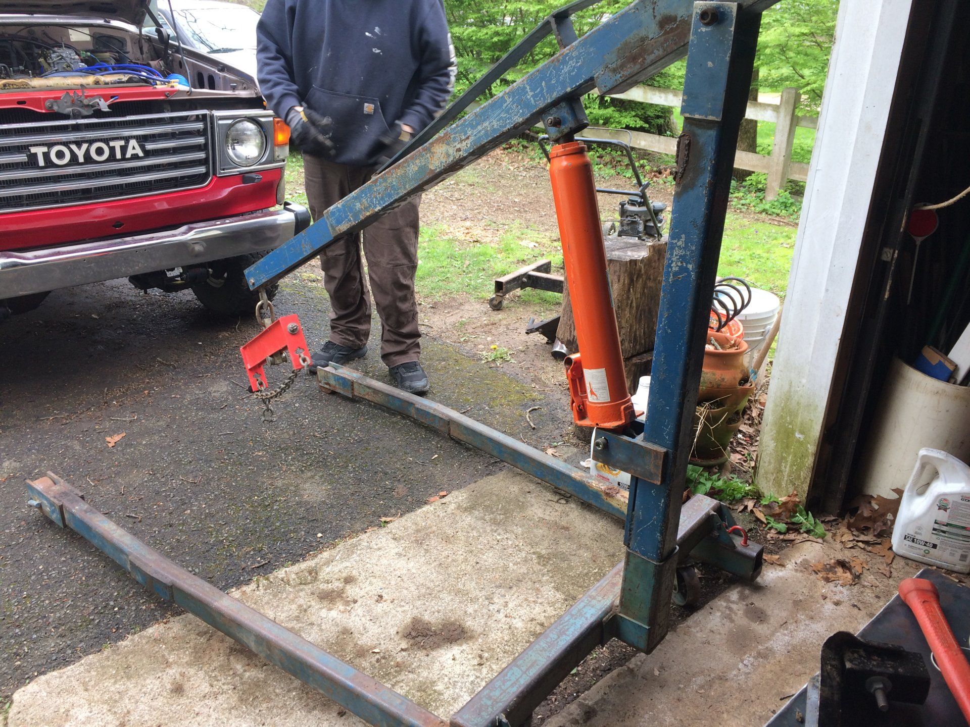

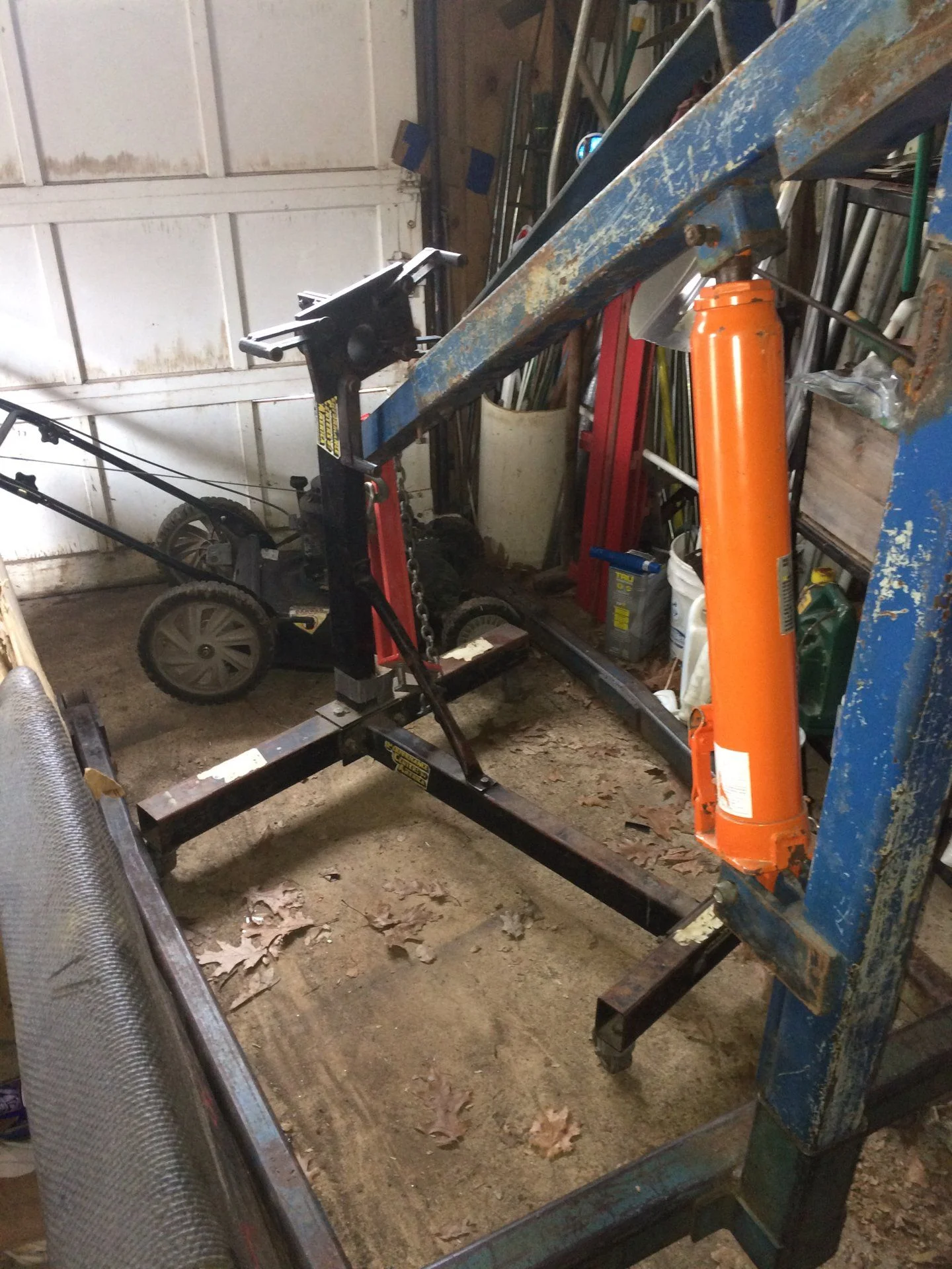

Give me few days to figure it out can you get your hands on an engine hoist to get it out of my truck I’ll see if I can the motor pulled so you don’t have whole truck sitting in your yard
I can easily get a heavy duty hoist and stand. My friend, David, has all that from working on diesels. He was going to drive it over this past weekend but I told him to hold off. It was a tad overwhelming to say yes right away. When I pulled the valve cover I knew I was in deep at that point.
I would so jump on a spare motor. At least if you have a cracked head, you might have a decent alternative. And a spare transfer case is gold.
Pisses me off cuz I asked that the head be fluxed, swore it was but I don’t think he wrote it on the receipt.
Maybe you'll be lucky and it's just the Head gasket. I hope so. Your machine shop can tell you easily. Cracked heads are super common on 60s though, so be prepared mentally for that. You have a bunch of work in front of you for sure. Good luck.

So curious here, what makes these heads so prone to cracking? Surely the low compression numbers combined with the oil/coolant mix lean towards just a HG failure right?
Hard to say but it's a fact. Early 2Fs do not seem to have the same issue. Could be they lightened the casting a bit. Someone like @FJ40Jim would know.
But in this case, I would not put the motor back together without specifically having the machine shop magnaflux the head.

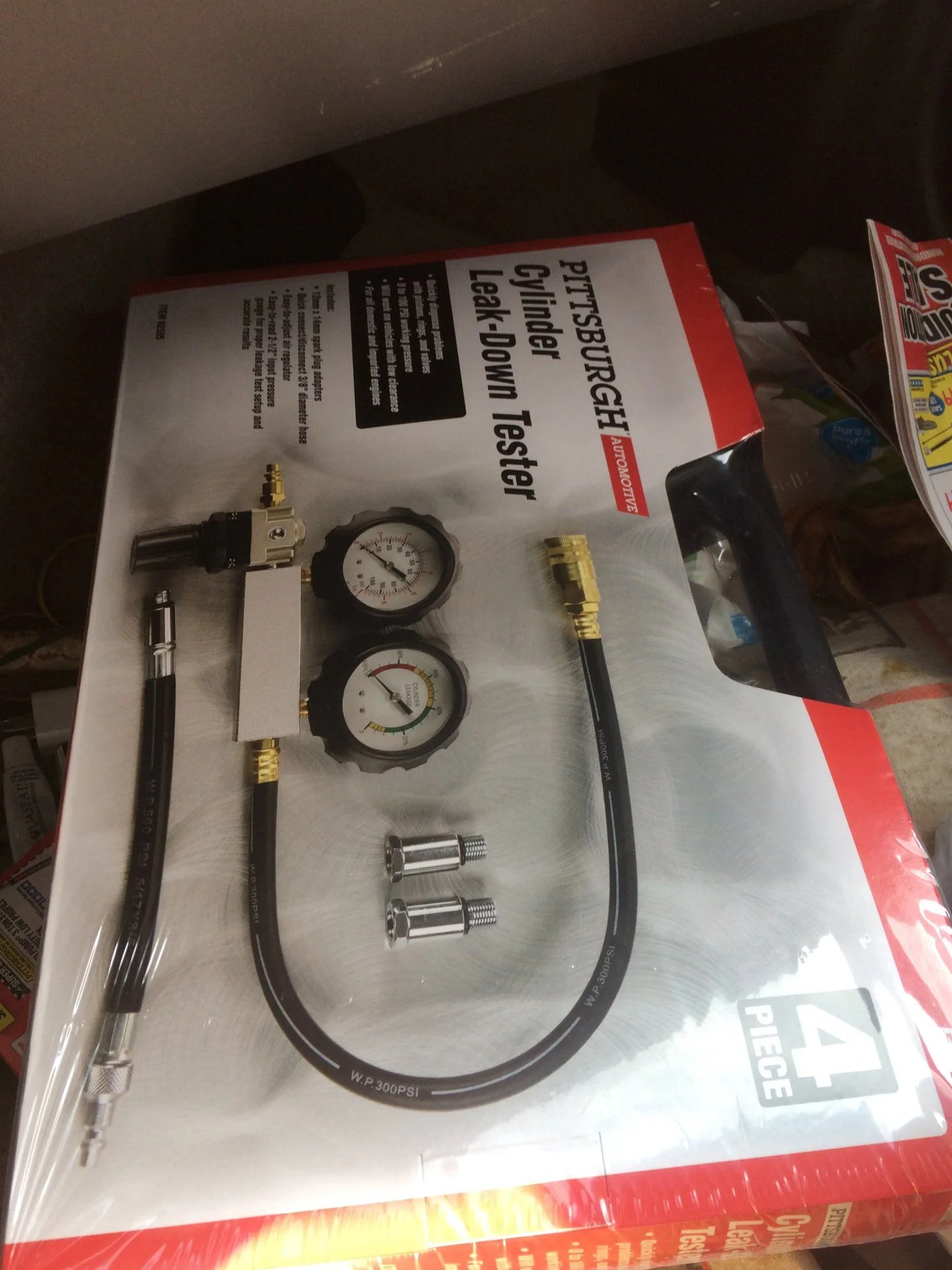

Ok those who’ve done a leak down, what psi is necessary? The cheap leak down tester on Amazon for $34 had 5 reviews. 2 said it won't hold over 15 psi. Next one up $71 has 500+ reviews goes to 100 psi but many complained it doesn't seal tight enough. The HF one is $49 and has many reviews that all seem fairly positive. One tho says he was glad the HF can use a low psi or high.
So what psi will I need?
I would think more is better. You should probably get one that can handle 90 or whatever your compressor can put out. To be able to find smaller leaks.
I got hooked up w/ this today. Seems it’ll be sufficient.
Did a valve adjustment and had to add a quart of coolant. New plugs. Started her up, quiet but lots of either smoke or steam. I hadn’t thought to grab a piece of glass or mirror to see if it condensed. Will try tmrw before I head to a local friend (5 miles one way) to do a leak down.
