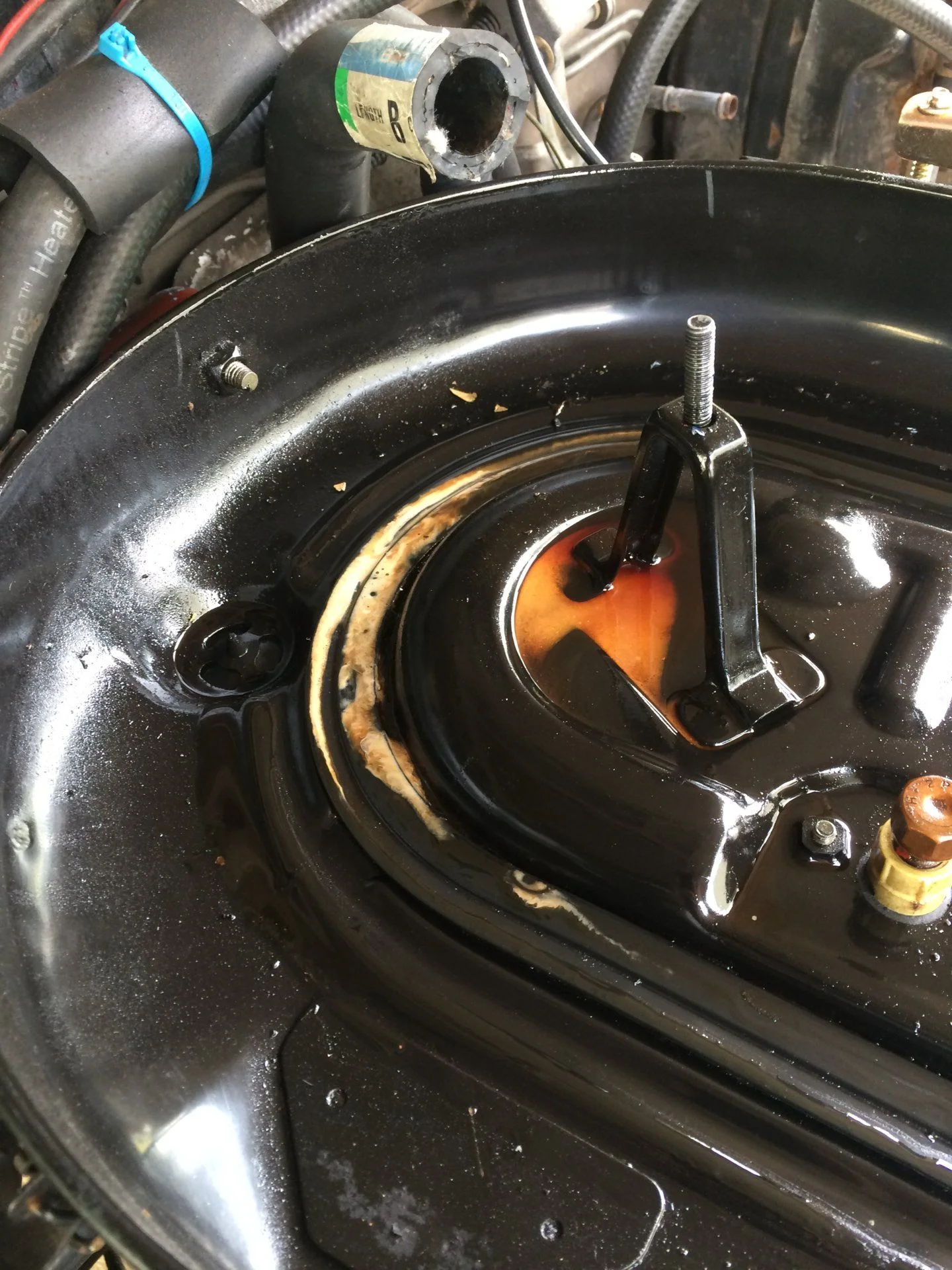

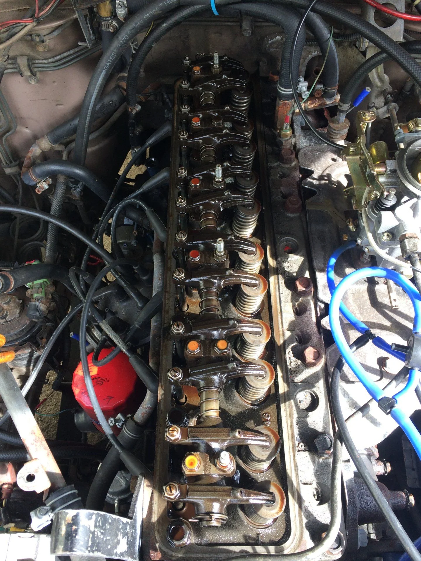

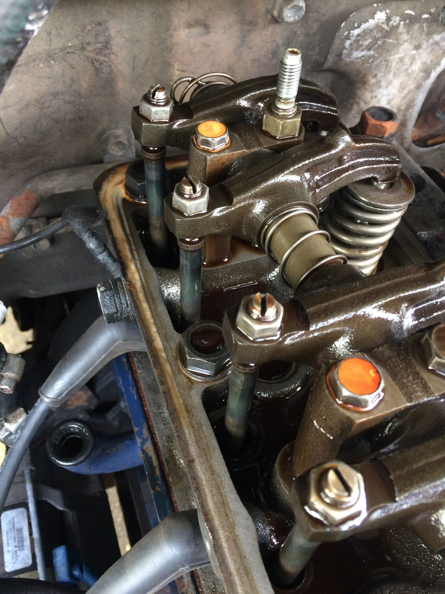

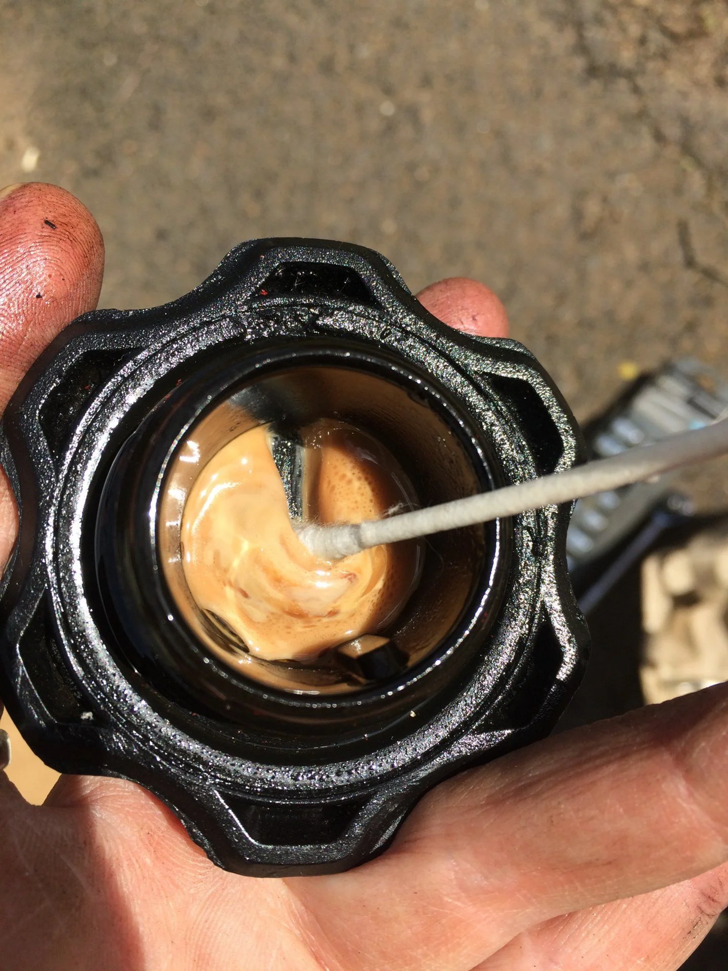

So somehow I believe from just a chance compression test I missed another catastrophe. I pulled the valve cover today after running the truck till it was nice and hot. Air filter was my first WTF moment, inner paper material was stained tan at the inner rear ring. Air cleaner base revealed a pool of oil and coolant mix. Now I know why the lip of the PCV grommet often appeared wet. Rocker arm bolts all have same oil and coolant mix.
Truck did run for a bit in the driveway. Once I saw what was going on I stepped away. Slid my feeler gauge in just to see how they felt and found my intakes tight and exhaust loose. I didn’t bother to get it to TDC and do an adjustment at that point. Stuffed some rags in the plug holes, packed up my tools and closed her up.

It’s possible that’s just condensation in the oil from not getting hot enough during cold weather starts.
It’s possible... plausible.... but that doesn’t explain why the PCV area has been wet... nor does it explain why my air filter has such a tall stain of oil in its paper material.

I’ve been watching my oil fill cap... it does grow a layer of the mix too. Never been ‘bad’ so I chalked it up to the same, condensate. This was the cap yesterday....

Really sorry to see that after all your hard work :frown: .Hang in there, the second time is always easier:cheers:.

Yeah lovely.... talk about learning through error.
I’ve got a head gasket hanging up in the shop just in case mine went bad. Happens to a lot of people - which is why I had the spare - and I don’t think you did anything wrong. I’ll check it to see if it’s still viable and the correct one and send it out to you if it’s a match.
